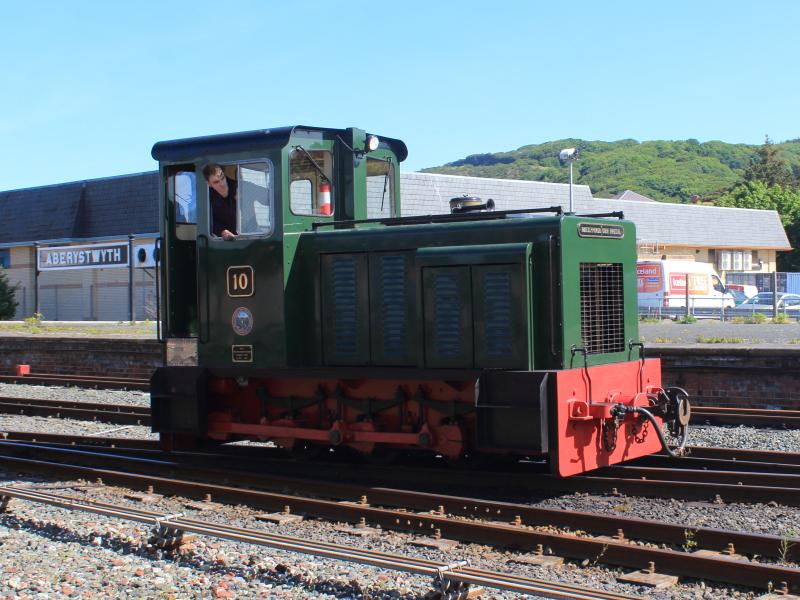

I got my Baguley - Drewry radiator plate from John Lythgoe  - http://www.johnlythgoe.com/16mm_Heritag ... lates.html - Scroll down to Miscellaneous Works Plates 226-132NS
Excellent service & very well packed for our Royal Mail's 5-a-side football games. Also includes excellent illustrated instructions on how to fit your nameplates.
He no longer does custom plates so you need to contact him to confirm he has your desired plates in stock. See here for a comment on payment for orders outside the UK - http://www.johnlythgoe.com/ORDERING.html
For number 10 plates as worn by Vale of Rheidol Baguley Drewry No.10, I ordered Narrow Planet NPP-402 Black Nickel Silver plates (height 14mm) - https://narrowplanet.myshopify.com/coll ... 5461806657
Be aware that it can take some time for your order to be processed by Narrow Planet - I was aware of this but the 10 weeks they actually took to arrive was somewhat more than others had previously posted online. They do send out an email with a copy of the graphic that is used to etch your custom plates for your final approval before they are actually made.
Chris Cairns
