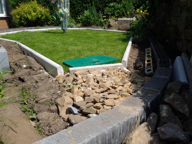

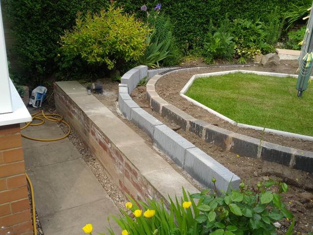

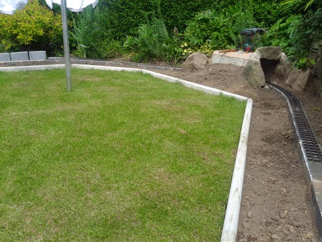

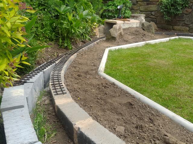

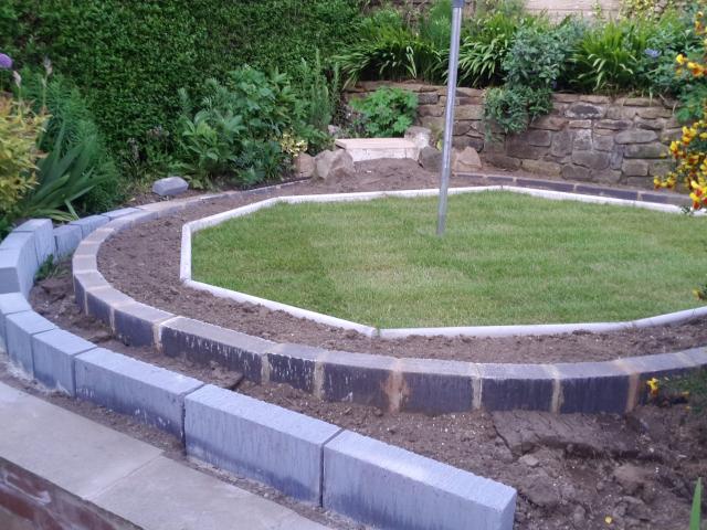

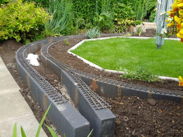

Thanks Peter, that lawn was actually on a very steep slope before the Bank Holiday! See photo below. I levelled it behind a new wall, using bricks from around the garden, and laid the turf AFTER  getting the railway trackbed in! The track will then loop round on a filcris structure over the lawn in the other photo below. The curved line of blocks provides a way of reversing trains. A 2nd stage may see the railway venture round the front too, but not yet. Oh, and a fence is planned next above the main garden wall, to hide things a bit.

Not a great deal of planning or engineering Andrew, it pretty much is just 'happening' as I go but all seems OK so far. Bit more track gone in this morning to form the outer platform road and the next job will be to tackle the footpath crossing so I can access the worksite without clambering about! As it happens though, we're just in time to see the Morning Mixed arrive at Hollycross so work can be postponed for a short time.......

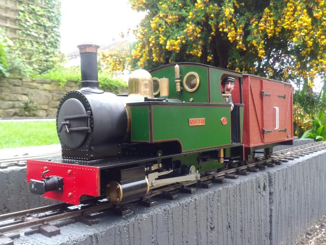

Bog standard IP kits Joe, built exactly as per but with toilet paper pasted on the roof to represent felt. They match the slightly larger ACCUCRAFT loading gauge so look well behind the Lawley!

There are some less successful attempts to make track beds out of straight units be they either blocks or planks.
What is clear here is that the track radii are large enouth to reduce the threepenny piece effect. This is helped further by the high standard of block laying giving a very effective 'well engineered' impression.
Whilst my railway is firmly fenced in at its extremities I feel that a railway using similar standards of contruction to this could spread incrementally beyond the original plans and without too much forward planning for each change.

As Andy says, there is some very good quality engineering on display there. I'm very impressed. Getting the alignment smooth and even is absolutely everything when it comes to looking realistic. Very few railways, even narrow gauge industrial ones, were ever just 'laid where they fell', there was almost always at least some surveying and setting out. This means straight straights and circular curves on the whole. Those lines which replicate this always look the better for it.

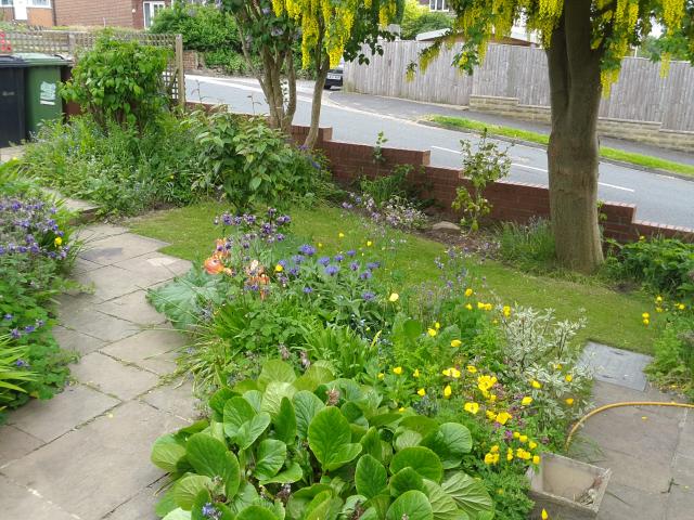

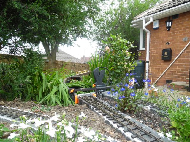

Many Thanks Andy and Andrew. Ive done some planting out around the area which seems to have made a big difference and also finished the access path. A couple of photos here.......
....and a few more photos on my flickr site. Feel free to have a nosey there, link below

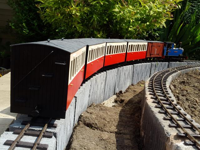

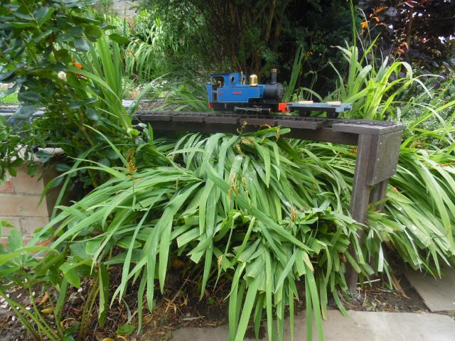

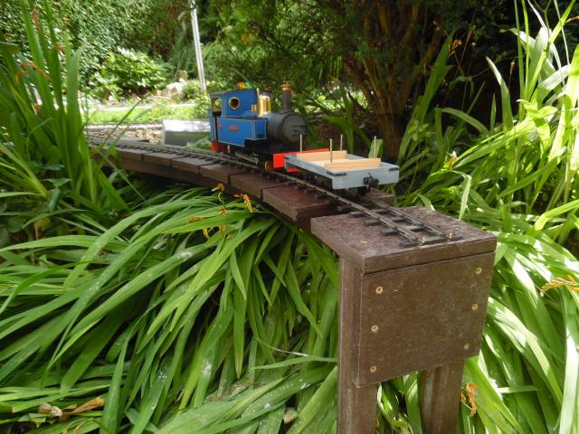

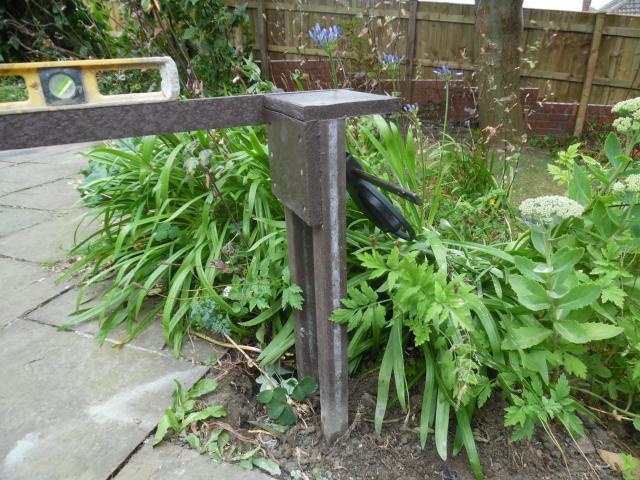

Greetings Peeps! Been a few weeks since Ive done anything to the railway but back in business these last couple of days and the next stage is underway, namely the raised 'filcris' section. The photos show progress so far, all achieved quite quickly really, the filcris is a joy to work with, hopefully it proves to be relatively maintenance free too! Time, and running trains, will tell! On with the show....
Going beyond Hollycross station, the line will run onto a raised section, almost immediately crossing the main path to the house where I plan to put in a removable bridge. A bit of faffing around gave me the initial positioning of the main bridge supports.
These were built and put in a couple of days ago, securely set in Postfix. A couple of battens were fixed to them to ensure they stay in position relative to each other, both while being set up and the next stage to ensure no twisting out of line occured. I can report this proved its worth, filcris is great to work with, very easy to use, but it IS flexible! Onwards....
The photo above shows the junction for a branch which will eventually lead to the front of the house. From this point, the run out and back will be approximately 60 yards, and will require locos to work hard on the way back!
Standard crosshead screws were used, initially in pre-drilled holes, but I found the filcris accepts them without holes being drilled, it doesnt split, crack, bobble and screws will countersink themselves very easily and neatly, making construction fly along. Within a couple of hours, the first train was venturing onto the new bit of line, and Im pleased with progress. You will note, some realignment of the outer platform line is required as a result of not much proper planning!

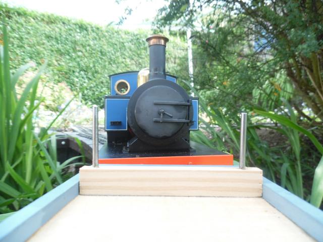

The wagon was built with a view to filming. 2 rubber bands hold the camera in place against the bolster and away we go...Ahem....
