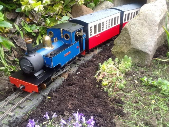

Many Thanks Andy and Andrew. Ive done some planting out around the area which seems to have made a big difference and also finished the access path. A couple of photos here.......
