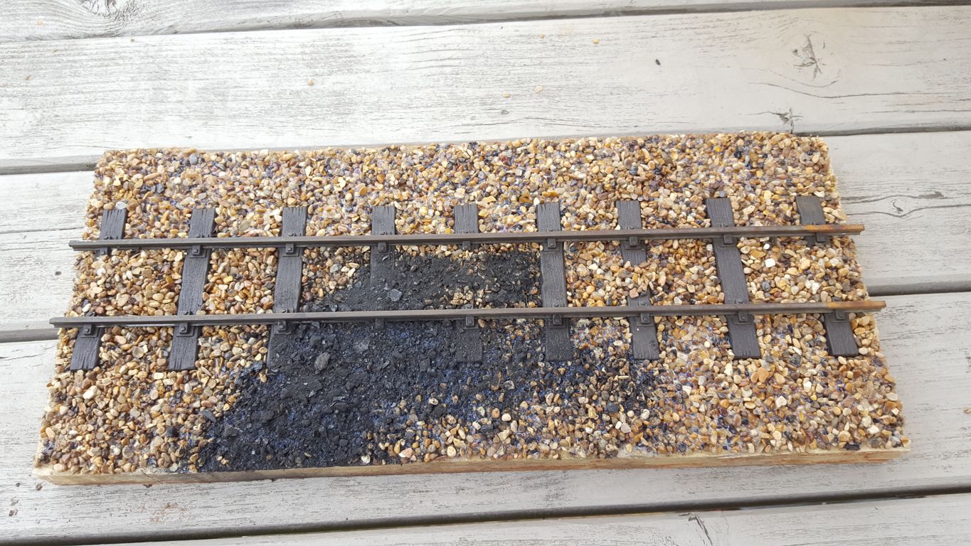

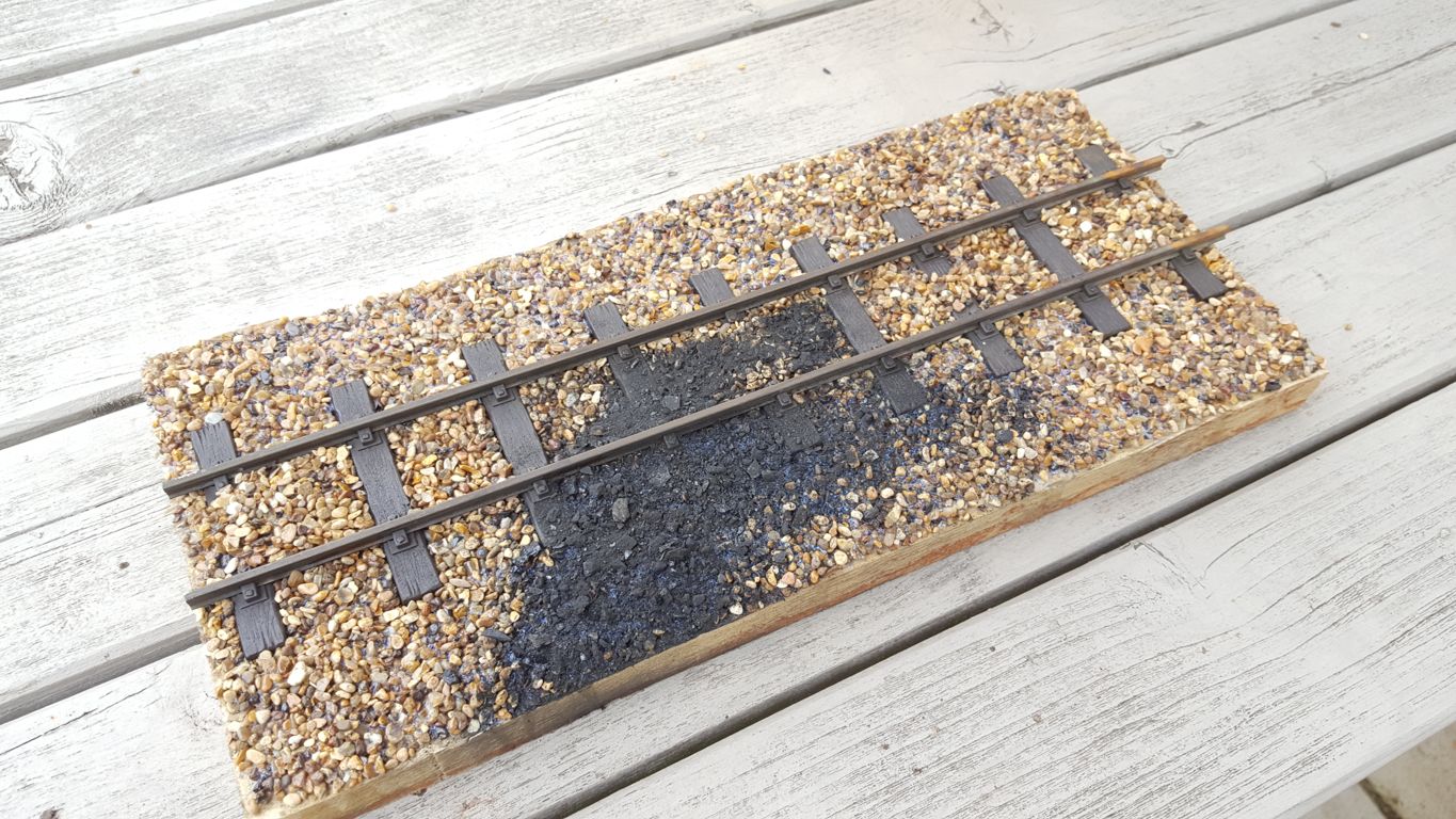

Re: RWLR - Robin Wood Light Railway
I am getting a bit obsessive about this!
A spare piece of gravel board with the track screwed directly to it (sleepers were drilled and counter sunk so the screws are flush then covered with ballast to hide them):
The coal dust was sprinkled on after applying SBR as this seems to work better. I also added washing up liquid as when using a pipet the SBR does not flow very well. No shiny sleepers this time as I did not use the spray bottle. You can still see white patches so hopefully these will go in time.
This test is to see if the ballast sets without having the larger pea shingle under it.
