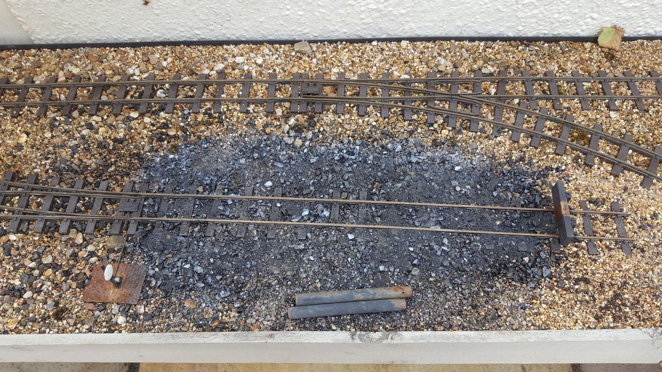

Re: RWLR - Robin Wood Light Railway
Post by tom_tom_go » Sat Aug 18, 2018 3:46 pm
Photo of second test patch straight after applying SBR neat from a spray bottle (I do not use as much this time, is this the amount you guys apply by looking at the picture?):
This is now covered and I will leave it alone!
Post by Peter Butler » Sat Aug 18, 2018 4:10 pm
Difficult to tell from the picture but well done for persevering. The trouble with using a spray is evident from the amount all over the sleepers etc... I always drip it on from a plastic container...(I have mentioned this before)..... avoiding the sleepers. 'Evo-stik' container is good for this. (other containers are available!)
When yours is dry it will be necessary to peel off the SBR from the sleepers as they will probably remain shiny.
Post by tom_tom_go » Sat Aug 18, 2018 4:15 pm
So using a pipet like I use to use for OO scale ballasting would be better?
I spent half hour trying to clear the spray bottle as it didn't work as well!

Post by philipy » Sat Aug 18, 2018 4:33 pm
Your picture looks about like mine after spraying, although as Peter said, it's difficult to be sure.
Peter is also correct about needing to get it off the sleepers ( and rails). A quick wipe with a J-cloth is all I do to the worst affected ones. If not, wait until it dries to the rubbery stage and you can peel it off.
Post by tom_tom_go » Sat Aug 18, 2018 4:46 pm
I did wipe the rails with a wet cloth and have now done the same with the sleepers although I reckon they will need the latex cover picking off when dry as I did not wipe them straight after applying the SBR. Next time, I will use a pipet as well.
For now, I will leave this patch covered for a week and see what happens.
