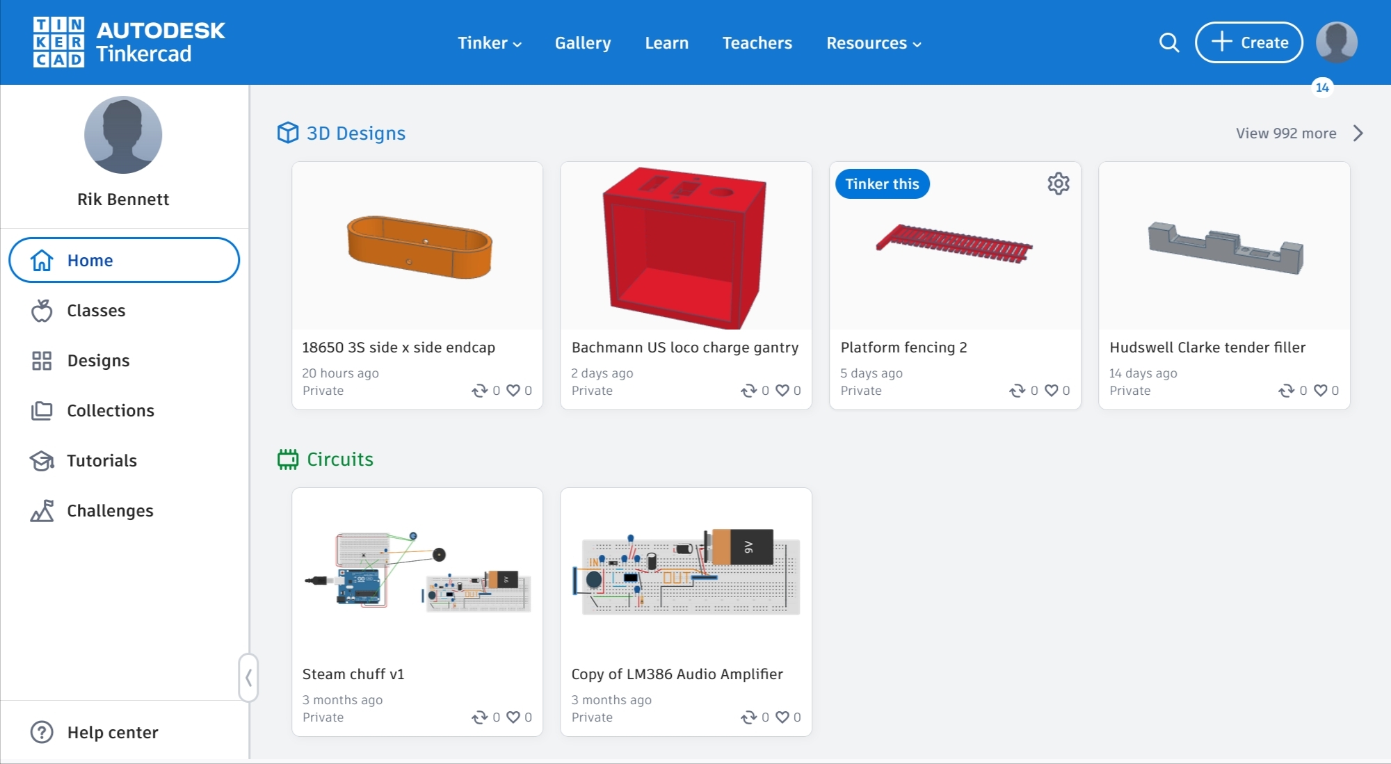

Well Tinkered is a good starting point, and buildings are made from solid boxes which are easily drawn in tinkered.
It is a good way to generate buildings and your bed size will lend itself to 16mm scale buildings
- Posts: 8052
Nothing wrong with Tinkercad. I've used it to create all my 3D printed locos, stock and accessories. As you can see, so far I've got nearly 1000 items created with Tinkercad .....nlc1072 wrote: Mon May 11, 2026 6:07 pm I am only using tinkercad at the moment, but I may move on to some other more advanced software when the time comes.

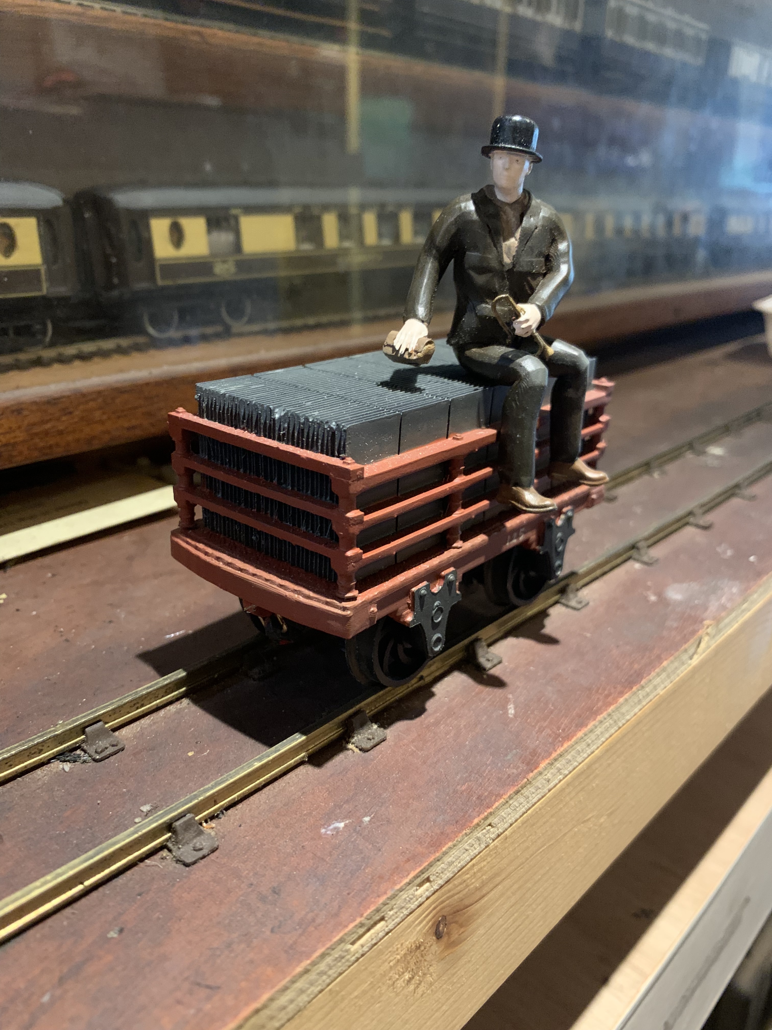

Phil and I ran some trains over the weekend.
Here is the first video taken on Saturday:
The wagon with the brakesman sitting on it is motorised. The train won't quite descend under gravity and this just allows it to make it to the bottom.
It has no speed control - it is just on or off. Fitting the driver into place closes a switch and sets it off. The train seems to work better if the motorised wagon is at the downhill end of the train. It is driven by an N20 geared motor through spur gears.
