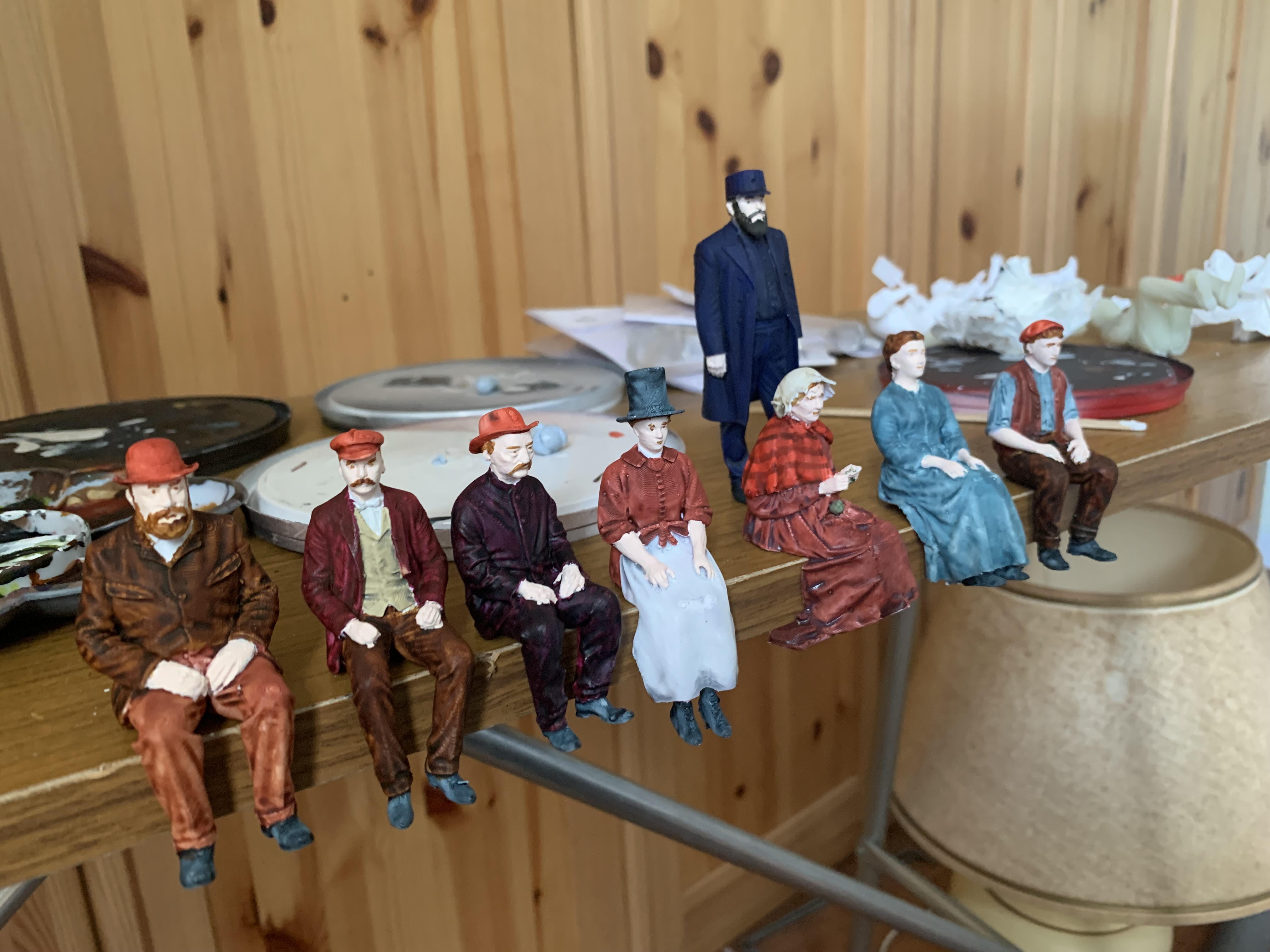

Taking this in a completely different direction, I have been printing the models I generated using "ai", from historic photographs.
My latest batch:
These are intended to sit on benches at the various stations. I am aiming for 90mm tall figures when they are standing , and something like 75 when seated, with some variation of course.
Some were resin printed, but most are from my filament printer. I can't tell the difference to be honest - so it looks like I will be getting rid of all of that resin printing equipment.
My latest batch:
- Posts: 7941
They look really good. I like the way their facial expressions have been preserved.

- Posts: 1179
- Location: South West Wales
Yes- and it isn't even the best quality it can achieve.
These were printed with a 0.4mm nozzle and a layer thickness of 0.12mm - I can go down to 0.2mm nozzle and 0.08mm layer height. The result is better but it is a lot slower. 8 figures such as I have been printing take 12 hours to print, with the best quality we are talking 40 odd hours, and I don't think the difference is worth waiting for!
