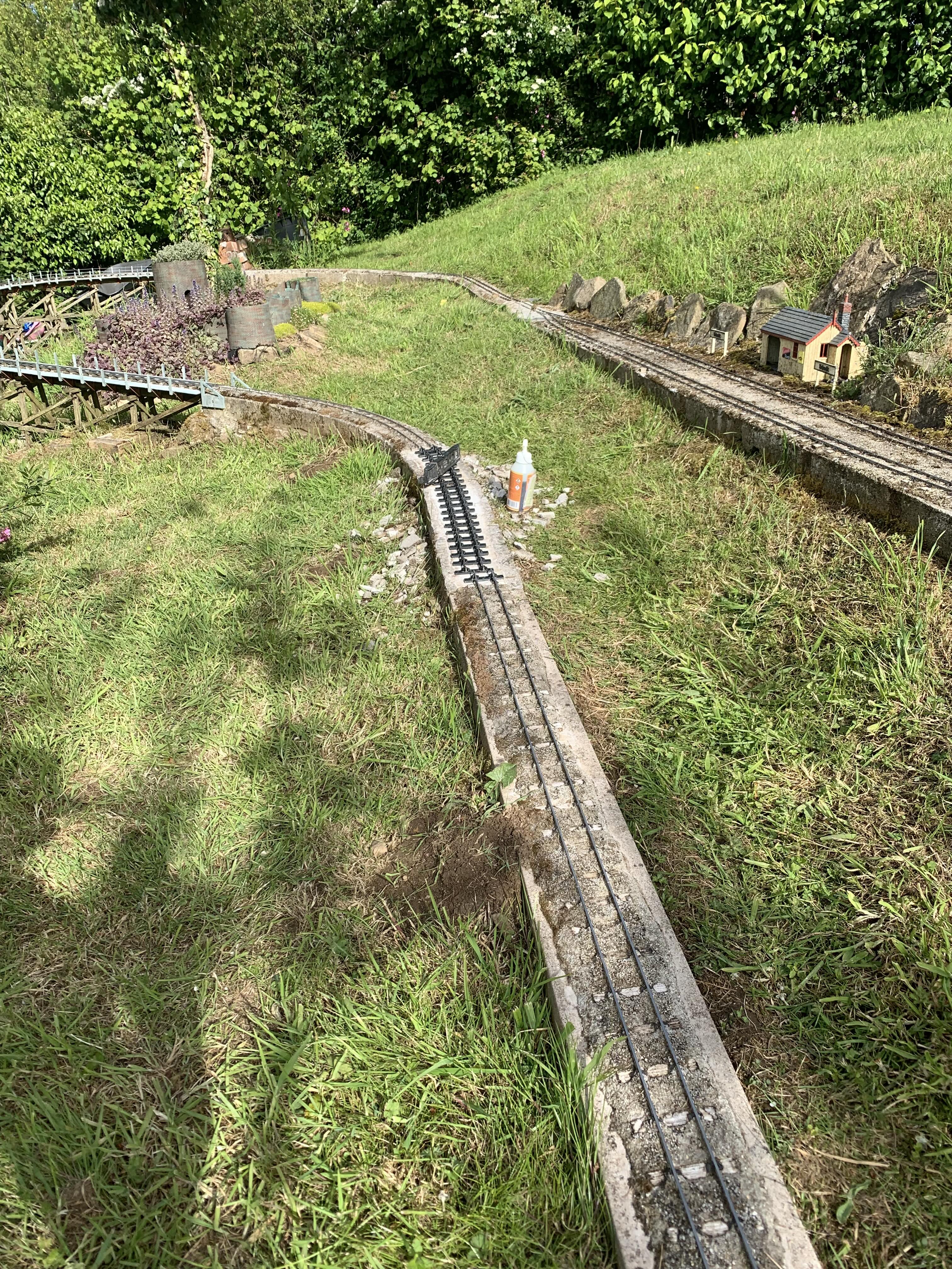

Quite a few wagons (particularly light ones) were derailing on the curve leading into the viaduct. Where I have removed a length of track in this photo:
It looked on Saturday as if there was a dip in the right hand rail in the middle of the curve where two lengths of track joined. When I looked at it again with a spirit level I could see that it wasn't a dip - but a bulge half a track length back. It just looked like a dip because that was where the wheel came off the rail. This curve has slight superelevation - purely accidental I hasten to add - but the bulge changed that for a short length to excessive superelevation.
I know that the trackbed moves as the ground dries out and gets soaked again, and this is compounded by moles. There are the remains of three mole hills visible in this photo. I think things have moved in this area because I don't remember having issues here last year.
Anyway - solution.

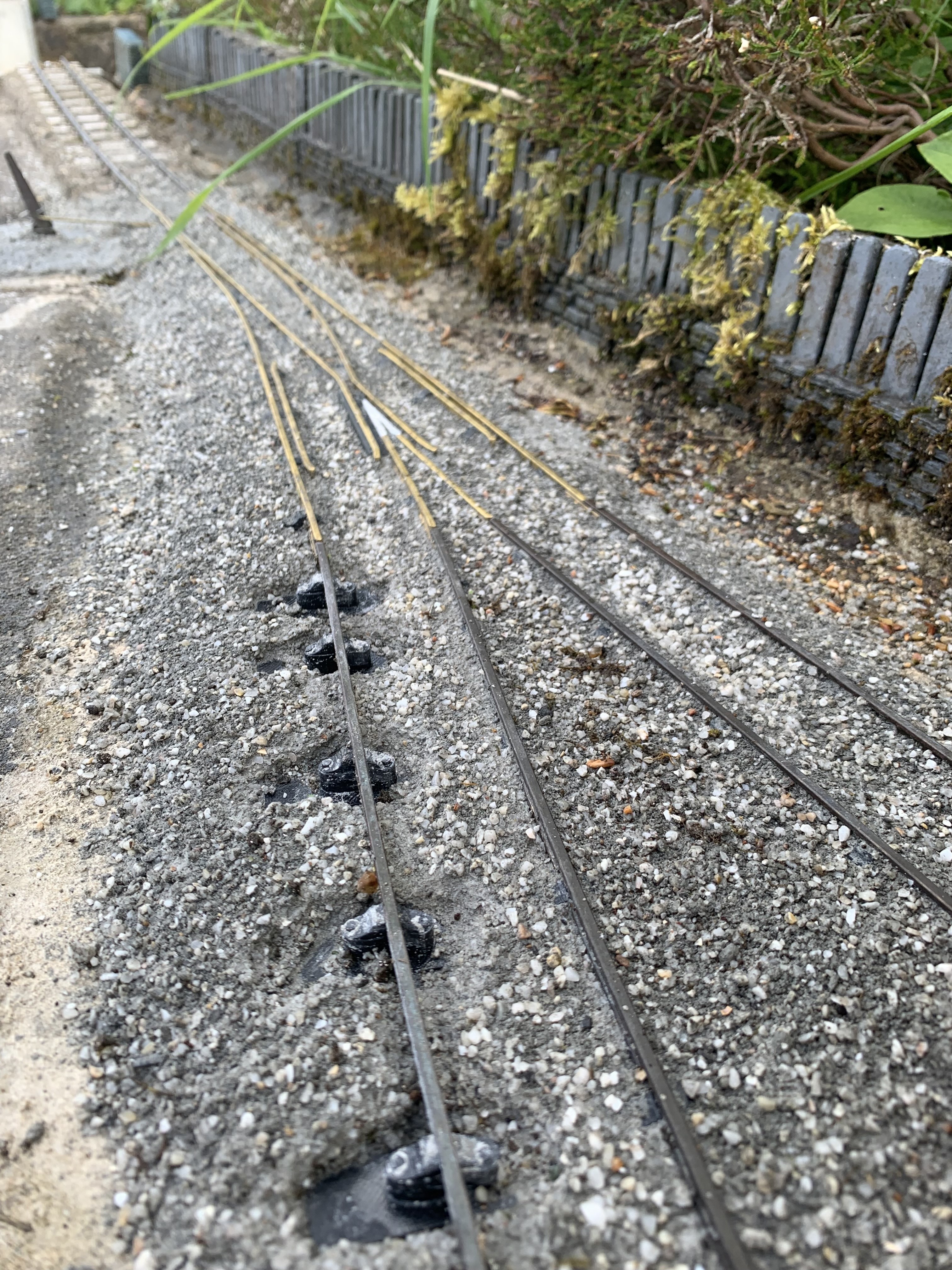

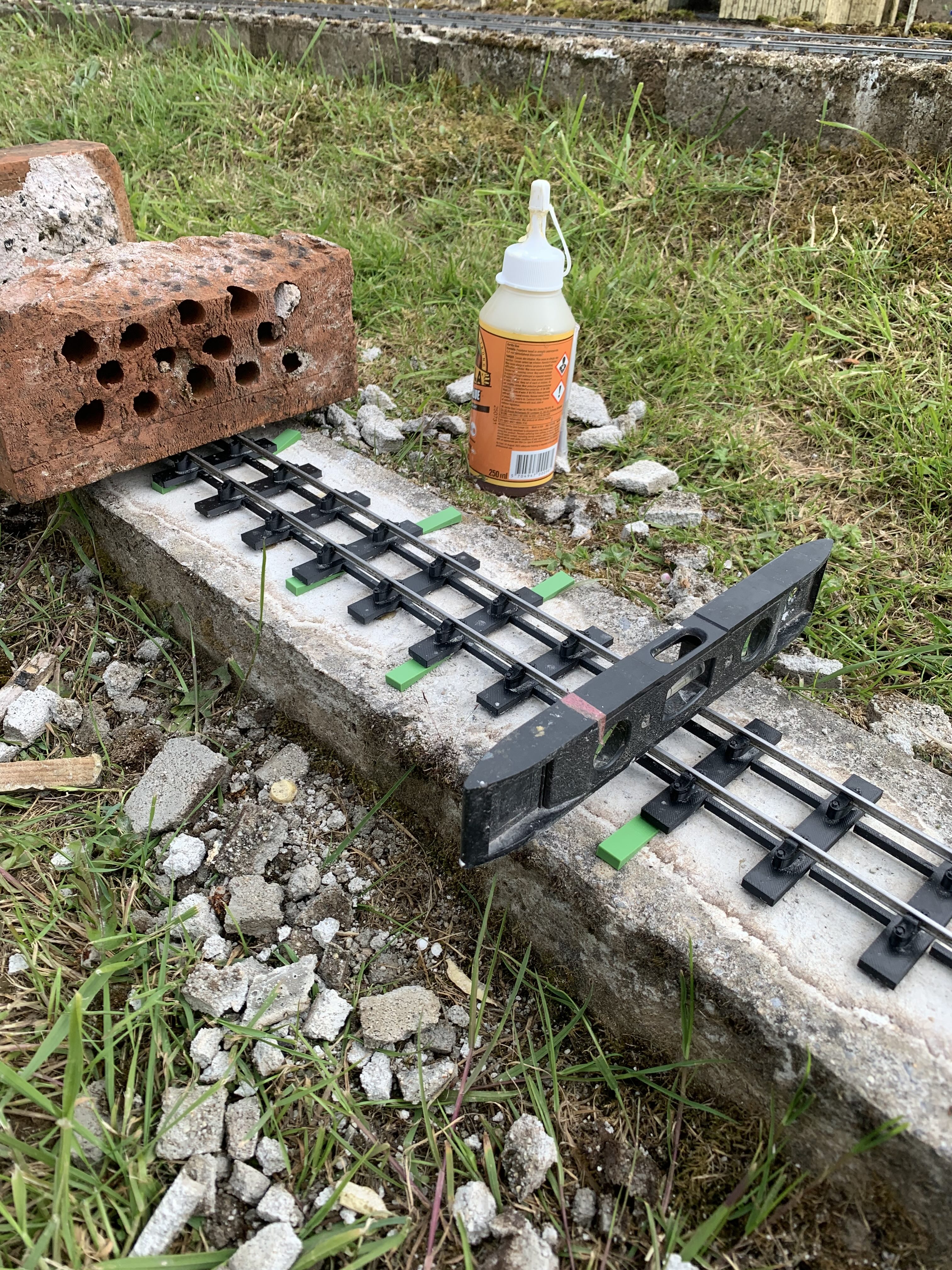

I chipped out the ballast and removed the length of track. Rather than reuse the part worn sleepers and chairs I printed 24 sleeper units. I carried out a shrinkage test on the black ABS, to ensure that the track gauge was accurate. (More about that later).
Relaying the track:
I have been careful to ensure that the slight superelevation is maintained consistently through the curve by printing wedges, and fitting them under some of the sleeper units before holding them down with my usual bricks while the glue sets. The foaming glue fills the gaps under alternate sleepers, and the bricks stop the foaming action lifting the track.

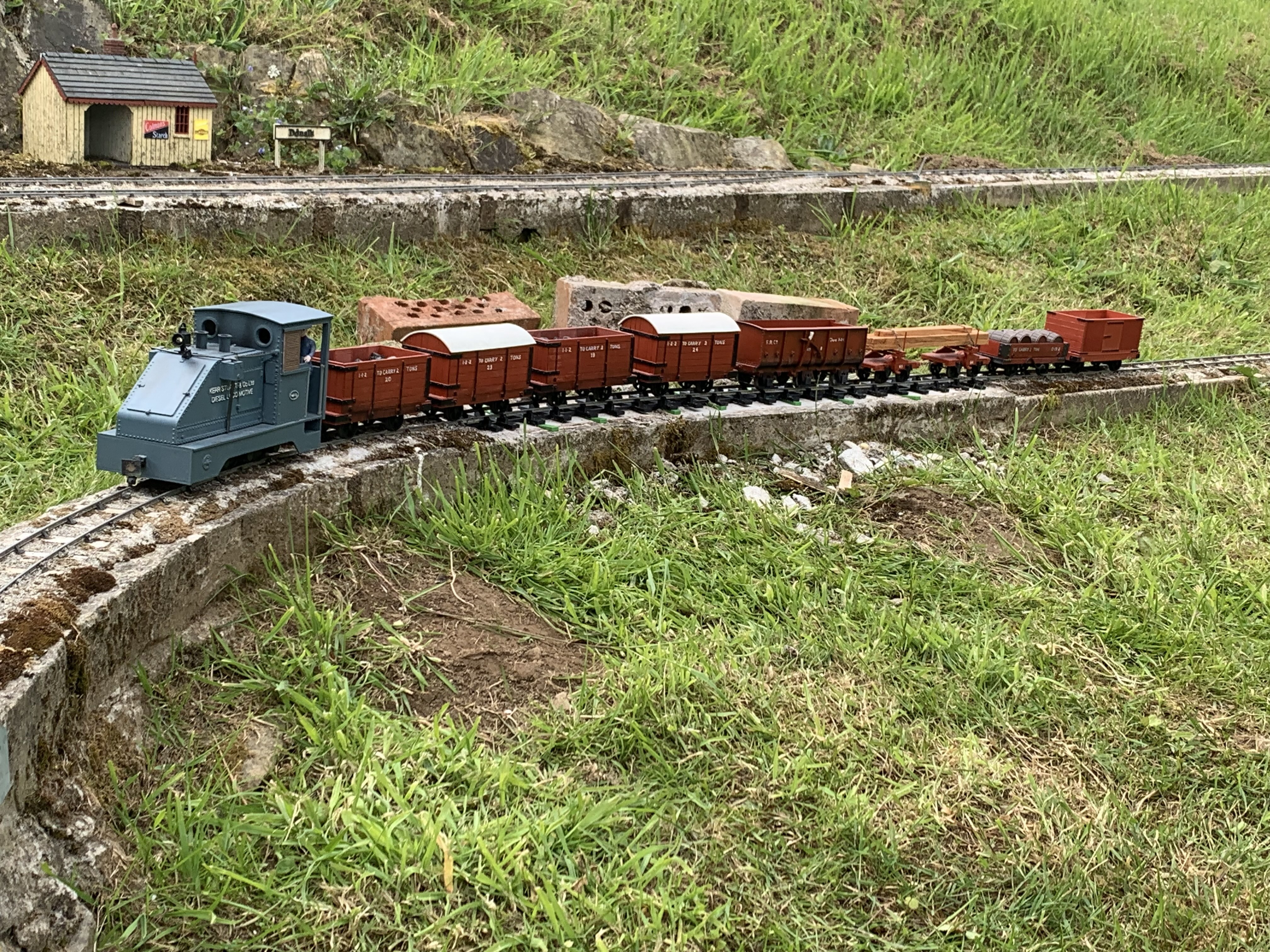

I have assembled a train which includes the wagons most likely to derail:
It includes heavy wagons alternating with light ones, and the last 3 wagons which really like to come off the track. It went round the bend with out any issues. So to the next problem.

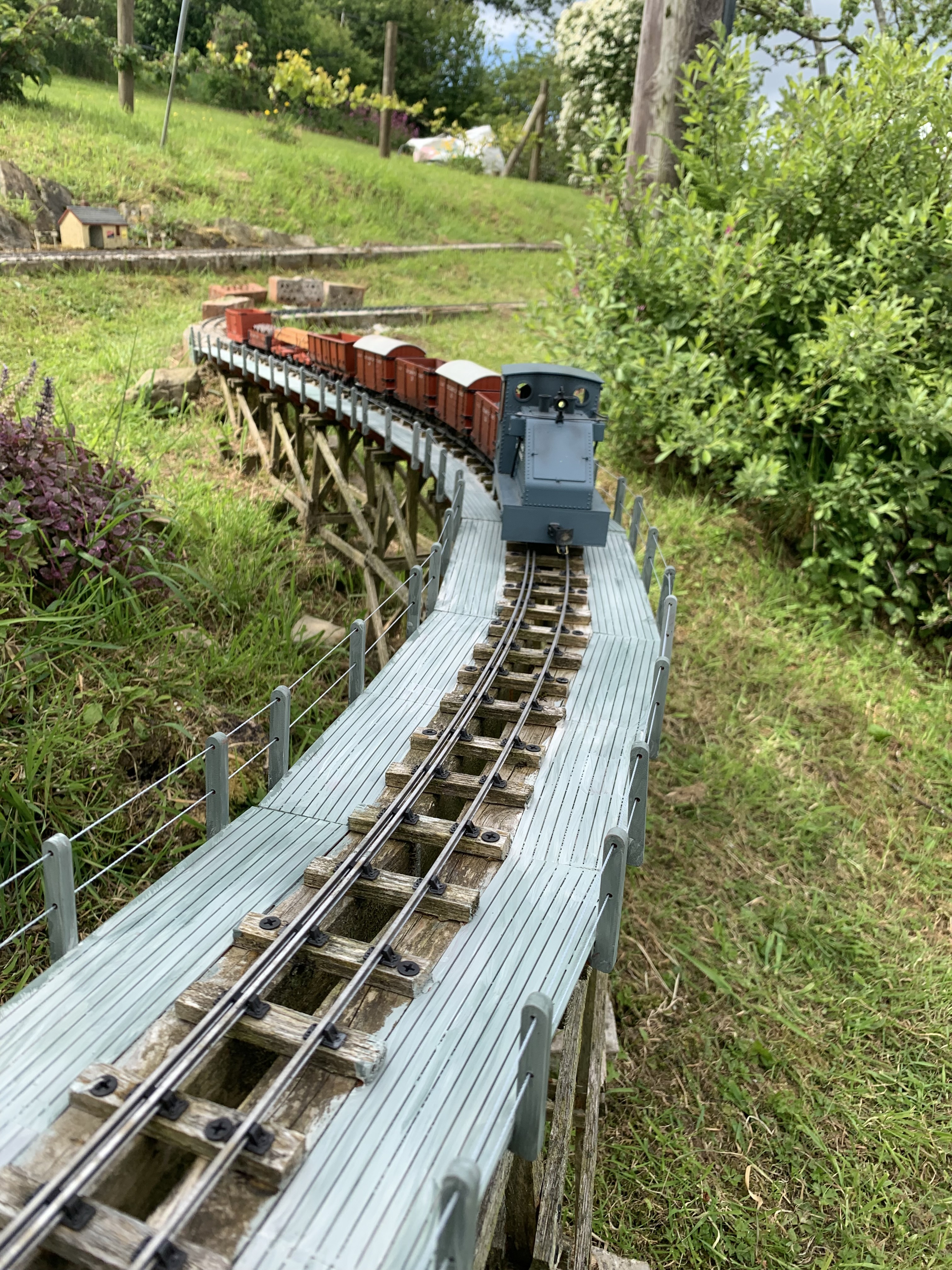

Of course the viaduct now has a finished railing all the way around it:
My visitors seemed pleased with it. Of course this is the one place that I don't have derailments!

Correction... Sorry Trevor, but I did suffer a derailment on the viaduct and had to clamber down to the lowest, or highest(?) point to re-rail my loco.
The ones you have corrected are where most users had similar issues so they should all be reassured now.
