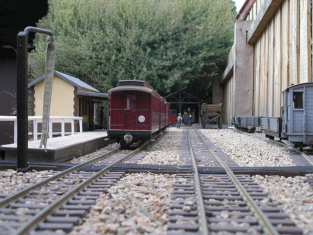

Post by LNR » Sat Mar 26, 2016 8:53 am

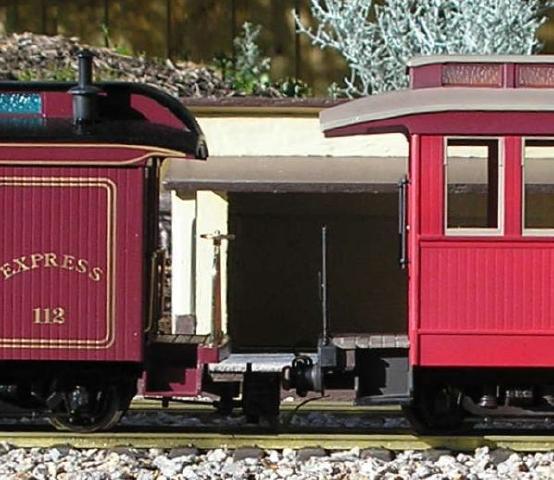

Image The Morning Passenger Service Hunslet in charge, pulling away from Leawarra in greener times.
Posts: 8052
Post by ge_rik » Sat Mar 26, 2016 9:31 am
LNR:116981 wrote:Image    The Morning Passenger Service Hunslet in charge, pulling away from Leawarra in greener times.
These must be the Jackson Sharps you mentioned. Have you raised their height?
Posts: 1905
Post by LNR » Sat Mar 26, 2016 11:11 am
Yes Ric, raised them by about 15mm if I remember correctly. Many of our pass cars were repaired along the bottom edges with tin sheathing (well that's my excuse and I'm sticking to it!) also lengthened the end platforms and new railings, cut the clerestory short, and changed bogie spacing and end doors. The pic. shows a visiting Jackson Sharpe coupled to one of mine showing the difference.
After building my first loco I needed pass cars quickly as you do when starting off, and these got me a train for the first GSSU.

Post by ge_rik » Sun Mar 27, 2016 9:15 am
LNR:116985 wrote:Yes Ric, raised them by about 15mm if I remember correctly. Many of our pass cars were repaired along the bottom edges with tin sheathing (well that's my excuse and I'm sticking to it!) also lengthened the end platforms and new railings, cut the clerestory short, and changed bogie spacing and end doors. The pic. shows a visiting Jackson Sharpe coupled to one of mine showing the difference.
A neat mod. Also, it's quite remarkable how lengthening the balcony and shortening the clerestory makes so much difference.

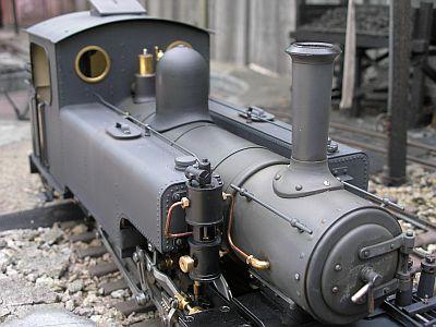

Post by LNR » Mon Mar 28, 2016 8:16 am

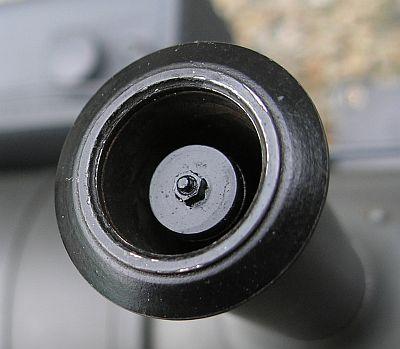

Have you had one of those days where everything just goes right! Well I've just had one :lol: :lol: :lol: :lol: I've been experimenting with the front end of my Bagnall. I'ts always been a wet engine, so I decided to experiment with a chuffer, not to make the chuff louder, but more to re-direct the wet and oily part of the exhaust.
After quite a few tries I achieved a good combination of sound with minimum loss of power ( it actually appears to have broadened the torque band ) etched and painted it on Saturday and have been dying to try it.
So today I made up a heavy train and had a perfect run. The engine shunts really well, and even after a short station stop, is totally oil and water free. No more constantly wiping it down. I'd washed the engine in preparation for this run, and it's totally clean after a morning and an afternoon run. Very happy :lol: :lol: :lol:

...and yet you offer no actual proof that this really happened.
Posts: 1905
Post by LNR » Mon Mar 28, 2016 10:54 pm
Sorry I was enjoying it too much to take a photo. Besides a black thing in a black hole doesn't make a great photo.
Posts: 1905
Post by LNR » Tue Mar 29, 2016 5:59 am
PROOF!
Just for you Keith, blowing a bit of a gale but I steamed up the loco again today. Lighter train, but once again no mess. Don't know
if this shows it "no mess Charlie"
Image Image
Like I said, black thing in a black hole.
After running bunker first back to Leawarra, the smokebox and frontplate would usually be spattered with fine oil and water. :lol: :lol:

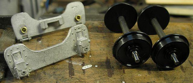

Bit of time spent on the lathe this afternoon yielded 16 axle bushes, to start putting together two pairs of Fox Trucks.
Have to make up the bolsters next, then prime and paint. Then it's on to underframes.

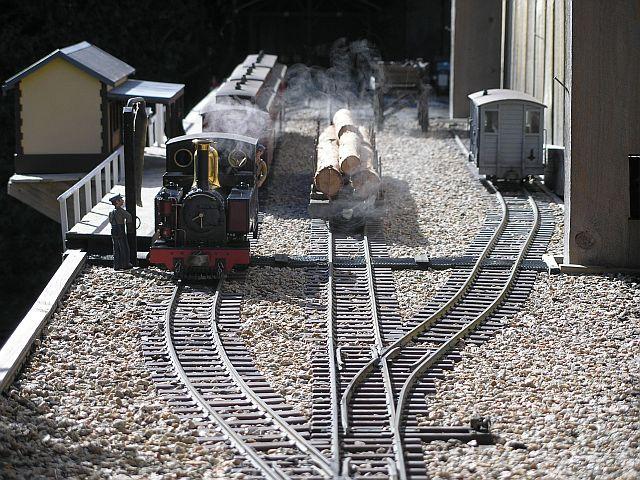

The afternoon Pass. has been made up, and the Hunslet is about to top up with water before coupling up and heading off to Nayook
Later the same day, the pass. has returned, locos on shed, and all is quiet in the afternoon sunshine at Leawarra.
