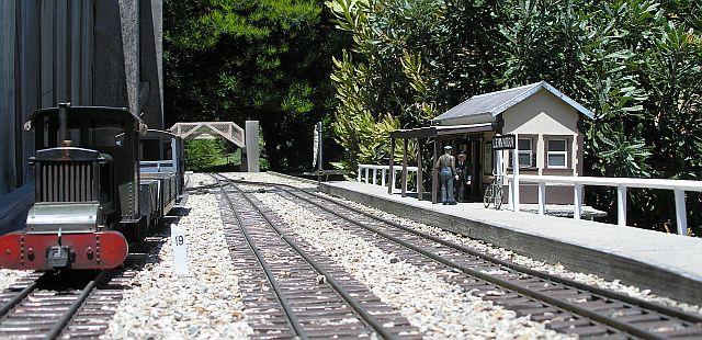

To this end my railway is not long, containing only two main stations and a small halt, allowing the taking of photographs without having other tracks in the background. If I could only remove fences, life would indeed be good.  I gain a sense of distance by running three laps of the track, after leaving the main station of Leawarra,(Mile post 19) to arrive at the halt, Warringine,(MP 32) followed by another three laps to arrive at the ‘terminus’ of Nayook.(MP 38)
Traffic consists of passengers, general goods, and timber out of Warringine, but because of a trailing siding, it is forwarded via Nayook anyway.
Grant (LNR)
Mile post 19 in the middle of Leawarra yard. (to the right of buffer beam)
Mile post 38 opposite the crew room at Nayook.

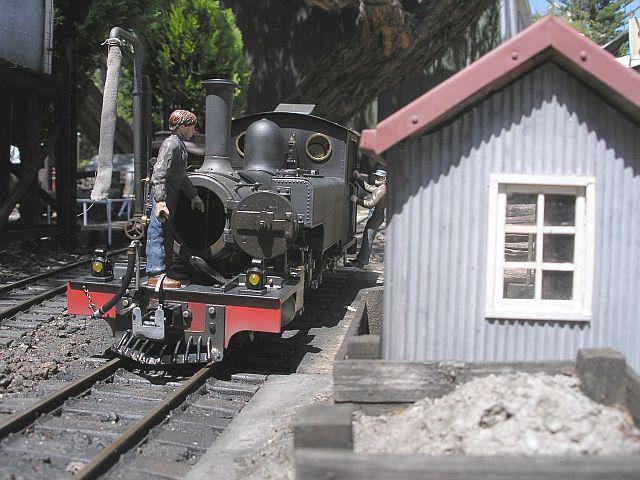

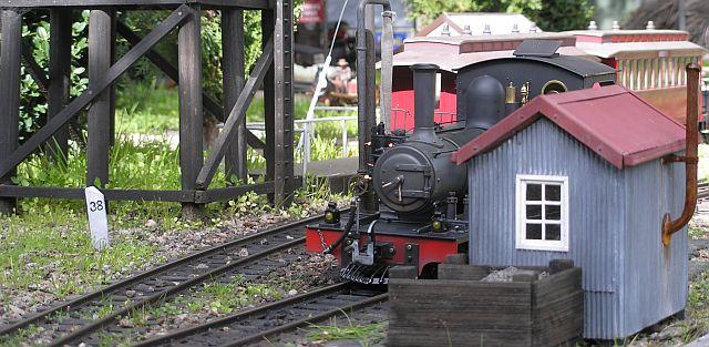

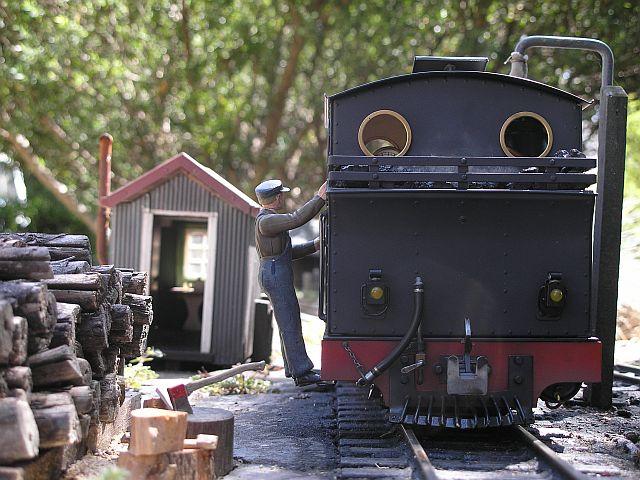

Loco Requirements at Nayook, smokebox ash removal and a top up with water.
Image Image

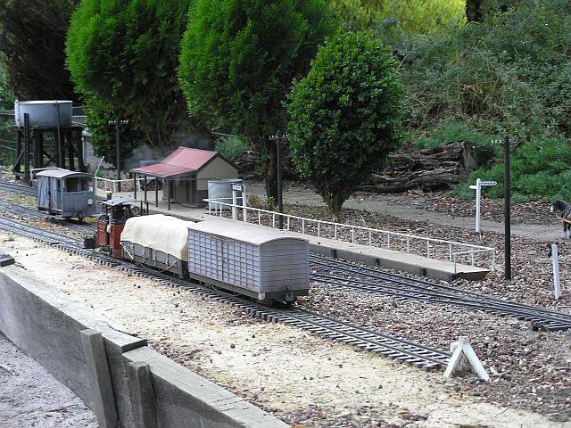

After the morning mixed has been made up ready for a return bunker first to Leawarra.
It's getting too hot outside these last couple of days. One train does me in, roll on Autumn.

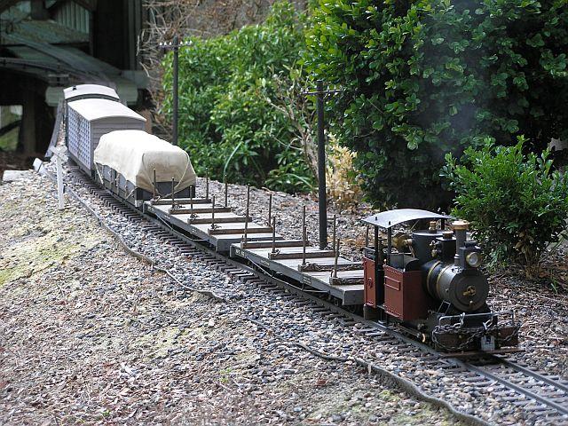

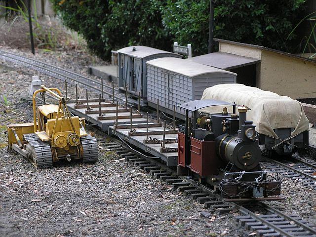

Well it rained here all yesterday, but today before the humidity got up too much, I steamed the Lumberjack on a goods train.
And because it was cooler I had visible steam, (not by British standards I know!) if you look very closely.
Two log empties for Warringine.
And two general goods for Nayook.(Note steam, you had to be quick!!)

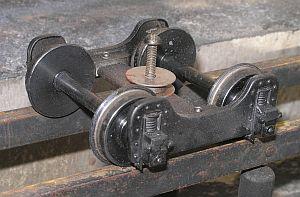

The goods stock and guards van are all scratch built, mostly on fox truck type bogies, with chopper couplings. The bogie log trucks have silver soldered steel archbars, and timber frames.
 My early builds in this scale tended to be belts and braces style. I had doubts (soon dispelled) about whitemetal from a strength point of view. I've adopted a standard underframe now, of aluminium angle, with timber bodies.
 I do have three pass. cars much modified from Bachmann Jackson Sharp cars. They appear in an earlier pic.

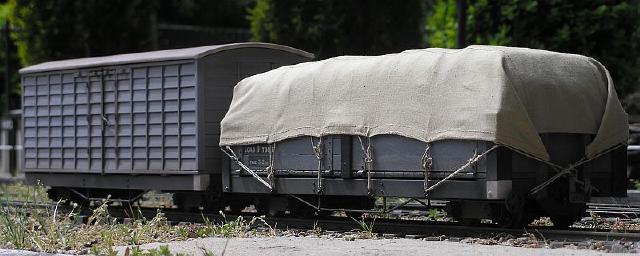

 The louvre van was made by using an adaption of a fence and table I made that screws to my router. It's what I use to turn a 3/4' thick board into a weatherboard wall as seen on two of the buildings at Nayook. The fence runs off the preceding board, so I can get a bit of sag if I want. Vertical channels sawn in for the vertical battens on the sides of the van. Door hardware and so on.
Image  Image
 The open wagon, one of two, has opening and removeable sides, and ends, a foam load with a tarp from khaki material, tied with sixteen scale sheep shank knots tied with tweezers. As I've said elsewhere, you don't have to be mad, but it helps.
