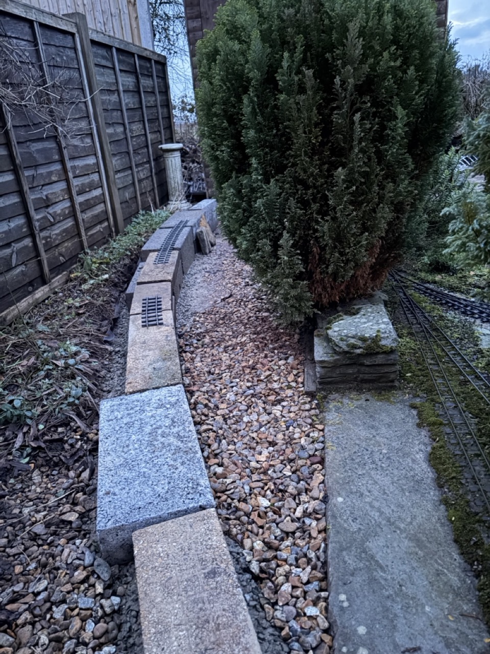

I've been very busy in the garden over the past six months. I caught the Garden Railway bug badly over the winter and decided it would be a good idea to spend all my cash on blocks, sand, cement and track!
The Ffestiniog has influenced the line greatly, so I plan for most of the railway to run on a dry-stone structure that twists and drops to accommodate the landscape. The current setup has always felt to me as though it was missing the drama of some serious civil engineering, so I decided to include an interpretation of Cei Mawr — the 60-foot-high stone embankment. https://www.festipedia.org.uk/wiki/Cei_Mawr
Here is my attempt, nearly complete:
IMG_4596 Large.jpeg (396.75 KiB) Viewed 576 times

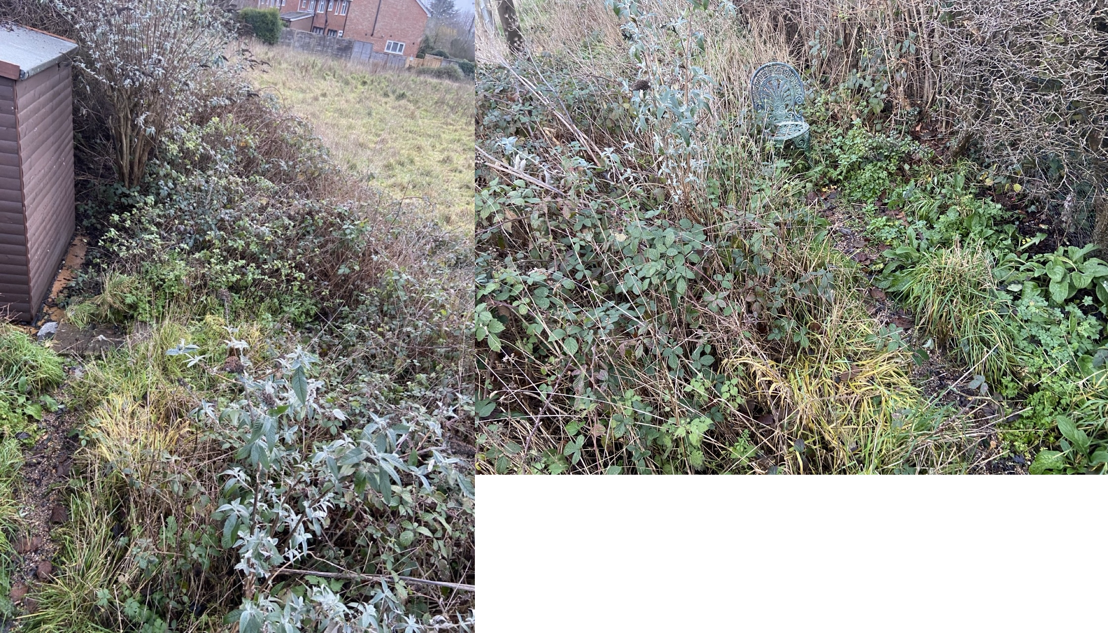

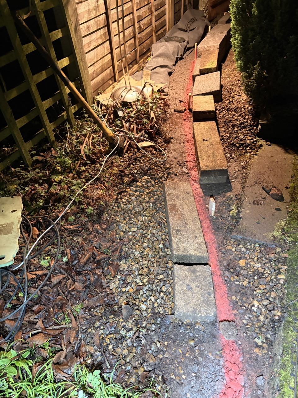

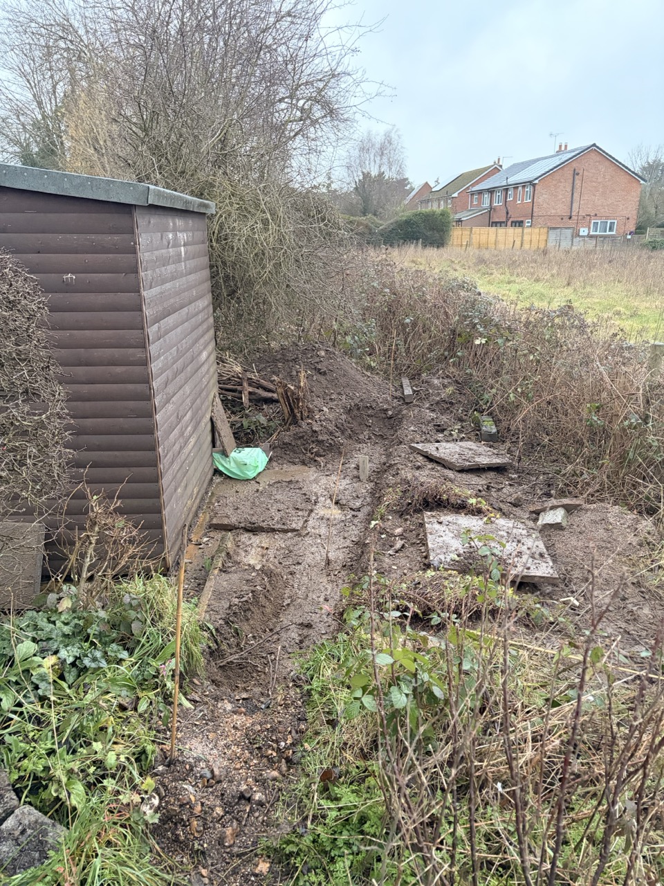

The first challenge was to tame the jungle that had been left to grow for years.
Here is the site - a lot of bramble roots:
A Mess was made. Aerosols were useful for marking out.
step 1.jpg (1.72 MiB) Viewed 444 times

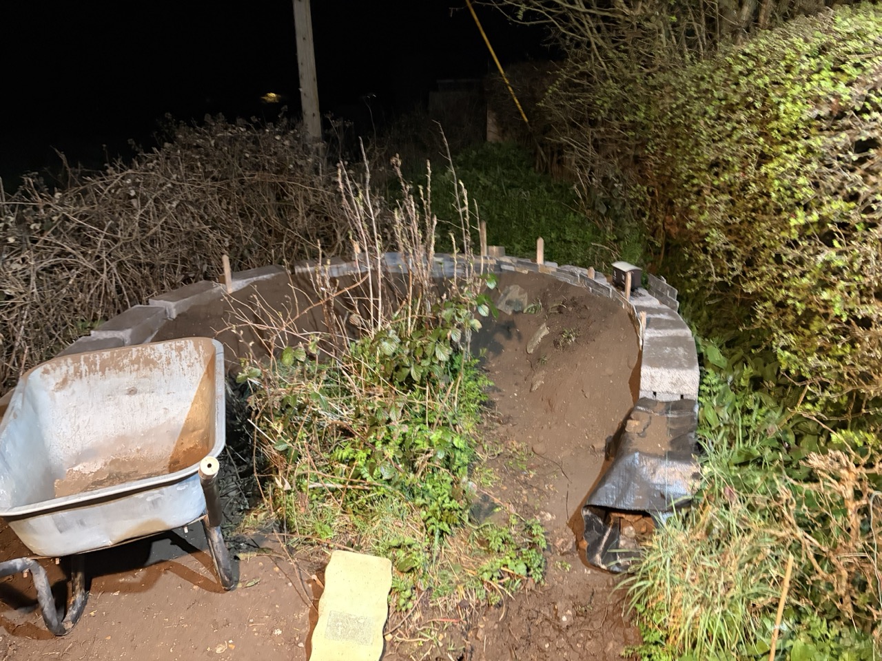

The Mud got worse. Digging is not that much fun.
IMG_3754 Large.jpeg (608.72 KiB) Viewed 444 times

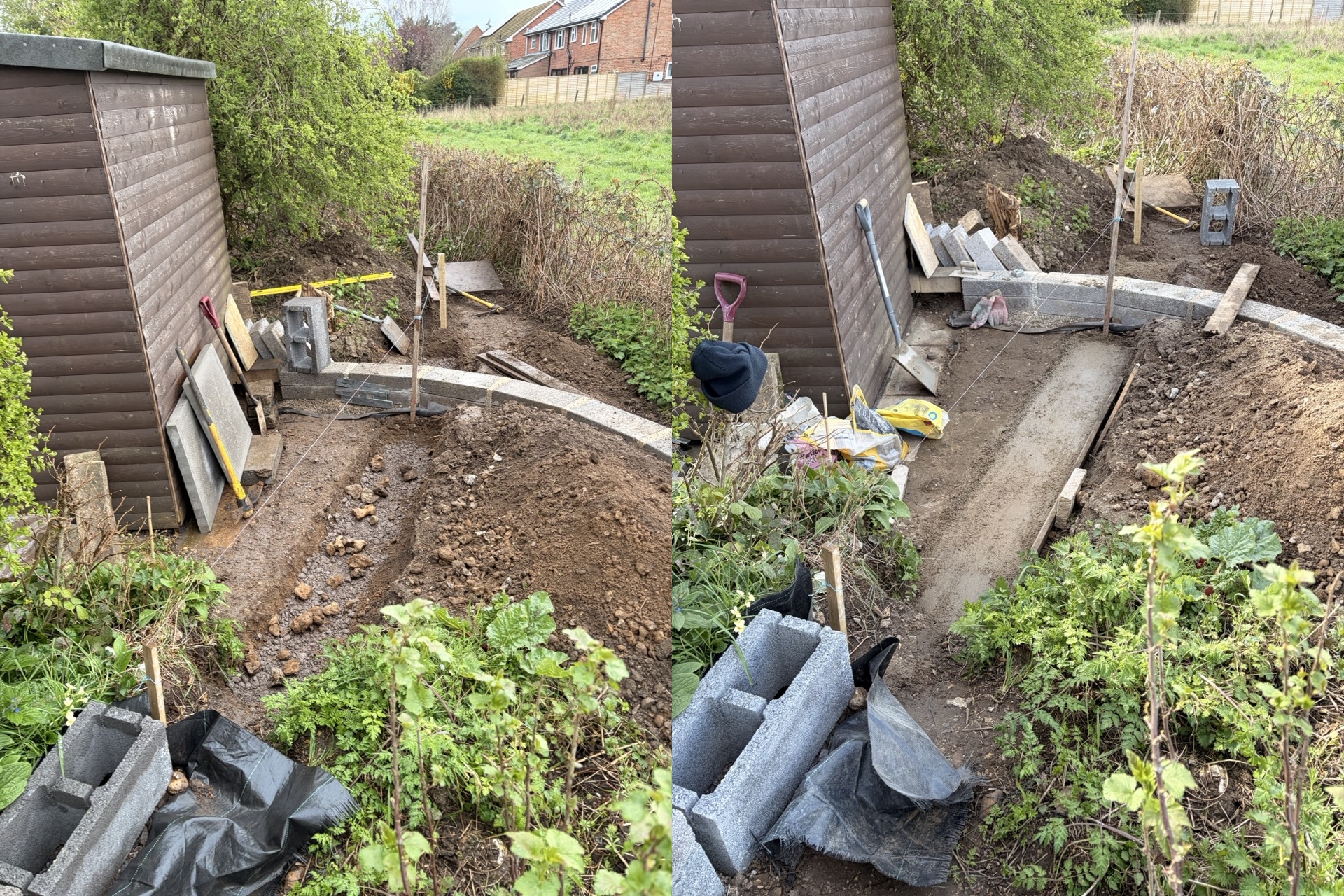

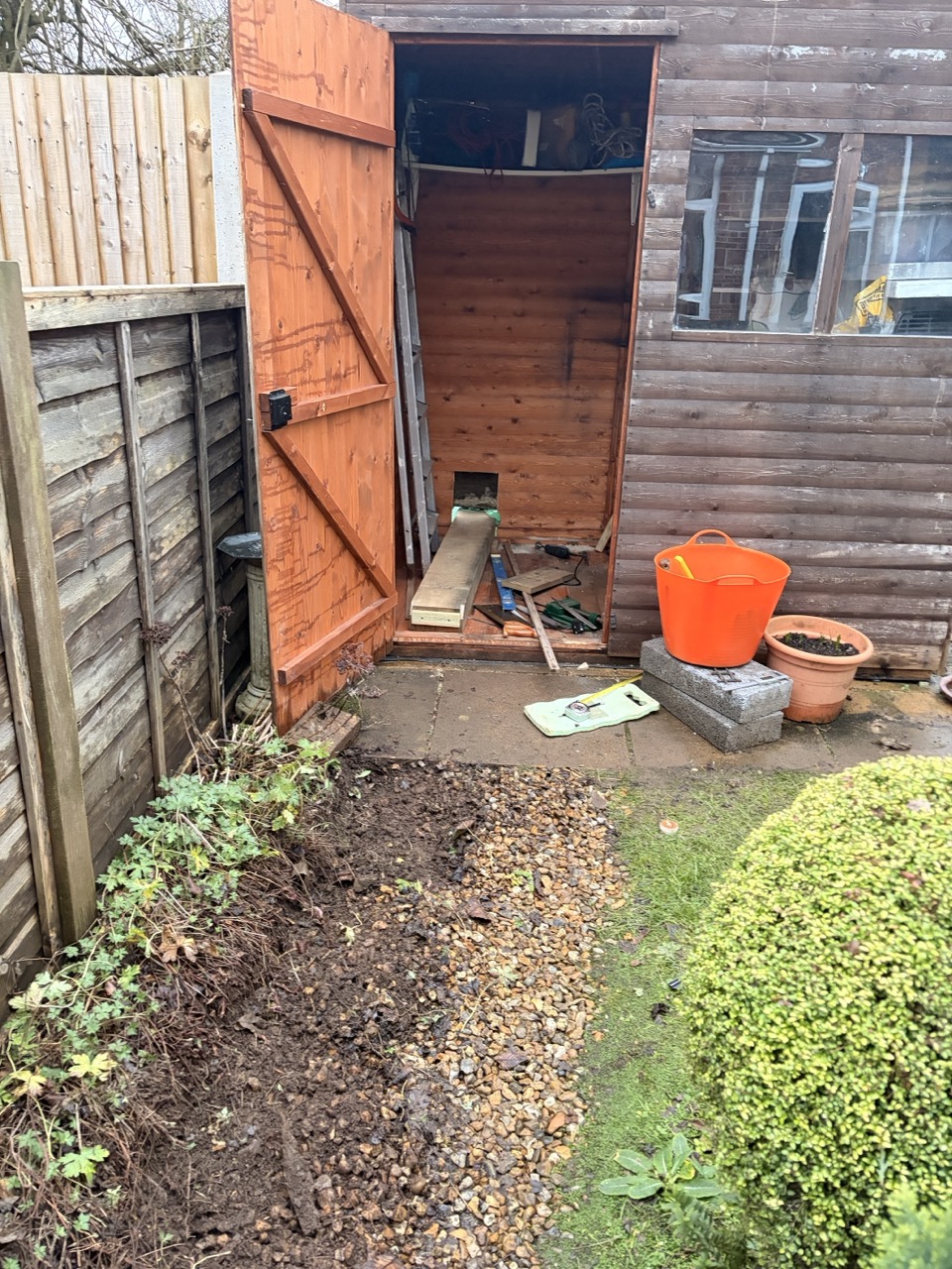

Having made a start behind the shed, I turned my attention to the first section that would connect to the existing railway.
I proudly cut a hole in the shed. The Oak sleeper will carry the track bed. There will be a removable bridge for the shed door.
IMG_3753 Large.jpeg (527.83 KiB) Viewed 378 times

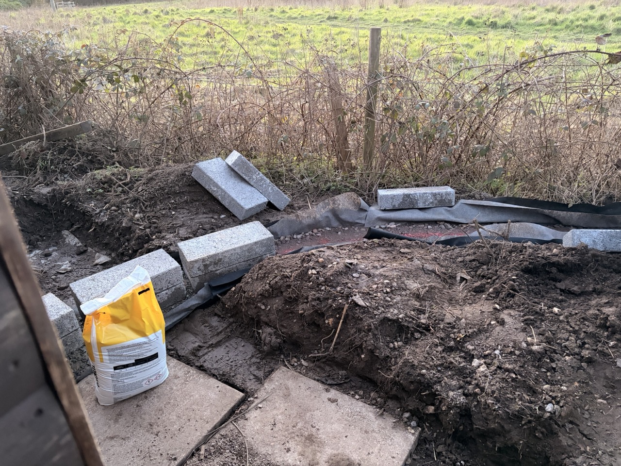

The blocks here will sit on the existing hardcore foundation from the gravel path. As it gets dark here by 4 pm in February, most of the work had to be carried out after hours by candlelight.
Stakes were used to get the 1:37.
IMG_3811 Large.jpeg (610.64 KiB) Viewed 378 times

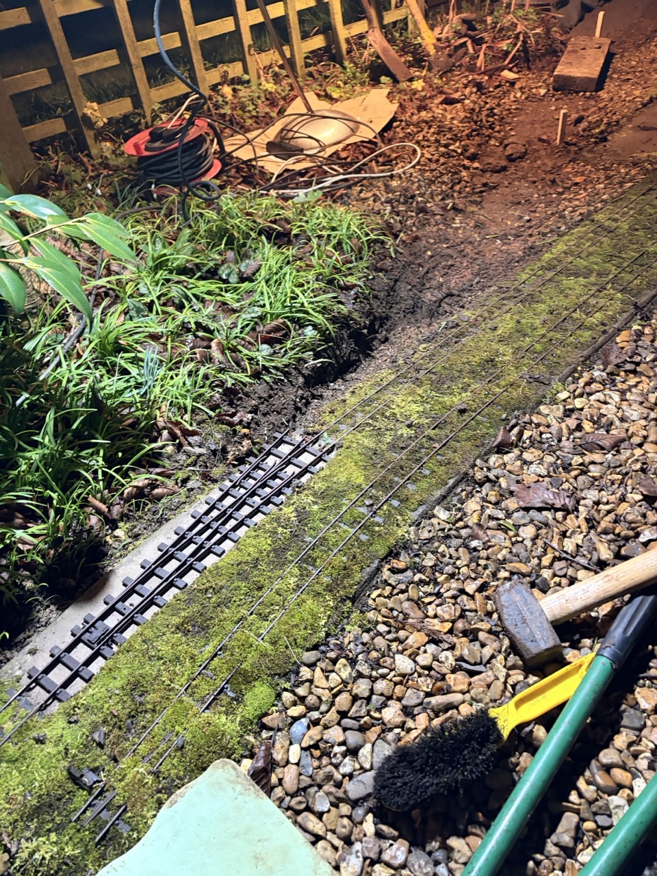

Point in.
It was a shame to remove the moss - hopefully it will grow back once ballasted.
IMG_3797 Large.jpeg (629.36 KiB) Viewed 378 times

...Continuing on from last time.

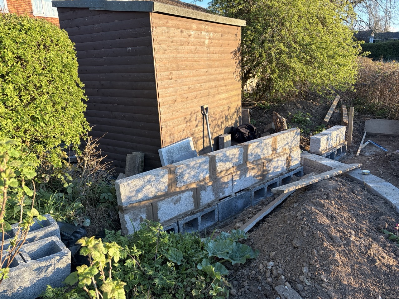

Blocks laid up to the shed:
IMG_3857 Large.jpeg (516.69 KiB) Viewed 310 times

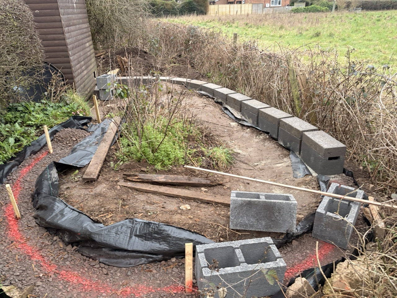

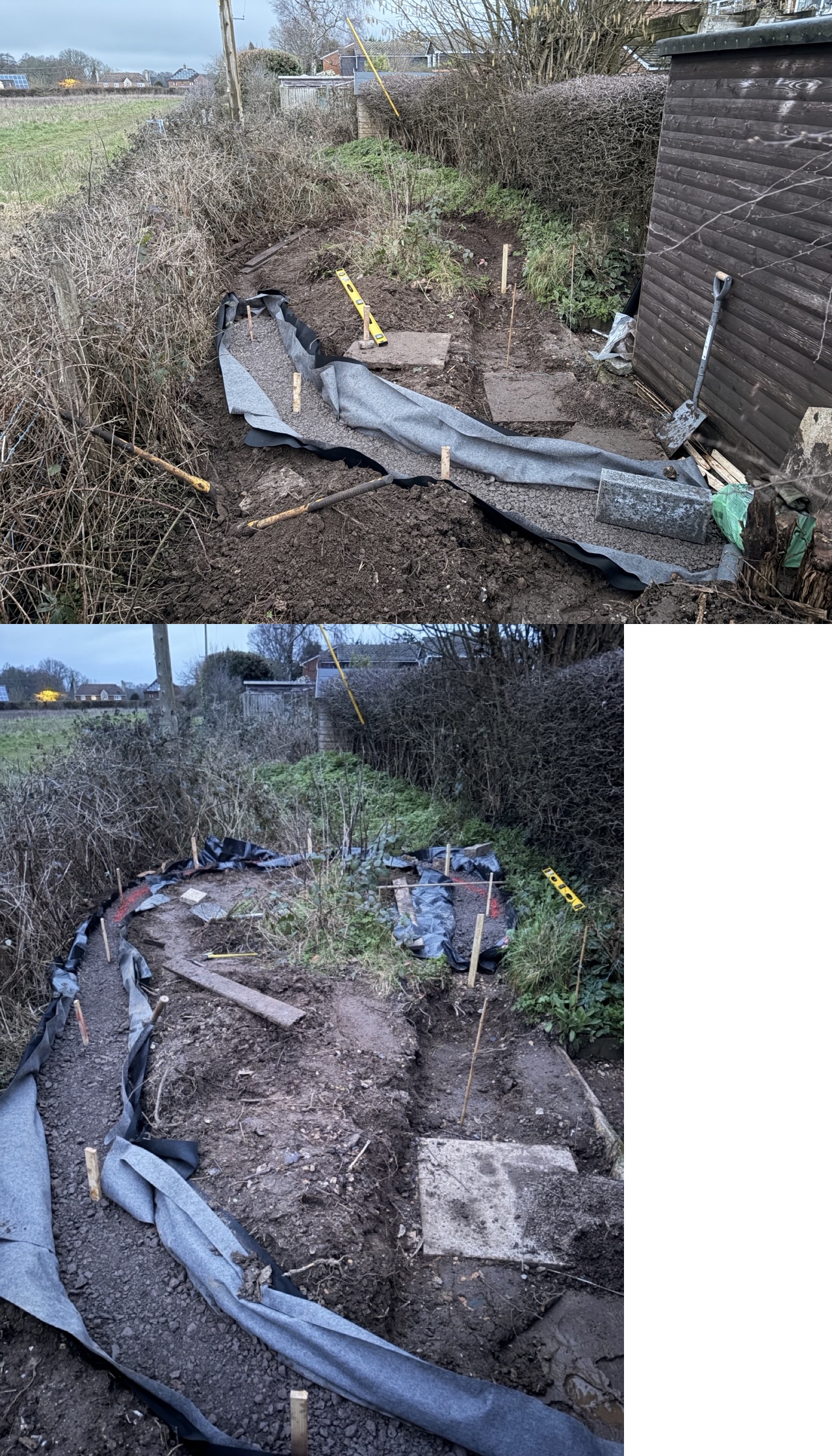

Work could now return to behind the Shed.
A trench was dug, groundsheet placed and then filled with Hardcore.
This was levelled to the nearest inch before compacting.
Carrying blocks gets quite repetitive
Signs of a railway appear at last! The first block has been laid behind the shed.

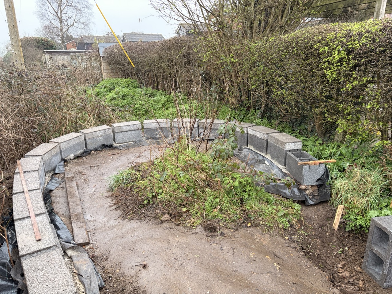

Post by steamgeorge » Fri Sep 11, 2026 12:07 am

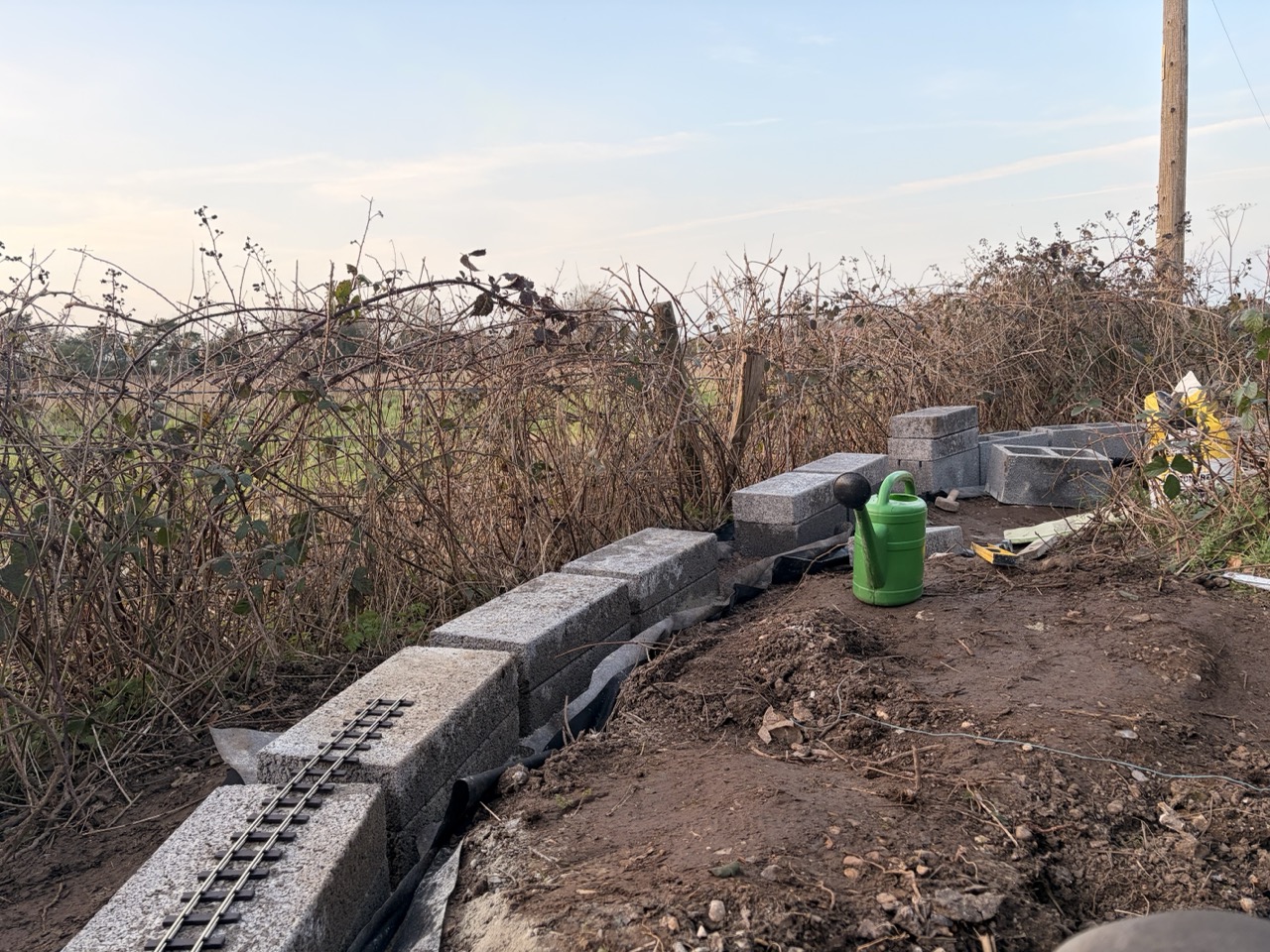

Post mix is very useful for laying blocks. You have plenty of time to make sure the block is exactly level before watering it in - unlike mortar.
IMG_3978 Large.jpeg (593.1 KiB) Viewed 305 times
I have stacked the blocks in doubles rather than like a typical wall on purpose. My theory is, when the ground inevitably shifts or a tree root gets underneath, individual blocks can be relevelled with much less destruction to the rest of the track. Lets hope I don't have to do much of that in the future!
IMG_3987 Large.jpeg (486.09 KiB) Viewed 305 times
Progress is good!
IMG_3992 Large.jpeg (564.6 KiB) Viewed 305 times
more to come...

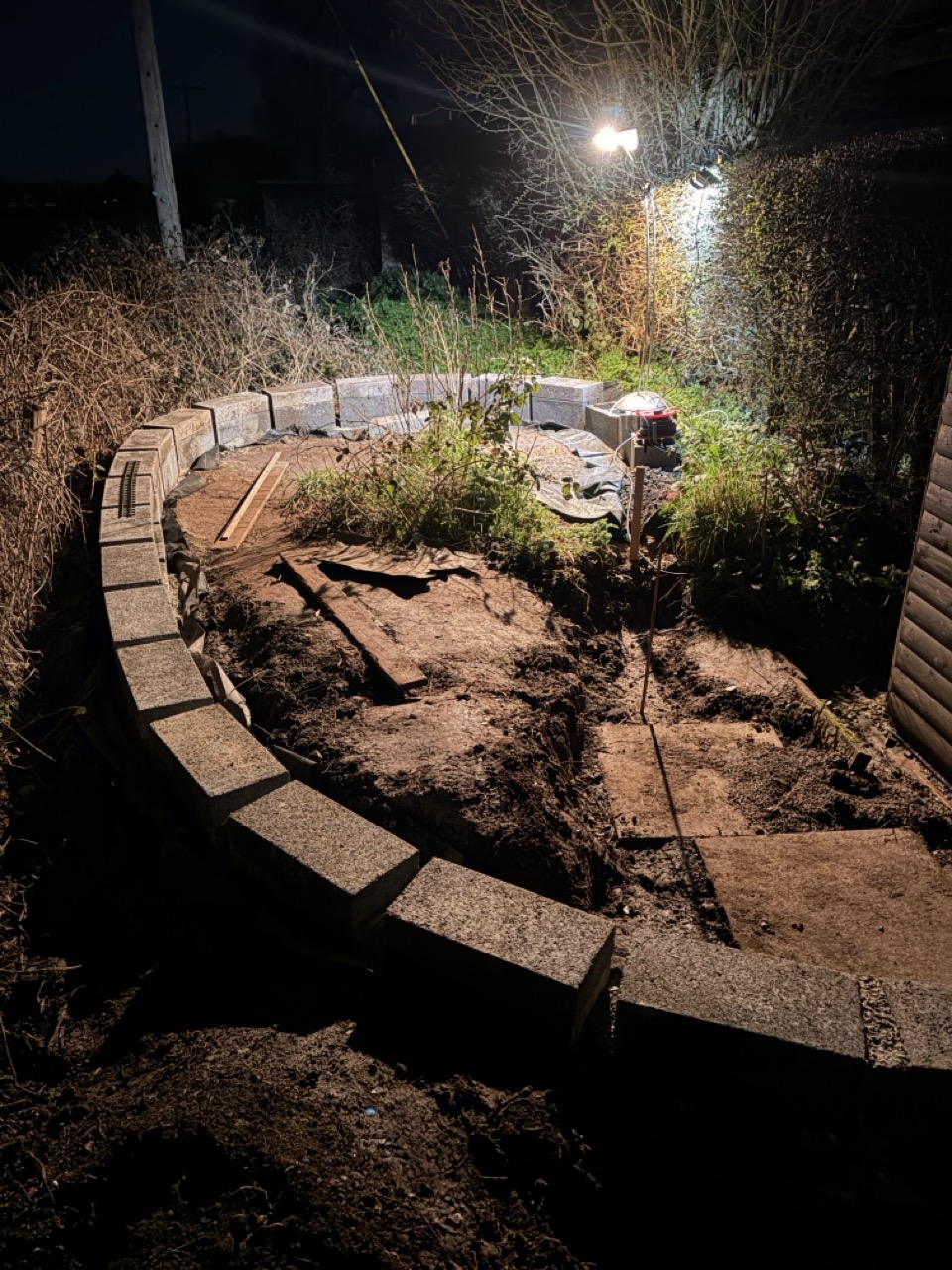

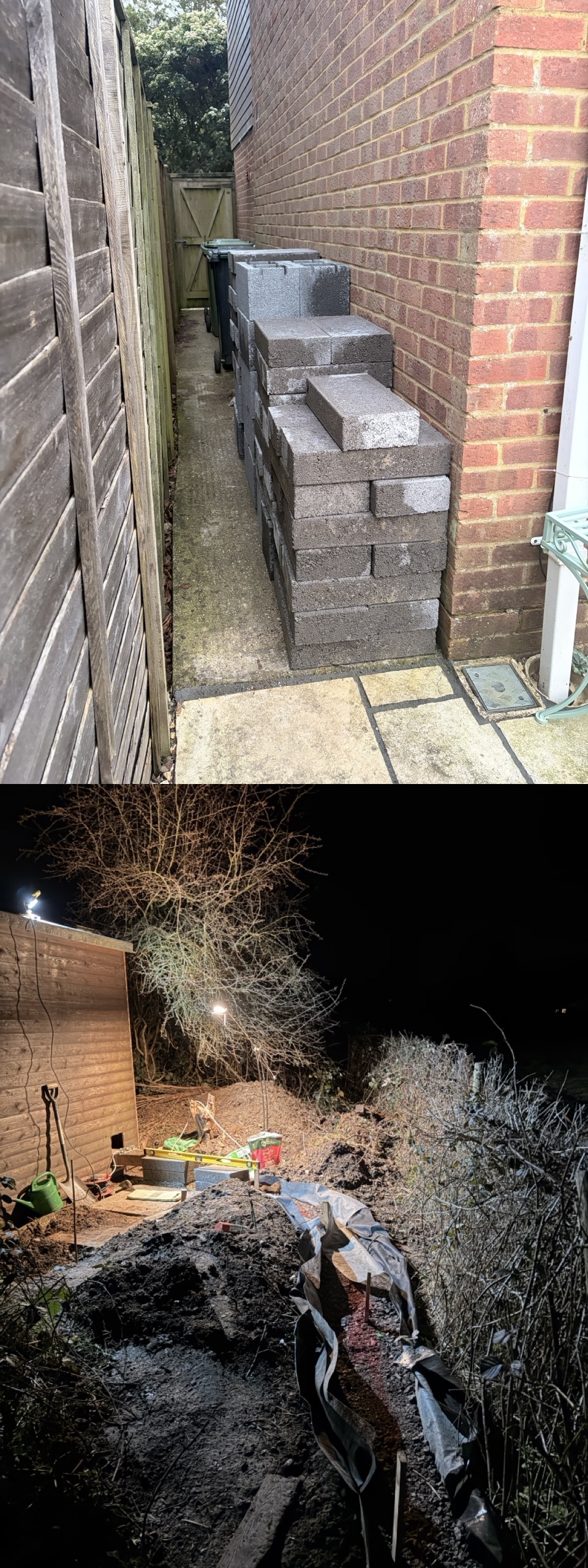

The build continues:
The neighbours must be very confused - more block laying in the dark.
IMG_4007 Large.jpeg (424.01 KiB) Viewed 165 times
All the blocks laid before the next phase.
IMG_4027 Large.jpeg (658.72 KiB) Viewed 165 times
Starting to put soil back. You need twice as much as you think!
IMG_4047 Large.jpeg (484.25 KiB) Viewed 165 times

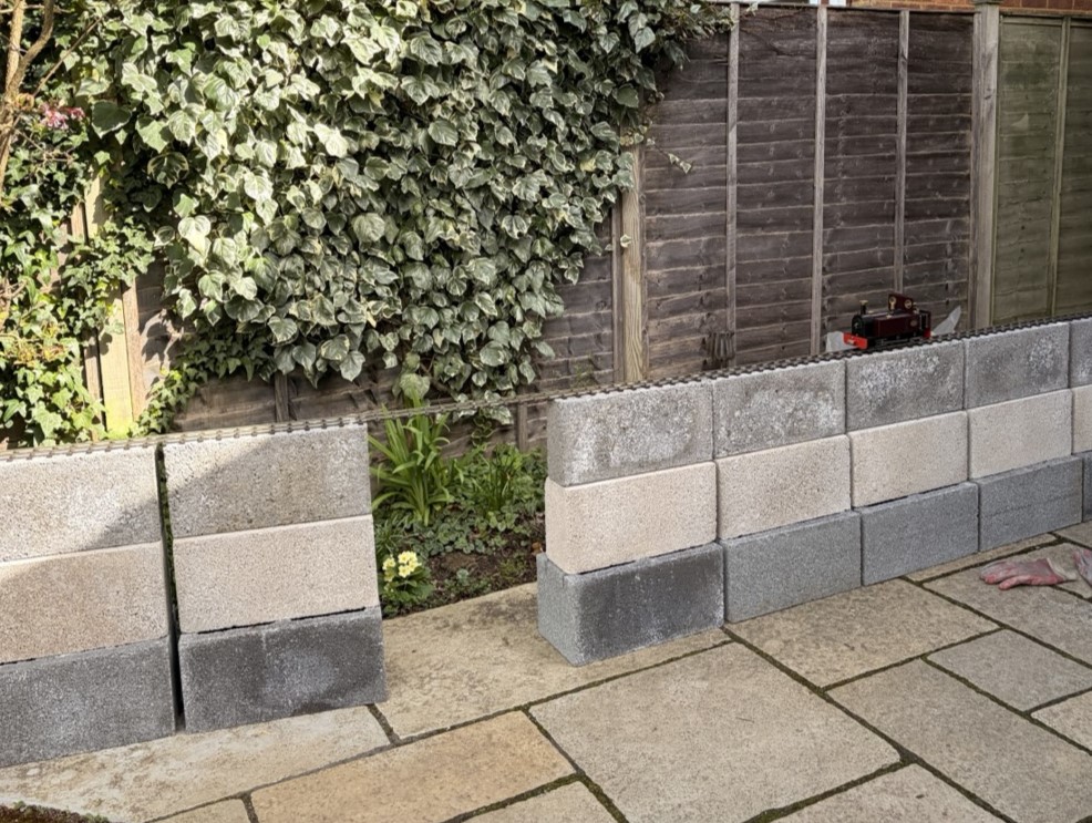

Blocks in - I do house extensions at your own risk.
IMG_4275 Large.jpeg (621.47 KiB) Viewed 156 times
