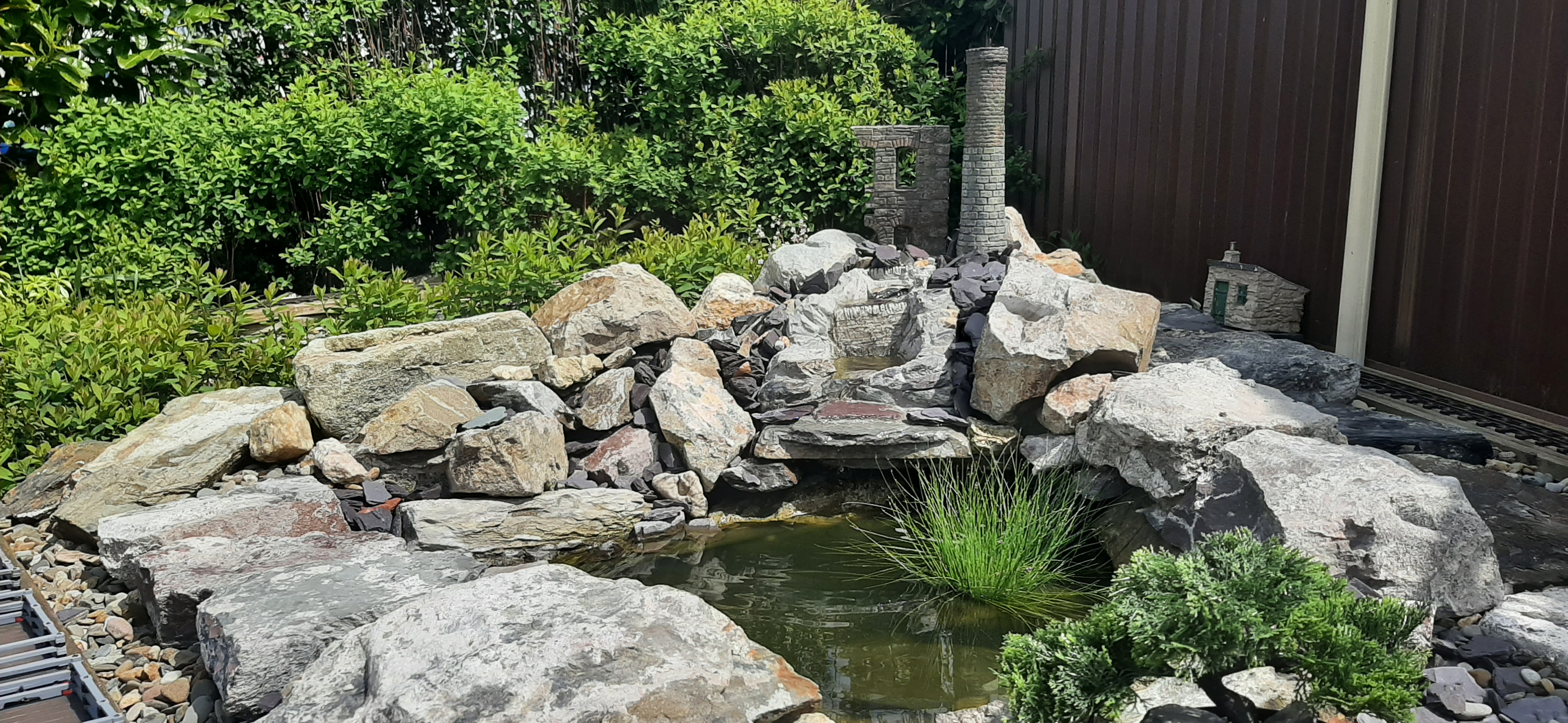

It has been extremely wet with no let up in the rain so far this year hampering the work on the water feature,despite that some more progress was made .Two more van loads of stone ,brick and rubble have been used to form the pond base and backfill the void.
Sand was then spread in the pond base before placing an old woollen rug on top and some gravel bags then a dpc sheet was triple folded and laid on top to form the pond liner.

The heavy rain helped fill the pond up , extra stone was used to hold the edges of the pond liner in place which helped form a rock face along the railway.

I have researched various solar pond pumps and went for a 12w variant which also has the option of adding a backup battery. I tested it out and was pleased with its performance. It is capable of lifting water up to a max of 1.5 metres . So fingers crossed, there will be a waterfall incorporated into the grand scheme.
Dai the coracle couldn't wait to go fishing .

Managed to book a dry weather slot for today in order to finish off the water feature . Whilst my expert friend did his magic with the final load of stone ,I set up the solar panel and pump.
With spring apon us the plants and bushes will shoot up behind the rocks providing the perfect backdrop .

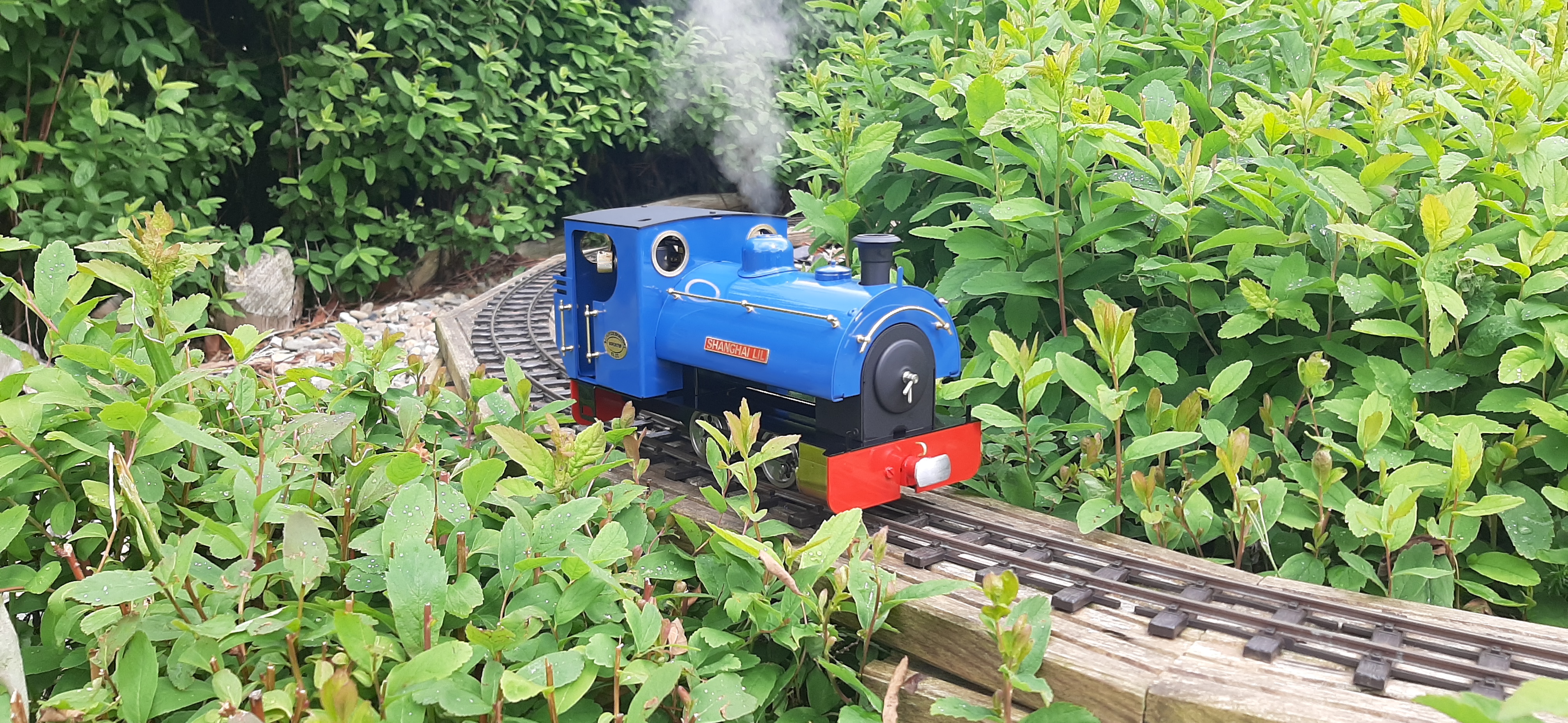

The P.M.R. held its first running session of 2026 a couple of days ago. The weather was perfect, light winds and lots of sunshine. Various guest locos turned up including a coal fired 7/8th scale engine . I was surprised by how quickly it built up steam pressure and performed . It covered 4 laps to one shovel of coal (anthracite)
I gave Vincent a run
Yr Tren Nesa Wedi Mynd

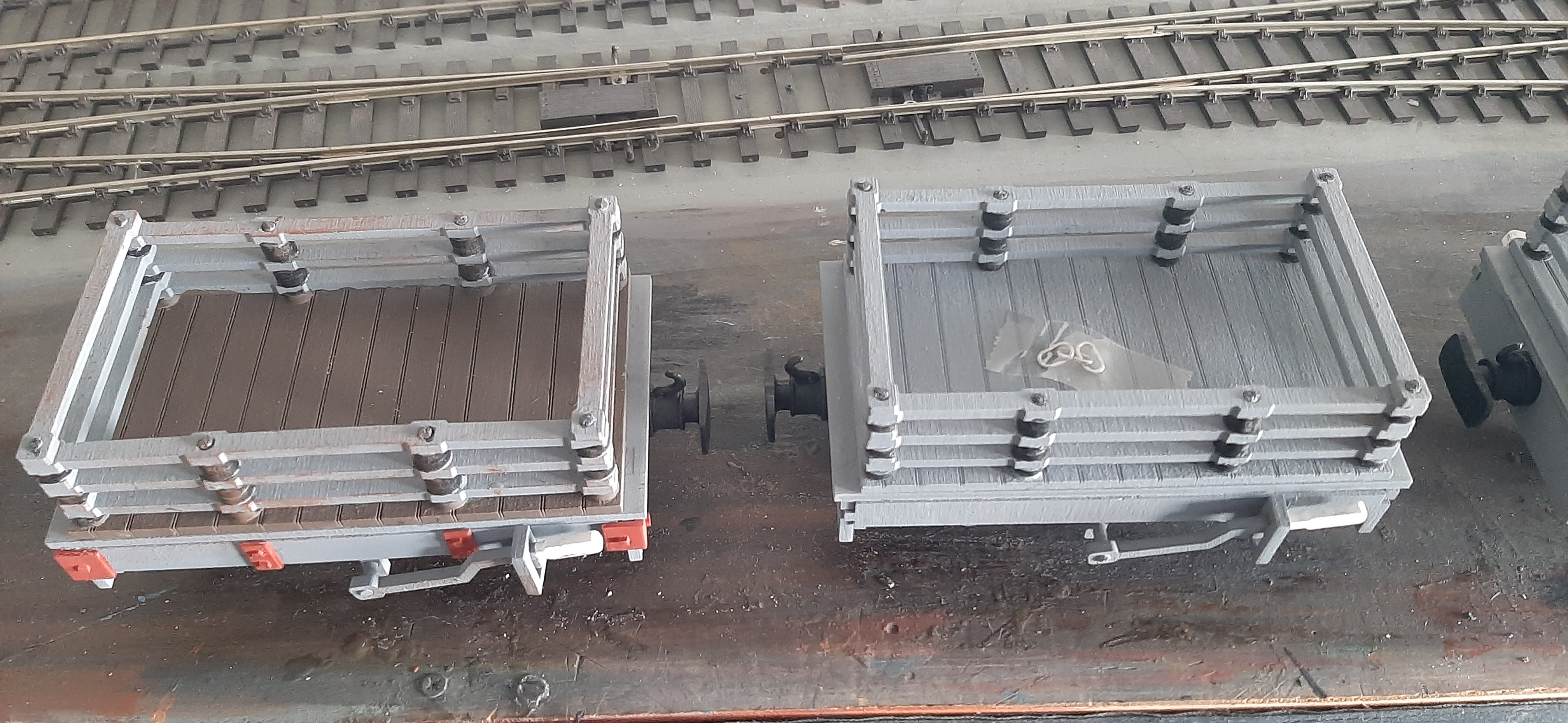

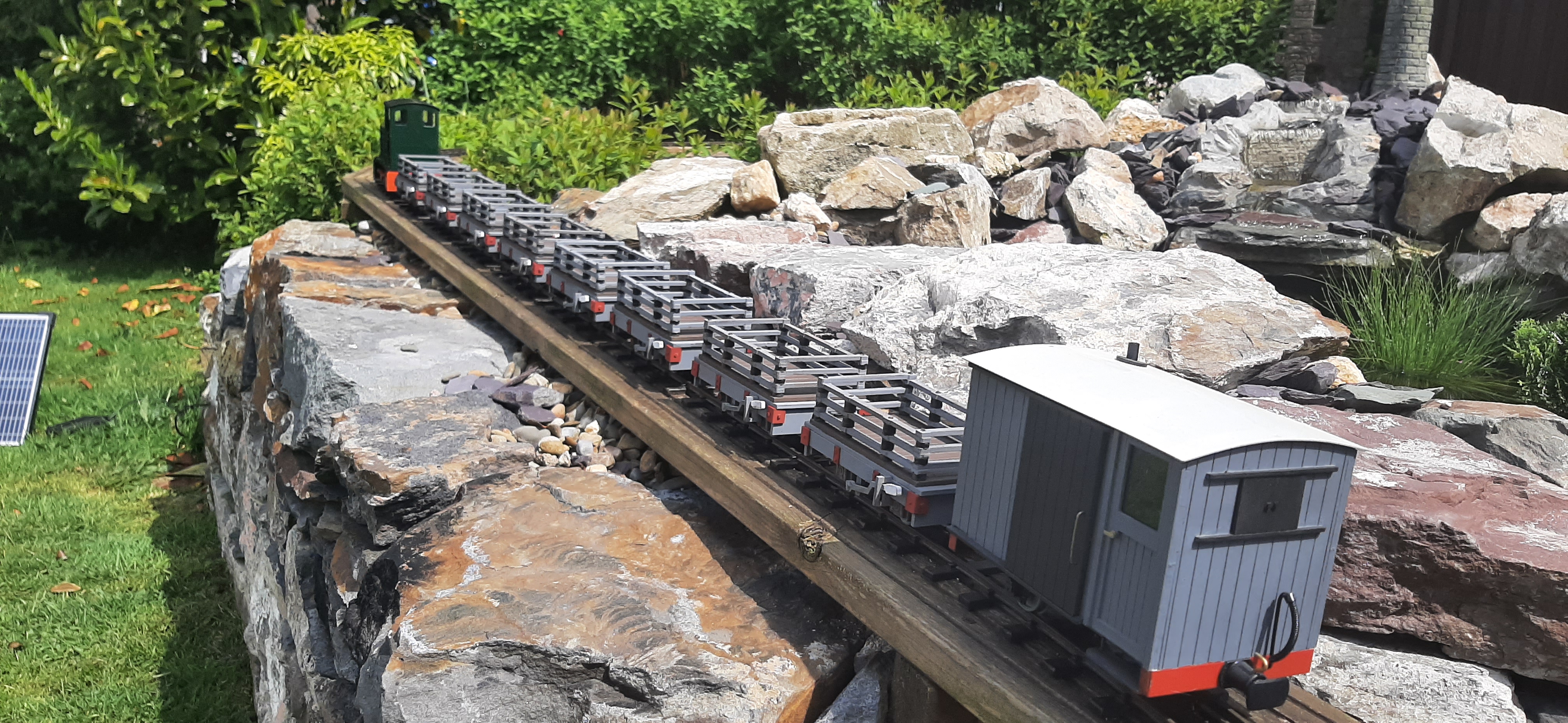

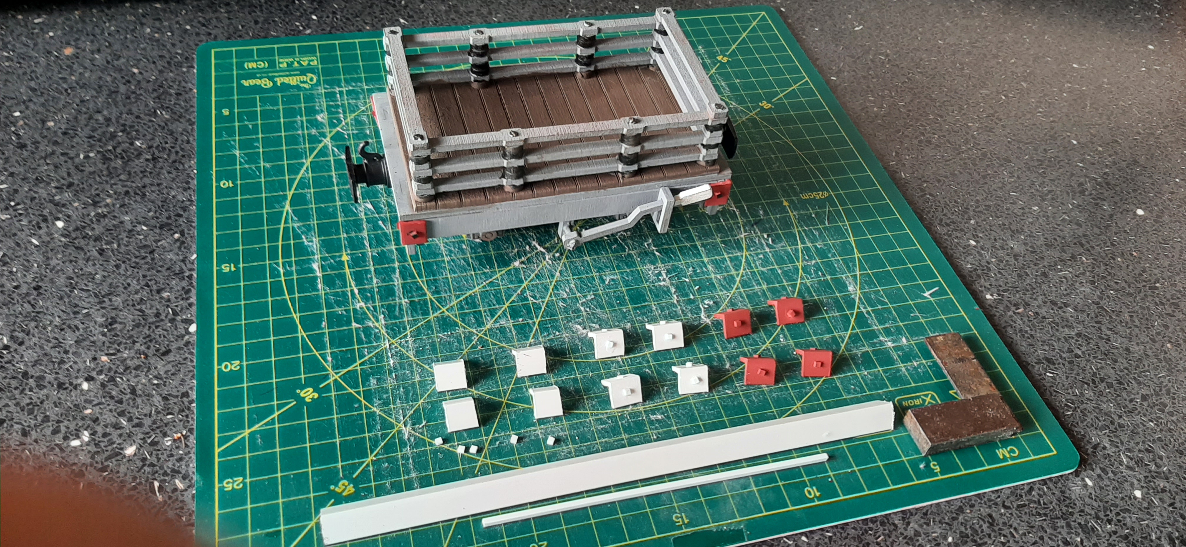

I acquired a number of slate wagons which were in need of some extra detailing . Not having a printer and not wanting to buy wagon iron castings , I rummaged through my plasticard selection and used some angle and 2mm bar .
Then made some more parts. The image shows before and after bodging.
There are 8 wagons in all . The Brandbright brake van goes well with them.

Meanwhile the plants are starting to ping behind the water feature. Spot the plastic Bonsai.

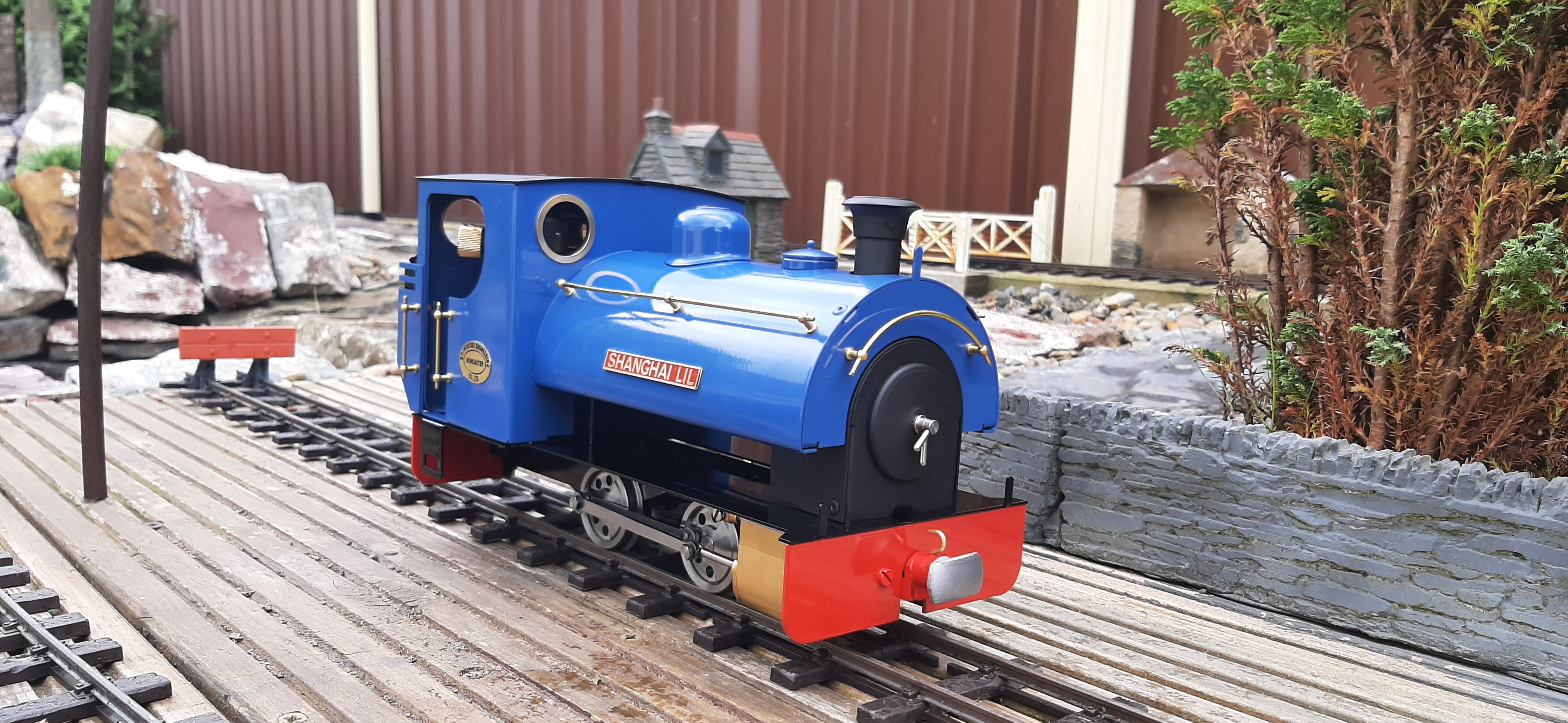

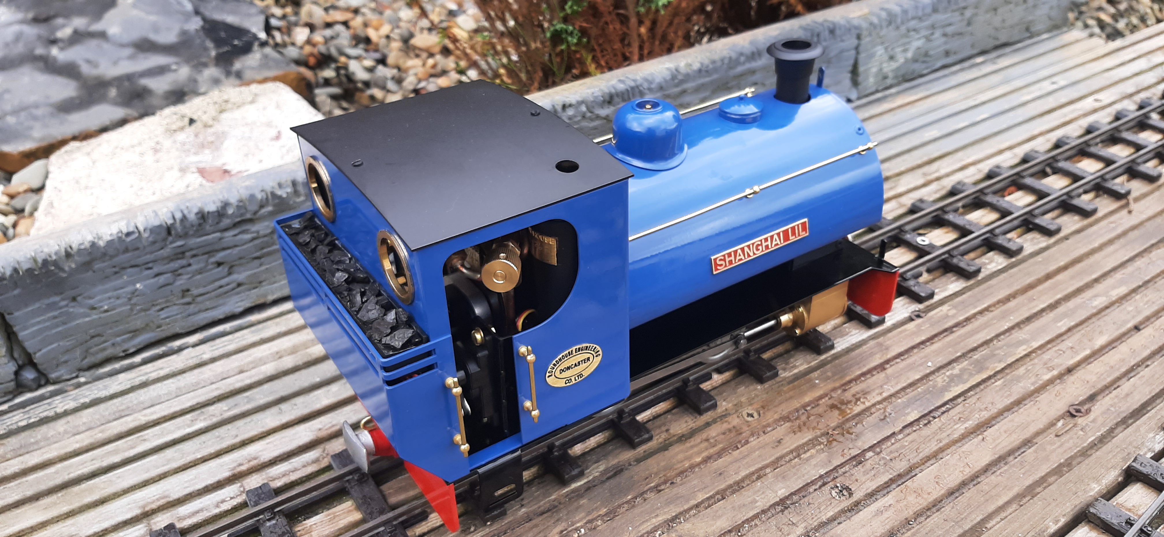

The P.M.R. has acquired another locomotive for the Summer Season. Namely a Roundhouse Engineering Basic series Peggie, which I have renamed Shanghai Lil.
It arrived earlier in the week but due to inclement weather and the curing time of the silicon adhesive used to fix the name plates it wasn't until today that I could give her a run.
This is the rc controlled version with the battery pack and power switch housed in the bunker. To hide the wires and battery switch I made a coal load using plasticard and some crushed up coal it does the job.
I want to paint the connecting rods red and paint the wheels and cylinder blocks black.
Does anybody know of a suitable paint on etch primer for this purpose.
Thanks in advance.
Chris.
