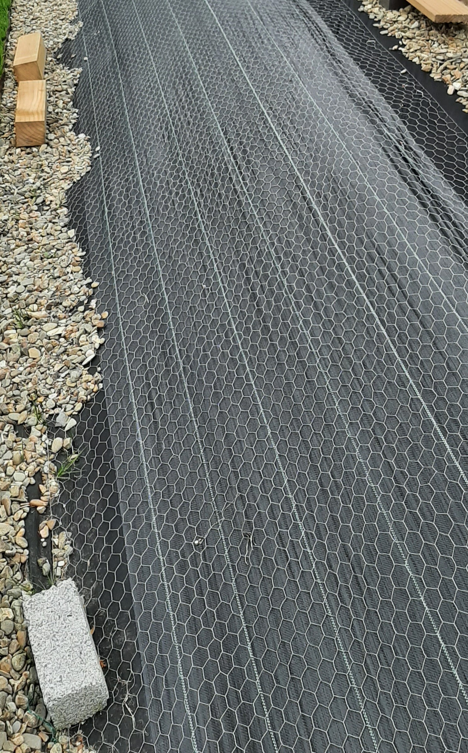

After visiting various garden railways to get an idea for my own future railways location, construction and requirements ,work commenced on the Preseli Mountain Railway in May 2022.
I decided that the railway would be at knee height to future proof my aging limbs and back. also construction and maintaining of the line to be kept simple as possible . I started off with laying plastic sheeting along the grass bank where the railway was to run . I pegged it down and all seemed good . My partner and I then went off for a weekend trip, but on our return we noticed that Mr fox had payed a visit and had ripped the sheeting in numerous places looking for prey. So it was back to the drawing board . We then came up with a solution to lay chicken wire on top of the sheeting to protect it and also create a surface for the gravel to adhere to .
Next task was to order a couple of tons of gravel, some postcrete decking board , 2x2 treated timber , fence post spikes, and a couple of 4x4 posts, and of course some track. and to get started .

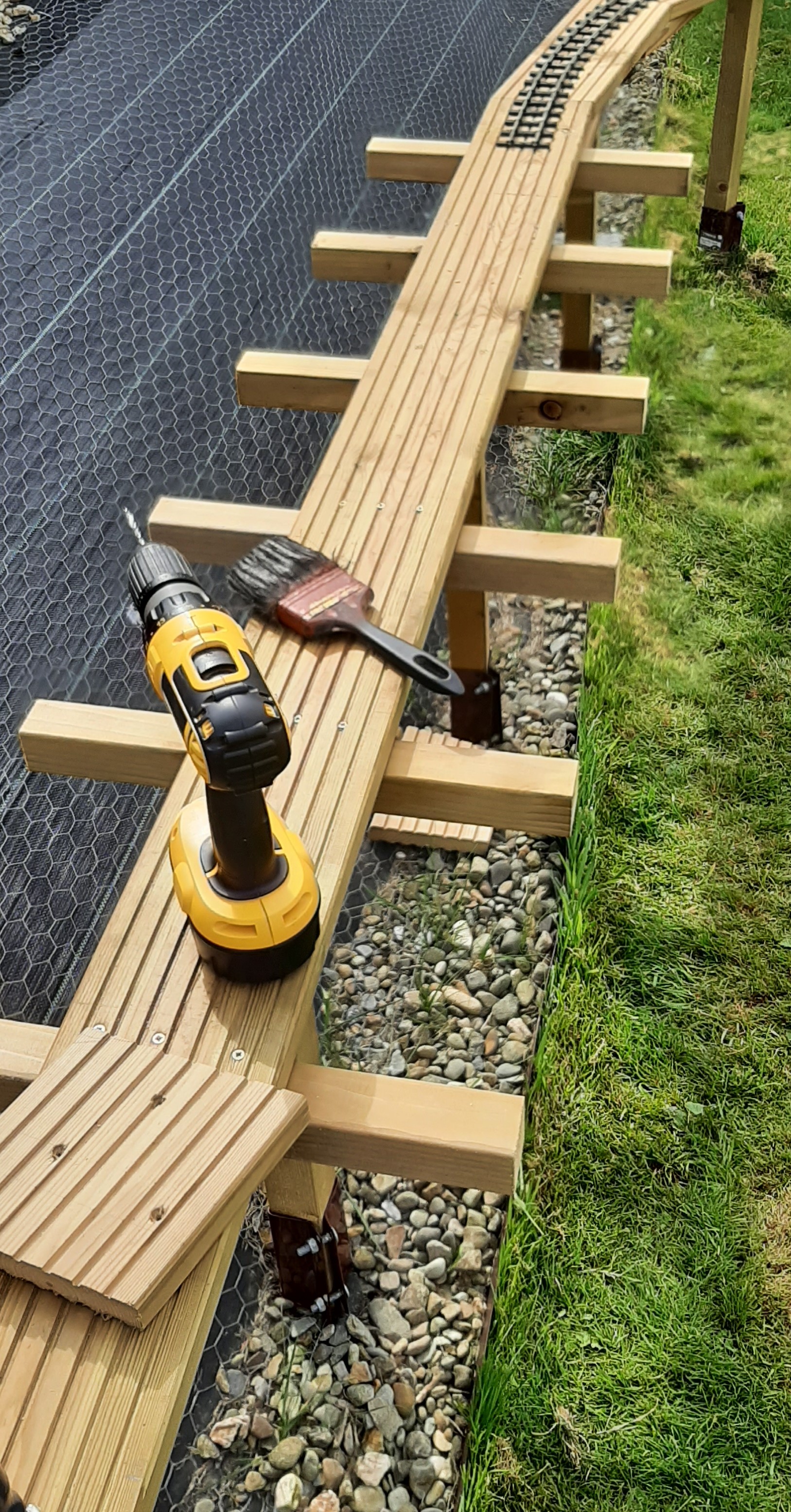

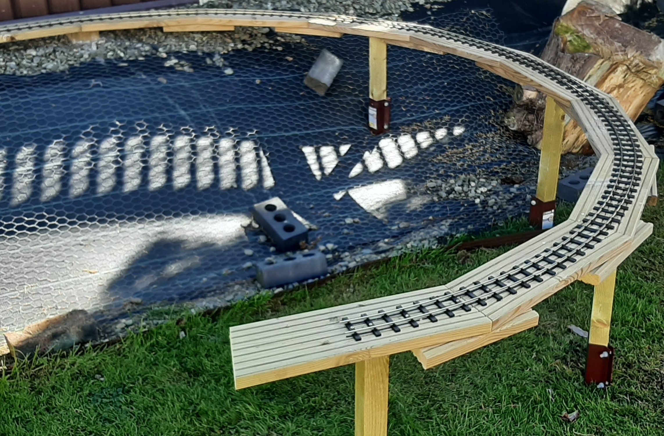

The next task was to work out the angles for cutting the Decking board to accommodate the curves. This I worked out to be approx 11.25 degrees .

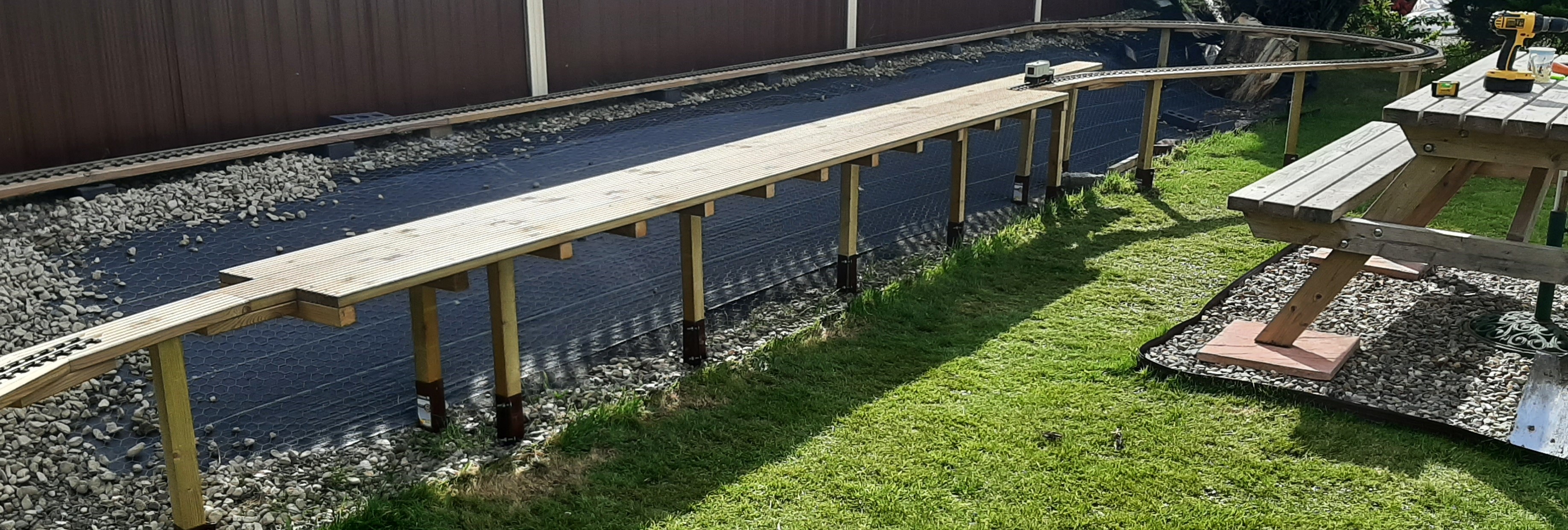

Progress was quite swift once the timber was cut .
- Attachments
- 20220912_104823.jpg (1.09 MiB) Viewed 314496 times

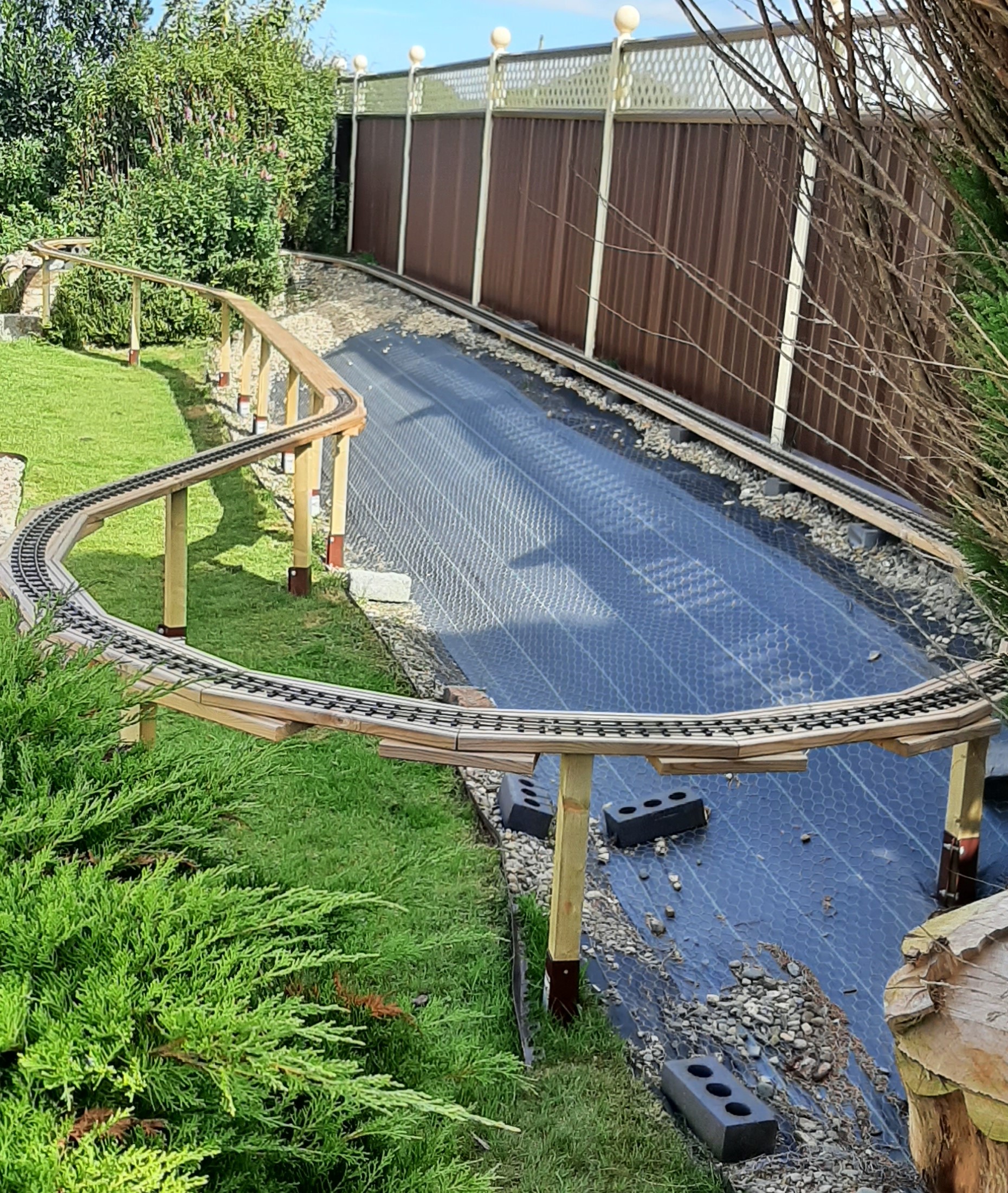

I then commenced construction at the other end of the line
- Attachments
- 20220904_134655.jpg (831.64 KiB) Viewed 314495 times

The circuit of my Railway is a dog bone shape Which doesn't take up too much of the garden . I used Peco flexi track and formed the curves with my 7mm o gauge Marcway track setters I decided on a minimum radius of 4' 6" for all the curves on the line.
- Attachments
- 20220916_140533.jpg (1.23 MiB) Viewed 314494 times

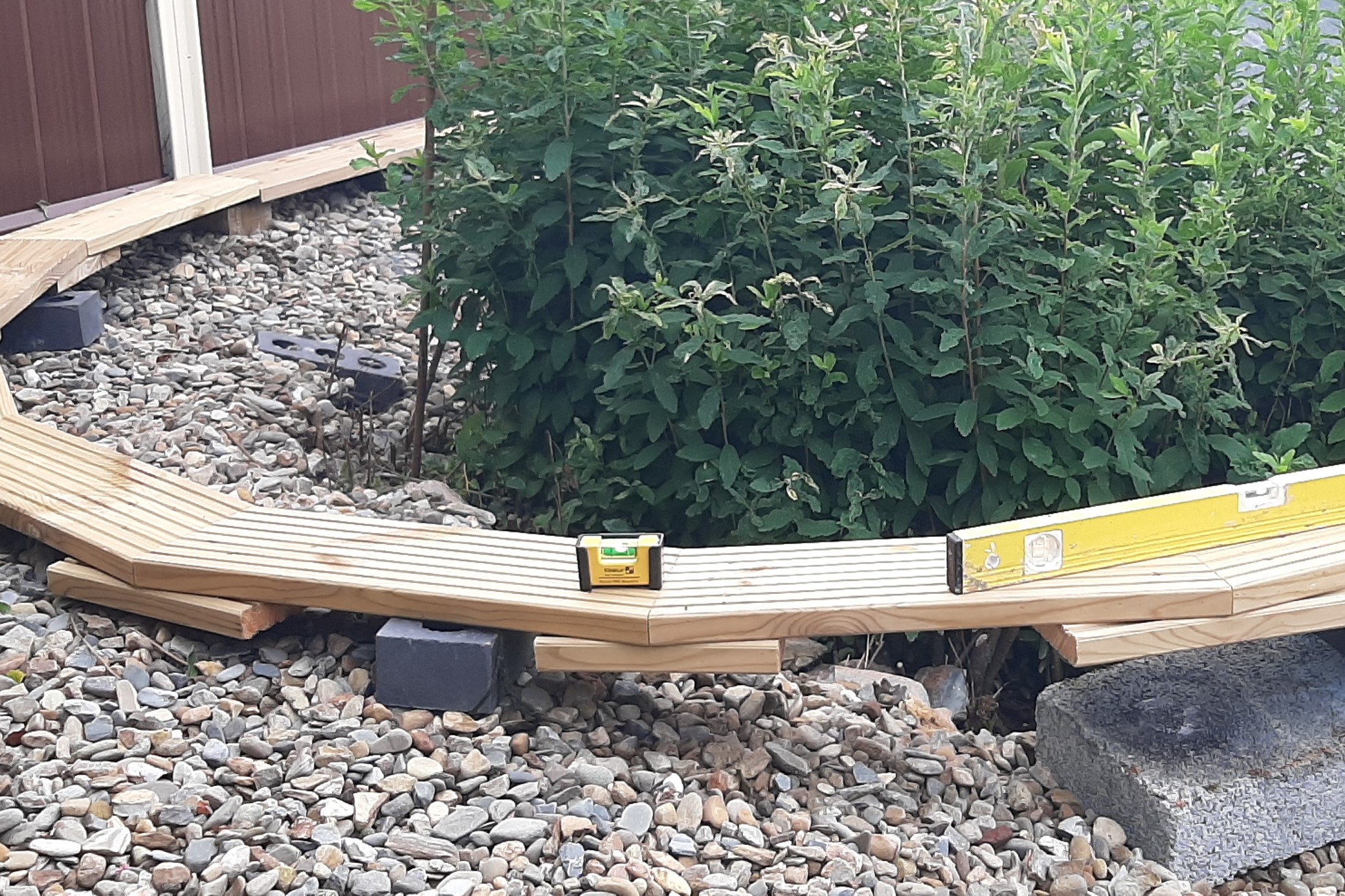

After completing both ends of the track when it came to joining up the decking boards I was pleasantly surprised to find that the alignment was only an inch out when I checked it with a laser level . Next task was the widen the front of the layout with more decking boards, So some cross braces were required.
- Attachments
- 20220920_133630.jpg (1.42 MiB) Viewed 314491 times

Although Decking boards are treated and have an average lifespan of 10 or so years, I coated all the timbers in a premium wood preserver as an extra precautionary measure especially with the way timber shot up in price after lockdown .
- Attachments
- 20220921_132331.jpg (1.25 MiB) Viewed 314490 times

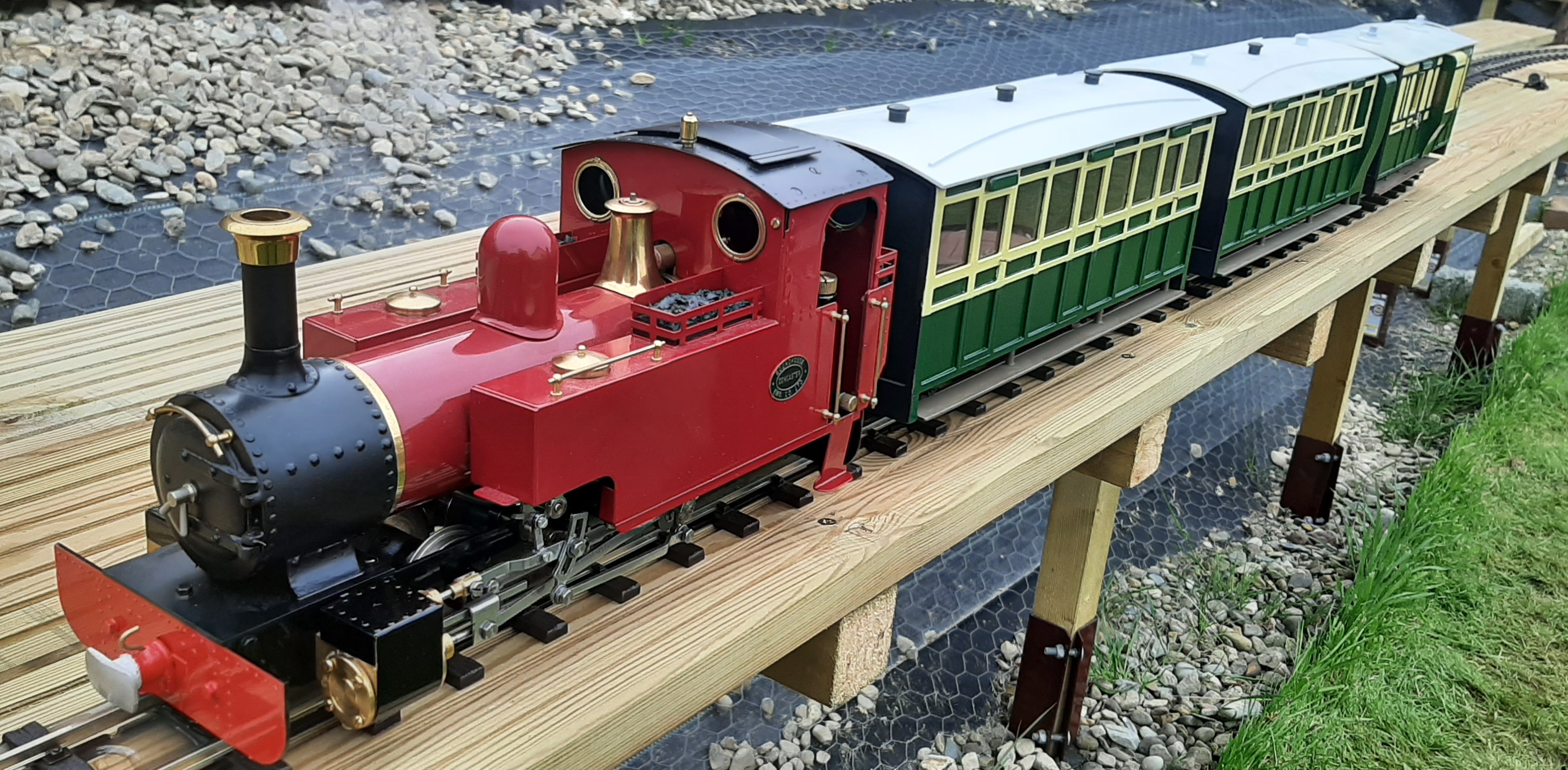

The line was starting to take shape ,and once I completed laying enough track to make a circuit it was time to reward myself by playing trains .

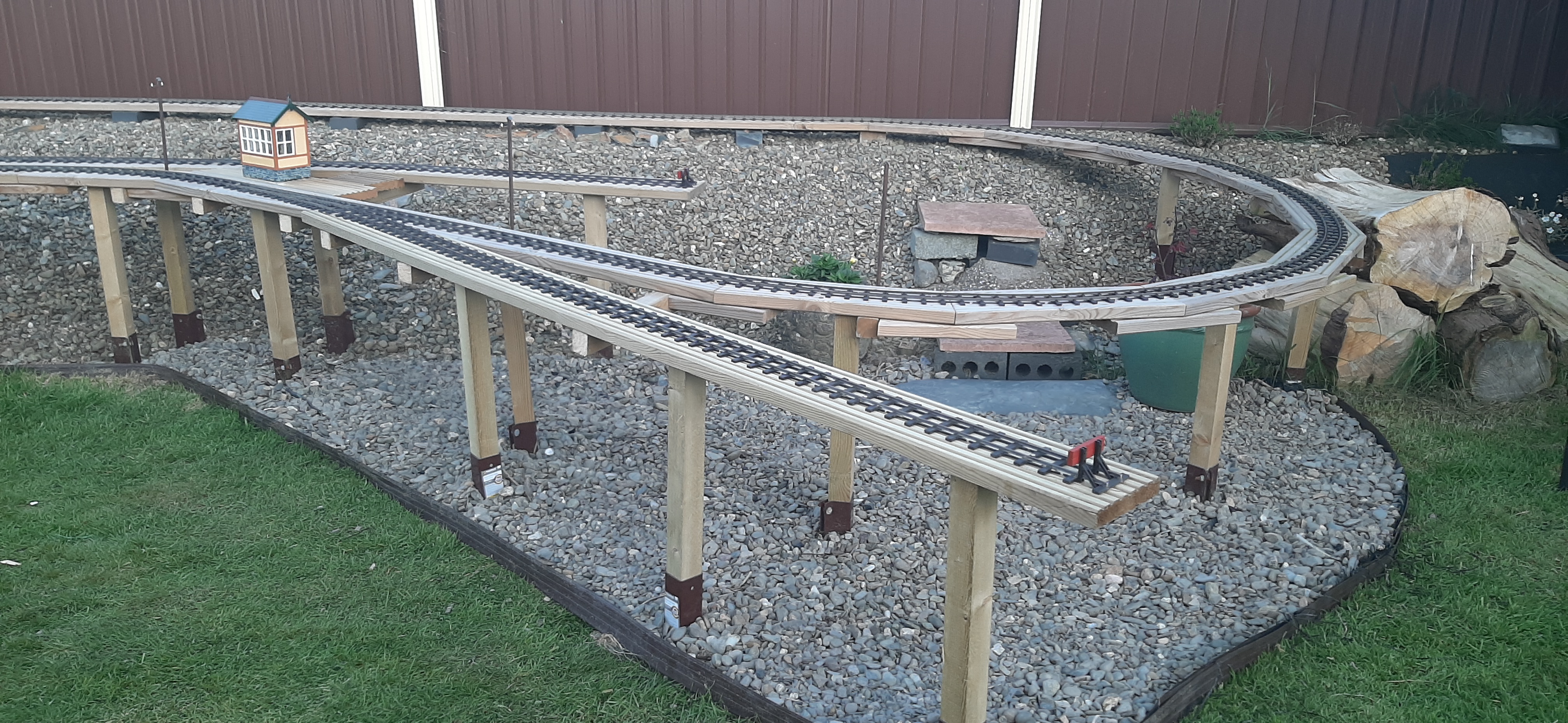

Next on the agenda was to fit some turnouts /points for a passing loop and start on constructing a station . I decided that only streamline points were to be used in keeping with any future purchases of locos and rolling stock that wouldn't traverse set track points. the platform and station building carcass were made from facia board off cuts .
- Attachments
- 20221007_181603.jpg (1.24 MiB) Viewed 314485 times

You've got yourself a nice long run there, nice clean work. Waiting to see what happens with the widened section at the front.
PS Ah! didn't see the last pic.

Looks like some lovely level trackwork, I bet that makes for smooth running! Do you have plans for the middle or will it all be gravel?

Thanks for the thumbs up . Yes level trackwork is a must for me I am able to reverse a train of wagons without derailment all around the circuit but only when its not windy ! ( wyntog iawn) the line is about 750 ft above sea level on a flat wind swept plateau .

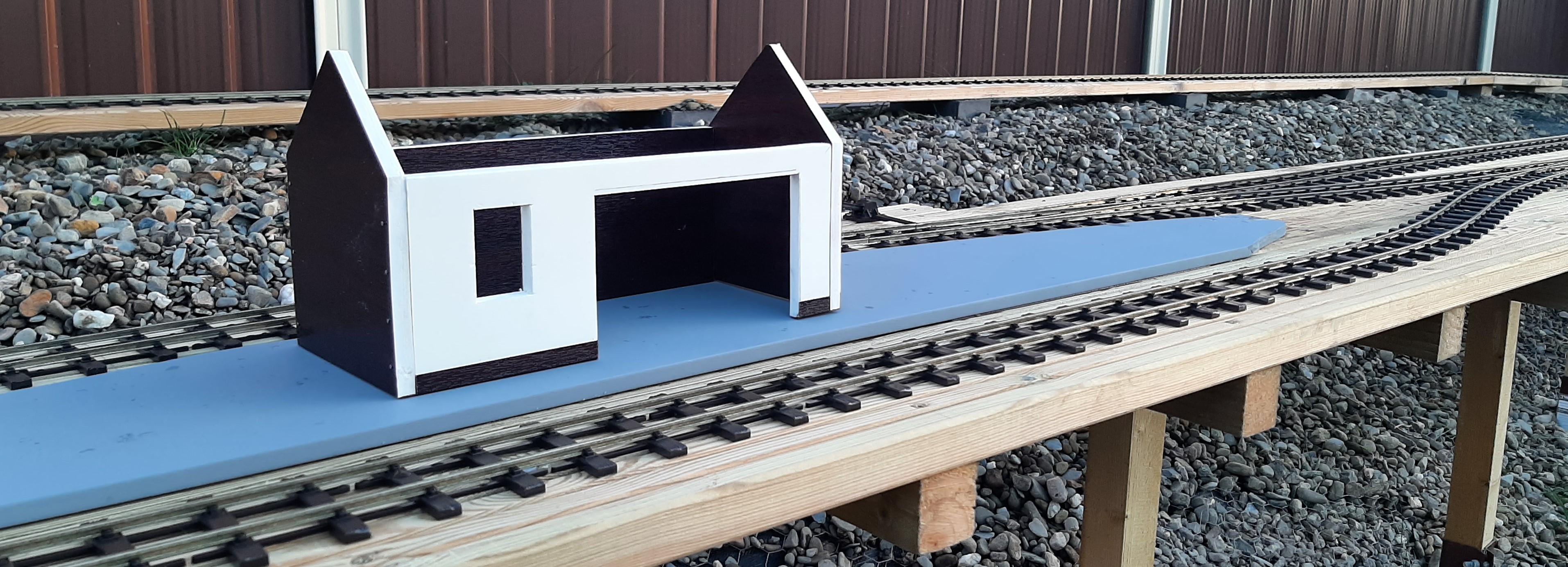

I managed to source some brick embossed plasticard sheets which are readily available for making dolls houses in i/12th and 1/24th scale I laminated them to the facia board carcasses to produce a presentable station building .
- Attachments
- 20221017_143101.jpg (1.99 MiB) Viewed 314446 times

Very presentable!Preseli Chris wrote: Mon May 27, 2024 12:47 pm I managed to source some brick embossed plasticard sheets which are readily available for making dolls houses in i/12th and 1/24th scale I laminated them to the facia board carcasses to produce a presentable station building .

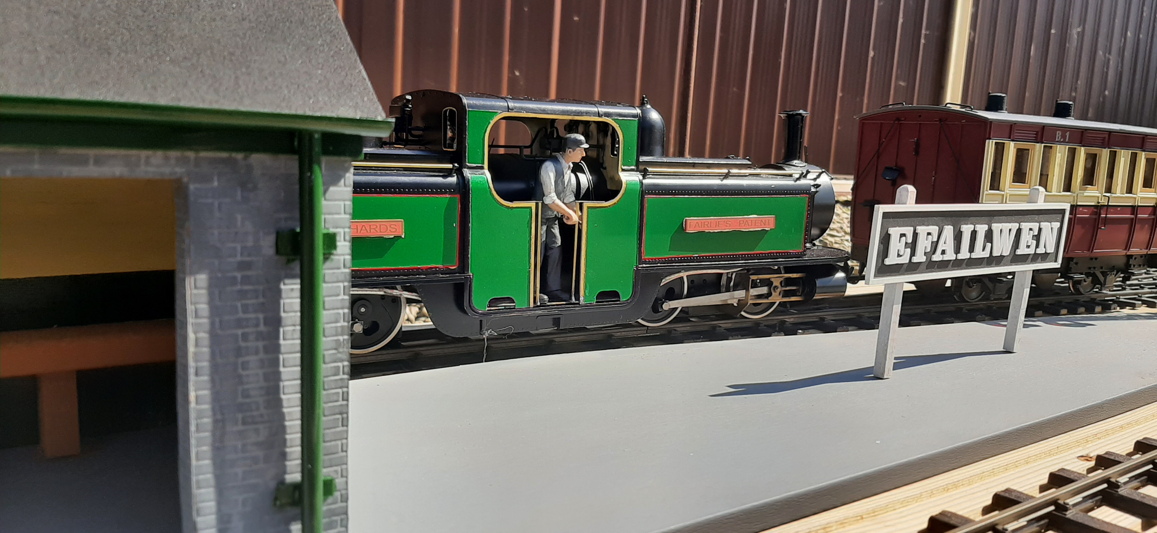

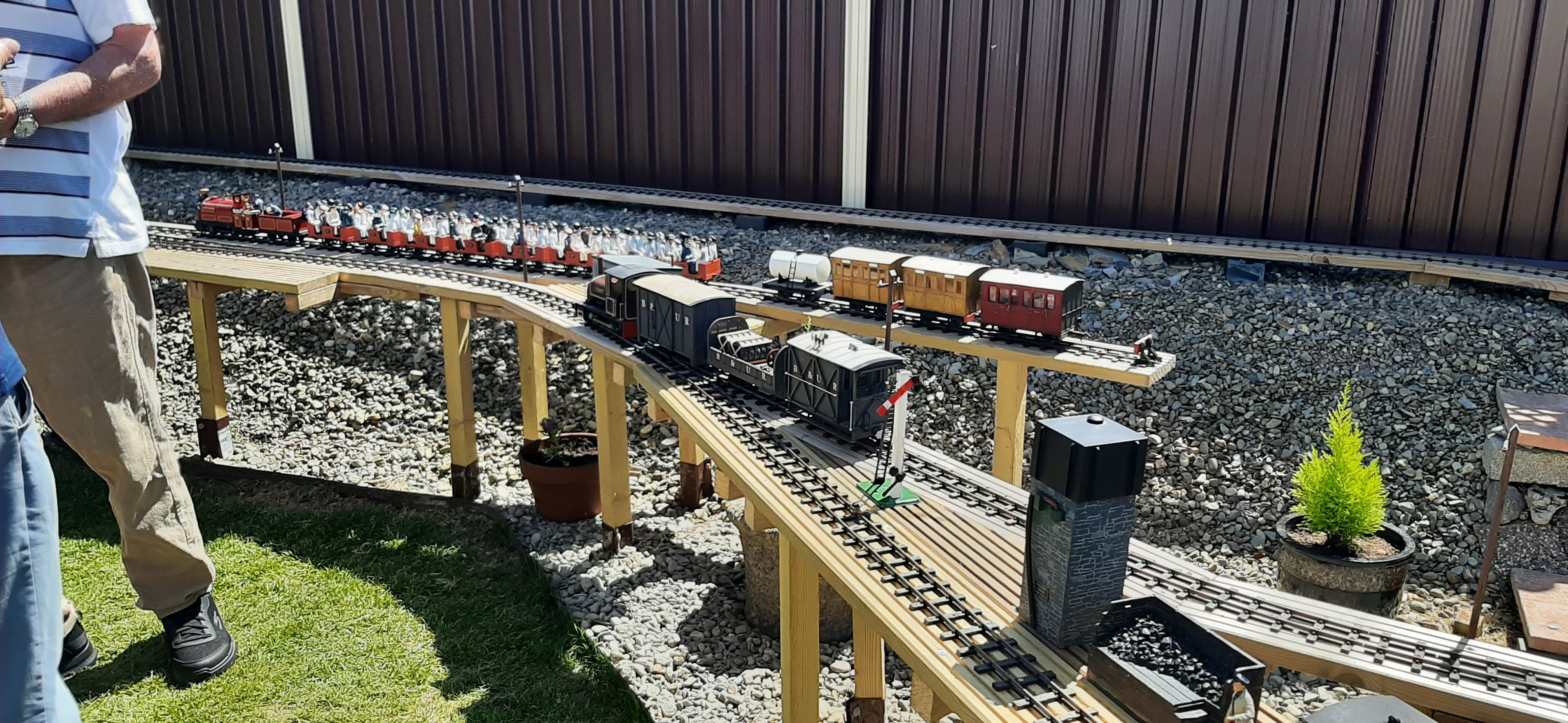

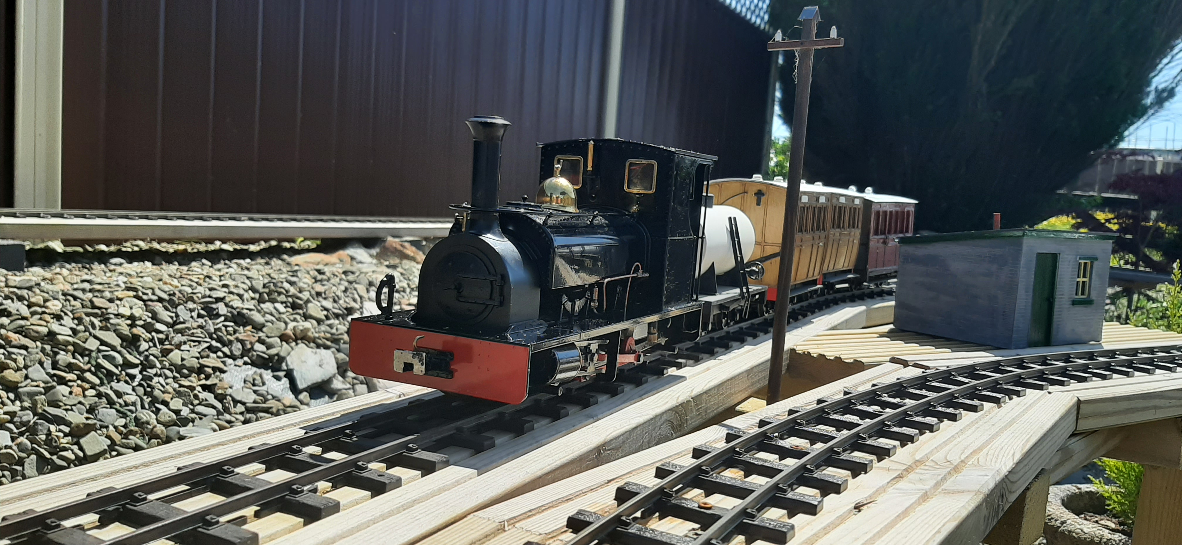

My first running day with the West Wales Group was upon me .I had been praying to the Great Maker for a calm sunny day , to which i was rewarded
- Attachments
- 20230603_134040.jpg (2.88 MiB) Viewed 314336 times

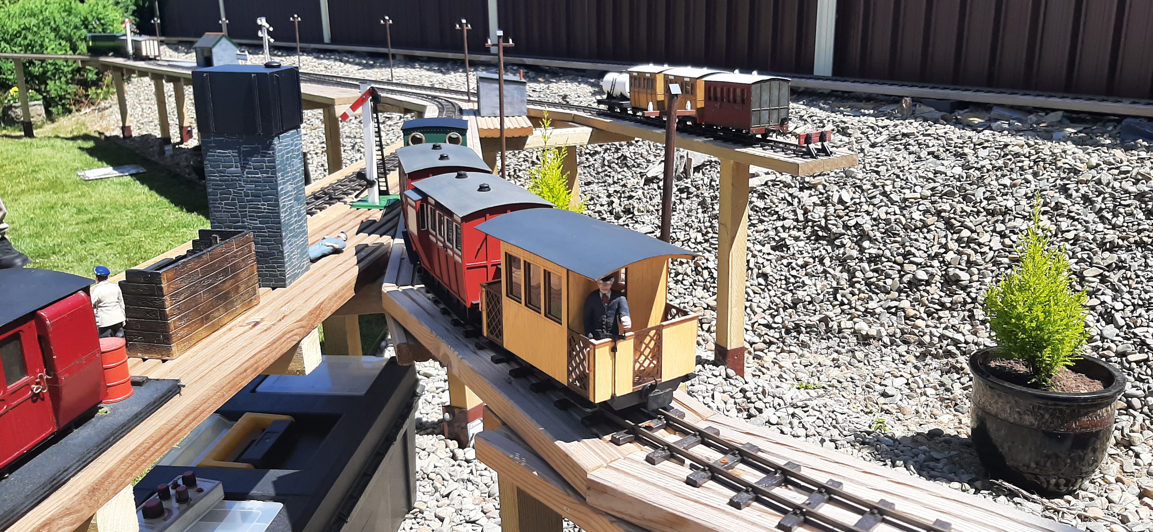

some more images from the day
- Attachments
- 20230603_115421.jpg (2 MiB) Viewed 314336 times
- 20230603_135236.jpg (1.62 MiB) Viewed 314336 times

I made the telegraph poles , using joiners hardwood dowels soaked in wood stain .They have been outside in the elements for over a year now with no ill effect .
- Attachments
- 20230603_145325.jpg (1.69 MiB) Viewed 314335 times
- 20230603_121023.jpg (2.41 MiB) Viewed 314335 times
