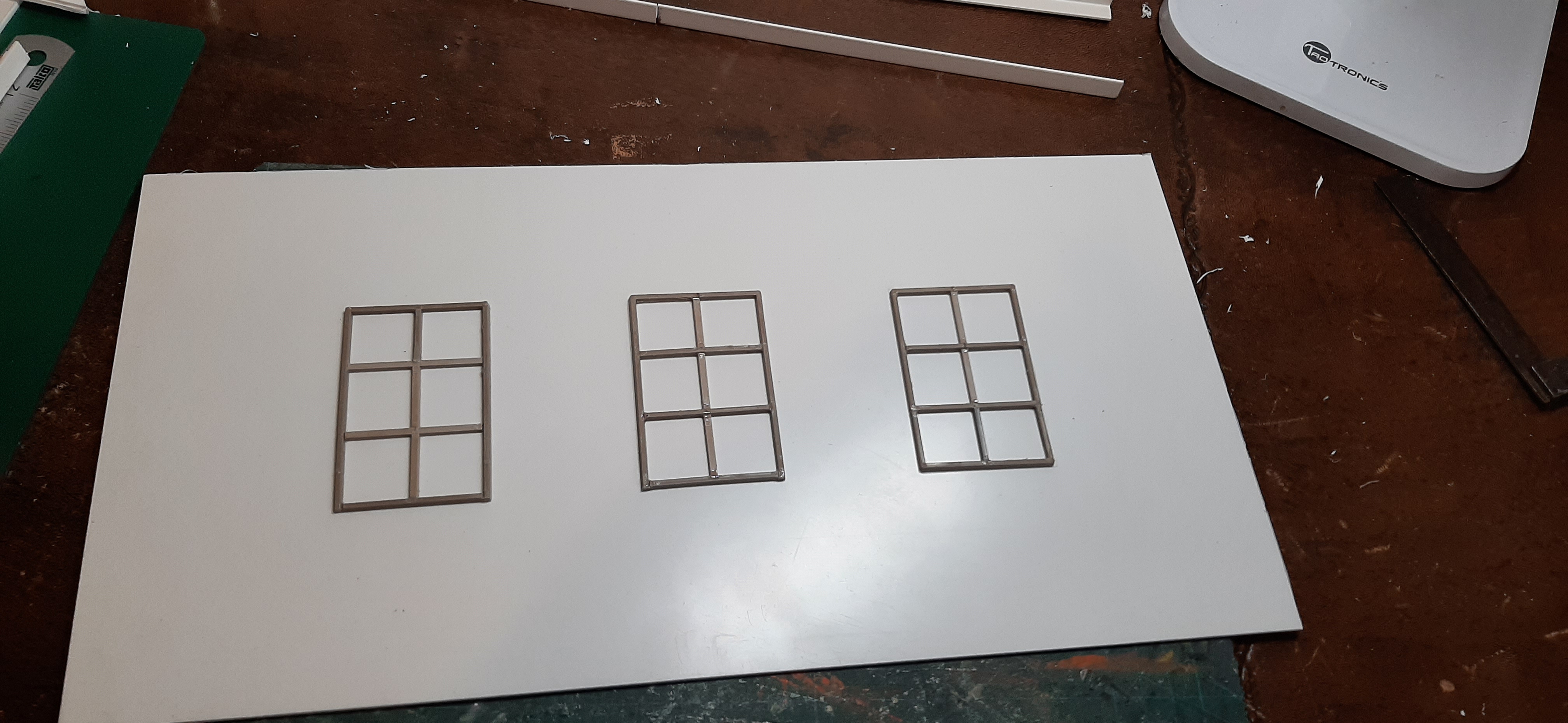

I wanted an engine shed for the railway . Various options are available , resin ,concrete and wood kits . The concrete cast kit is not an option due to weight,and the other options are costly. So on to my preferred option scratch build it .
The model's made from 2mm thick plasticard Sheets progress so far
The window frames have been fashioned from ex ratio n gauge kit sprues.
Next on to laminating the carcass

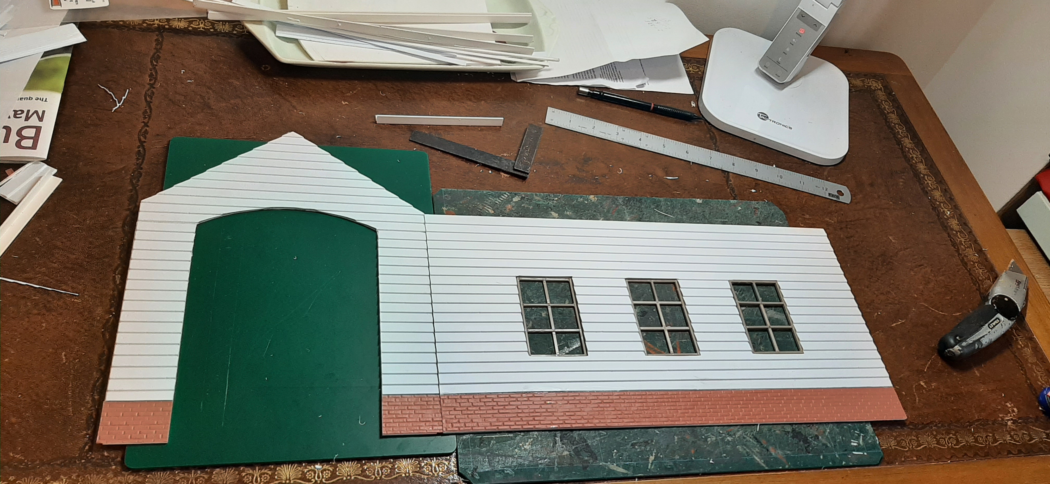

Post by Preseli Chris » Tue Jun 17, 2025 9:34 pm
So after a day of scribing and gluing . This is the result.

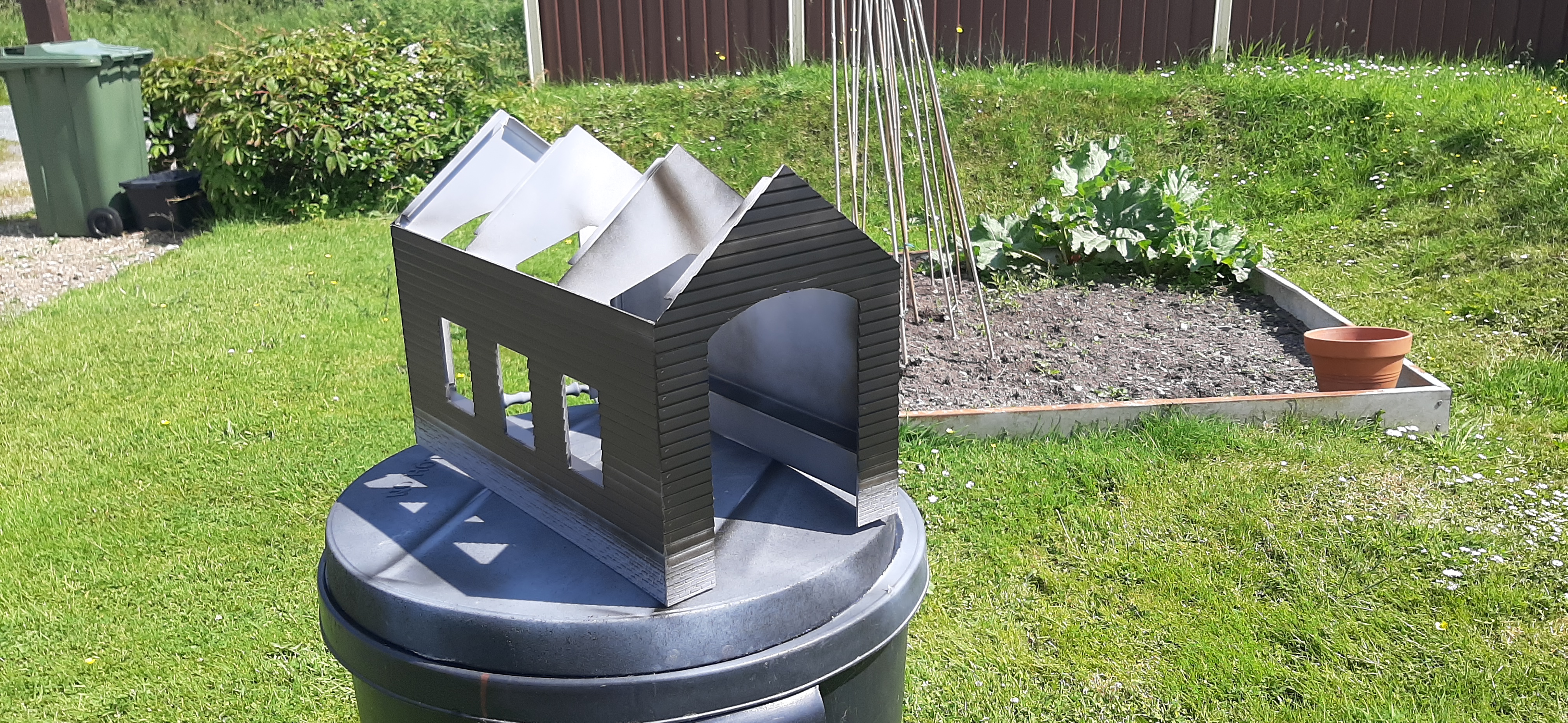

I was able to do some more work on the engine shed today ,fitted some roof trusses and bracing ,filled gaps with miliput then as the weather was ideal with no wind ,I rattle canned the building .

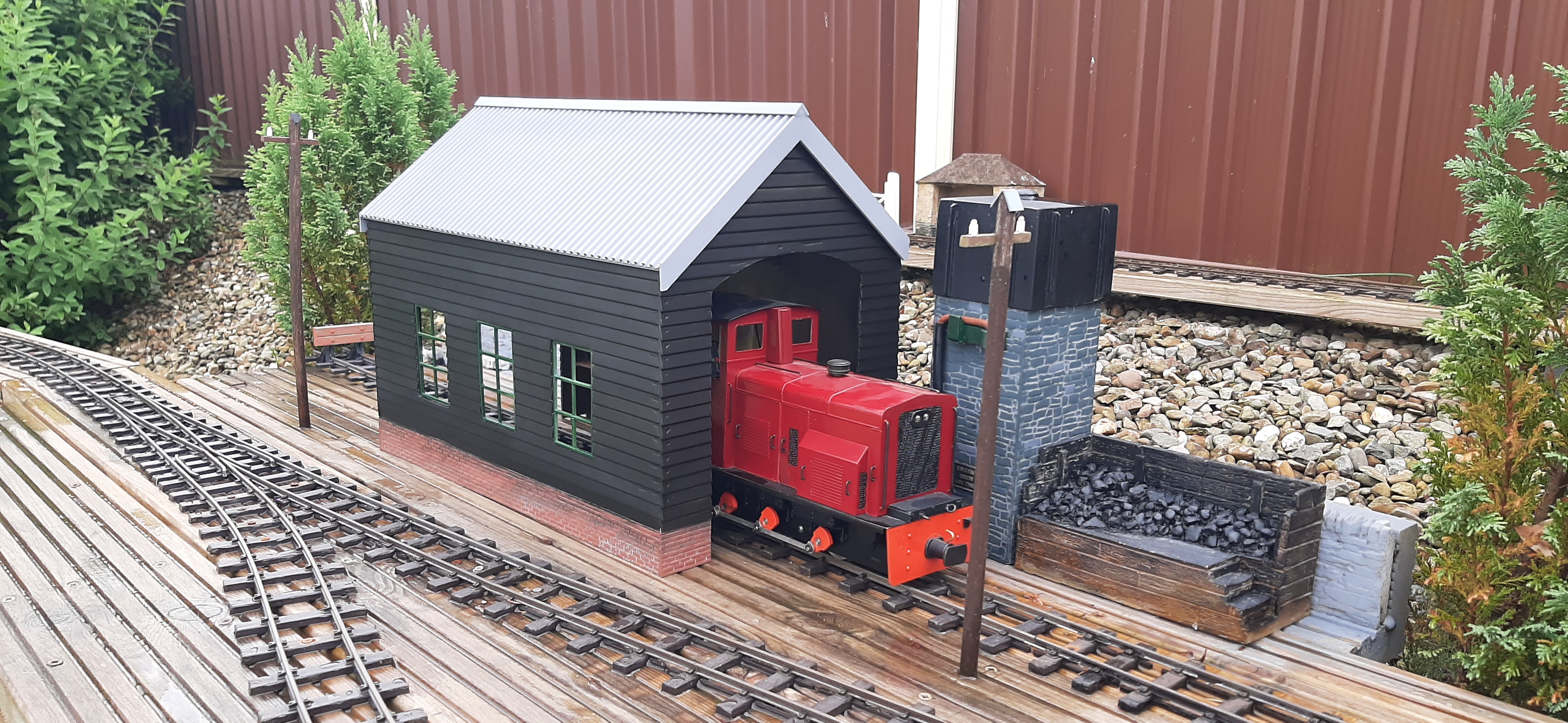

The engine shed is almost finished . I have painted the roof, facia boards and gutter . Just need to attach the drain pips and make some doors . The coffee stirrers are a little under scale for the doors only measuring 5mm wide , so I went on the net and found some kebab sticks 200mm long and 9mm wide ,they will be ideal for the job .

Hi Chris
I store it in the garage when not in use. Given my past experiences with plywood outdoors, I don't trust even so-called exterior or even marine ply to survive unscathed.
Posts: 5728
Re: The Preseli Mountain Railway.
Post by Peter Butler » Sat Jun 28, 2025 10:41 am
Chris, to be sure, simple answer is ... Don't use wood!
You have seen my Plastikard structures which have been on my B.U.R.P.S. railway for about 8-10 years now and all they require is cleaning up for winter storage in my shed and only light paint repairs where appropriate. I have heard too many horror stories about time and money wasted on timber preservation for outdoor use and have never gone down that road.
Jackson's Miniatures supply all of the embossed sheet material you need and other waterproof materials can be applied for surface finish. I'll be glad to pass on my experiences if ever you need advice.

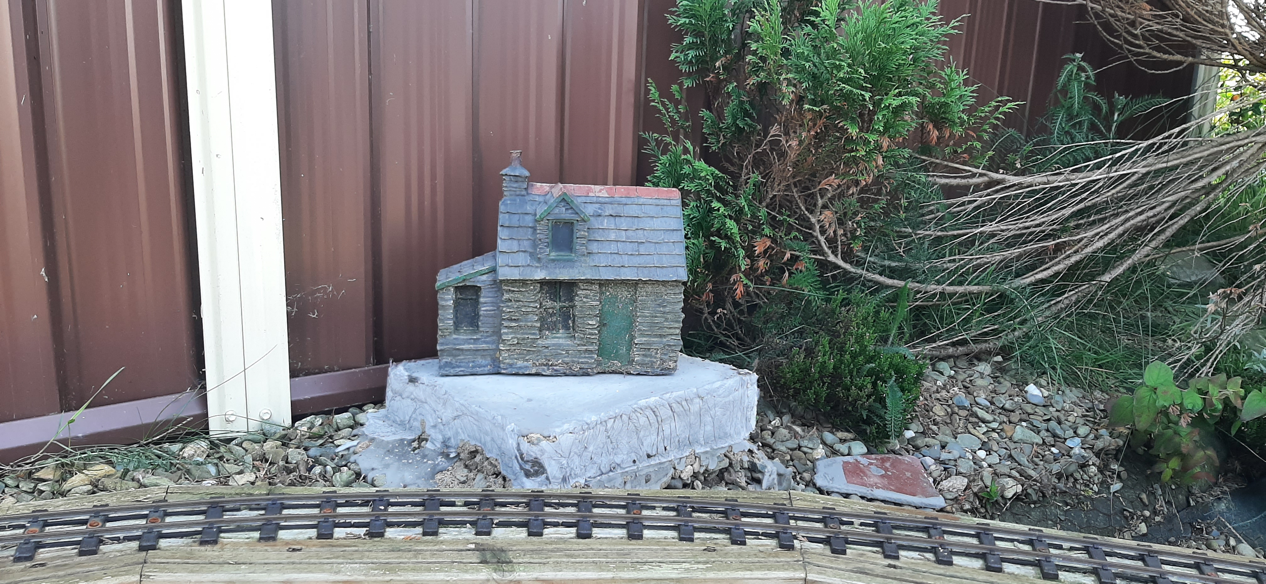

Thanks Peter. I have always made my buildings from plasticard in 2 3 4 7 and 16mm scale . its a medium that I am happy with . The only material that I would consider to leave out all year is Concrete . I was recently gifted a couple of concrete cast buildings , and for the first time I made a mini concrete plinth to place the building on

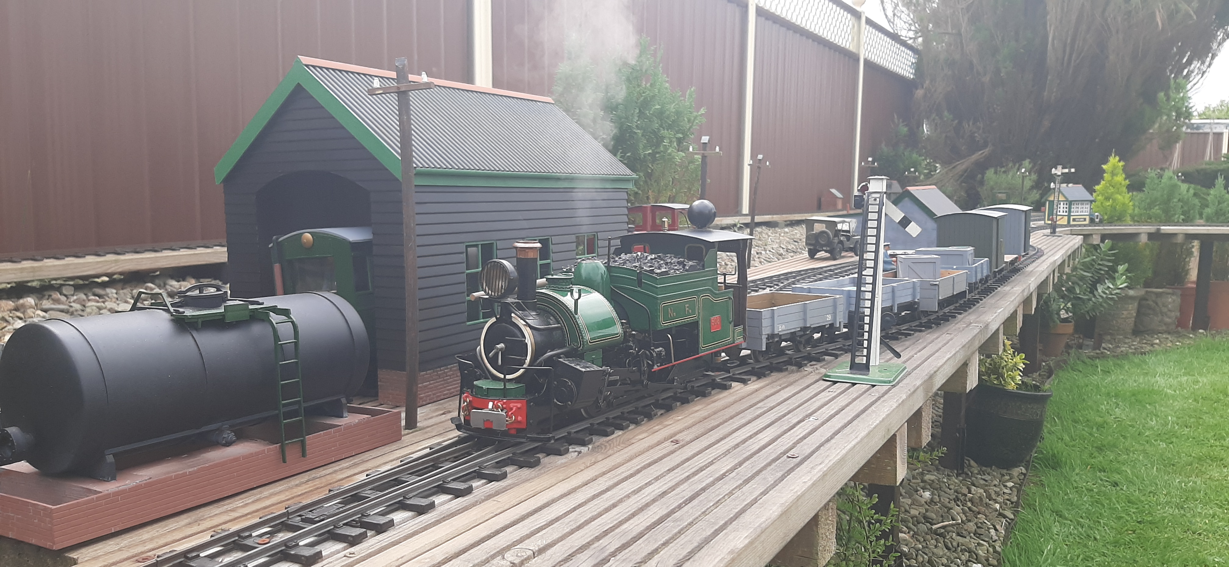

Post by Preseli Chris » Mon Jun 30, 2025 10:23 pm
Had an impromptu Monday meet up with some more guest locos running on the line . I was impressed with the 7/8ths scale locos running characteristics which was fitted with a slo mo device. Fortunately here in the wild west of Wales, today wasn't too hot and oppressive.
