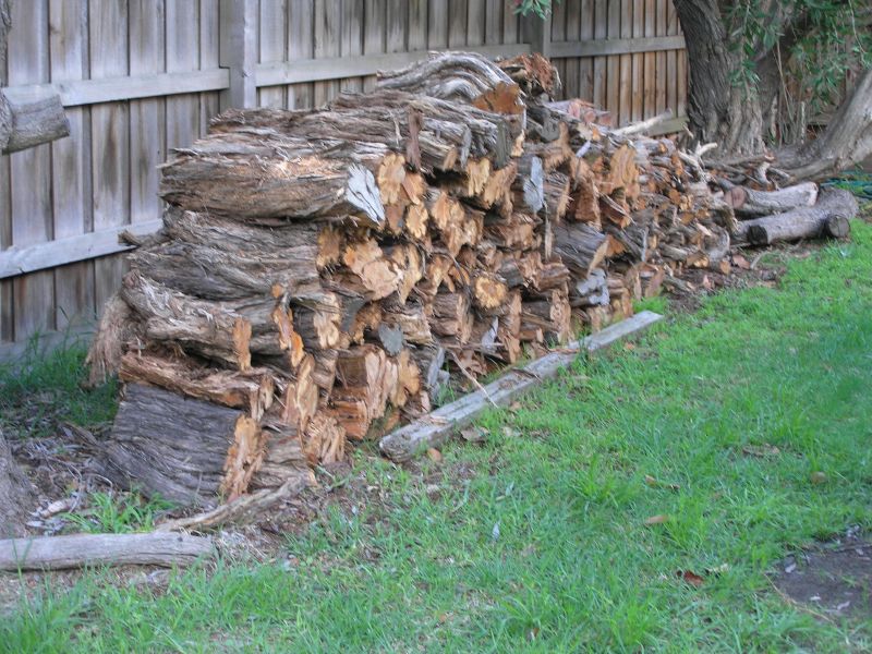

Post by LNR » Thu May 09, 2024 1:37 am
This small pile, a bigger one at the back
A quiet Wednesday afternoon 2.JPG (131.24 KiB) Viewed 12123 times
and an even bigger one at the front
Time to get a man with a chipper in.
In some ways I can see an advantage in the lack of tree cover over Nayook, no bird s*** all over the buildings, and no leaves to be forever cleaning up. Might not feel the same next Summer though.

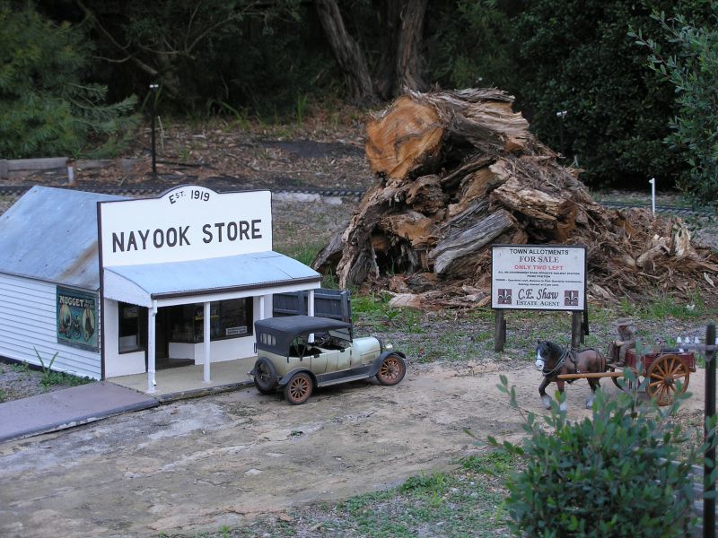

OK I'm putting a new loco together as hinted to recently. I would like to include all the features I have wanted, but due to my impatience with previous builds have not included.
So time for a guessing game!
Pic 2.JPG (47.37 KiB) Viewed 12004 times
The first fitting.
Posts: 8052
Post by ge_rik » Mon May 13, 2024 7:47 am
LNR wrote: Mon May 13, 2024 2:46 am OK I'm putting a new loco together as hinted to recently. I would like to include all the features I have wanted, but due to my impatience with previous builds have not included.
The first fitting.
Whatever it is, it's beautifully engineered.
Some sort of manifold ..... for oiling maybe?
Posts: 1905
Post by LNR » Mon May 13, 2024 8:47 am
Sorry Rik, no cupee doll for you.
Posts: 871
Post by drewzero1 » Mon May 13, 2024 9:04 am
The screw on the end looks like it could be for attaching a handle, so does it have some kind of valve inside? The symmetrical nature of the dual outlets suggests it might connect to something that's the same on both sides, like cylinders maybe. (I don't know much about steam locos, but I'm pretty sure they have cylinders... right?)
Posts: 1905
Post by LNR » Mon May 13, 2024 9:37 am
I'll have to give you the cupee doll for that Drew.
Yes with the piston in the forward position the cylinders exhaust up the stack, the rear position directs it to two outlets facing forward under the cylinders to represent cylinder drains. It's actually a design from a sadly passed friend Jock D here in Australia.
