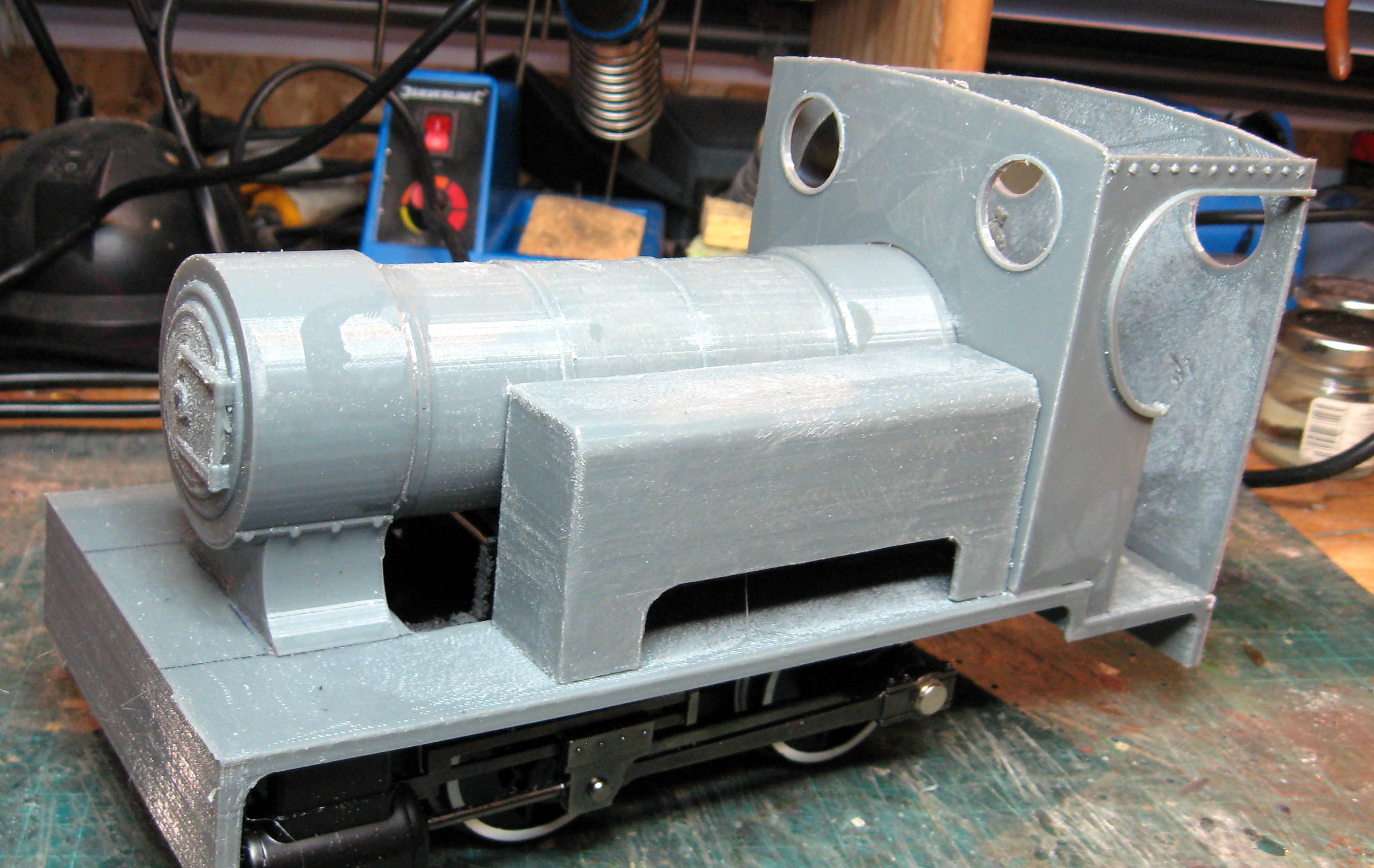

The boiler has now been printed, glued to the smokebox and firebox and the whole thing fixed to the running plate. It's beginning to look like a loco....
