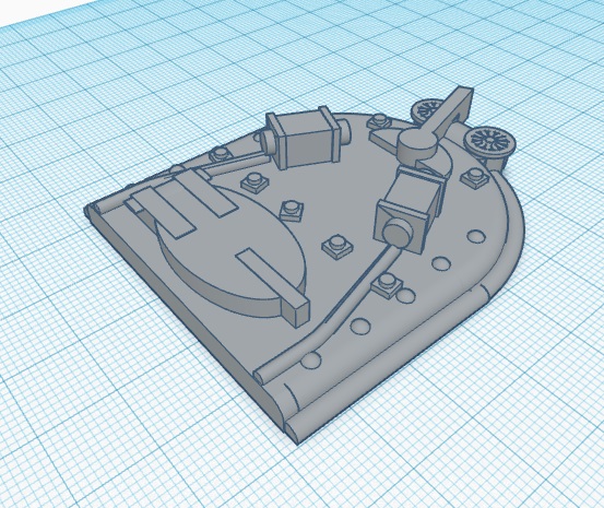

A bit of cosmetic work on the backhead (stolen and then reworked from my Schull loco)

Those drawings are most impressive Rik. Every time you post a drawing, I just wish I could get on well with Tinker! :roll:

Post by ge_rik » Fri Oct 08, 2021 9:19 am
Thanks Philip
I supposed my bodgelling background helps. You'll notice on most of the drawings there are tiny flaws where some shapes aren't quite aligned properly. I think most conscientious modellers would keep going back to make minute adjustments until there was perfect alignment. I've learned to live with those small anomalies. I've realised that, with a 0.4mm diameter nozzle, they aren't picked-up during the printing process.
If I was selling the drawings or the models, I might be a bit more assiduous.

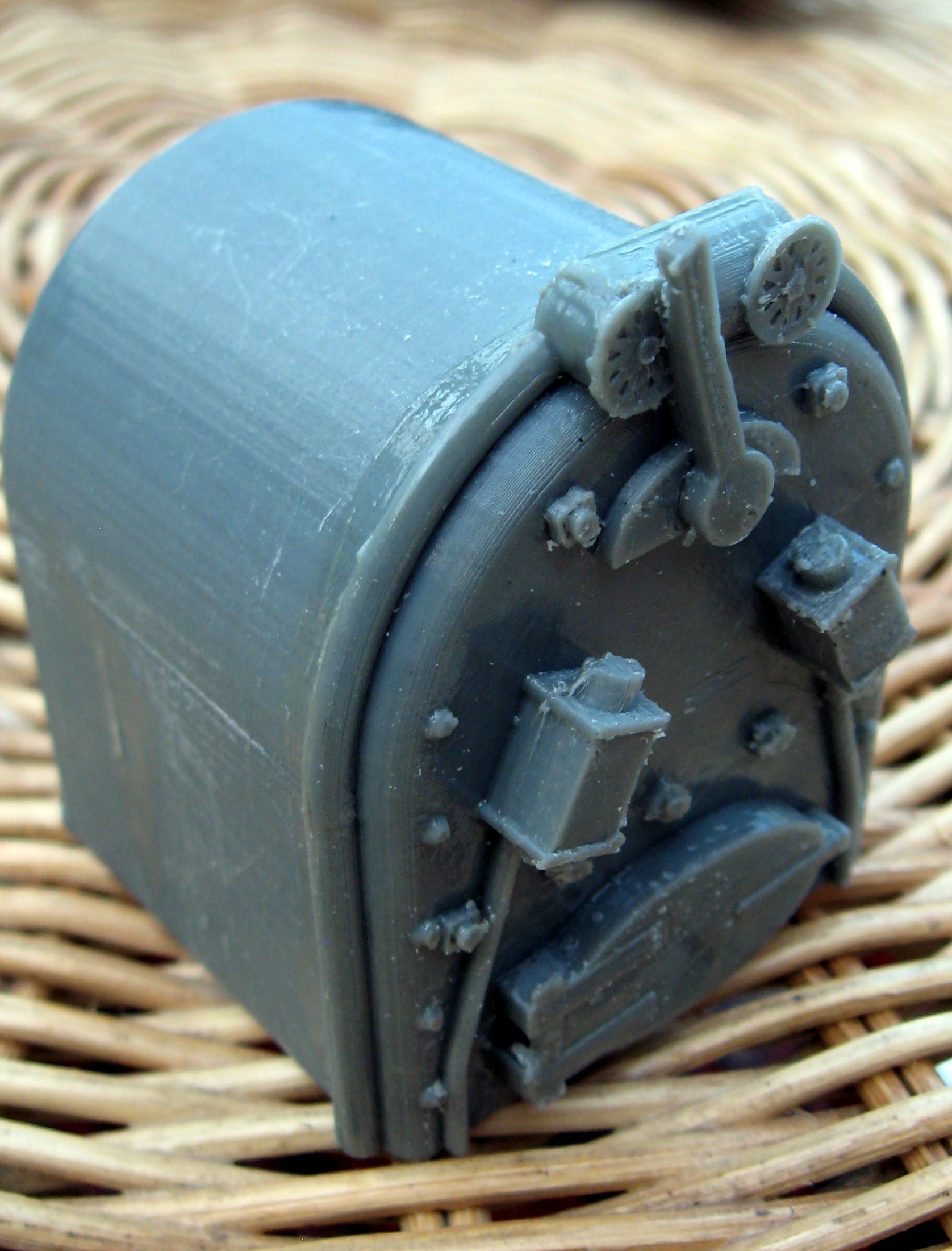

.....but the back end less so. They say every day is a school day. I thought I might be able to get away with printing the firebox as a single unit hoping that the inherent stringiness of PETG would enable it to bridge the void beneath the backhead ...... no such luck!
The strings turned to blobs which caught on the nozzle and pulled it off the bed.
So Plan B. Sliced the firebox into two and print the two parts separately.
Not wasting the bit I've already printed, though. I'll tidy it up and stick the backhead (which is now printing) to it. Waste not want not..... :lol:

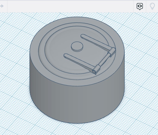

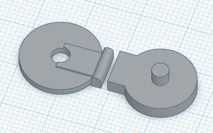

The drawings don't show the tank fillers and the photos don't help much, other than that they seem to be round. I can't see a handle or hinge so have improvised. As my loco is an amalgamation of what was proposed with what was actually produced, I think I can I'm allowed some artistic licence. Drawn in two parts to overcome the dreaded overhang.

The two parts of the firebox have now been reunited ....
.... and so the loco is beginning to take shape.
