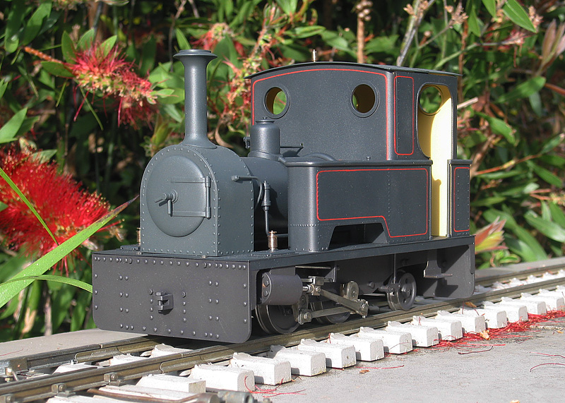

This model has been in the paintshop queue for several months, but the rain has been getting warmer here and with a few dry days, the paint job has been completed.
The original intent was to paint the model in the usual faded black colours, but I recently bought a WW2 vintage US made drafting instrument set. Research suggested it was of good quality and it didn't appear to have had much use. Some tests were run on a painted test panel with the ruling pens and the spring bow pen and the results were better than I've been getting with a more modern German ruling pen.
The plain black colour scheme looked a bit dead, so the decision was made to line it using the new (to me) drawing instruments. Lining is a simple 0.020" red line, using Humbrol #60 vermilion. This was the only tin of bright red I had and while I'm not a fan of Humbrol paint since Hornby took over, the results are OK.
I've been having ongoing model painting problems in recent years, but a change in airbrush a while ago and a lot of experimentation seems to have ironed out most problems, even when using Humbrol. This time around it looks like the varnish has worked OK as well. Of course this varnish formulation is no longer available, so time will tell if the problems return when this tin runs out and I have to use the new version............
This paint job went well enough that I'm now encouraged to put the O&K, that I built earlier this year, through the paintshop next. .... 8)
The first photos show the completed model sitting for it's family portrait in late afternoon sunshine, just before the storm clouds returned. The storm missed us though.
The primer used is an industrial etch primer and the top coat is the usual mixture of three different shades of black mixed from various ratios of Revell satin black, grey and red oxide. The lining, as previously mentioned, is Humbrol #60 and the satin clearcoat is an Aust. brand sold by the big green shed.

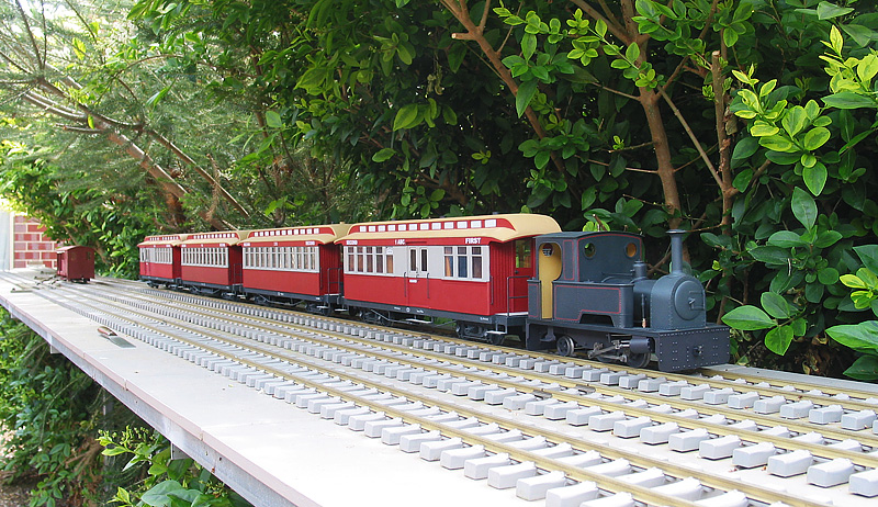

Post by GTB » Wed Dec 08, 2021 4:15 am
Eighteenth Steam Run 6.jpg (301.62 KiB) Viewed 67834 times
"When I grow up, I'm going to pull passenger trains, just like my Dad." .............

GTB wrote: Wed Dec 08, 2021 4:15 am "When I grow up, I'm going to pull passenger trains, just like my Dad." .............
Seems to have plenty of puff, Graeme.....
Posts: 1710
Re: TVT - The Skylark That Couldn't
Post by GTB » Fri Dec 10, 2021 4:49 am
ge_rik wrote: Wed Dec 08, 2021 2:57 pm Seems to have plenty of puff, Graeme.....
I haven't tried it, but the drawbar pull measurements suggest it would be able to pull ten bogie wagons. Not having grades helps......
