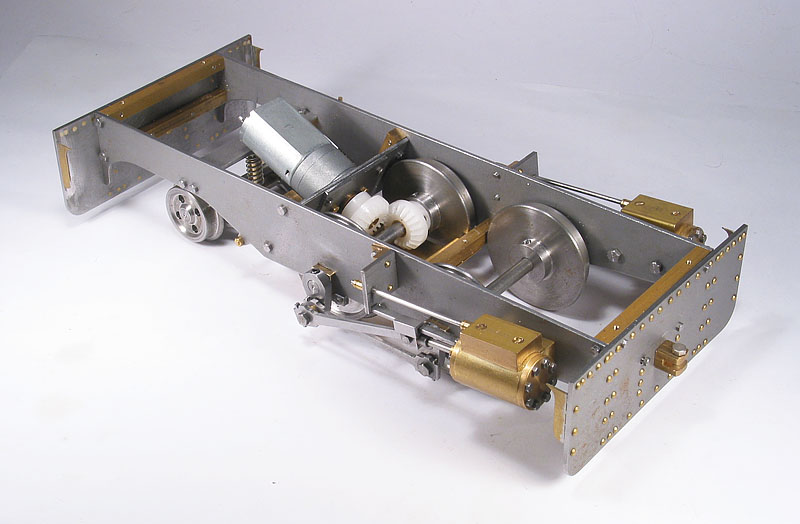

The first job was to build a basic chassis and power train and do some tests. These were successful and pointed the way forward to being able to fit adequate battery power in the limited available space and getting good running and speed performance.
The photo below shows the finished chassis after all the detail like headstocks, cylinders etc. had been added to make it look like a steam loco and not a diesel with a very strange wheelbase. General construction is based on my normal live steam chassis design. Like the old Mortein adverts said, 'When you're on a good thing stick to it'.
The motor is a 6V Pololu 20mm gearmotor with a 29:1 reduction and a 1:1 final drive using 0.8mod Hostalen mitre gears. The large diesel I built last year uses the same gears with a larger Pololu motor and this chassis runs just as well as the diesel. Quiet, smooth and plenty of power.
The motor is mounted at an angle to leave space under it for a chassis stretcher and the spring on the trailing truck. It sticks up out of the cab floor by a few mm, but is hidden by the firebox when the cab interior is fitted.

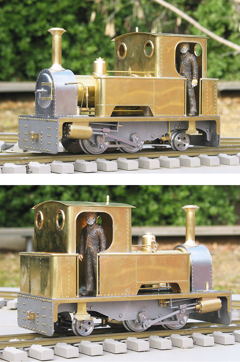

The photos below show the model cosmetically complete. It also emphasises how small a Skylark was, as the engineer figure scales out at 5' 8" which isn't tall by Aust. standards and he barely fits under the roof.

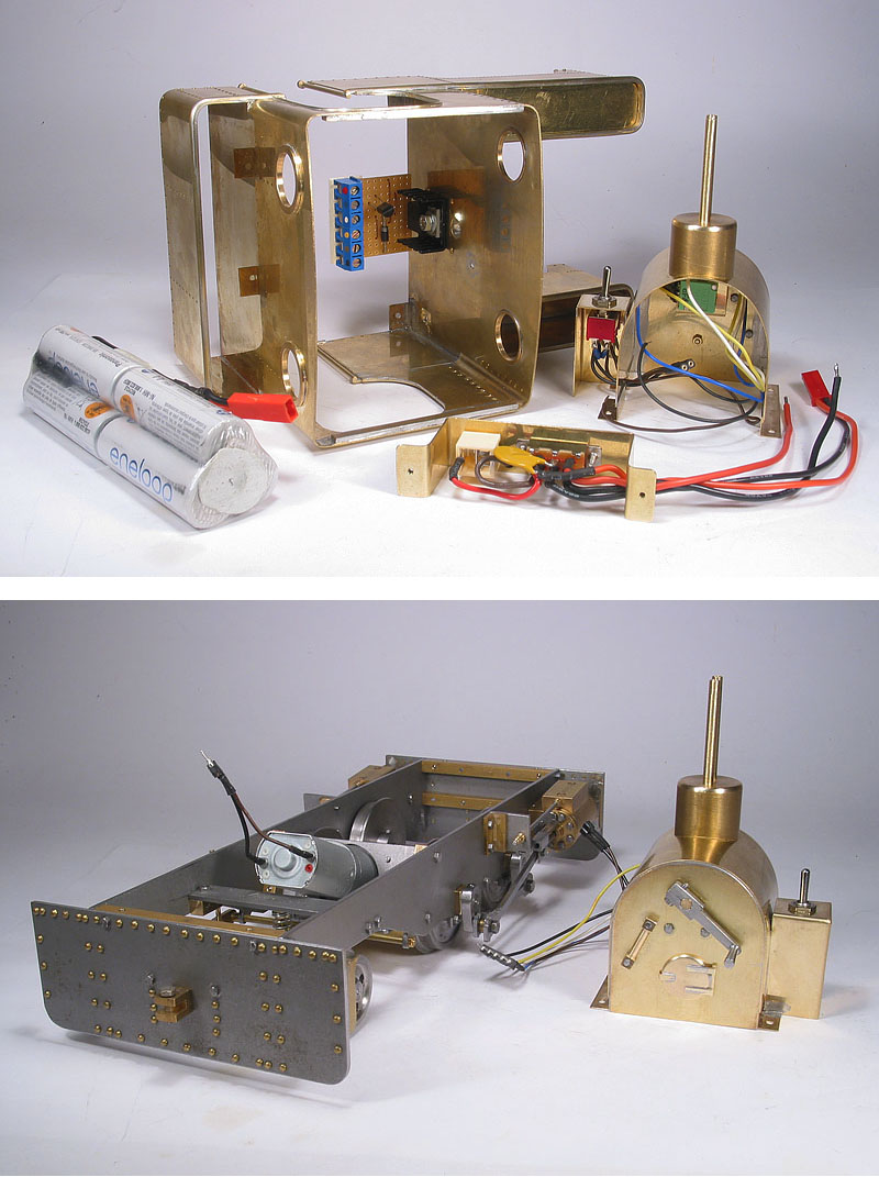

About the time I wrote the first part of this build story, we were in shutdown again and getting some of the electrickery to finish this project got a lot more tricky. Normally I just drive down to the local Jaycar, but that's more than 5km away and probably closed anyway.
The plan was to use the speed control circuit that was removed from the motor mule when it was converted to r/c. The fly in the ointment was fitting the battery pack into what is a very small model by Fn3 standards. The battery cells would fit, but the available battery holders didn't.
Jaycar used to sell long life NiMH cells with solder tags, which could be made up into a battery pack, basically these were Eneloops clones. I prefer the genuine Eneloops cells, but these aren't available in Oz with solder tags. Of course when I went looking online, Jaycar no longer sell their version and the nearest source of Eneloops with solder tags was in the Netherlands.......
There was a supplier of a suitable battery pack in Sydney, but they didn't supply direct, only through agents. I finally ordered one off a small company on the NSW South Coast, who were able to make up a suitable battery pack using genuine Eneloops.
A couple of weeks ago I was waiting for materials for another project to arrive, so I dug out all the parts needed for fitting the speed control in the Skylark and started making the various cosmetic bits that were needed to hide the electrickery and also stop the magic smoke from escaping.
The first photo shows the parts laid out along with the loco body, dummy firebox and various electrical bits. From left to right, the battery pack with a JST plug fitted, the little perfboard with the active components fitted to the cab front (which provides additional heatsinking for the power transistor) and at the front the switch panel with charging socket, switch and PTC resistor for overcurrent protection. On the right is the dummy firebox with the reversing switch and speed control potentiometer fitted inside.
The second photo shows the chassis with the motor wiring and the backhead showing the speed control (throttle) and reverser, along with some rudimentary details to make it look more like a boiler backhead and less like an electronics enclosure. The wiring is fitted with miniature plugs so that the electrical parts can be removed if necessary without having to try and wield a soldering iron in the confines of the cab.

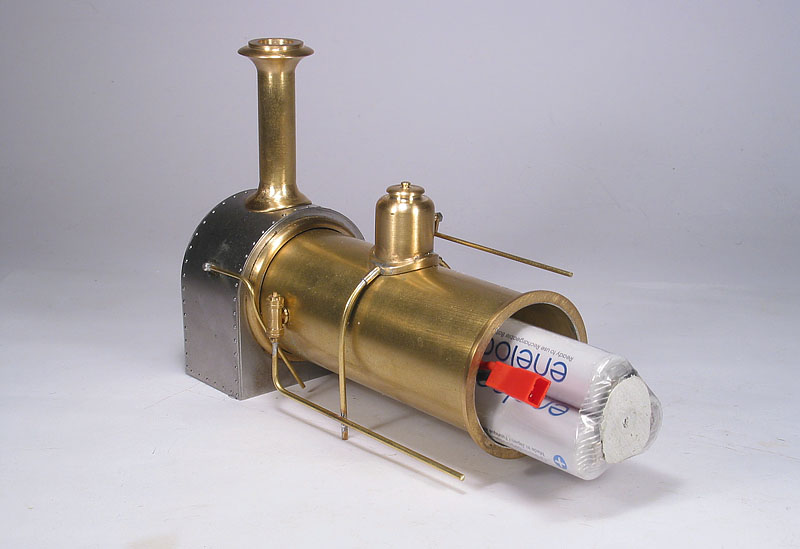

The third photo shows the boiler with the battery pack, which just fits inside the boiler/smokebox assembly. With the battery weight in this position, the loco is much better balanced and is no longer tail heavy.
All of this was eventually fitted in place, with much stress and bad language. Tested, repaired, tested again and finally the loco was bench tested.

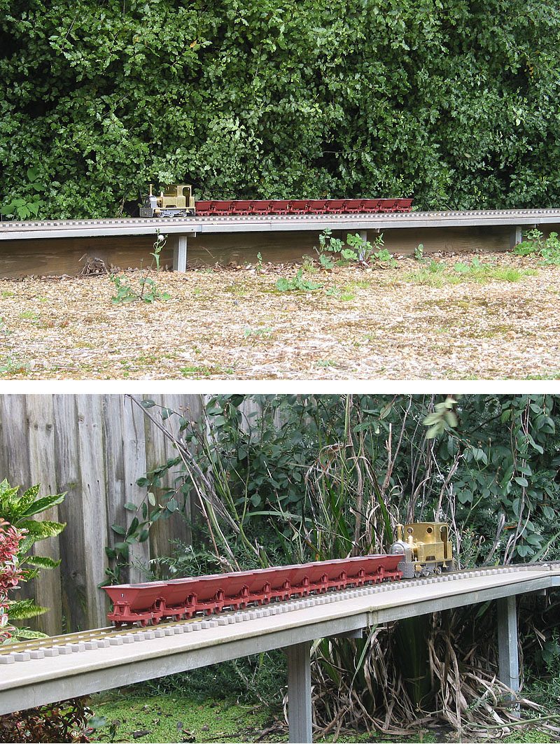

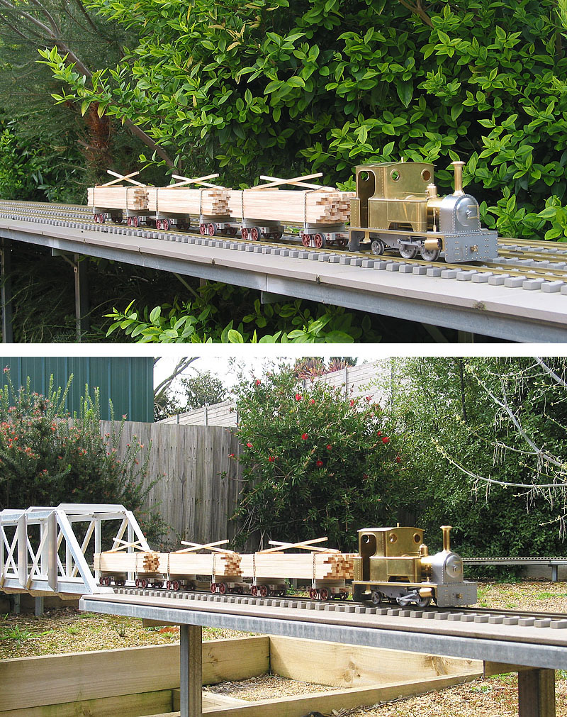

The weather cleared enough yesterday for the first test run outside with a train and the next two photos show the Skylark emulating her sister loco with a string of v-tippers. The first photo is running along the back straight and the second shows the train being pushed back into the yard. This worked only because the loco is pushing funnel first. The very short coupled wheelbase and long overhang makes this impossible if the loco is running bunker first, due to what amounts to buffer lock.
The lat two photos show it on a run today emulating it's prototype on Russell's timber tram, taking a load of sawn timber on it's way to the VR interchange at Gembrook. Unlike the prototype, there were no derailments and three pairs is well within it's haulage abilities. The first photo shows the train made up in the yard and ready to go. The second photo shows it coming off the bridge.
Now all I have to do is wait for the weather to warm up a bit so I can get the model painted and off the list of things to do.

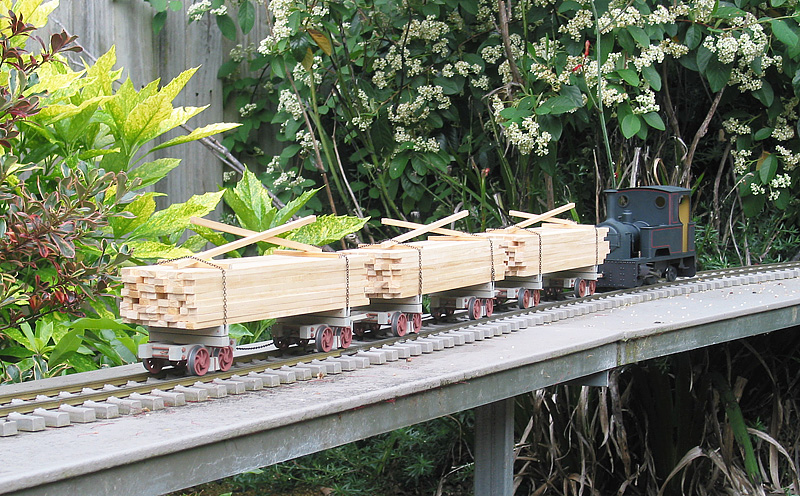

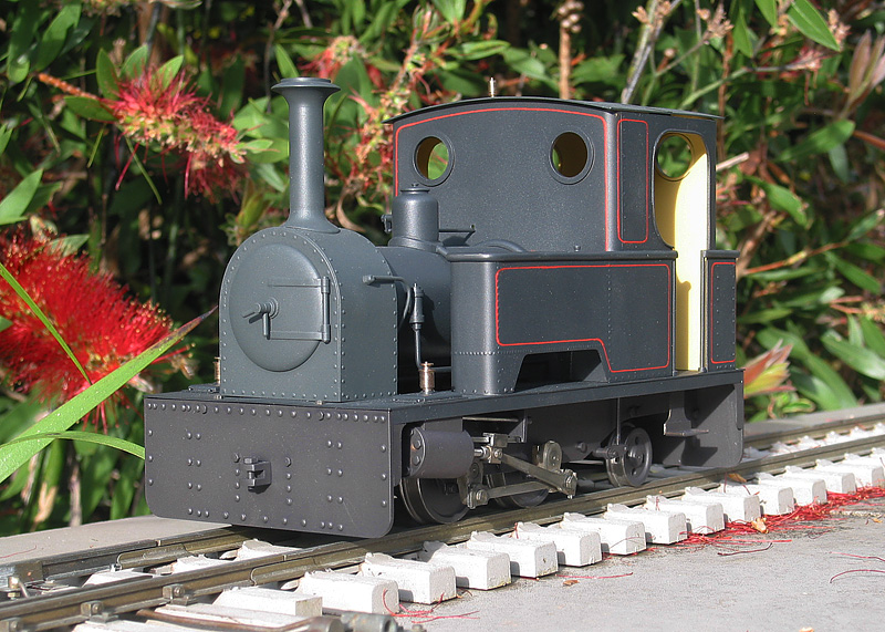

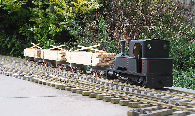

This model has been in the paintshop queue for several months, but the rain has been getting warmer here and with a few dry days, the paint job has been completed.
The original intent was to paint the model in the usual faded black colours, but I recently bought a WW2 vintage US made drafting instrument set. Research suggested it was of good quality and it didn't appear to have had much use. Some tests were run on a painted test panel with the ruling pens and the spring bow pen and the results were better than I've been getting with a more modern German ruling pen.
The plain black colour scheme looked a bit dead, so the decision was made to line it using the new (to me) drawing instruments. Lining is a simple 0.020" red line, using Humbrol #60 vermilion. This was the only tin of bright red I had and while I'm not a fan of Humbrol paint since Hornby took over, the results are OK.
I've been having ongoing model painting problems in recent years, but a change in airbrush a while ago and a lot of experimentation seems to have ironed out most problems, even when using Humbrol. This time around it looks like the varnish has worked OK as well. Of course this varnish formulation is no longer available, so time will tell if the problems return when this tin runs out and I have to use the new version............
This paint job went well enough that I'm now encouraged to put the O&K, that I built earlier this year, through the paintshop next. ....
The first photos show the completed model sitting for it's family portrait in late afternoon sunshine, just before the storm clouds returned. The storm missed us though.
The primer used is an industrial etch primer and the top coat is the usual mixture of three different shades of black mixed from various ratios of Revell satin black, grey and red oxide. The lining, as previously mentioned, is Humbrol #60 and the satin clearcoat is an Aust. brand sold by the big green shed.
The last photo shows the loco pushing a train of timber bogies into the TVT exchange sidings just before the storm hit. I've found with this loco. that it is best to run trains cab first, which minimises issues with the excessive side play at the rear and also increases traction, as the load on the front coupler transfers weight onto the drivers.
