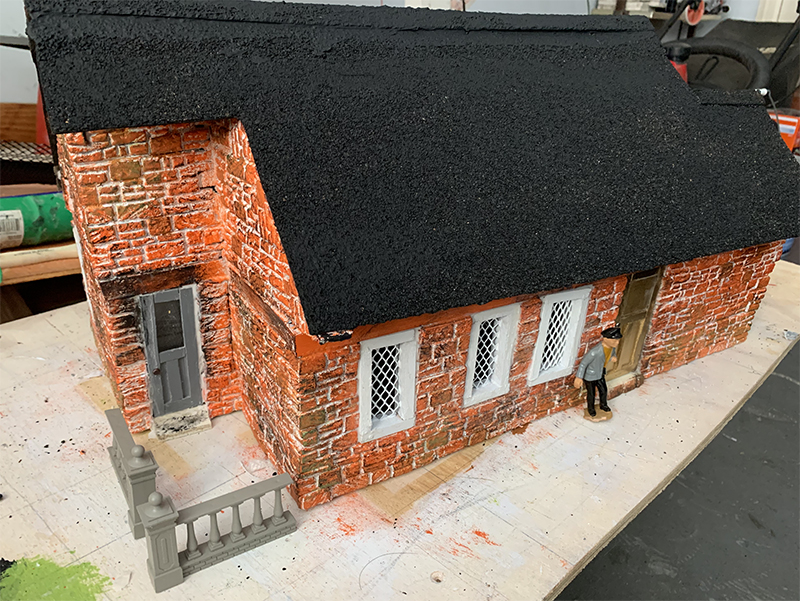

Post by mymodeltrain » Wed Feb 17, 2021 11:12 pm
This is my new jigstone building, made from polyurethane resins.

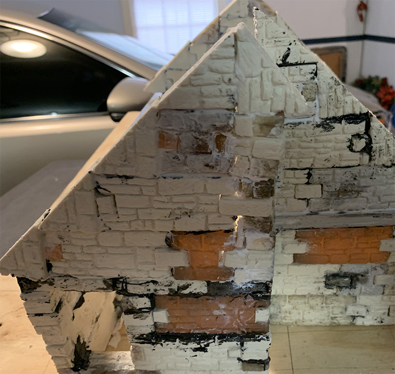

ge_rik wrote: Fri Feb 19, 2021 9:59 am That must have taken ages to cast all the individual components. Presumably you had the mix the resin in very small batches. I suppose the upside is that the resin will set more quickly than concrete.
Looks great. I like the mullioned window frames.
Rik,
Yes, resin heals quicker than concrete. Usually, I can do the casting in the Summer only, and it would take one day for the concrete to cure. While resin heals in 10 min at 50F; so I spent only one hour a night for three nights to get all the bricks I need for the building.
At different temperatures, the color of the product is different. I guess when it is cold the resins didn't diffuse fast enough and they became brown, but when I used a heating lamp, the products are white. nevertheless, I don't mind, since they are equally strong, and I can paint later. To speed up the construction, I used JB Weld epoxy glue. The healing time is 10 min versus 24h if using liquid nail.
This is a very large building. It would be difficult to make it with concrete for the weight. I used an aluminum beam to hold the bricks together, or else the building would fall apart if I lift it up. The other advantage of resin is that I also screwed the beam into the bricks.
To trim and cut the resin-based bricks, I used the sharp blade and wood chisel, respectively. But when I need a more precise cut, a tiny metal hacksaw is great.
The window frames were made of thick wood so they can fit in the thick bricks nicely. While, the mullions are from metal gutter guards. I used super glue to glue the mullions onto the wood frame. Please be careful when using superglue, eye protection goggles are required during this process.
While the doors were made of 3 mm-thick acrylic sheets, and I used the ceramic tile table saw (the blade has no teeth, so it is pretty safe to use) to cut them into small panels. This is the first time I can cut plexiglass into small pieces using the same device to make the door glasses.
The roof was from my house roof; It may not look very nice, but it will survive all weather conditions. An aluminum bar was placed below to ensure the roof will not bend over time.
Finally, dry-painting method must be pointed to Rik's website for further instructions.

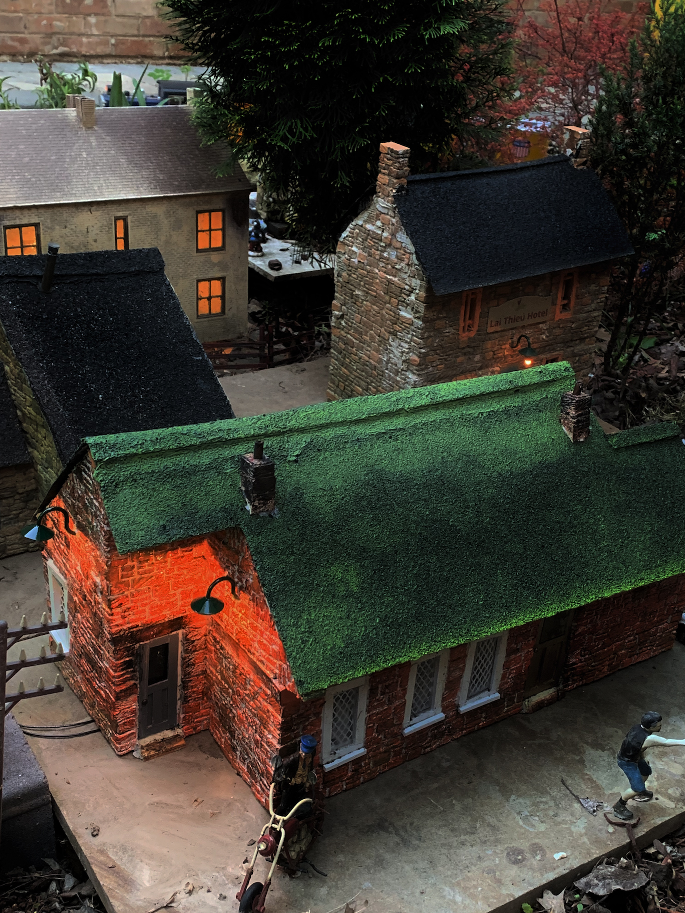

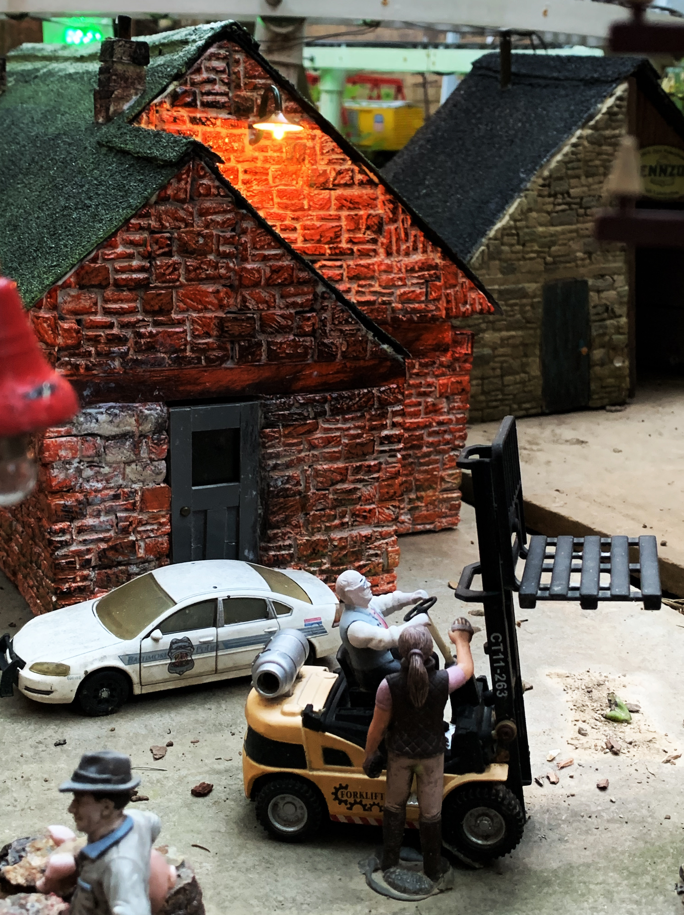

I brought the building out to the garden during the weekend and wiring to light it up.
jigstone building_2021.jpg (1.69 MiB) Viewed 6335 times
Jigstone building_2021_1.jpg (1.96 MiB) Viewed 6335 times
