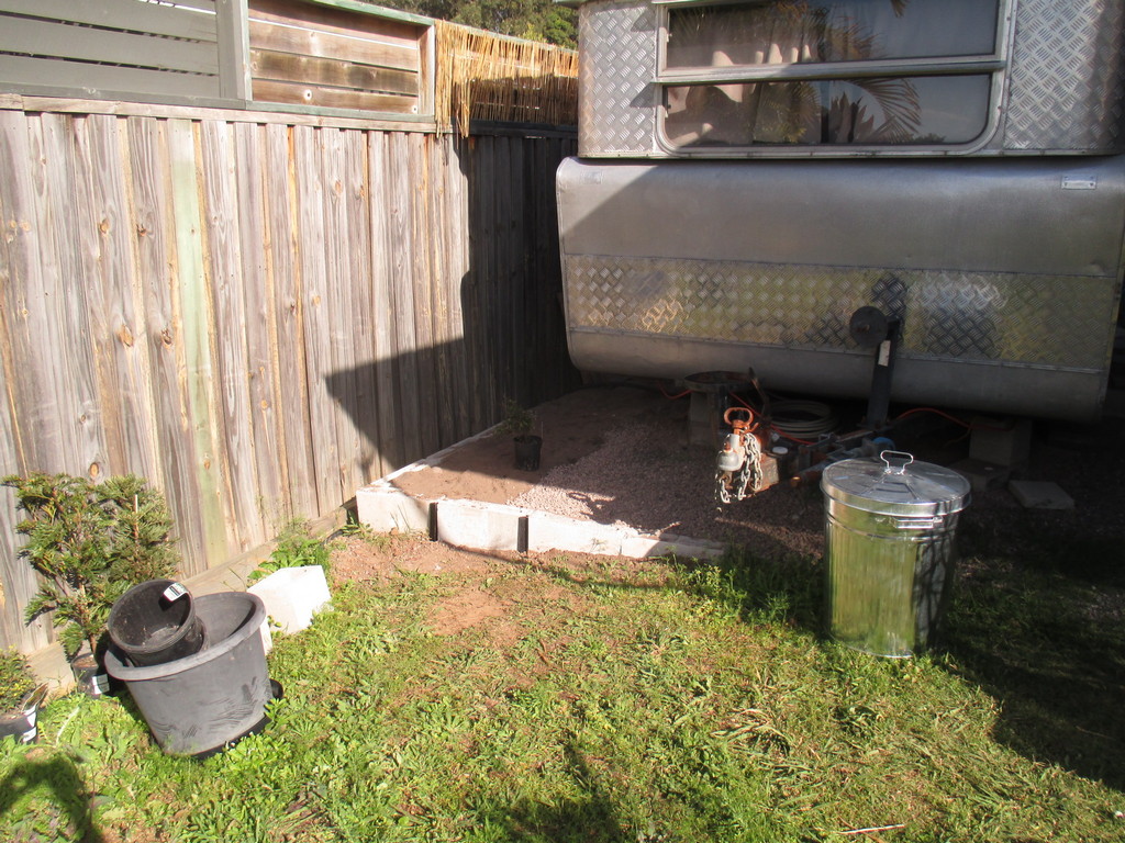

Not much to see, but levelling off the future site of "Phase Two" was finished yesterday. Still some odd junk to tidy up, ahead of a routine tenancy inspection next week.

With The track of Stage One nearly complete, thoughts turned to getting Stage Two built before the weather gets too hot.
Was surprised to get this knocked up in a day.
This will be an elevated mill yard, loco shed/servicing, and navvy siding. Maybe a "dead row" if I can squeeze it in, we'll see once the points arrive..
The timber frame is only untreated pine held together with chipboard screws, as it needs only last a few years before we buy a place. A cat-run we built from the same cheap timber, lasted eight years in the constant humidity of our last yard. Cautiously-optimistic about this..
