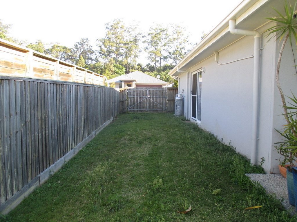

Long story short, my folks and I put our money together and moved to another rental house back in August of 2019. Their plan is to save up over "a couple of years" for a house deposit, but the way the world is going, I'm not convinced that's entirely realistic for us. These new houses are crammed together like sardines, built like cardboard boxes, and priced like five-star hotels. I digress..
In any case, I find myself in need of some sort of tramway on which to test whatever with which I keep myself busy building. It'll also function as a test-bed for structures and scenery - When we buy a house (if I live that long! :D ) I'd like by then, to have a stockpile of weatherproof structures, track and detailing ready for use. I've spent so many years building things, testing by trial and (mostly!) error, I just want to get on with building something reliable to enjoy in the long-term.
21/08/2019

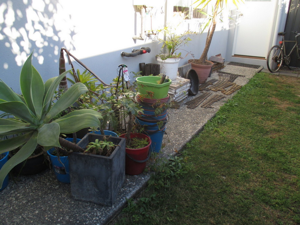

The slate here is pretty dismal, but at least (besides the slope towards the fence) it's mostly a blank slate. The tramway area is roughly 13' x 25'.

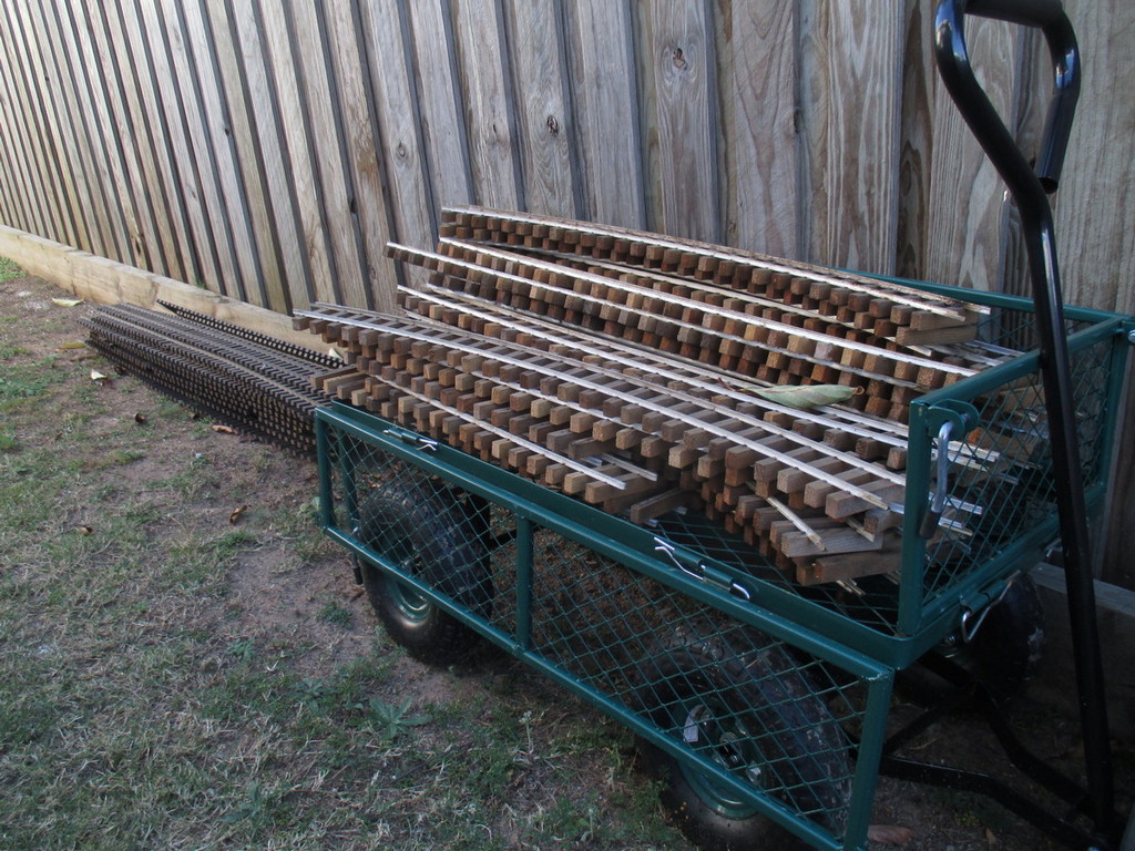

I've plenty of track leftover from the Bad Old Days, (my first outdoor line) and a temporary setup along a closed industrial formation.
A smattering of plants salvaged from the last garden also helps.

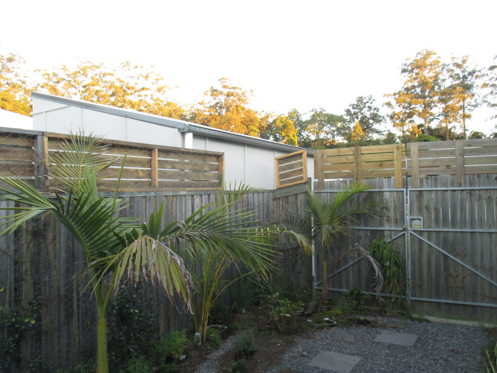

A railway isn't the only thing planned for this side-yard, so the fence needs more privacy extensions. The fence itself also needs disguising. Some jasmine plants were bought to cover it, with chicken wire as something to climb on. The neighbors have started erecting a shed on their side, so I'll have to wait for them to render it's walls, before I can fit the last of the fence extensions, and the second, higher roll of chicken wire.. The owners of the house aren't concerned by any of this, as we have a spotless record in over 20 years of tenancy, and even though when we move, I'll be taking as much as my own added plants etc. as possible, we're still increasing the value of the property with this screening and future garden, at no expense to the owners. Worst (unlikely) case, if the owners don't like it, I figure anything I put in, I can pull out later.
Some of the jasmines have been re-potted in some old buckets with drainage holes, to let their root systems (and therefore the rest of the plant) expand a little. Bricks, old and new, will be retained with some star pickets, and hold the earth away from the fence, when I get to leveling the yard.
The timber under the gates has been packed up a bit, as the yard slopes not only toward the side fence, but also toward the gates. I still don't think the yard will be level enough, and will likely re-hang the gates a couple of inches higher, and so they open outwards rather than inwards.

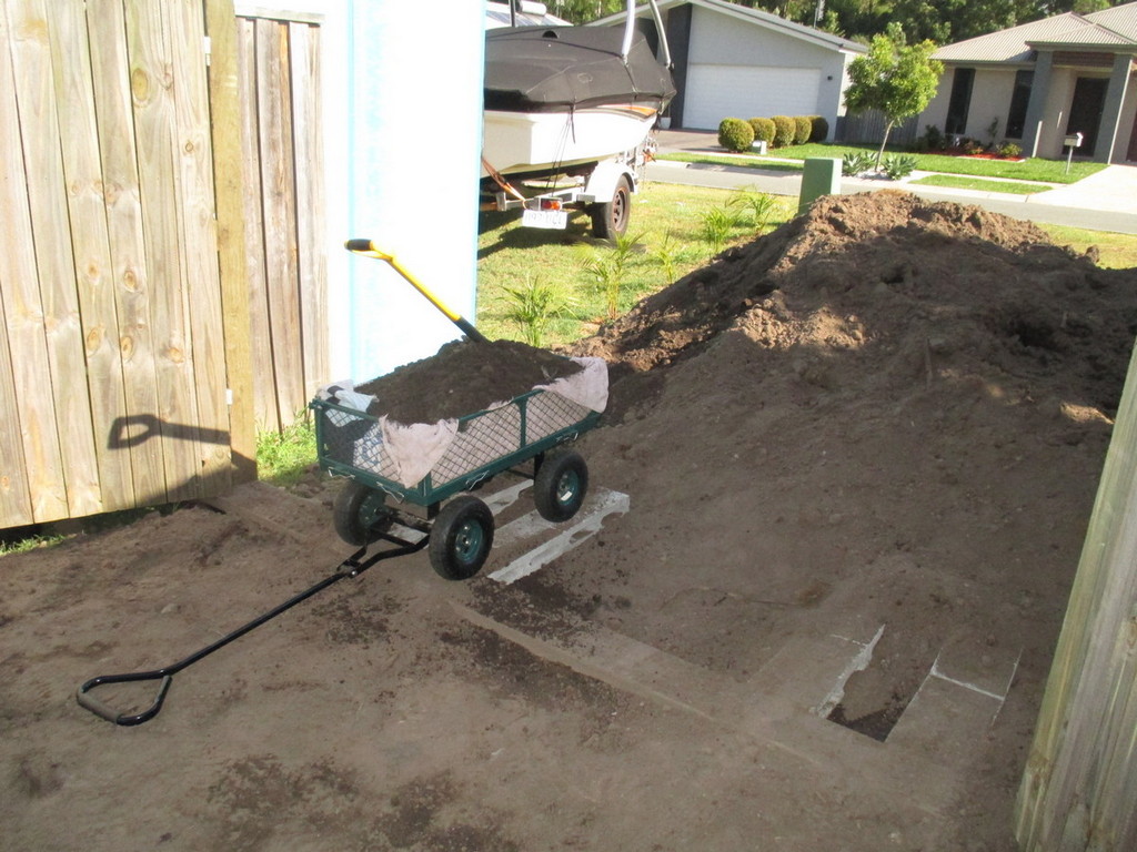

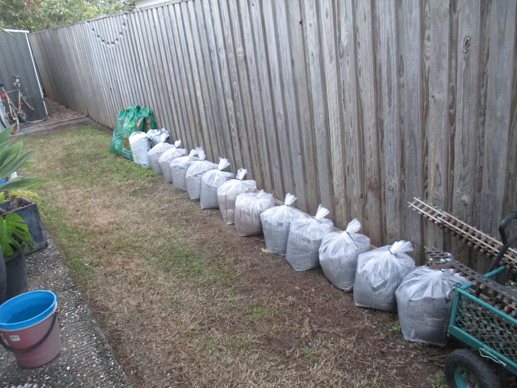

I'd never calculated volume for landscaping before, and chronic fatigue is a vicious b****, so I gave up and erred on the side of caution, ordering nine cubic meters of soil. Honestly, I was rather shocked when the truck turned up. :roll:
Accounting for settling, this was almost double what I really needed. But it was only $225-ish including delivery, so I'm not complaining.
The navvies soon got stuck into moving the pile. They soon gave up, leaving their tools onsite, then headed to the pub, until I provide them a workable place to lay track..
The garden cart was pressed into use, and I slowly chipped away at the pile over the next fortnight, moving a cart-load or six, then going inside to do work on things less exhausting for a few hours.. I had a bit of help some days later, for which I was grateful.

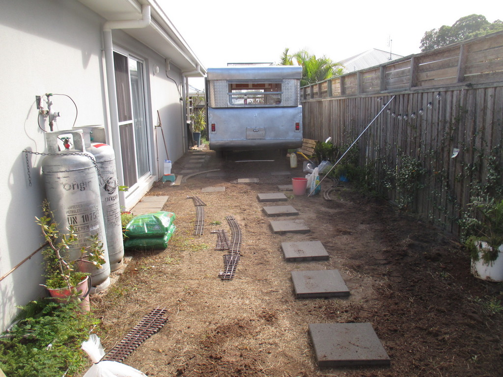

02/12/19

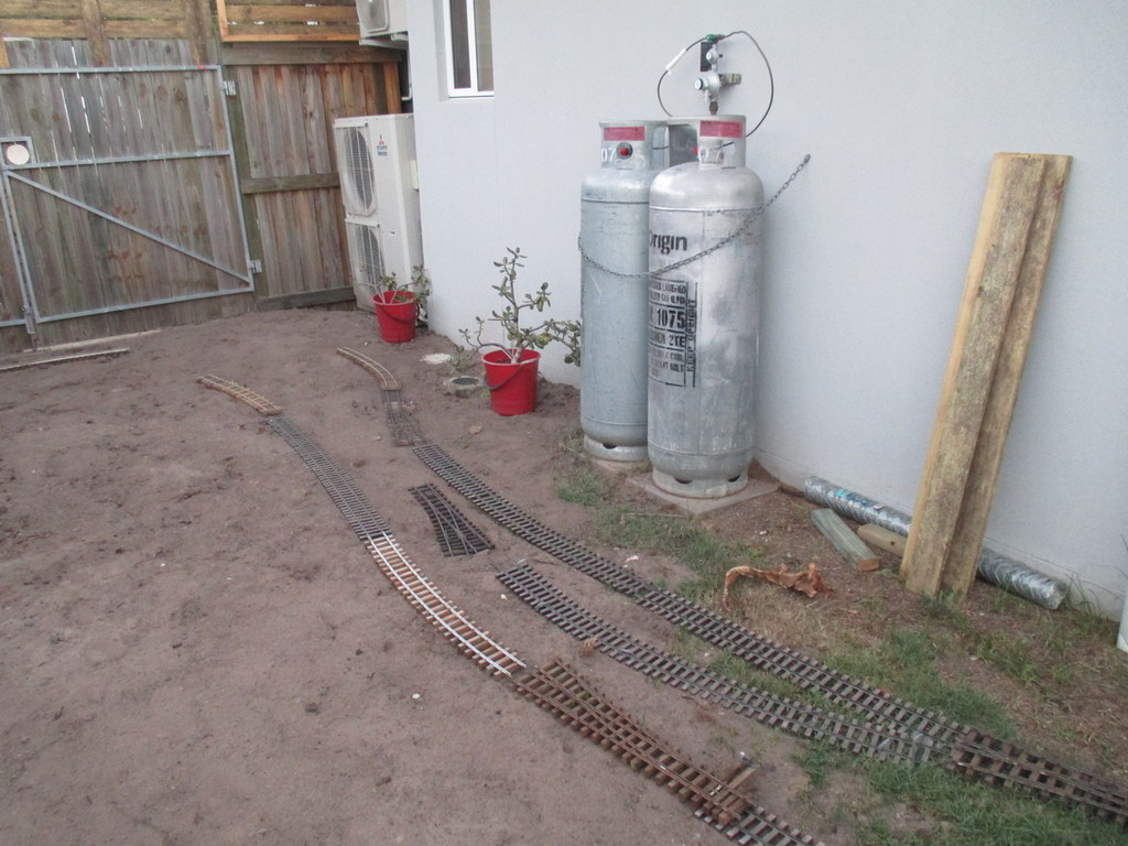

The garden area is now mostly levelled. The opportunity was taken to try out a track plan. Still not sure if I'll include the buildings in this setup, or leave them around the back of the house to test their weather-proof-ness..
The gas bottles (for the hot water system) need to remain accessible for the gas people and their bottle trolleys. Two removable bridge/ramp units will be made from marine plywood, to allow the trolleys to pass over the track - once I decide on a track layout.

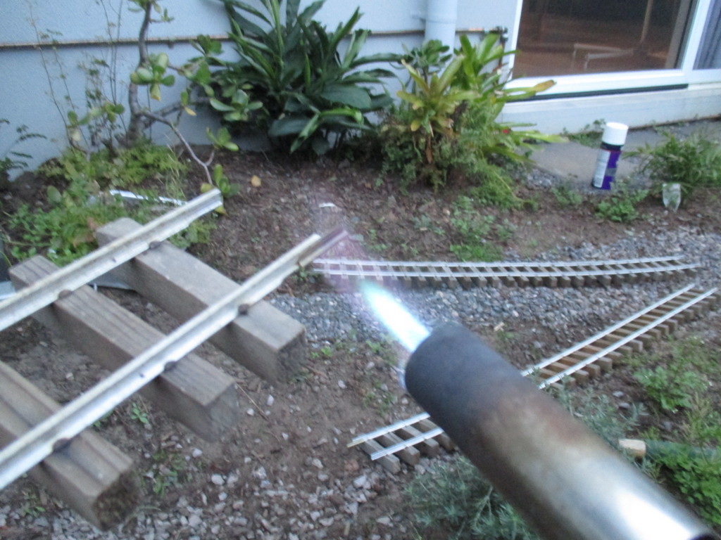

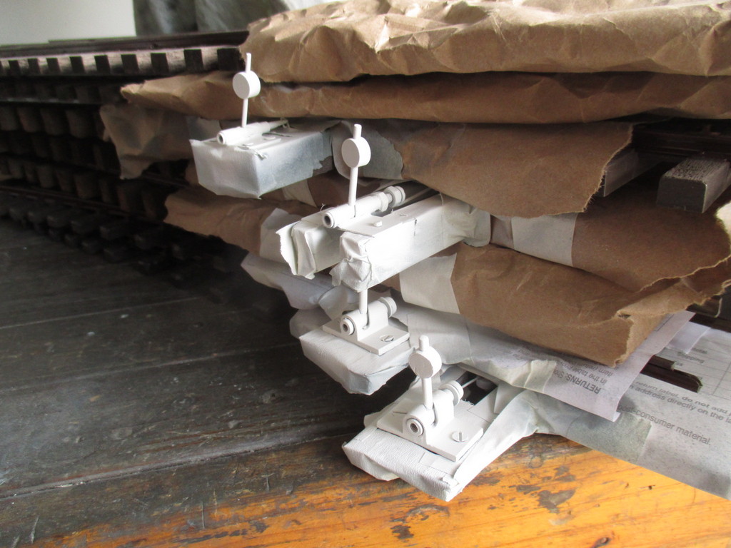

All the leaves, dirt etc. were washed from the points, and the throws masked off, etch-primed and sprayed with Dulux Metalshield flat white. The counterweights still need some red paint, yet.Image

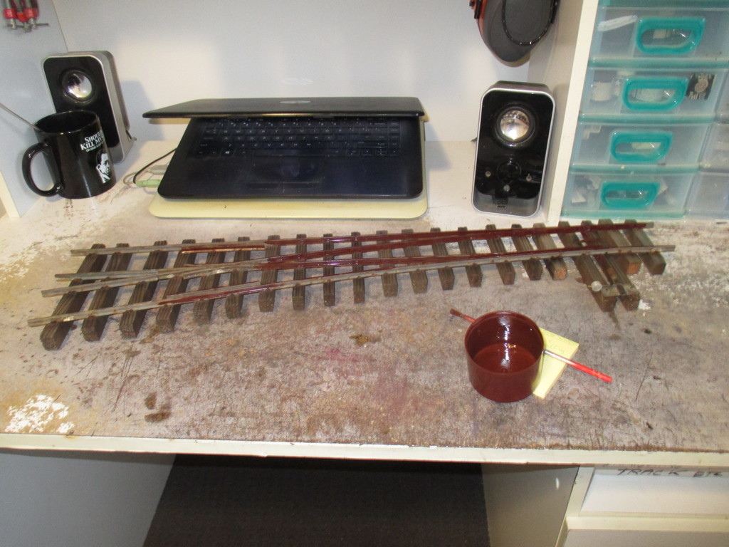

Given I went to the trouble of re-timbering that second-hand curved point, it would be a shame to let it sit in storage for who knows how many years until we buy a permanent place. I'm not planning any extensions to this line (it is after all, a test track) but it certainly provides options..

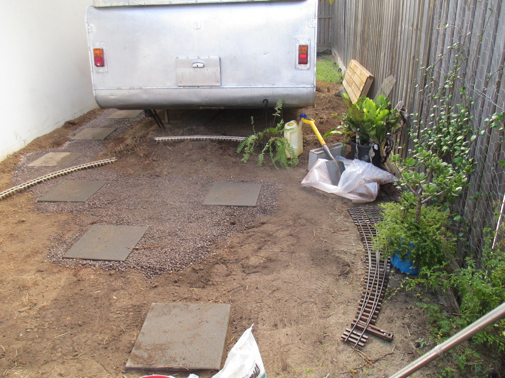

03/05/20

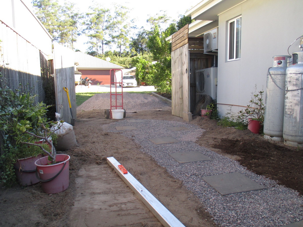

After a delivery of another 2mΒ³ of drainage gravel, (What was I originally thinking with five bags?!) the pathway was laid out.
Scrap aluminium tube from the van, and a bubble level, make short work of smoothing this soft, sandy soil. I've also made a start on bringing the plants around to this side of the house, to help them acclimate to the moderate differences in sunlight exposure.Image
This chunk of wood that came in the soil (and what resembles a track alignment in front of it) gives me an idea..

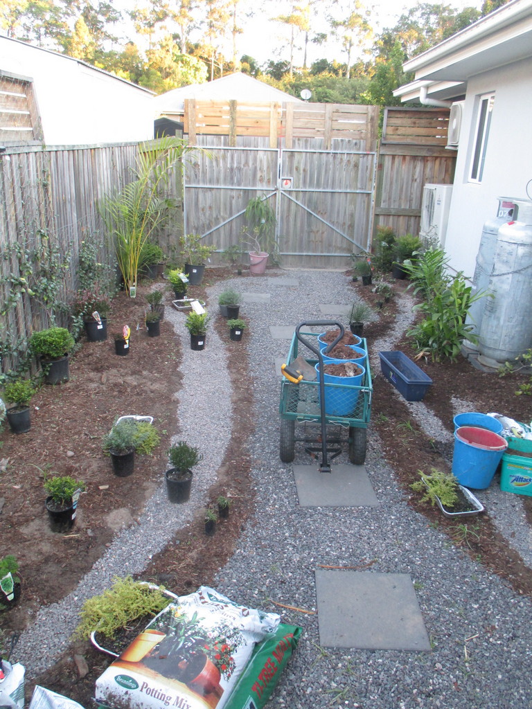

07/05/20

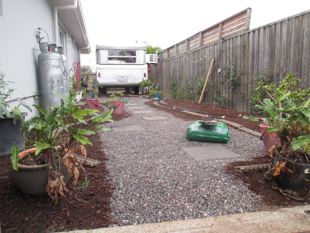

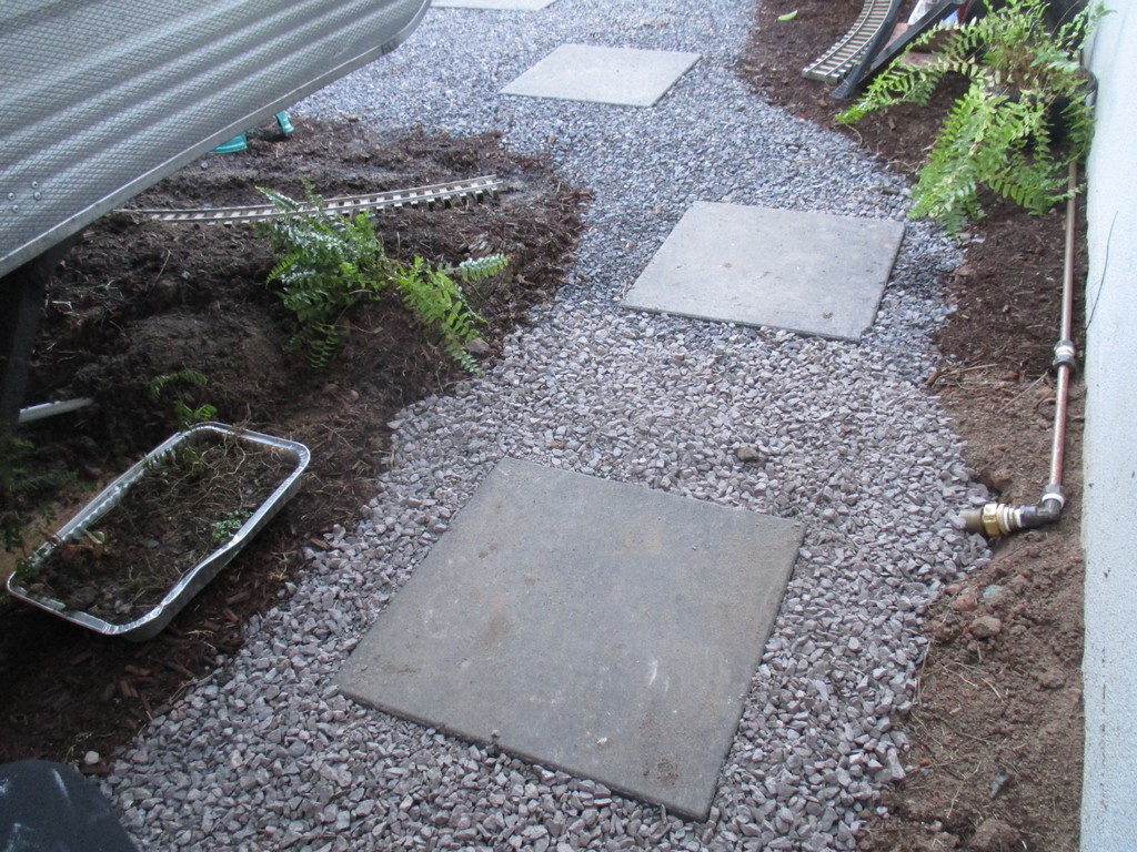

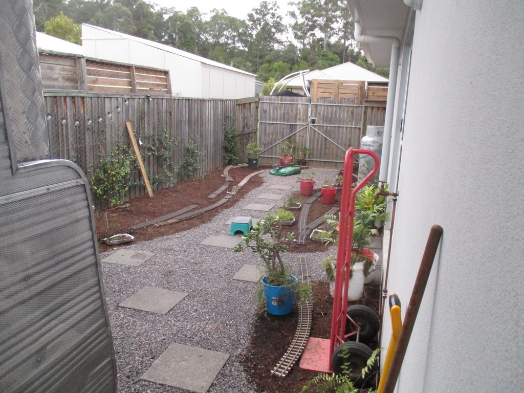

Lots of progress in the last few days. The trackbed areas have been roughly levelled and the dusty soil finally covered with a nice woody mulch, that should fade in time to resemble the "floor" of the bush. The track layout has been reworked to better suit the yard. The plants on hand have been plonked roughly where they'll be dug in - though I'll likely shuffle them 'round again, when some more plants are delivered on Thursday.. A level crossing will be concreted here.Image
The gates have been re-hung - they now open outwards, away from the garden. The neighbors' shed's a bit of a hold-up, waiting for them to fit the guttering - they have to come in our yard for that job. Once that's done, I can fit the remaining privacy extensions to the fence/gate, staple up the remaining chicken wire for the jasmine vines against the fence, then dig the plants in and start on trackbed in that area. Not all that bothered by the hold-up though, the caravan will still take precedence for another month..
Four skewers with little duct tape flags were also planted, to remind me where to plant the larger palms when the time comes - I'm currently using them as privacy screening outside my bedroom window around the back of the house, because the cheaply-made fences around here are too low.Image
Water's now hooked up to the van and the leaks chased up, so the pathway was finished. A small fern and mossy piece of wood salvaged from the last garden were then put in. Again, a concrete level crossing is to follow..Image

Forging ahead there Aaron, the bark, gravel, and the pathway go together nicely. You've certainly cleaned up the area, bet your Mum and Dad are pleased.

Oooh, I'm behind the times on this one - what fantastic progress!
The track plan looks great, I love the sweeping curves. I look forward to further progress - I always enjoy "first train" pictures...

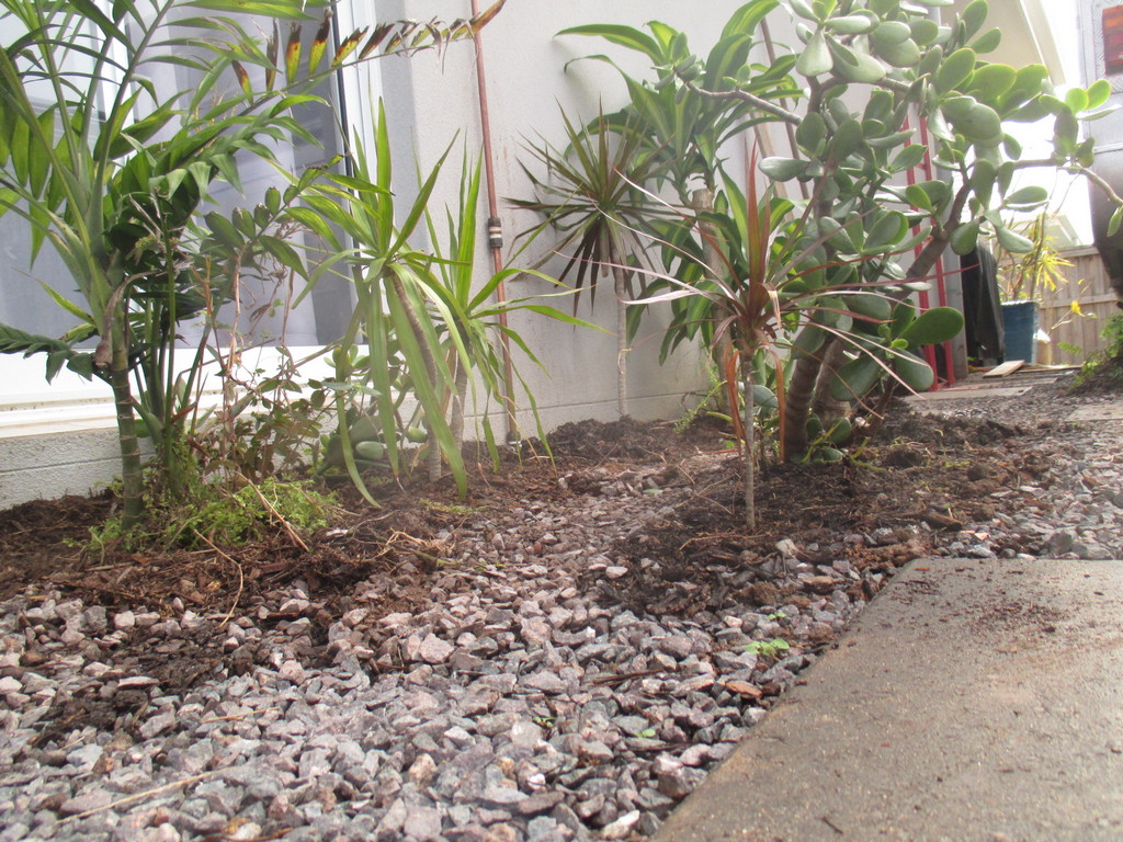

Some more plants delivered, (always need more though) and in trying to use up that pile of gravel (yes, I over-ordered again) I got to starting on the gravel-filled trench roadbed as well.
Mum's a bit of a "tropical enthusiast" and has a number of Dracaena plants, that I've noticed to resemble scale palm trees if kept small. To that end, I've been watering and fertilising them for some months, cultivating the offshoots. I've been doing the same with her Jade plants, which make reasonable miniature "trees".
I left most of these in their pots when I planted them. This will limit their size and make it easier to take them with us when we move out.
I must say, I like where this is going..Image

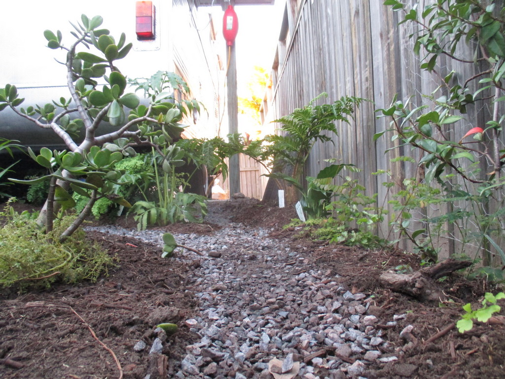

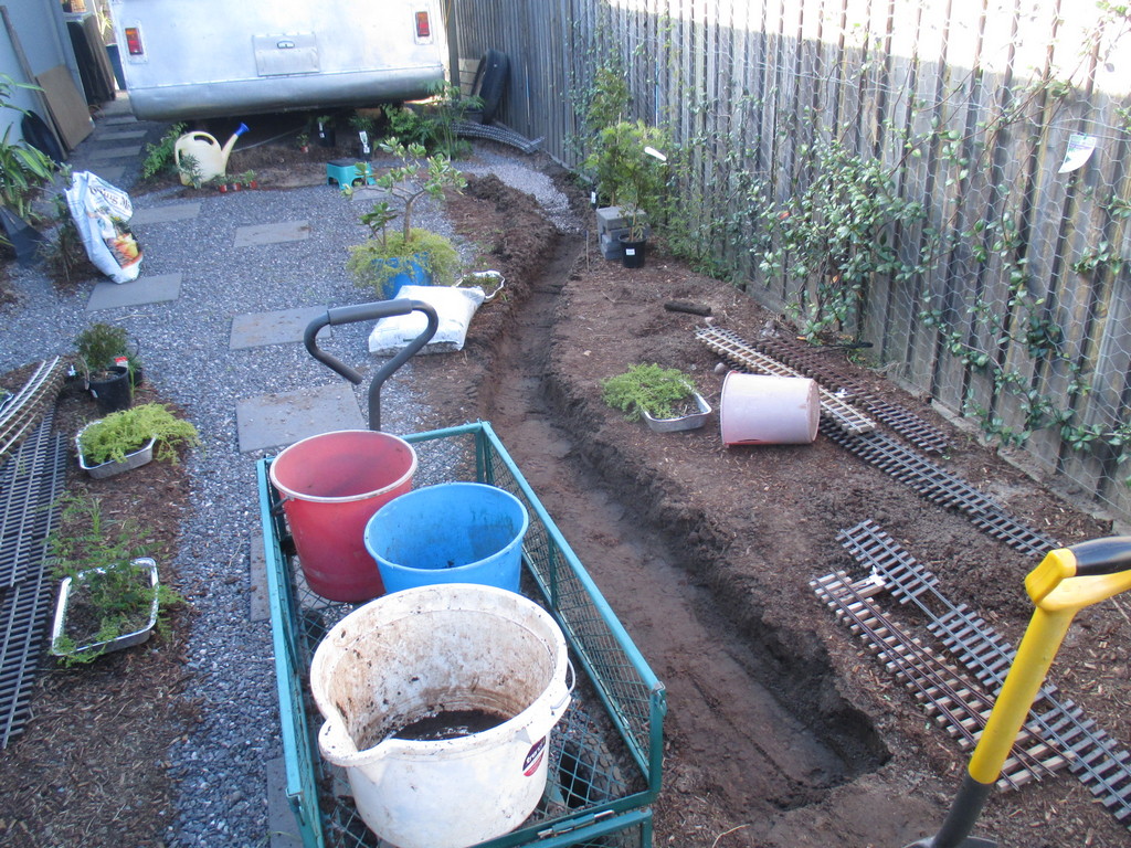

Trench-digging continues, with frequent trips to the back of the house, to dump the spoil. Wouldn't mind having some portable track and a few skip wagons right now..Image

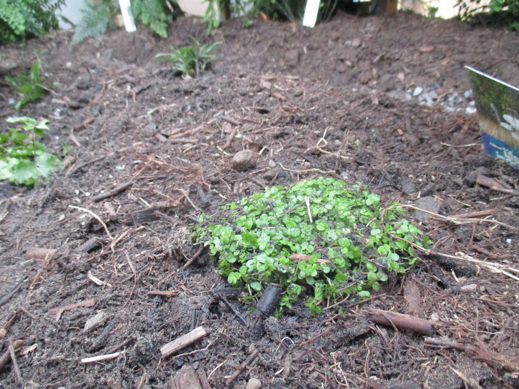

08/06/20

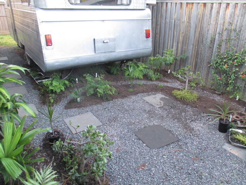

The gravel roadbed is about done, as is the planting at this end. The van's not far off, either - should be living in it by this time next month.Image
For now, I'm leaving most of the plant labels in place so I can keep track of what I've planted. Once they're more established and stable, I can do away with the labels.Image
After watching others do battle with it from this side of the world, for some years now, I finally found some of the dreaded MYOB/babies' tears at the nursery the other day. $15 a pot wasn't cheap though, so I bought two - one was broken into clumps and planted in a couple of BBQ trays to propagate. The other was planted whole, behind the van in full shade, and the surrounding area given a "top dressing" of good potting mix. I'd like to give it a good start so that it might thrive in spite of our sweltering, windy Summers.Image
Some more planting along the West (house) side. The plants in front of the gas bottles are in a plastic window-sill-type flowerbox, which sits in a gravel and brick pit. The edges are then covered over with mulch. Having forgotten to photograph it when I was building it, I'll get a photo when the box is removed next time a bottle is changed out. Still need to build a portable ramp for the bottle trollies, but until I lay track here, I can get away with plonking some marine ply down here when needed. Still waiting on the neighbors to fit their guttering, before the East side can progress much further.Image
Still need to plant these hardy shrubs to obfuscate the air-conditioners. I'll be keeping these trimmed and in their pots, for if and/or when the aircon units need access for any servicing.Image

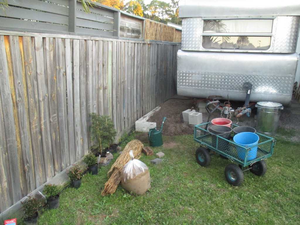

13/07/20
After the final push to complete and move into the van, (always minor teething issues to iron out, though) I was able to return to the garden. This time round, I'm allowing some weeds to grow, rather than constantly chasing them. They help fill in the gaps and look after themselves. Anything too obtrusive (in the way or with large leaves) gets pulled, though. This toilet vent is also obtrusive, being adjacent to the future alignment. I have a suitable building with which to cover this, whilst allowing airflow to continue.Image
Had a bit of a sort-out before moving my things into the van, and found this forgotten slab hut I'd made some years ago. We'll see how it holds up in this fairly sheltered position - it's only made of tongue depressors and pine, coated in polyurethane..Image
19/07/20

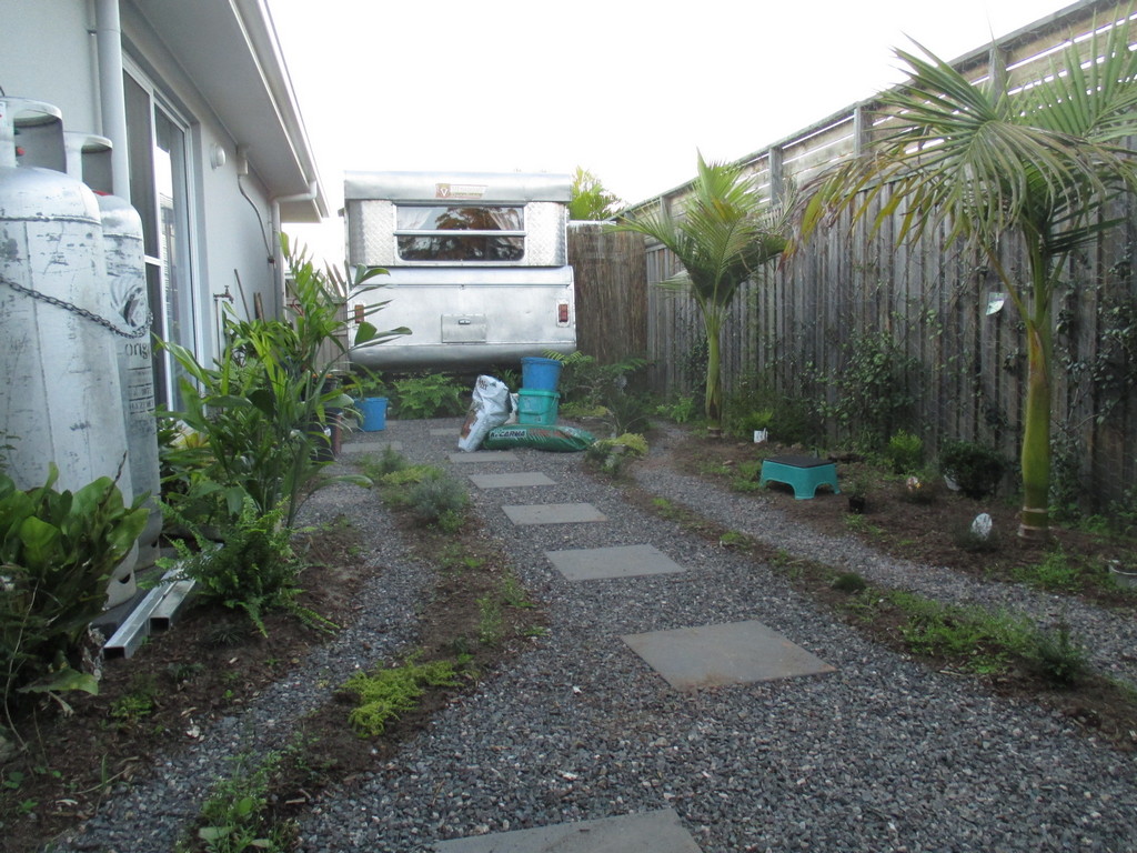

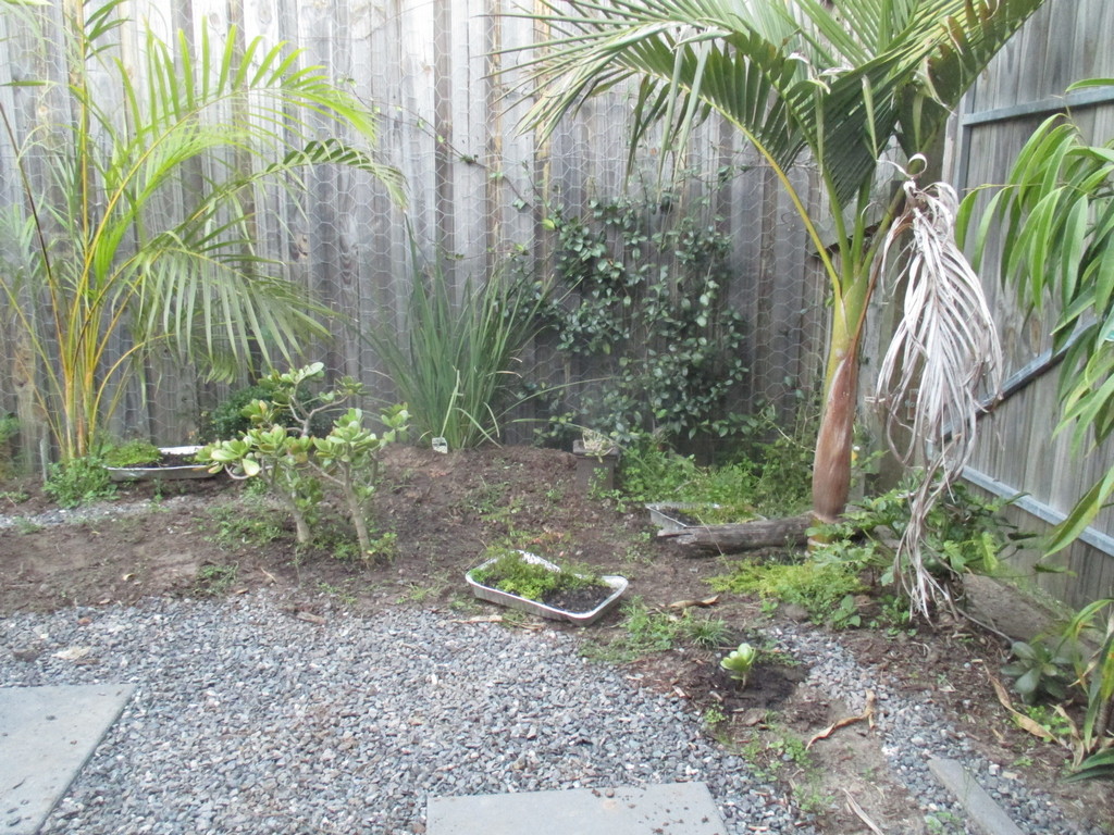

Having moved into the van, I was finally able to move the larger palms around this side, sinking their pots into the ground to allow some chance of taking them with us one day. I was using them as privacy screening outside my bedroom window, to compensate for the substandard back fence. And with those palms in place, locations for a few buildings and further planting could then be determined.Image
The neighbors finally pulled their fingers out and fitted their guttering yesterday. I've only been waiting eight months to fit those remaining fence extensions...
The planting in this corner was also about done. Still deciding where to plant the remaining BBQ trays.

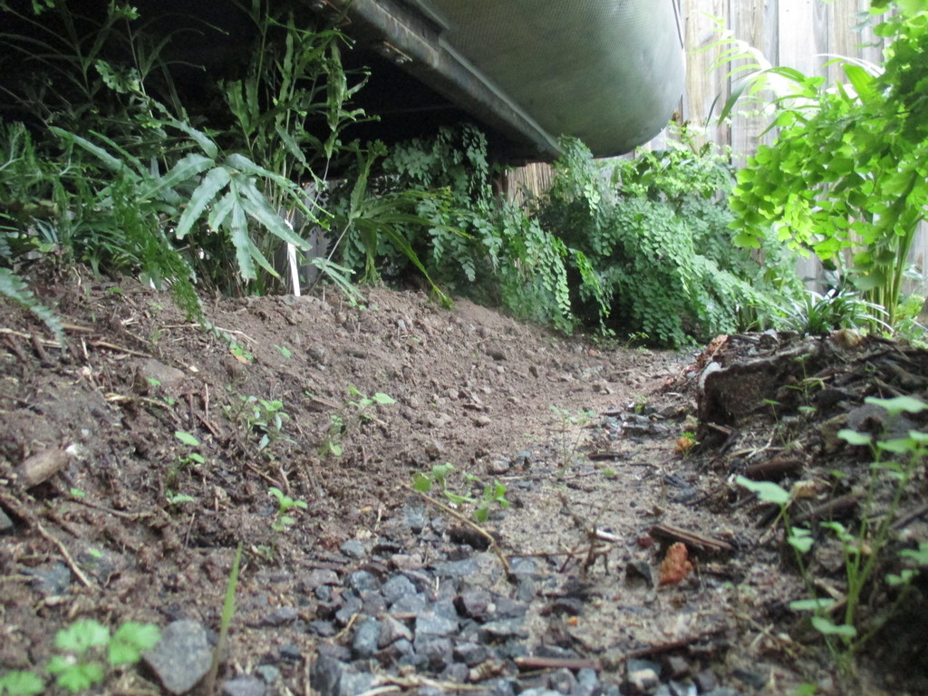

Predictably, the North face of the cutting under the van is prone to washing out, due to the rain running down the ends of the van.
This photo was taken after I'd cleaned it up; I'll have to make some sections of log cribbing for the problem spots.Image
The ground around the Northeast corner of the van is currently being levelled off. It's quite stable, I'm only doing this so it looks presentable when we move out..

Sounds like your enjoying the grand plan Aaron, just a thought could you perhaps silicone rubber an aluminium weather strip across the roof of the van to lead most of the water off to the side somewhere?

Re-directing the runoff, why didn't I think of that.. :roll: Looking at the van, there's three pairs of rivets plugging holes above the rear windows. A hinged stone guard was once mounted there. I could use those holes to mount a piece of channel as a gutter, and pipe the runoff to some water tanks I'll be installing in front of the van. Thanks for the idea!

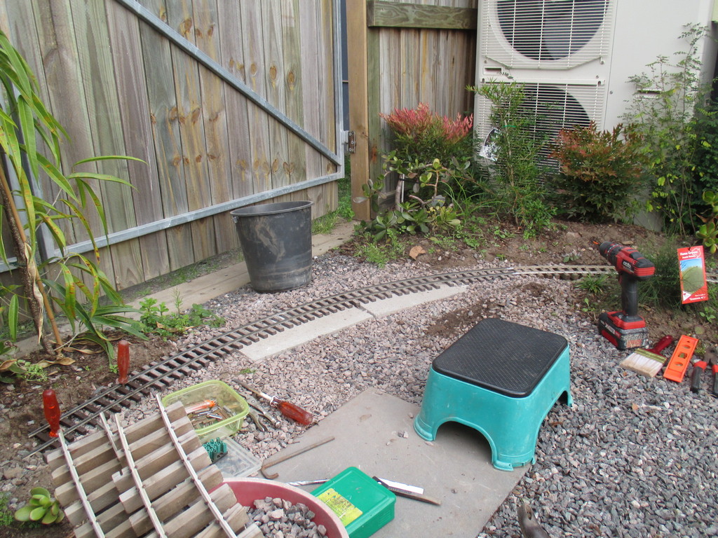

First track the navvies have laid in years, today.
21/07/20
Starting from the middle of a curve isn't ideal, but because the garden is so small, there's little room for variation in track alignment. So it made sense to start with a spot I need to be accurately-placed.
A couple of spare besser block caps provided a solid foundation for the South crossing. Some large flat-blade screwdrivers make reasonable "stakes" to hold flex track in shape. Also quite good for packing gravel between sleepers. The cordless drill is nice to have this time round; really need to re-sharpen that masonry bit, though..Image
A battered 1980s Stainz, picked up for only $100 at a swap meet years ago, and crudely converted to battery power using leftover bits and a PWM speed controller through the roof, makes an ideal track tester. It's nice not to worry about chipping paint, or other damage with this loco. Poor old thing will get a proper rebuild with new bodywork one day..
No derailments yet. Only using enough gravel to merely support the track - it'll be ballasted proper with a mix of crusher dust, sand, cement and oxide dye.
Not sure if the weather will allow more track work tomorrow, but it's nice to just watch the little Krauss trundle about this short section.Image
Cheap pavers are split in half with a hammer and cold chisel; simply to stretch money. These are spaced every 2-3ft, the track being screwed to them via wall plugs.
It was getting dark, so this one's a bit blurry. A butane torch was indispensable for removing stuck rail joiners with (gently) vice grips.Image
