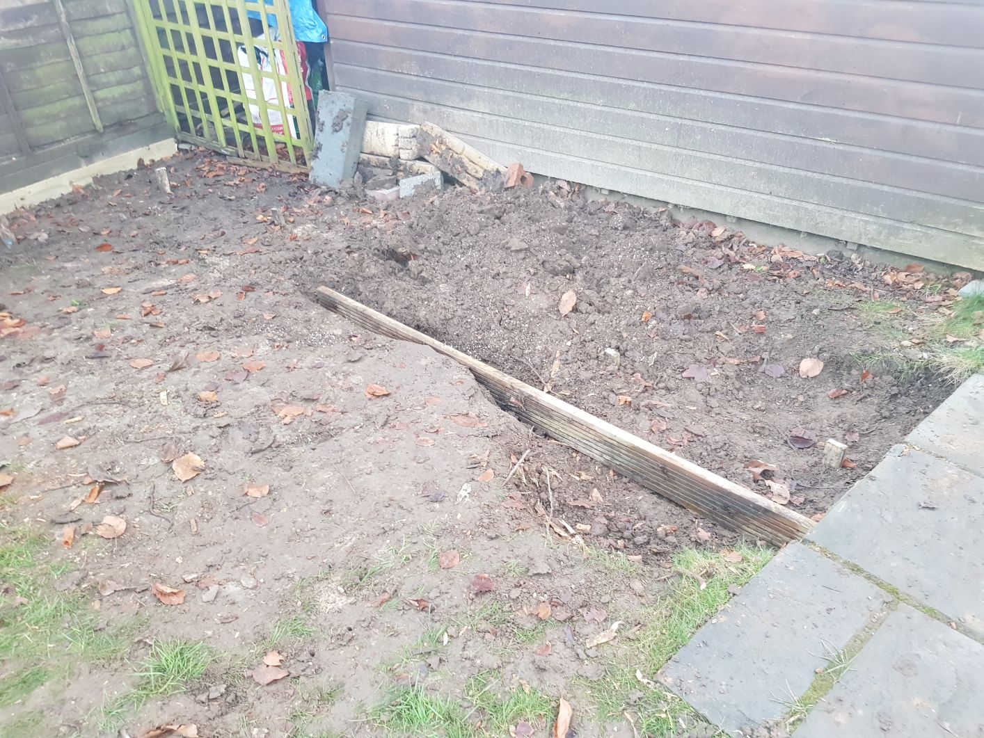

We have a made some limited progress, life getting in the way. The idea is the new station will come off the loop here.
Which means this corner needs some work, a point added and I'll replace the Mamod track at the same time.
The station will then sit next to the shed, using the turn table for the run round. A couple of siding and an engine shed
Looking at the space on the ground, I think I'll place the sidings behind the station building rather than in front. But I'm not sure yet.
We then dug down to put in this old deck board to find the level. I now need to dig this all out to start to form up the area. But I'll start with the extension out of the existing section. Then at least we will have a new siding to play with.

Stations where the sidings are on th same side as the station building are very common full size. It makes road access easier all from one side. Enjoy your project.

Although I can see why you might want to do it, sidings at the back, i.e. furthest from the operating space, can make coupling/uncoupling wagons very awkward.

Which is why it's nice to step back and think about things!
As you can get to the turn table from the path, I might go back to plan A and have the sidings at the front. My other station has them at the back and I don't enjoy always reaching over. The joy of ground level.

Wonderful! I do so like seeing a bit of civil engineering....sjrixon wrote: Sun Jan 12, 2020 8:19 am We have a made some limited progress, life getting in the way. The idea is the new station will come off the loop here.

Another option re the station building/sidings thing might be to put the station and sidings on the other side of the line, ie the opposite side to the shed, so that you see the back of the building from the usual viewing spots? Less conventional from a traditional garden railway perspective, but nothing wrong with that...

Thanks for all the positive feedback. I'm still toying with my track plan, but then that's the joy of this hobby. My last tweak moved the turn table to the entry point of the station, but I'm not sure..
We did get out and really started to sort out the levels today, more tomorrow. I love it when it's cold but sunny.

It's about level!

"about level" was the best I achieved !
I managed to get some sections dead level, in other places I'm sure the ground moved when I wasn't looking.
Eventually decided a spirit level makes it look worse than it is !
