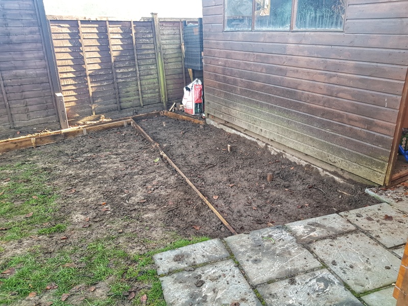

We have a made some limited progress, life getting in the way. The idea is the new station will come off the loop here.
Which means this corner needs some work, a point added and I'll replace the Mamod track at the same time.
The station will then sit next to the shed, using the turn table for the run round. A couple of siding and an engine shed
Looking at the space on the ground, I think I'll place the sidings behind the station building rather than in front. But I'm not sure yet.
We then dug down to put in this old deck board to find the level. I now need to dig this all out to start to form up the area. But I'll start with the extension out of the existing section. Then at least we will have a new siding to play with. :)

Thanks for all the positive feedback. I'm still toying with my track plan, but then that's the joy of this hobby. My last tweak moved the turn table to the entry point of the station, but I'm not sure..
We did get out and really started to sort out the levels today, more tomorrow. I love it when it's cold but sunny.
sjrixon
Posts: 170
Location: Reading
Re: GRR - Light Railway Extension
Post by sjrixon » Sun Jan 19, 2020 5:09 pm
It's about level!

"about level" was the best I achieved !
I managed to get some sections dead level, in other places I'm sure the ground moved when I wasn't looking.
Eventually decided a spirit level makes it look worse than it is !
