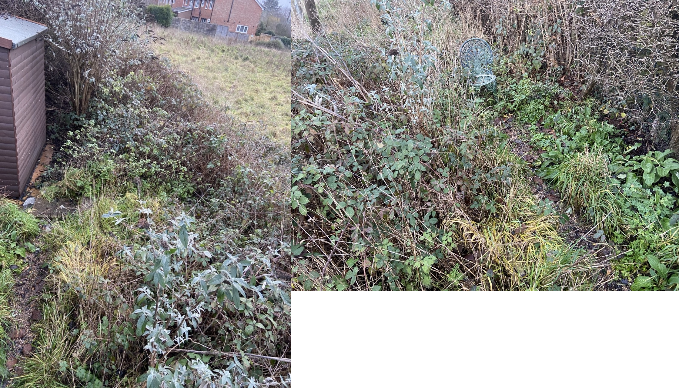

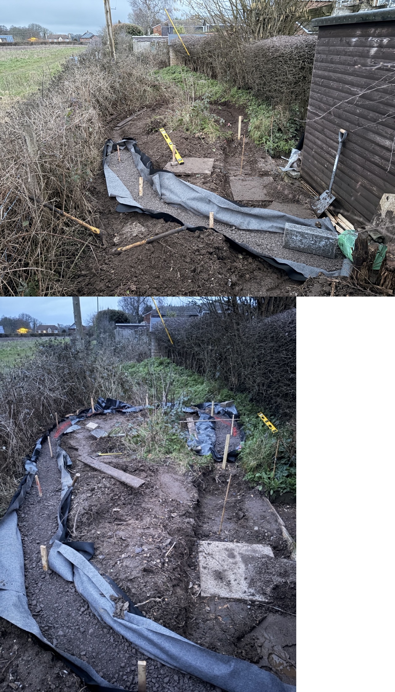

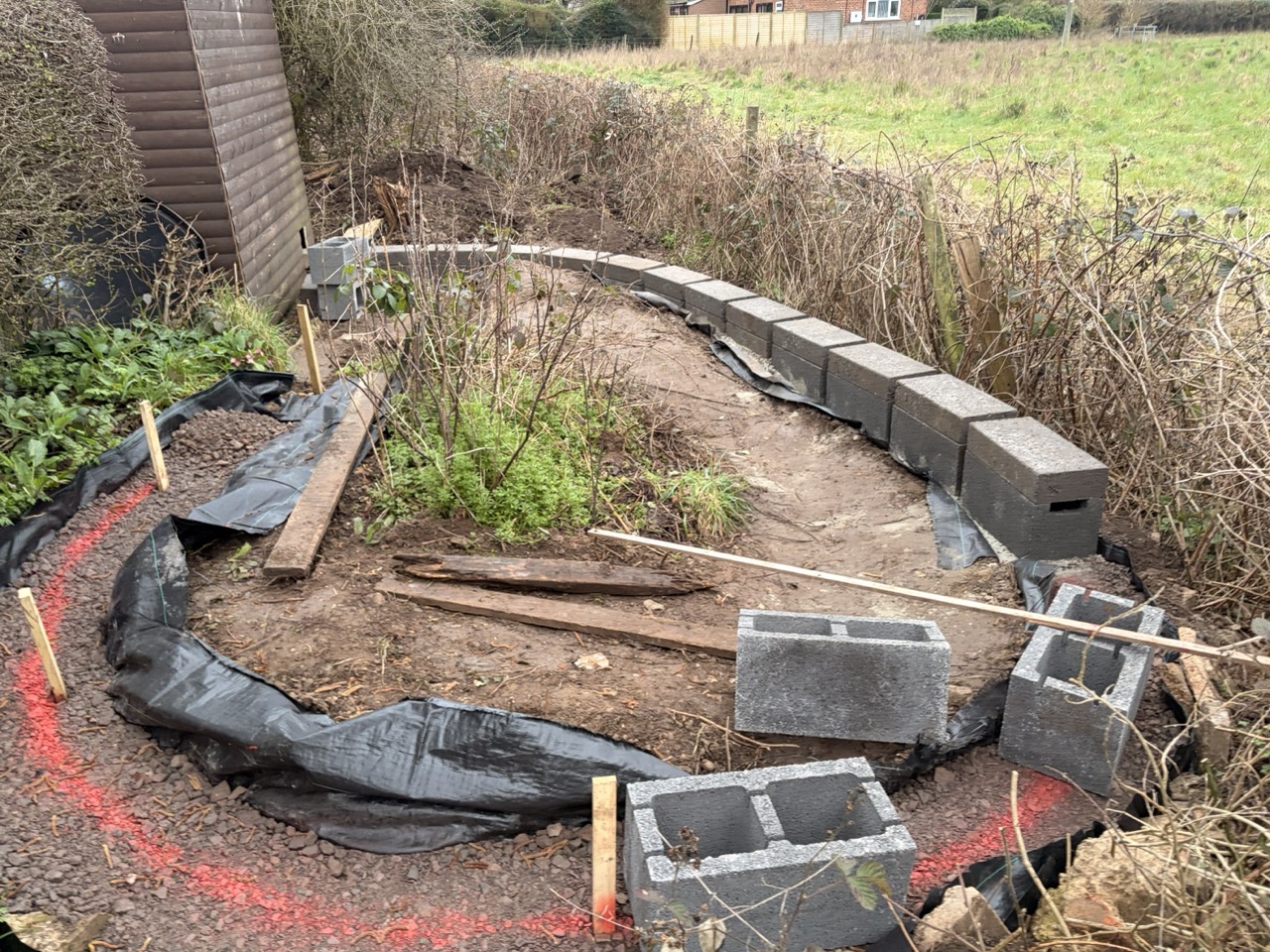

The first challenge was to tame the jungle that had been left to grow for years.
Here is the site - a lot of bramble roots:

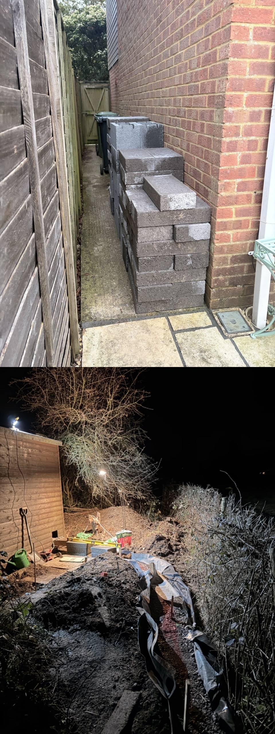

A Mess was made. Aerosols were useful for marking out.
step 1.jpg (1.72 MiB) Viewed 1609 times

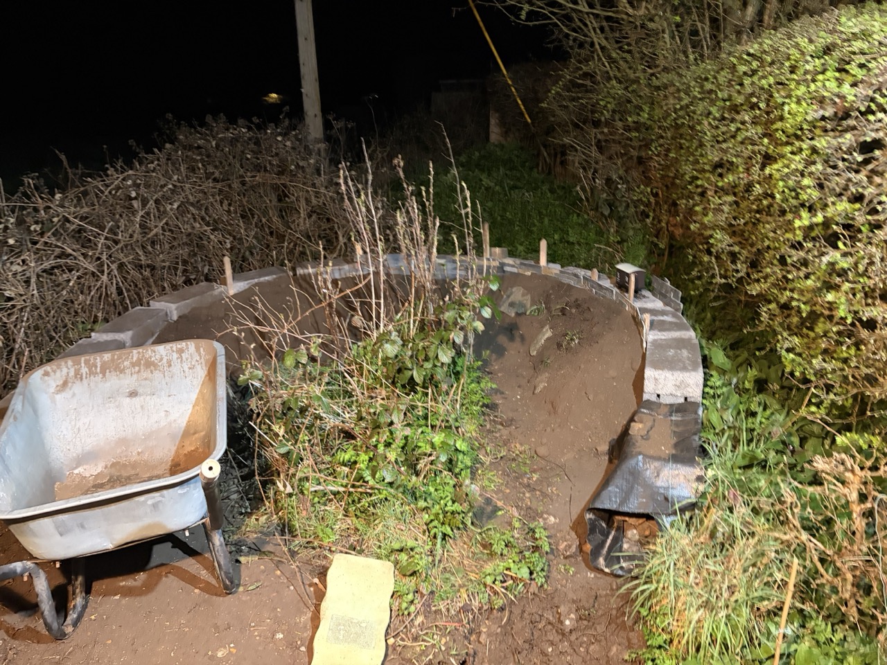

The Mud got worse. Digging is not that much fun.
IMG_3754 Large.jpeg (608.72 KiB) Viewed 1609 times

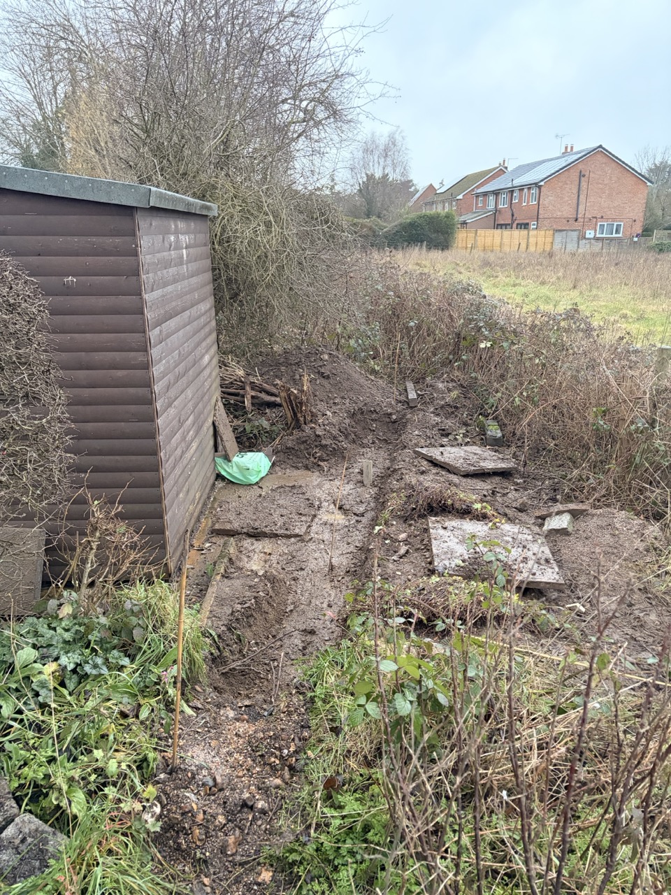

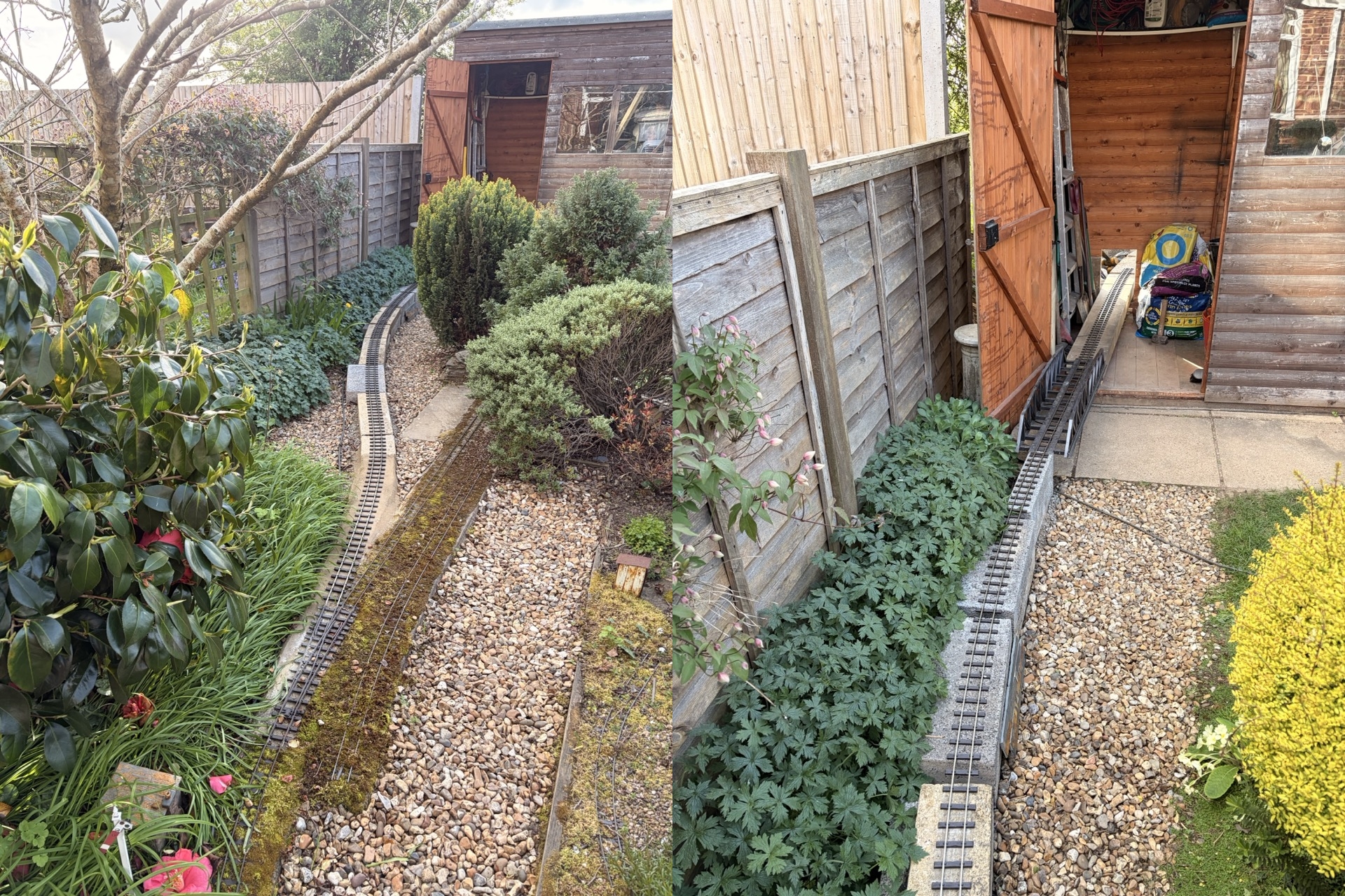

Having made a start behind the shed, I turned my attention to the first section that would connect to the existing railway.
I proudly cut a hole in the shed. The Oak sleeper will carry the track bed. There will be a removable bridge for the shed door.
IMG_3753 Large.jpeg (527.83 KiB) Viewed 1543 times
The blocks here will sit on the existing hardcore foundation from the gravel path. As it gets dark here by 4 pm in February, most of the work had to be carried out after hours by candlelight.
Stakes were used to get the 1:37.
IMG_3811 Large.jpeg (610.64 KiB) Viewed 1543 times

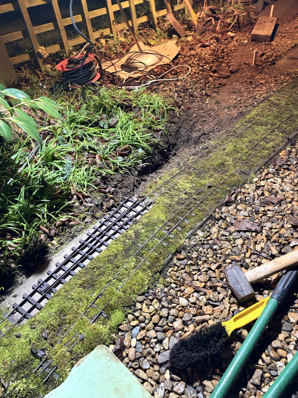

Point in.
It was a shame to remove the moss - hopefully it will grow back once ballasted.
IMG_3797 Large.jpeg (629.36 KiB) Viewed 1543 times

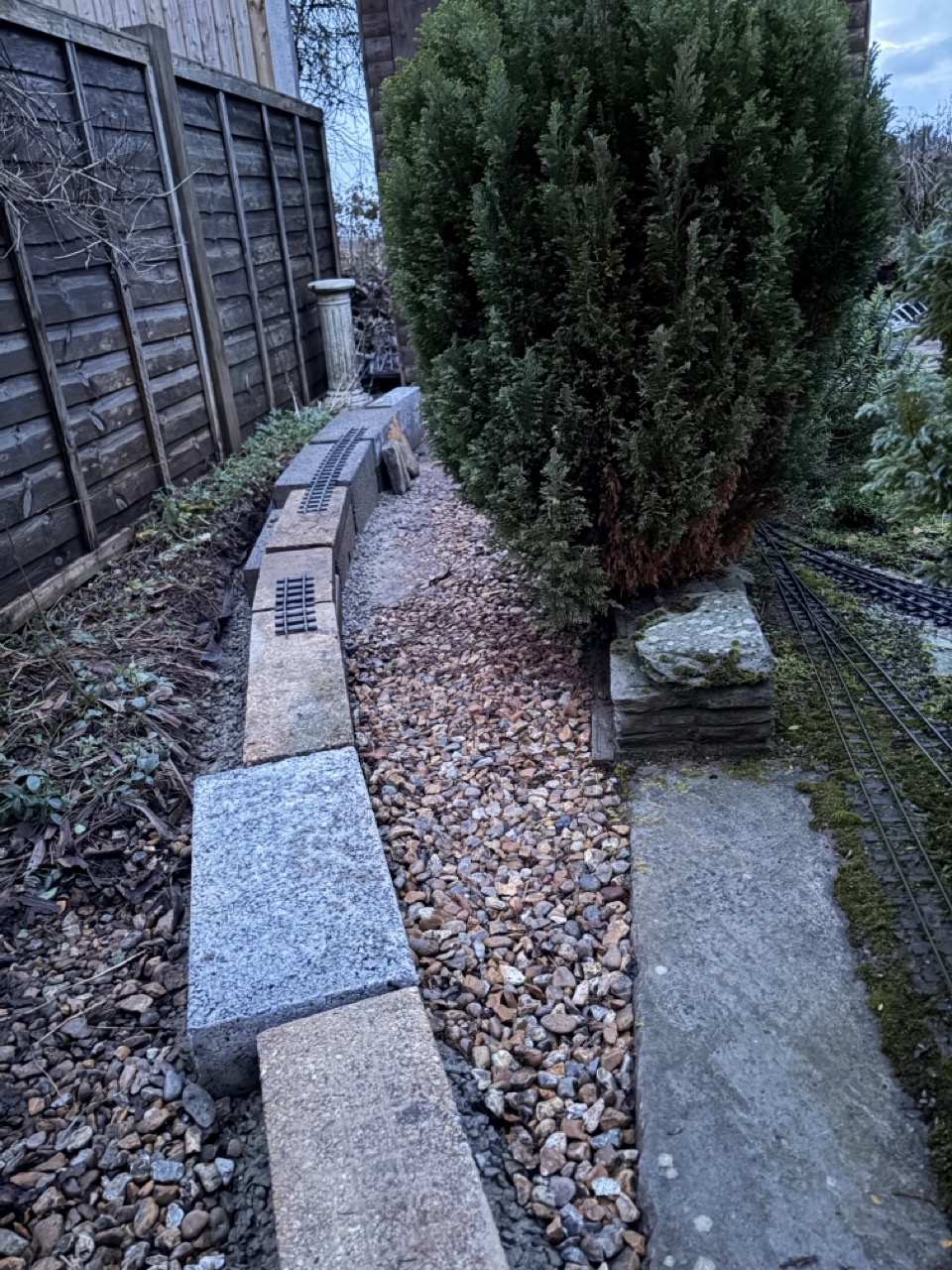

...Continuing on from last time.
Blocks laid up to the shed:
IMG_3857 Large.jpeg (516.69 KiB) Viewed 1475 times

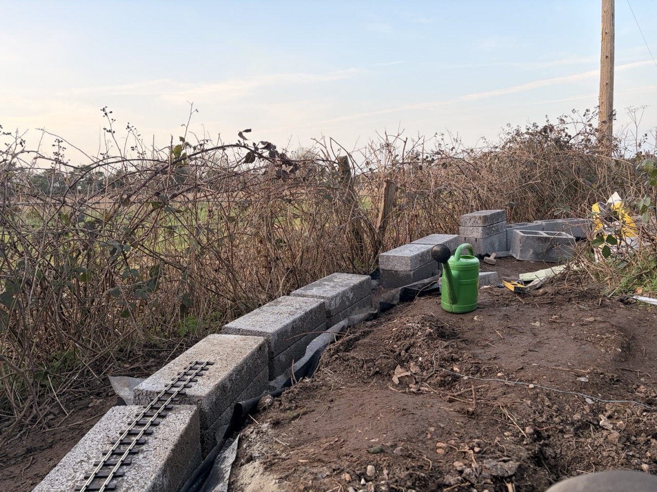

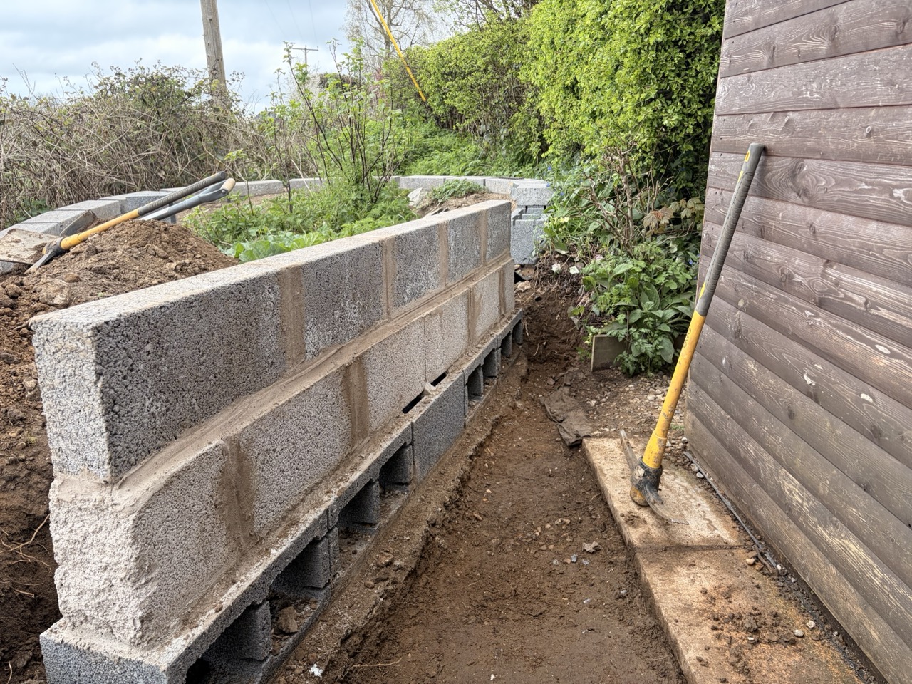

Post mix is very useful for laying blocks. You have plenty of time to make sure the block is exactly level before watering it in - unlike mortar.
IMG_3978 Large.jpeg (593.1 KiB) Viewed 1470 times

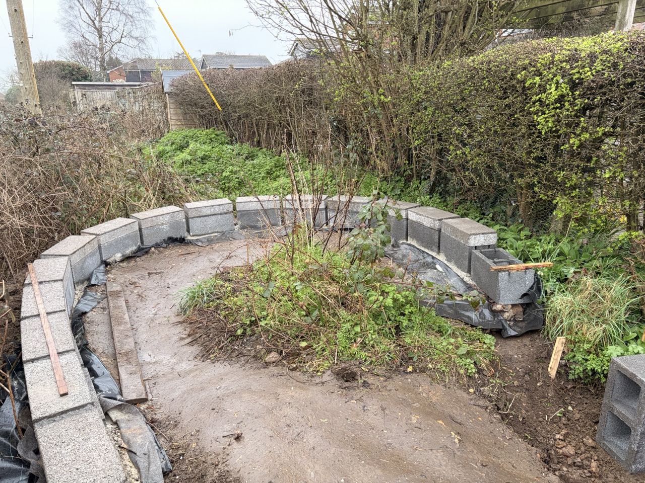

I have stacked the blocks in doubles rather than like a typical wall on purpose. My theory is, when the ground inevitably shifts or a tree root gets underneath, individual blocks can be relevelled with much less destruction to the rest of the track. Lets hope I don't have to do much of that in the future!
IMG_3987 Large.jpeg (486.09 KiB) Viewed 1470 times
Progress is good!

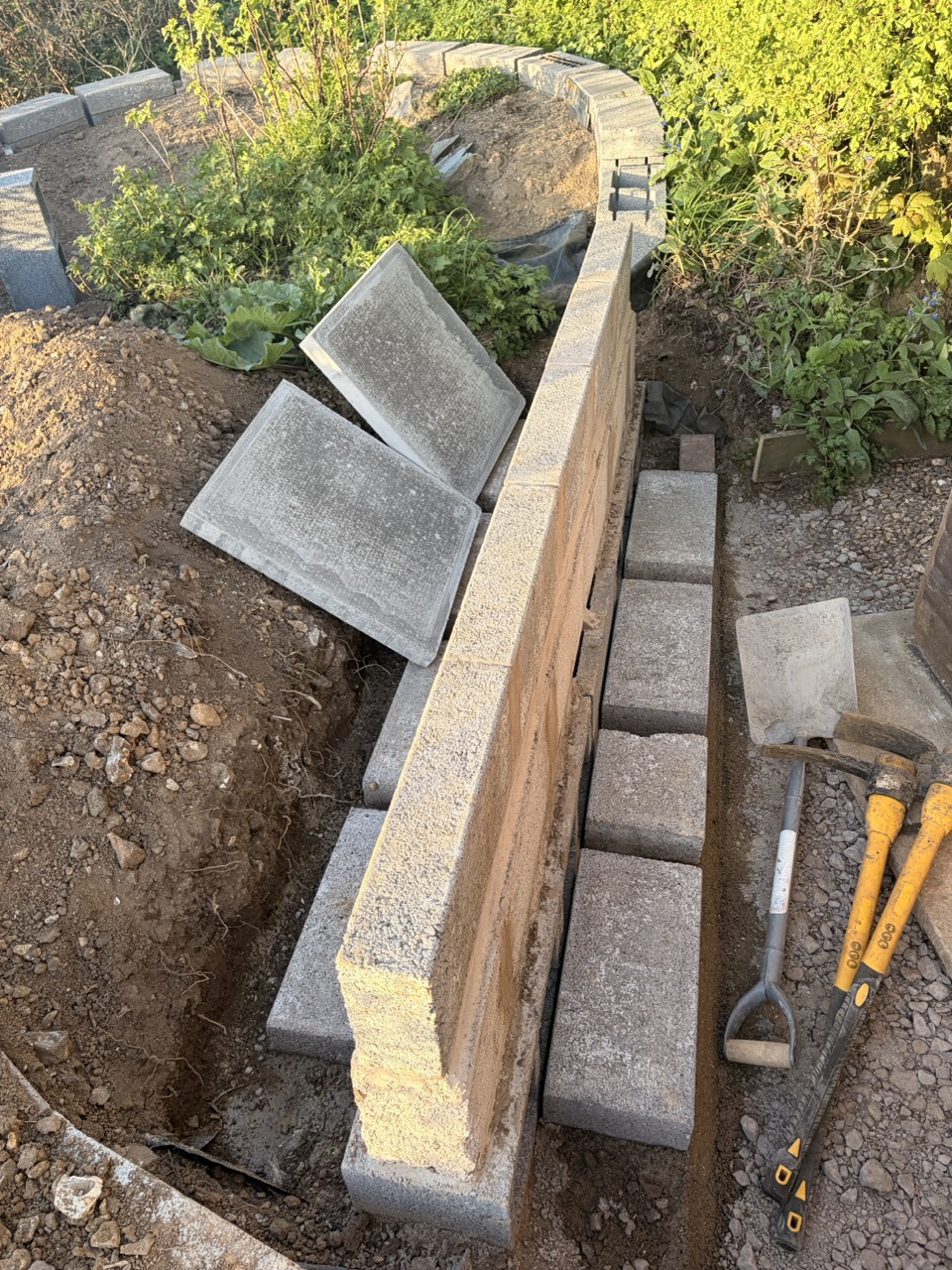

Ground preparation for hard standing.
The track will be an ergonomic 2' above the ground here.
IMG_4317 Large.jpeg (599.98 KiB) Viewed 1044 times
More cement and blocks for the slabs to sit on.
IMG_4337 Large.jpeg (604.29 KiB) Viewed 1044 times

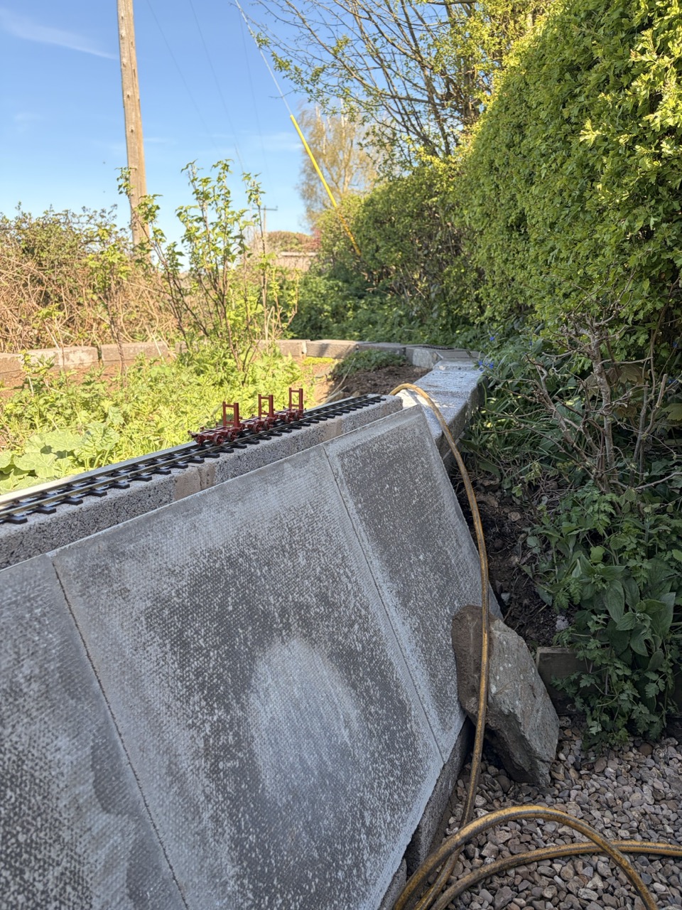

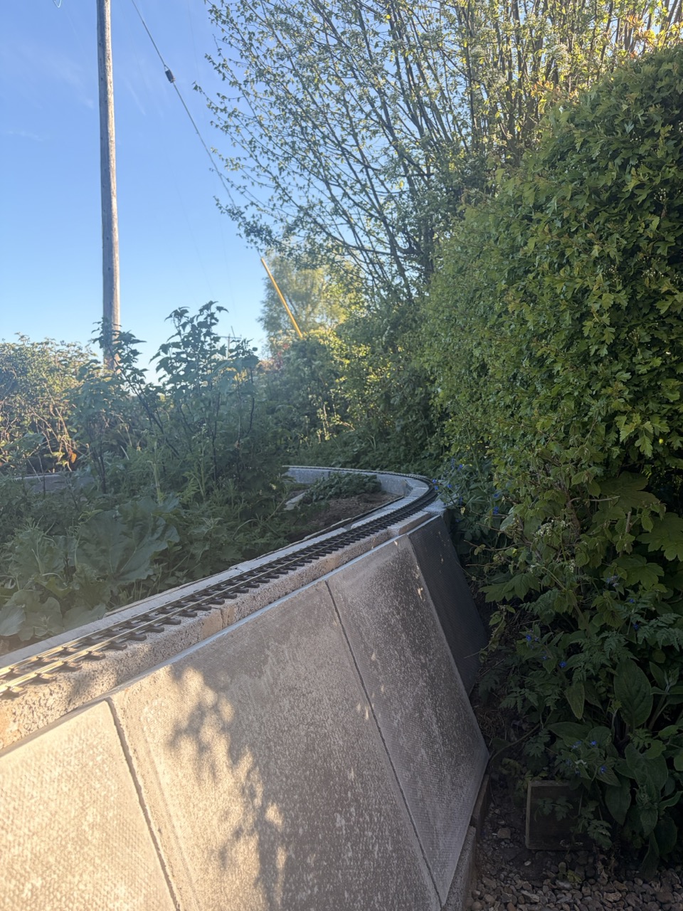

The slabs create the angle of the dry stone wall. The gravel has been laid to join up with the existing garden path.
Note how the thickness of the slabs and the block on end is the same as the blocks laid flat.
IMG_4352 Large.jpeg (537.9 KiB) Viewed 1044 times

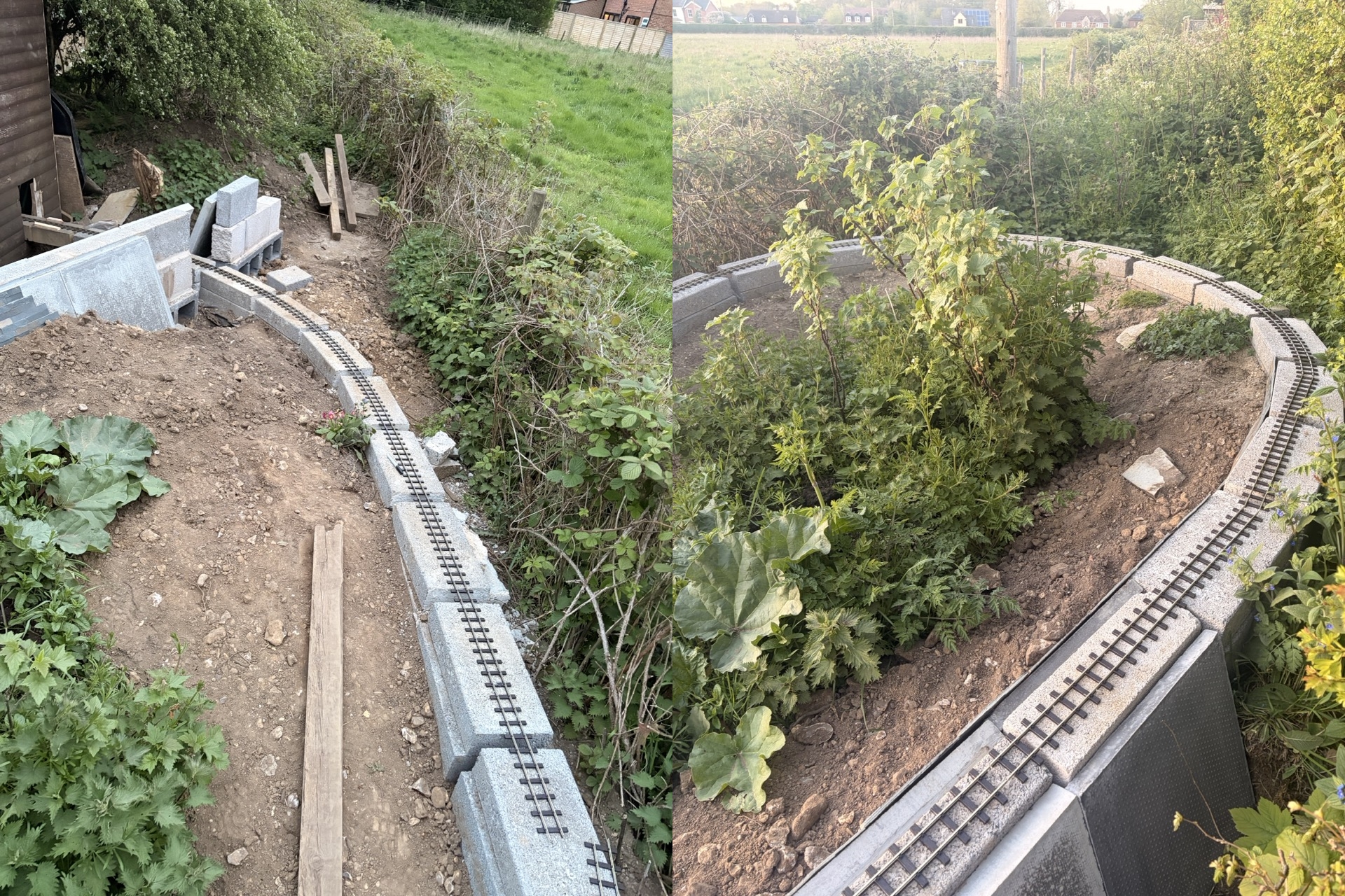

Post by steamgeorge » Mon Sep 21, 2026 11:53 pm
Thought I would summarise the line so far.
The track has been cut and bent.
The extension is 70' so far and rises at a continuous gradient of 1:37.
From the existing line and through the shed:
to the shed.jpg (1.85 MiB) Viewed 1041 times
The line continues to climb:
after the shed.jpg (1.8 MiB) Viewed 1041 times
