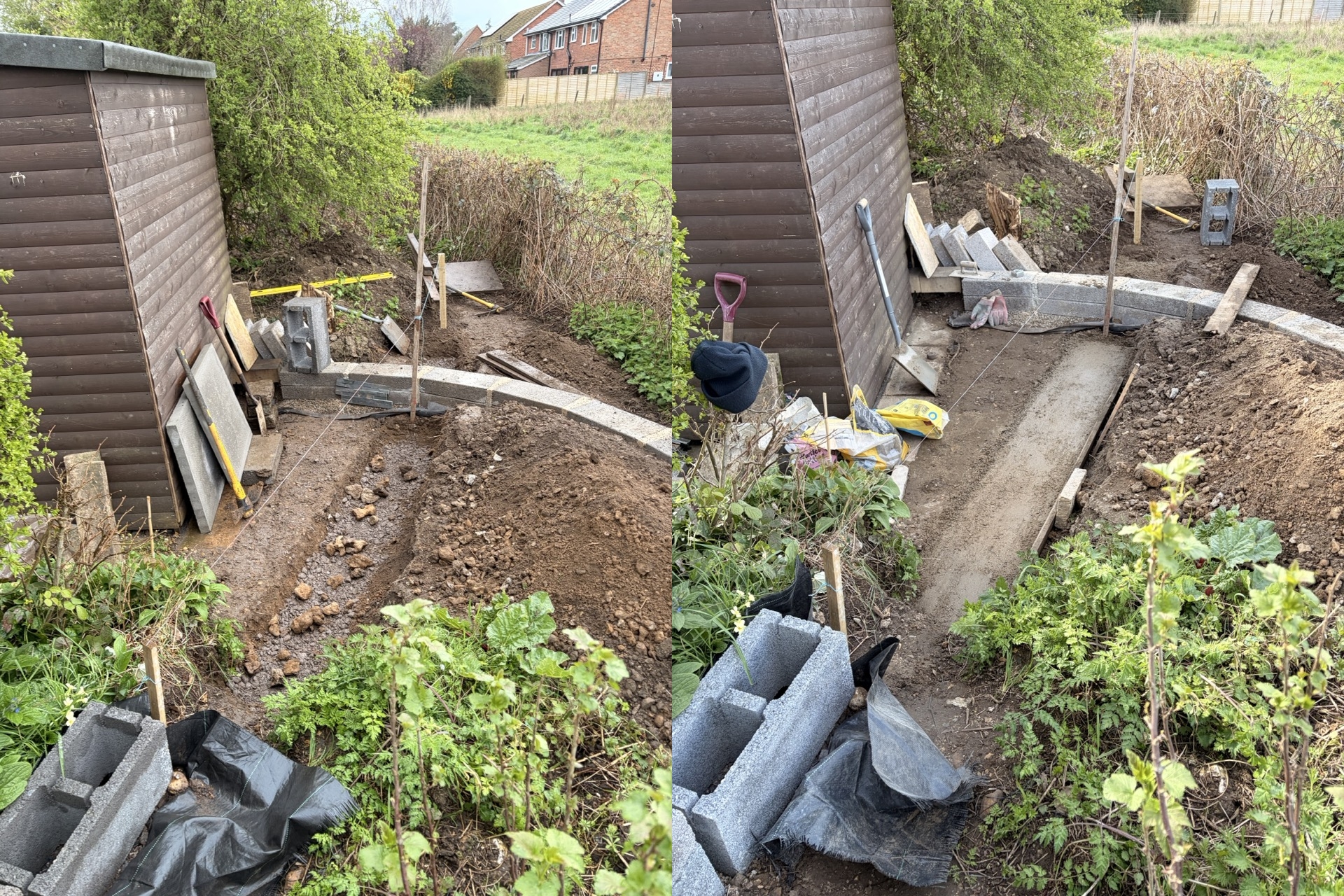

Having made a start behind the shed, I turned my attention to the first section that would connect to the existing railway.
I proudly cut a hole in the shed. The Oak sleeper will carry the track bed. There will be a removable bridge for the shed door. The blocks here will sit on the existing hardcore foundation from the gravel path. As it gets dark here by 4 pm in February, most of the work had to be carried out after hours by candlelight.
Stakes were used to get the 1:37. Point in.
It was a shame to remove the moss - hopefully it will grow back once ballasted. stay tuned...

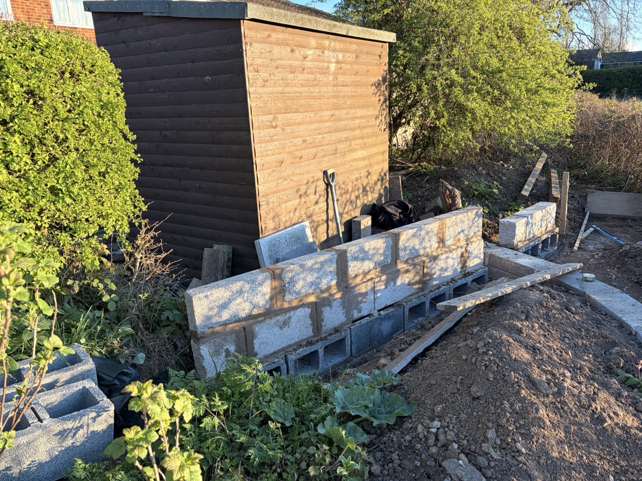

...Continuing on from last time.
Blocks laid up to the shed: Work could now return to behind the Shed.
A trench was dug, groundsheet placed and then filled with Hardcore.
This was levelled to the nearest inch before compacting. Carrying blocks gets quite repetitive Signs of a railway appear at last! The first block has been laid behind the shed.

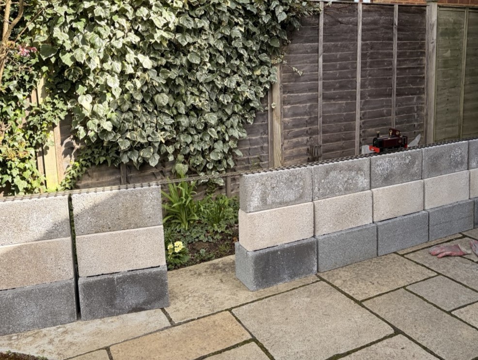

Now time for the main event. Earlier I said how the railway was missing the drama of some serious civil engineering, so I decided to include an interpretation of Cei Mawr — the 60-foot-high stone embankment. https://www.ffestiniograilway.org.uk/ga ... #gallery-2
So here is the start:
A foundation was laid. 2:2:1 aggregate - sharp sand - concrete The wall will be constructed with blocks in descending widths to make the base sturdier.
mock up on the patio: Blocks in - I do house extensions at your own risk. More to come!
