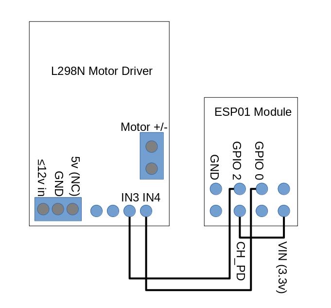

Here's the wiring diagram I came up with after some trial-and-error (and a mix-up that led to it almost working, but not quite as expected!):
Edited to add connection between VIN 3.3v and CH_PD on the ESP-01; CH_PD must be pulled high to operate.
This isn't necessarily a how-to, more just trying to remember what I did so I don't forget it all again for next time! :kermit:

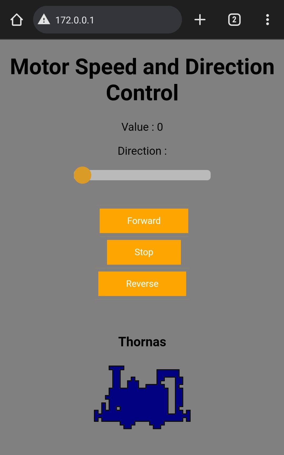

Meanwhile, the interface as written by KushagraK7 on GitHub:
It's actually pretty close to what I think I'd like. There's some inertia built in so the motor gradually responds to the slider, but I'm thinking it might be useful to add an emergency stop button that stops immediately instead of ramping down. An overly ambitious part of me wants to replace the direction buttons with a reverser to simulate steam loco controls, at least for steam-outline models, and a brake control. Since I'll be using this on more than one loco it'd be nice to display the name of the current loco somewhere on the page. Light and sound are definitely on my list but will require a microcontroller board with more than two GPIO, such as the ESP-12.

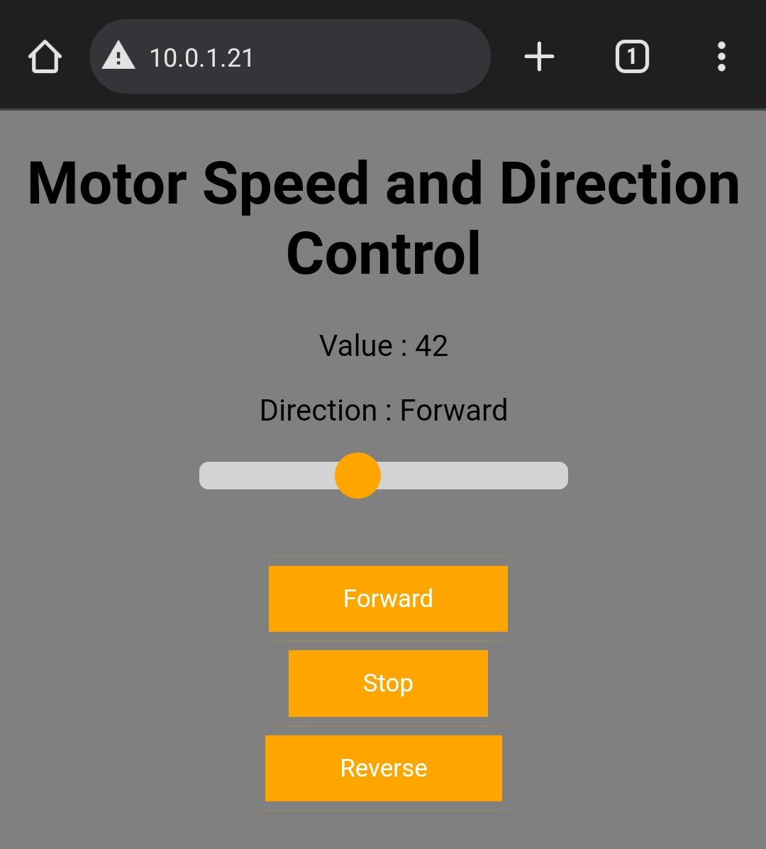

After puzzling for a while over why the ESP would boot on the programmer but not on the ribbon cable I made for it, I realized that the CH_PD pin also needed to be pulled high to boot, and modified the ribbon cable accordingly. (See updated diagram in the first post!) With the L298N connected to a 12v wall adapter and the ESP-01 getting 3.3v from the programmer, this is the result:
Note, the blue flashing light indicates that the ESP is receiving input on the web interface.
So far so good! I should be able to get that to work on batteries. :mrgreen:

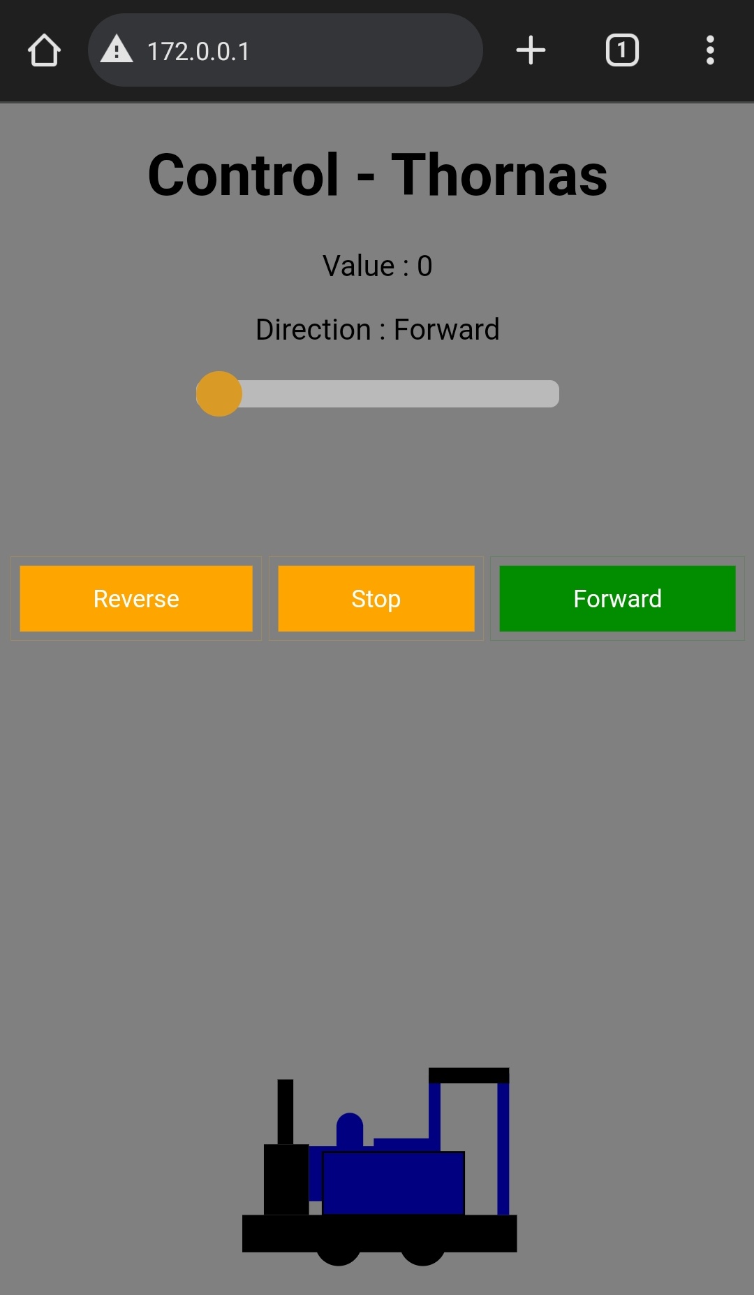

I felt pretty productive last night and checked off two to-dos:
  • Switched the ESP to AP mode, meaning it appears as a wireless access point for devices to connect to independent of my home wifi network (or any other). This wasn't necessary for home use as my entire railway site is well-covered by wifi, but will allow me to run the loco elsewhere.
  • Added an indicator of the loco name and a crude image. Originally this was a multicolor 28x20px gif (around 650 bytes) but I couldn't figure out how to use #include on that file type, so I hastily converted it to SVG to embed within the text of the control page (HTML). The result added around 1.5KB which still leaves around 600KB free in the flash, but I'd like to try redrawing it in SVG directly and at least make it look better if the jagged pixels aren't helping save any space.
I also attempted to set up a captive portal that would simply redirect to the control page, so the user doesn't have to enter an IP address once they're connected to the AP, but need to learn more about the ESP8266 DNS libraries to get that working. For now I settled for a static IP to avoid the need for a network scan or serial monitor to find out the IP every time it starts.

Played around with some SVGs yesterday and managed to get Thornas down to about 900 bytes and Moke (the little diesel) under 800. Looks a little less lumpy too.
I've also been experimenting with using the button color to indicate selected direction. As I'm modifying this existing code I'm getting a better idea of what it does, and getting more ideas of how to make it work.

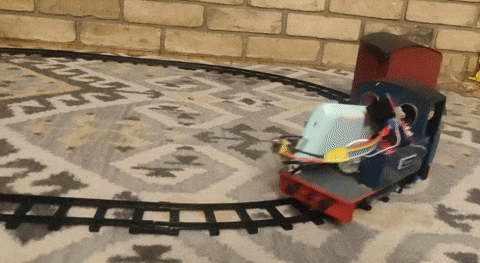

Post by drewzero1 » Mon Mar 04, 2024 2:34 am
The 7333-A regulators and DRV8833 boards came a few days ago (earlier than expected!) and I've just finished working them up. Now most of the electronics fit in the boiler, with some overhang into the cab. There's a lot of extra wiring that needs to be cleaned up, and some that I'll need to add... It ain't pretty, but it works!
Something's not quite right with the power supply to the ESP... it may need some kind of smoothing capacitor to keep the power steady, but most of the time it seems fine.
I set up the indoor test track and shunted some wagons. My first RC loco, very exciting!

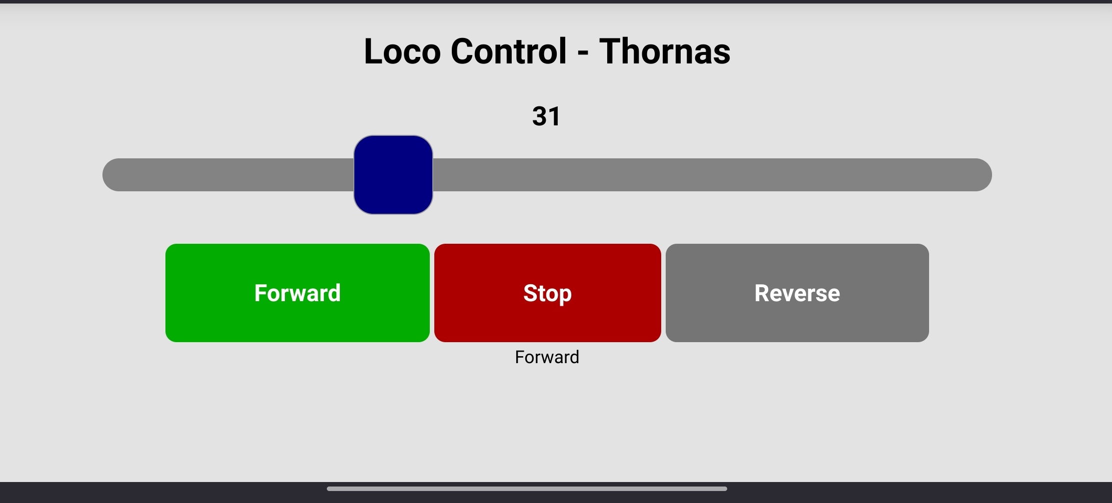

Did some more tweaking, mostly UI modifications to make touch control work better. After playing around with it a little, this is the best I've got for now-- though upon further reflection I think I should probably rearrange the controls to the edges where the thumbs naturally fall.
The locomotive image ends up below the fold on my phone in landscape mode, but fits perfectly on my iPad screen.
A physical controller would of course be better in every way, but that may have to be a project for next winter!
