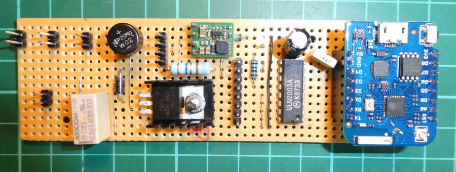

Overview of System
The system relies on each component, locos, hand-held controller and in the future any lineside/signalling systems, being connected to a local wi-fi network. I'm using my home network, extended into the garden but it could just as easily operate on a separate network.

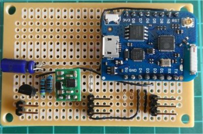

Each device uses an ESP8266 based microcontroller module, widely used by hobbyists in robotic and home automation systems. They are cheap, have built-in 2.4Ghz wi-fi support and are far more powerful and smaller than any of the Arduino range. I use the Wemos D1 mini pro, which costs a little more than the basic Wemos model but has an external aerial connection. This will be needed when fitted to locos manufactured in metal. It can be easily programmed using the Arduino IDE or other similar software and a basic program to control 2 servos on a steam train is just 60 lines of code. An important feature of the ESP8266 software library is an option for 'over the air programming' which means that once installed in a loco, it doesn't have to be taken apart when changes to the program are needed.
Picture shows the control board for a typical steam loco showing the Wemos D1 mini pro with a 5v step-up regulator, temperature sensor and connectors for two servos and a 3.7 volt lithium battery.
Once connected to the network, there are various ways of sending messages between all the devices. Based on my home automation experience, I'm using the messaging protocol MQTT. This requires an MQTT server which in my case is located on a Raspberry Pi Zero W. Unlike typical loco control systems, messages can also be sent from each device, and between each device, allowing useful information from the locos to be available to the user, like battery voltage, location, actual speed, etc.

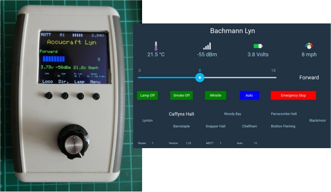

An ESP8266 based hand-held controller with a tft colour display and a PC/tablet/phone program provides the control.

As the "Why Live Steam?" thread shows, we are all different in our approach to this hobby. I came into Garden Railway with an electronics background. I have tried modelling, but my kit built coach and station proved less than satisfactory, so I have therefore decided to stick to what I know and enjoy doing. This initially involved updating my electric and steam locos to battery remote control using a Spectrum controller and separate commercially available ESP/Radio Control units. This was updated to a system using the Arduino range of microcontrollers a few years ago. After recently completing a home automation project, I've started to update everything with the same technology.
Overview of System
I'm not used to writing up things like this so comments and any questions are most welcome.

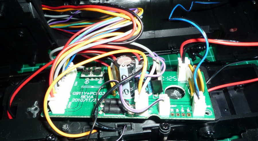

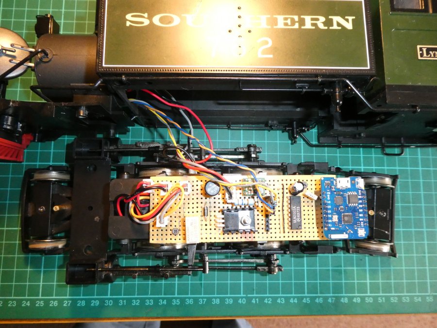

Bachmann Lyn Conversion
Whilst the Bachmann Lyn is G scale (1:22.5) and therefore slightly undersized for the rest of my 16mm railway, it's a nice little loco, good value for the money and runs flawlessly on my less than perfectly laid 45mm track. A minor niggle is that the cab and bunker are too high. I tend to use this first to ensure the track is ok and when I'm in the garden, working, eating or drinking wine, and just want a train to run with minimal control. A secondhand model purchased from Ebay was my first loco, later to replaced by a new one, when Bachmann bought out a much improved version a few years later.
It is easy to take apart (4 screws) and contains a DCC ready control PCB that sits on top of the motor drive assembly. There are two switches accessible when the front of the smoke box is opened. The original PCB has been replaced with one containing the microcontroller and associated components. Two 18650 lithium batteries are fitted in each side tank along with a 4 cell charger/protection circuit.
The component cost of the PCB, which is a typical of that needed for an electric loco, is £12-£18 depending on source of components. Details are:
1) The 3 connectors to the top left are the electric pick up points for the front, centre and rear wheels. These are used to charge the battery either off the track or from a section of the track that is powered, so it can be recharged during use. This also saves having a separate charger socket. The bridge rectifier ensures the polarity is irrelevant.
2) The lower left comprises a 2 way connector to the motor, power MOS FET and relay used to drive the motor. I use this rather than a separate motor driver as from experience these typically (especially type L298) lose to many volts (reduces speed), get hot and wastes battery capacity. However, I haven't looked lately so there maybe a better alternative now.
3) A 4 way connector for power from the batteries in the side tanks and the original on/off switch located in the smoke box.
4) A 5 volt step-down switched mode power supply. I love Pololu products.
5) An 8 way connector and ULN2003 driver for the relay, front lamp and smoke generator, leaving 4 outputs available for future use.
6) A Wemos D1 mini pro microcontroller. There are cheaper alternatives and clones but I have standardised on this one.
Pictures showing the assembly of the original control board and the new one.

Between the recent bad weather, I've been testing the Bachmann Lyn on my newly extended track and have been really pleased with the results, sufficiently to start this thread and share my experiences.
Michael
