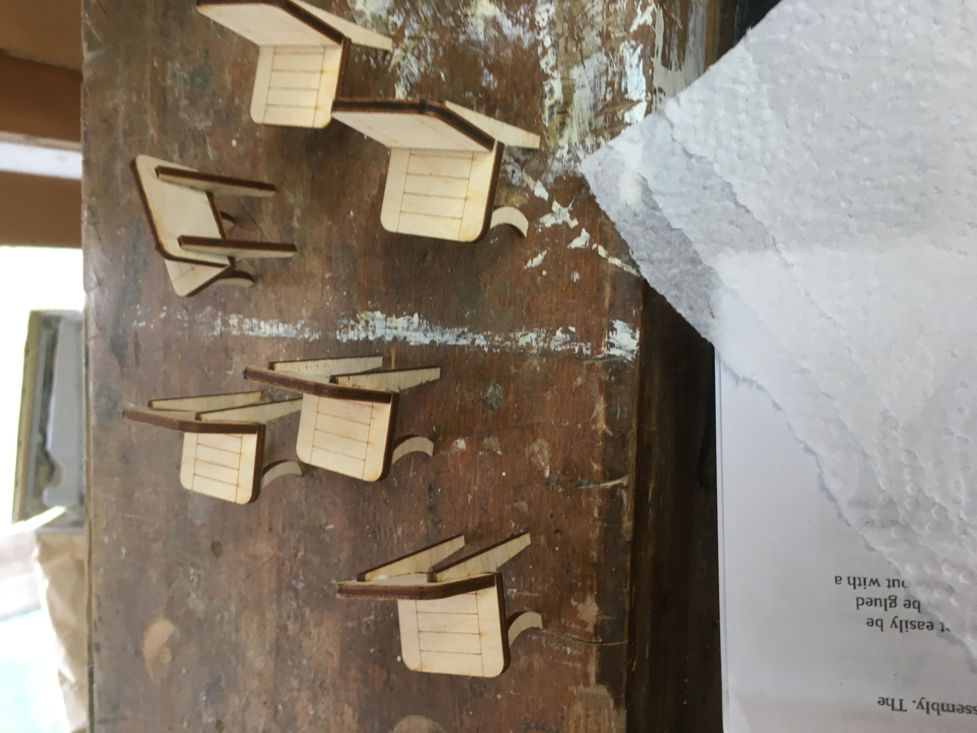

Not always one to hurry to get something finished I have done some work on two Plateway Models balcony coaches bought at Llangollen in May. There is a picture of a finished one on an April 2nd post - page 7 I think.
The kits have lots of parts, some of them quite small. Here is one seat and one luggage rack, leave aside for now!

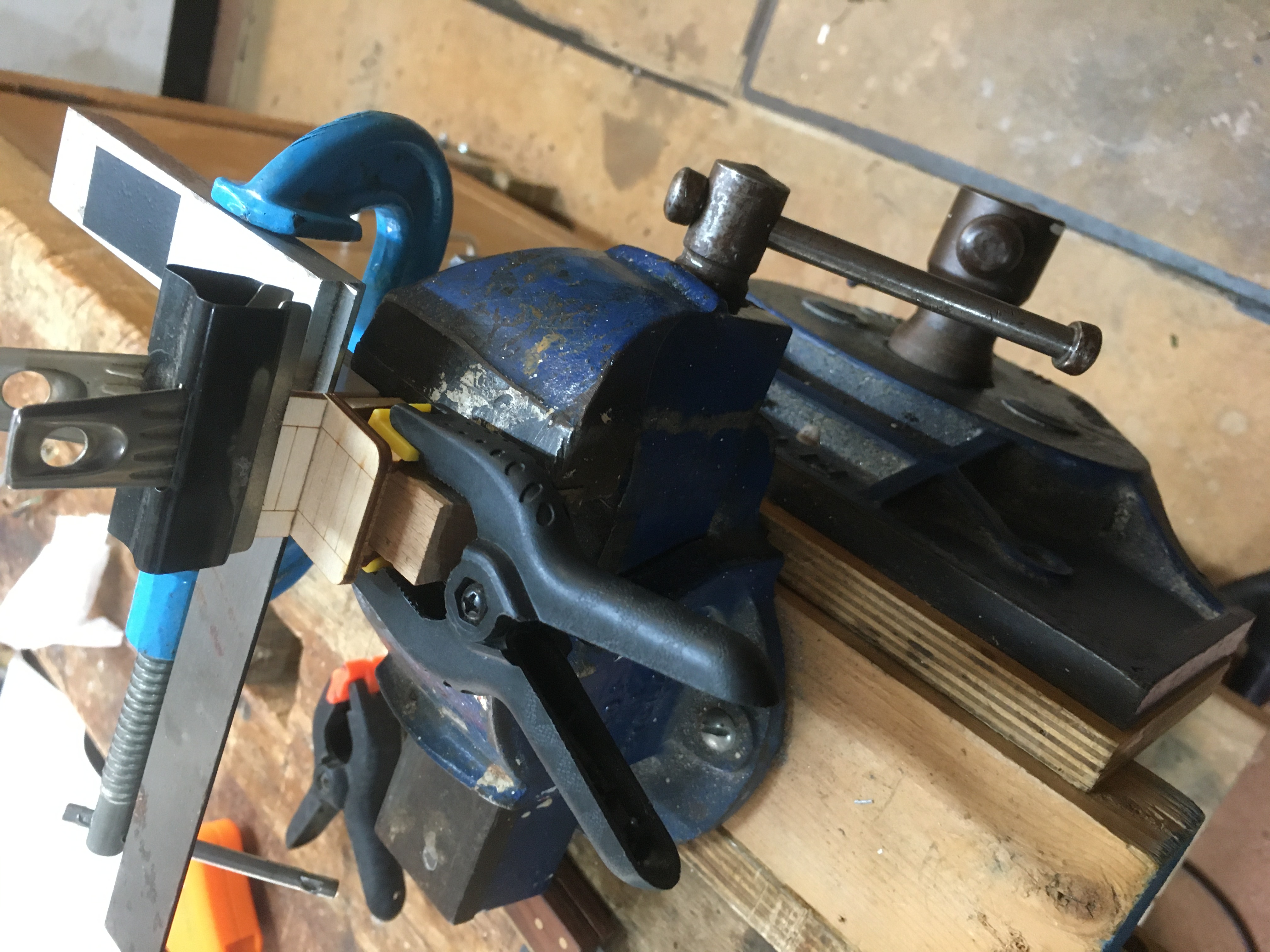

Here are most of the large pieces of the two compartment coach, there are as many again for the guard's van, having been given a coat of MDF sealer, this raises the grain so a gentle rub down with fine abrasive is needed and a second coat if you feel like it.
The nearest piece is the floor of the two compartment coach which has been stained, next is its roof then six pieces which glue together to form the sides. Further down the bench are its ends and a central partition and two balcony ends. The panel next to the roof is the middle layer of the three, this was stained with a darker wood dye. The outer layers of sides and ends were all painted with antique pine varnish. The window frames (12) were stained to match the middle layer.

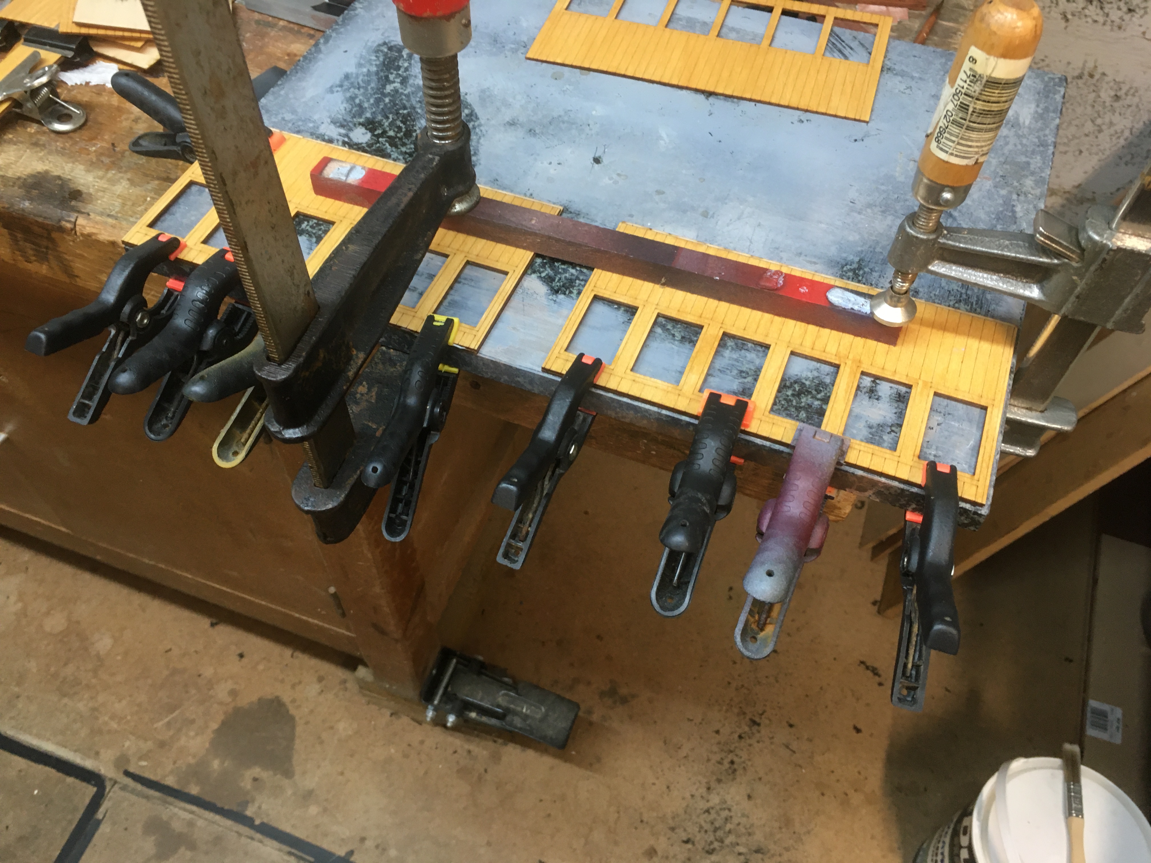

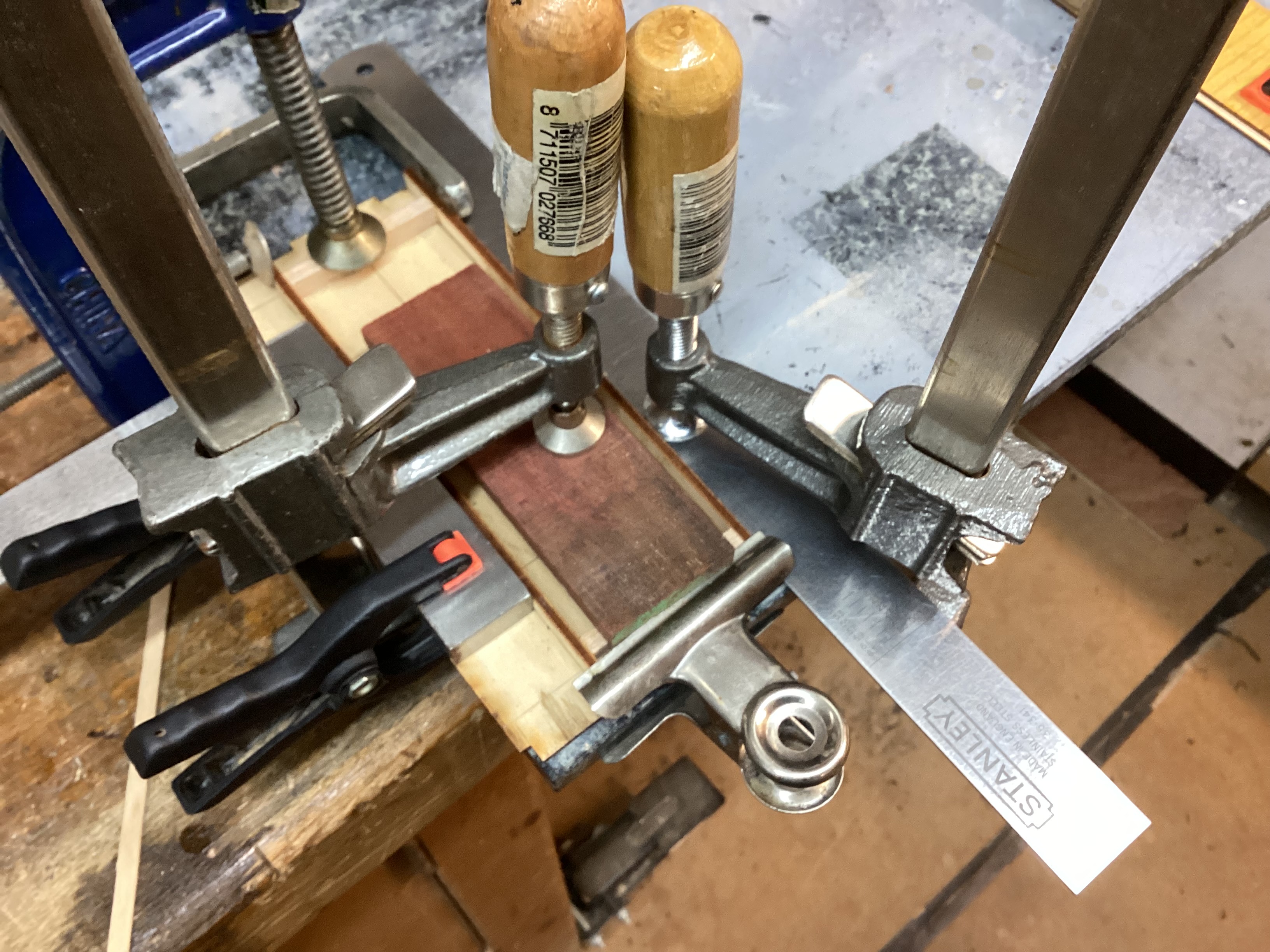

A piece of glazing plastic was glued to the outside of the inside wall of the coach using canopy glue and allowed to set. This then had the stained middle layer of the wall attached using wood glue, the tops and ends line up but the inner wall is shorter. Lots of spring clamps and a couple of bigger ones and length of timber were used to hold the assemblies flat on a granite worktop saver while the glue dried.
The next stage is to add the window frames which fit inside the holes in the middle slice up against the glazing, canopy glue was used again, after which the outide layer can be glued in place.
This shows both sides of the sides!

Post by gilfachphil » Fri Sep 08, 2023 9:55 am
A bit more progress.
Having plenty of clamps is always a good idea!
Result of first gluing

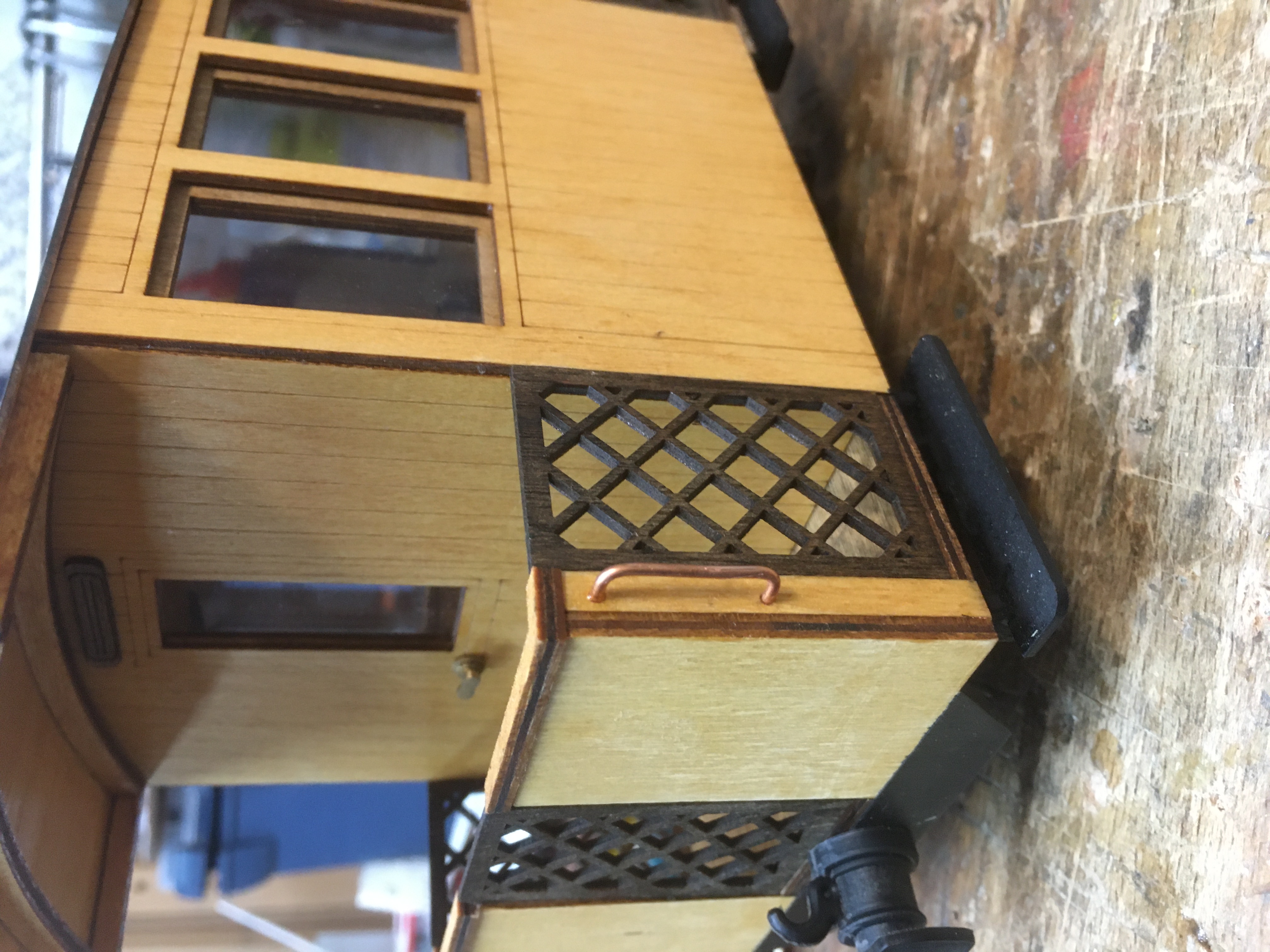

Onto the duckets for the brake coach, which also has balconies so the guard may look out from there but if it's raining ...
The sides of the duckets are two pieces glued together. The kit includes an internal window sill which holds the sides at the correct spacing. I made up a similar piece for the tops of them to aid getting the box square.
This shows the sides and spacers glued together, using the side wall to get the shape correct, once dry the upper view shows the two pieces of front cladding being added. Once all had set the duckets were removed from the sides and a coat of varnish was applied, allowed to dry and then sanded gently before adding a second coat.
This thens shows a finished ducket and a side with it being glued in.

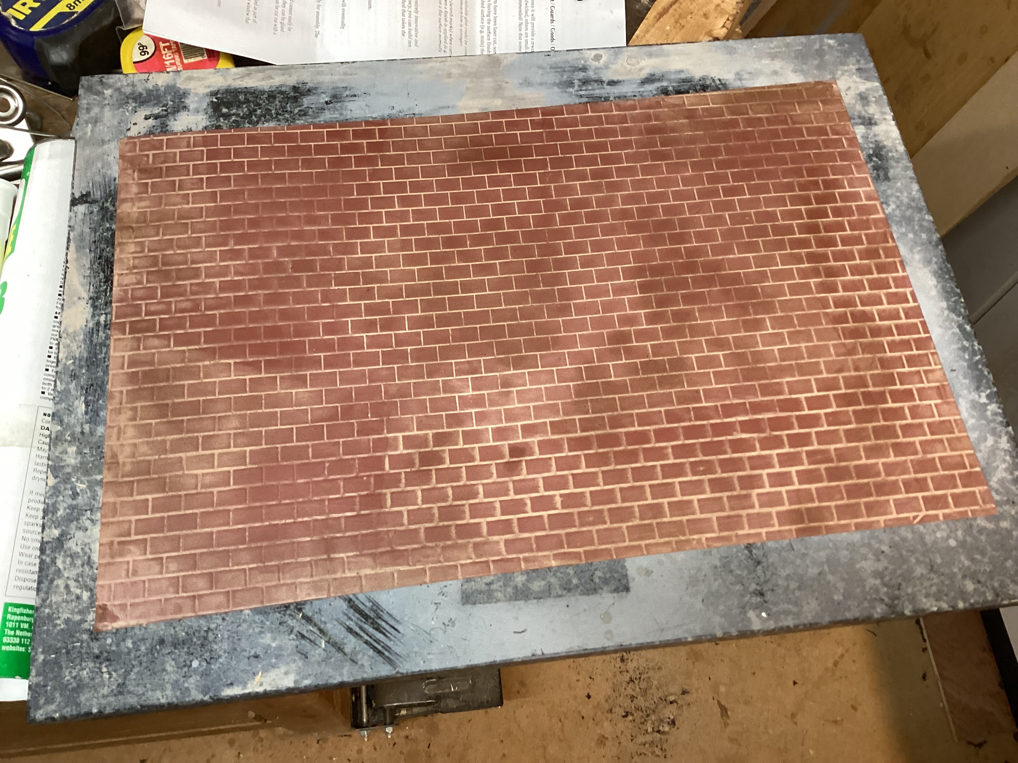

The garden layout has a station platform taking shape on the large table. It has a core of UPVC fascia board which has probably appeared in some of the pictures so far. This is topped with a layer of 3mm recycled plastic board. I have been wondering what I could use to cover the platform faces and at the Swansea Model railway Show on Sunday I found some sheets of embossed plastic on the Squires stall.

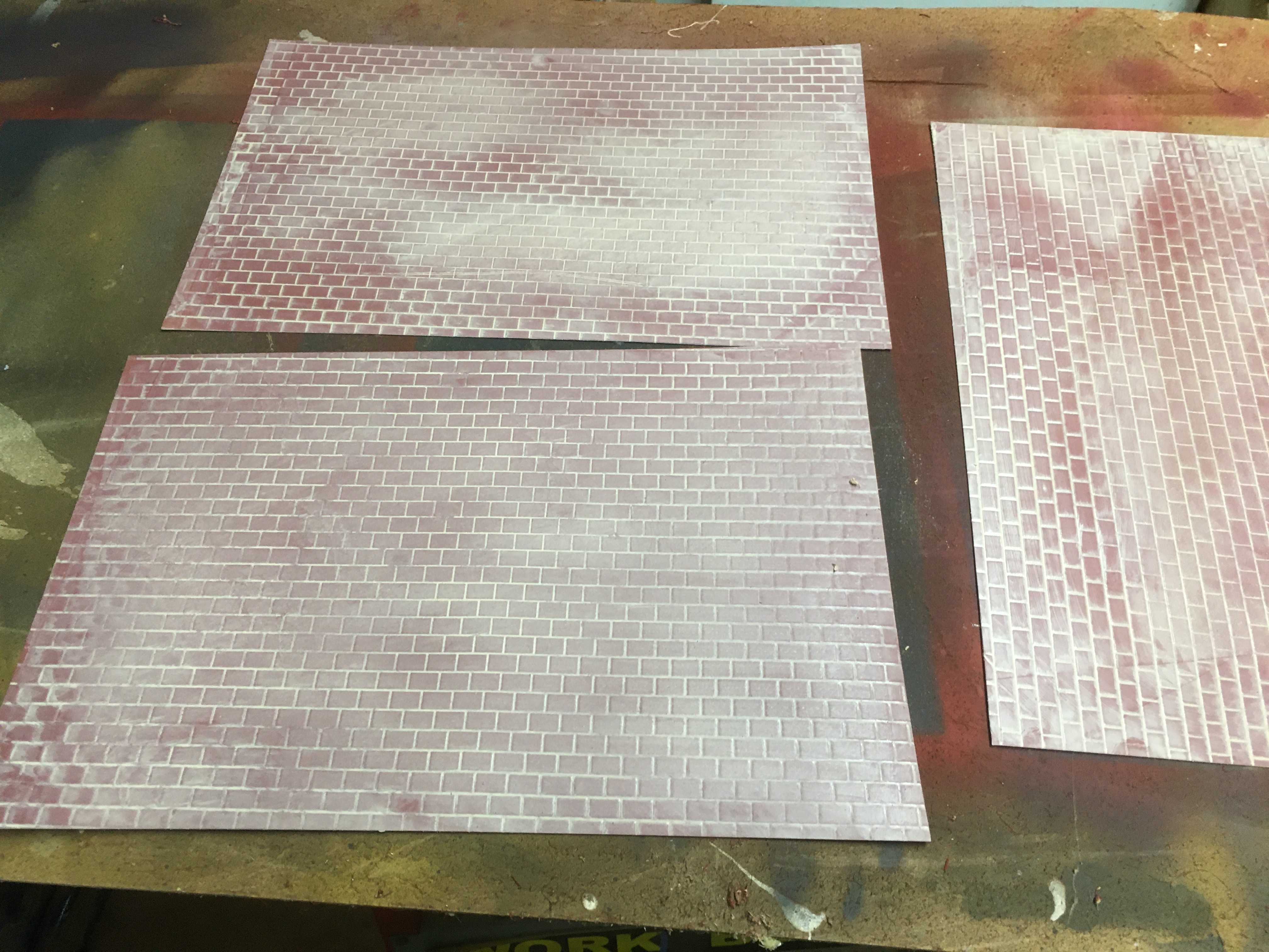

These I sprayed with red oxide primer then once dry used a squeegee to scrape diluted acrylic paint across the surface and into the mortar lines.
I then worked with a cheap foam roller and some walnut wood stain to darken the sheets
That was looking quite good I felt. I cut strips to the height of the platform face. At the ends I used wedges of timber screwed down front middle and back to create the slope. The strips I have glued in place with solvent based UHU.
