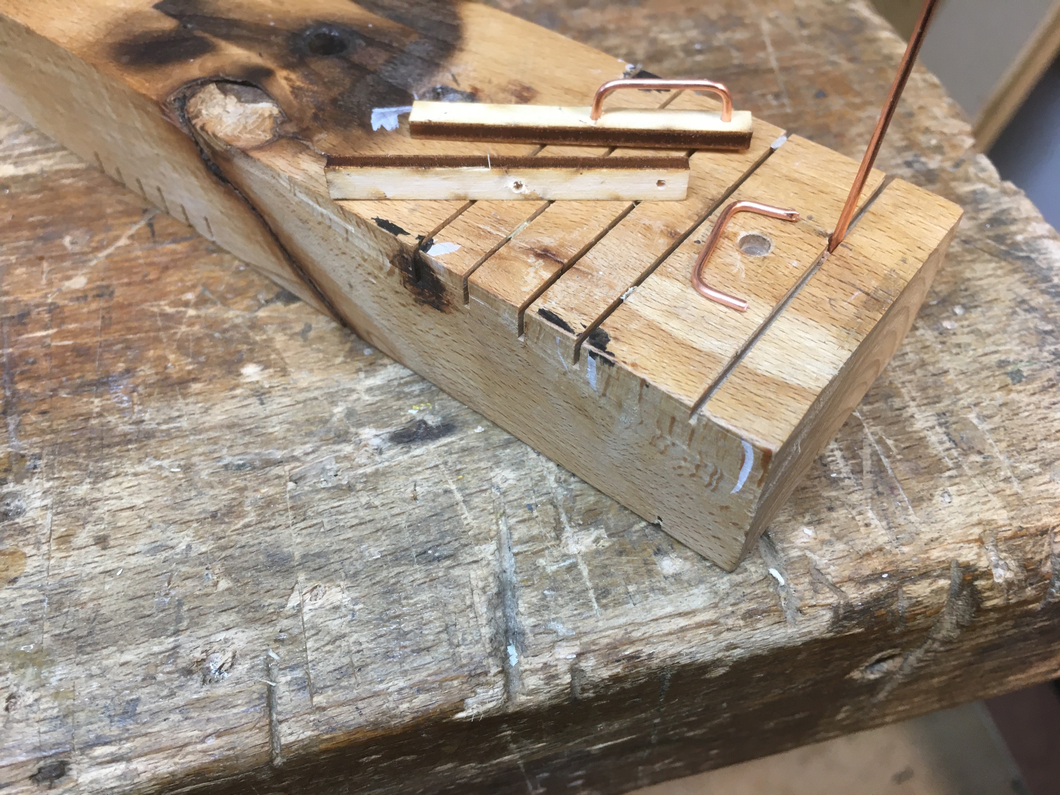

Each coach has handrails fashioned from copper wire at each corner. On this coach I drilled the holes by hand in the fully assembled coach (not sure why they are not just laser cut into the kit), this time as I am making the two coaches I decided to batch make the handles and drill the wood before assembly.
I expect we all have our favourite home-made jigs and useful bits of wood. The holes were made on the pillar drill using a 1.3mm bit and a high tech jig. First the jig was positioned to make a hole 3mm from the top. Having made up the handles one was used to mark the height of the second hole in pencil on one of the ply pieces. The jig was repositioned and the second eight holes drileed:-
The last picture shows a block of beech which comes in for many uses. A 1.3mm hole was drilled 18mm from the edge into one of the slots, the wire end inserted and it was bend along the slot and down the side where it was snipped off at a 6mm mark. The wire ready to bend, a handle, a piece of ply with holes and another with handle inserted.
