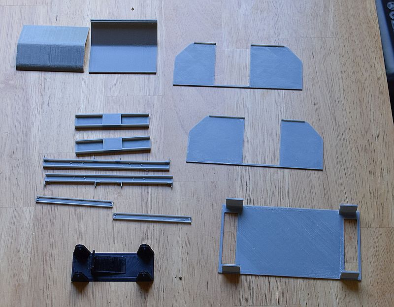

Anyway, some progress although not as much as I had hoped, for several reasons: I had to redraw/reprint a few bits due to errors. Getting the batteries in proved to be a bit of a pain until I had a bright idea ( more about that in a bit). The post strikes have delayed delivery of 3mm axle bushes ( I thought I had some but they turned out to be 1/8" GRRR!) and Micron have put me on the waiting list for a 603!
Sooo... this is where I am at the mo.
1) The body is mostly put together and had a prelim rub down/tidy up. The battery box is in the LH end and has a cover to be screwed on in due course.
2) Getting the batteries in was a trial. They sit in 2 rows, a three above a two but not tight, so every time I tried to do anything they slipped and went out of line and didn't fit in. I tried tape, and glue, and all sorts but they would NOT stay where I put them. Then I had my bright idea and printed a 'mould' by extending walls up from the drawing of the inside face of the compartment end. This holds the batteries in the correct alignment and automatically spaces them! Then a glue gun locked them in place and allowed me to solder the tags, and now I have a nice rigid custom shape battery pack which is what you can see in the 'mould' at the RHS.
3) The roof is printed.
4) The chasis is done and the motor mounted. The motor can't actually be seen in the picture because I've printed a 1mm thick cover for it to try to protect the very fine gearbox from the worst track debris.
5) I've also resin printed the fuel tank and a rudimentary engine ( not in picture).

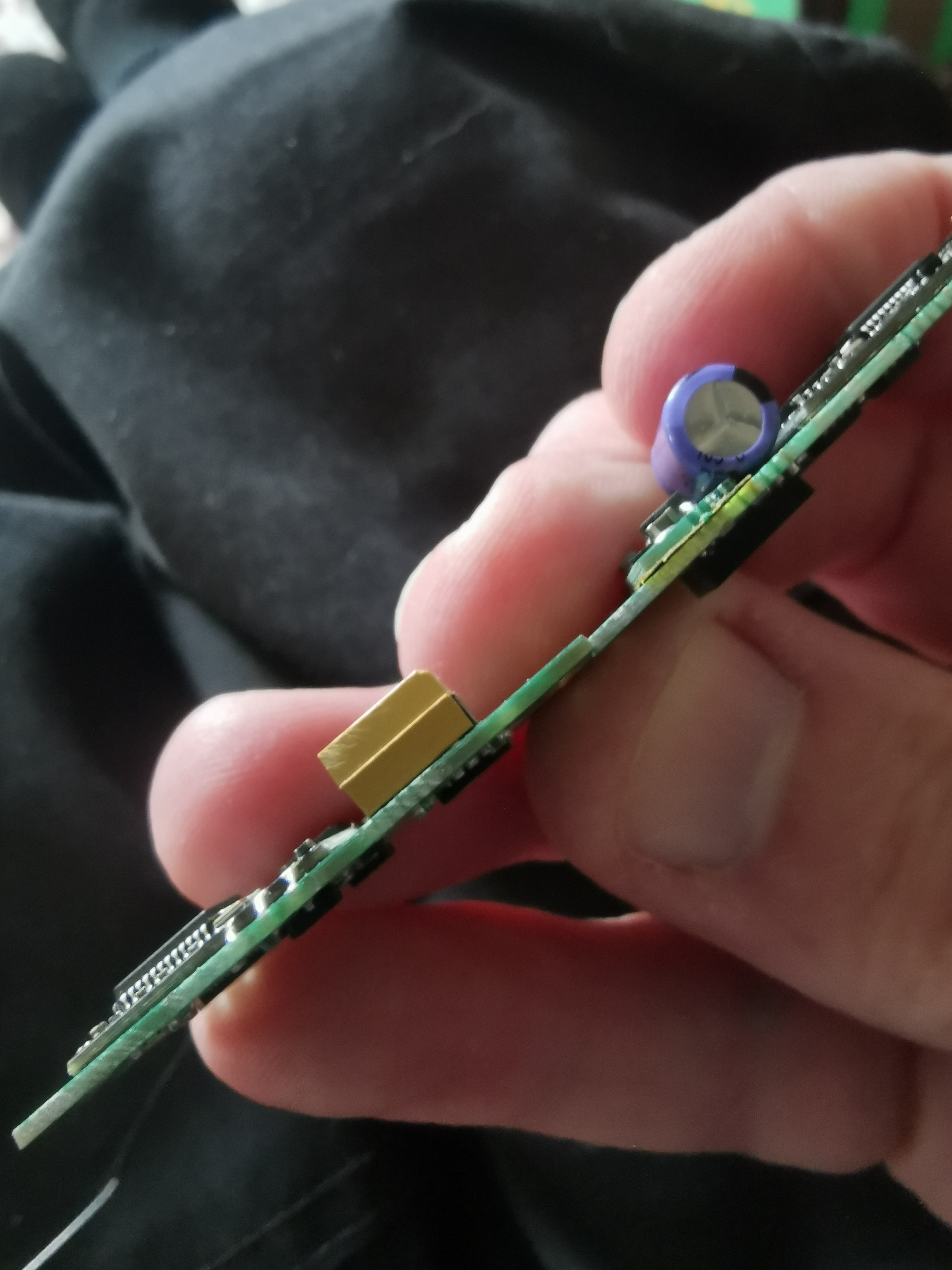

What Rx were you planning on using? I bought a couple of the RSC version of the new Micron MR603a, one of which was intended for use in a railmotor. What doesn't show in most of the photos is the electrolytic capacitor on the back of the board, which made it too large to fit in the intended model.

I was planning on using a Micron 603b, but I'm on a waiting list of unknown length for delivery, so yesterday morning I dropped Andy a line asking about his thoughts for using a Deltang 41/43/45 instead.GTB wrote: Sun Sep 18, 2022 5:21 am
Interesting, your comment about the capacitor. I must admit that I had wondered why the board dims had such a large figure ( 10mm) for the thickness, but that would explain it. In my works layout planning for this A-D I had simply drawn a rectangular box of the correct o/a dims and worked with that, so it doesn't bother me as such this time around because I have the room.

The 'B' is better, in this respect :
- Attachments
- MR603 'A' and 'B'
- IMG_20220918_101541.jpg (2.99 MiB) Viewed 12918 times

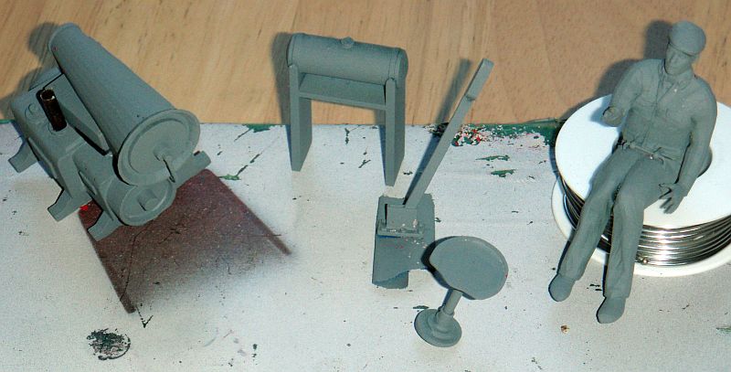

Slow, but progress.
This shows the driver, his seat and his handbrake ( at least I assume thats what it is - it appears on the drawings, but no piccys, unfortunately). Also the fuel tank, plus the engine which is a sort of cobbled up version, made up from several pictures which appear to show various versions. I used the bits which appealed to me for one reason or another, plus some of my own invention for practical modelling purposes.
I've also now got the r/c, which is working fine on the motor control.

Still creeping forward slowly and I've now got to the stage of THINKING about painting
This is where I need the assistance of the more petrol-headed amongst the membership. The engine is completely exposed, so I've been trying to find what colour a Daimler engine would have been painted back in the day. The best I've been able to find, on a vintage car forum, is a reference to "Daimler standard grey-green" but no indication what that means in the real world. I also found a bespoke paint maunufacturer who sells Daimler paint allegedly matched to a piece of brand new and unused piece of engine, but again no colour swatch to even give a clue and I don't really need complete canful of paint to find out!
Any offers anyone?
Any offers anyone?

Accordinging to the original posted links that started this, while that particular model of loco was built by Austro-Daimler, the motor was actually made by Jenbacher Werke. Who also made their own diesel locos.philipy wrote: Wed Oct 05, 2022 11:33 am Still creeping forward slowly and I've now got to the stage of THINKING about painting.
Plug 'Jenbacher JW20 diesel motor' into google and you'll get a few coloured photos, but the photos show a single horizontal cylinder motor with twin flywheels, in a range of colours.........
There was more than one Daimler company in the world, in the UK it was part of Jaguar.....
- Posts: 6075
Re: Austro Daimler Build project
Graeme,
Thanks for your input as always. I can't see where it mentions the Jenbacher in the articles, but I'm notoriously blind when it comes to searching.
However, the end outlines and plan drawings as part of the original drawings seem to show one of these ( or at least a similar model) : https://www.austrodaimler.at/fotogaleri ... fahrzeuge/ - picture 16 in the gallery.
Which is described as "Austro Daimler 4 Zylinder Feldbahnmotor Type FB 12 mit 12PS Leistung, luftgekühlter Benzinmotor mit Draisinengetriebe, gebaut ab 1928."
Which Google translates as "Austro Daimler 4-cylinder field railway engine type FB 12 with 12 hp, air-cooled petrol engine with handcar transmission, built from 1928"

Ahhhh... I was looking at a link posted by Andrew.http://www.feldbahn.at/fahrzeuge/verbre ... aimler.phpphilipy wrote: Wed Oct 05, 2022 2:09 pm Which Google translates as "Austro Daimler 4-cylinder field railway engine type FB 12 with 12 hp, air-cooled petrol engine with handcar transmission, built from 1928.
Looking at it again, I may have gotten off track, as your model looks like the 'Kromag' loco, with the lifting roof and a steel body. The Daimler shown on that page is fetchingly clad in varnished wood......
Industrial engines wouldn't necessarily be the same colour as a car engine. There's an early Austro-Daimler industrial engine in the Powerhouse Museum in Sydney. Looks like the sort of colour you'd find in Revell and other brands of military paint colours. https://collection.maas.museum/object/206779
Re-engine it with a small Gardiner diesel, or a Dorman, which is what any sensible '30s british engineer would have done when the original petrol motor wore out.
