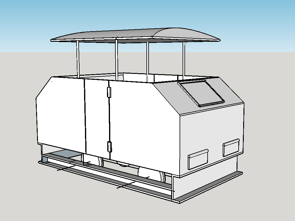

Obviously a lot of detail needed, but I thought it worth working out how much space would be available for motor, r/c, etc. Answer..Not very much!

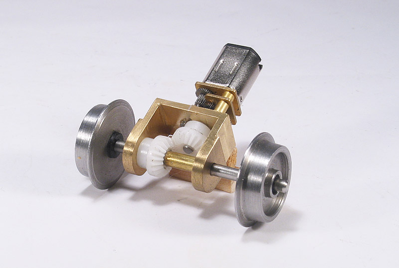

That mobile bread bin is about the size of a 20HP Simplex, so it shouldn't be difficult to power it with a modern gear motor drive mounted under the floor. The motor would be on the axle centre line about where the real gearbox is located and the chassis rails would tend to hide the drive details at normal viewing angles.philipy wrote: Thu Aug 18, 2022 11:00 am I've been puzzling about a chassis for it myself, and the only way I can think of, is some sort of very slim motor mounted horizontally under the floor, possibly using spur gears or crown and pinion gears to get at the axles. I've been looking at coreless motors which could probably fit that requirement but they are all high revving and gearing down would be a problem with the space constraints.
The 6V 50:1 N20 gearmotor and bevel gear final drive that I use in my railmotors, or the N20 with a 50:1 worm gearbox, like the one you used in that steam powered potting shed you built recently, would do the job. Hiding the batteries and an ESC will be harder.
Incidentally, if you magnify the 3rd drawing that was posted, the wheel dia. arrow heads actually touch the wheel tread, not the flange, so commercial metal 20mm wheels would be near enough.

I hadn't realised that little engine was so low powered. Does it just sit there and quiver if loaded up, or does it slip and fail to proceed?philipy wrote: Sat Aug 20, 2022 10:50 am My only reason for looking at something other than the N20 gearmotors is that the one in my "steam powered potting shed "![]()
can barely pull itself along, not sure why.
If it's slipping, I'd be less surprised. It's small and light and I seem to remember you printed the wheels to get the right look. Plastic wheels have a lower coefficient of friction on metal rail than metal wheels do. 'Bullfrog Snot' gives you a diy traction tyre if you can live with the bright green colour....
The sun made an appearance here today and the wind was from the north, instead of straight off the ice pack, so I did a little test running with my gang motor. It only has single axle drive, but the rail was dry and it managed to haul it's usual trolley, plus the weed killer trucks for a load of eight axles. The results may be of use.philipy wrote: Sat Aug 20, 2022 10:50 am I've been looking again at posibilities and a pair of 1:1 bevel gears does look feasible. Coupled with a 6v, 30rpm gearmotor, should give realistically low speed with hopefully enough power to pull itself along!
https://gardenrails.org/viewtopic.php?f=37&t=12453
The gang motor weighs 260g and with the driven axle leading (worst case) managed 34g drawbar pull. The train weighed 663g and had a rolling resistance of 22g. Well within it's capability on my more or less flat track, but it would have slipped to a halt on a 1:50 grade. If both axles were powered, it would have just managed the train on a 1:30 grade.
The gang motor is fitted with a Como 951D601/6V micro gearmotor (I now use Pololu #998 6V 50:1 gearmotors). Gear ratio is 60:1 giving 300rpm at 6V at the output. The final drive is 1:1, using a pair of 0.5mod 20 tooth mitre gears (I now use a pair of 0.5mod 16T mitre gears). The final drive gearbox is milled out of a block of brass, but would probably be possible to print. I can post the back of the envelope sketch I use if needed. I work in 45 mm gauge, but the gearbox is only 21 mm wide so should fit a 32mm gauge wheelset. Probably not enough space left though, to couple the axles by chain for all wheel drive.
The gang motor has 20 mm steel wheels, from IPE I think, leftover from some early Ezee kits before I started turning my own wheels. The battery is 4 x Eneloop cells (4.8V), which gives a scale speed of 11 mph, so a 30:1 gearmotor would give you 20+mph.

Thanks for that info. I wouldn't mind seeing gearbox your sketch, please. No point in reinventing the wheel so to speak.GTB wrote: Sun Aug 21, 2022 2:18 pm https://gardenrails.org/viewtopic.php?f=37&t=12453

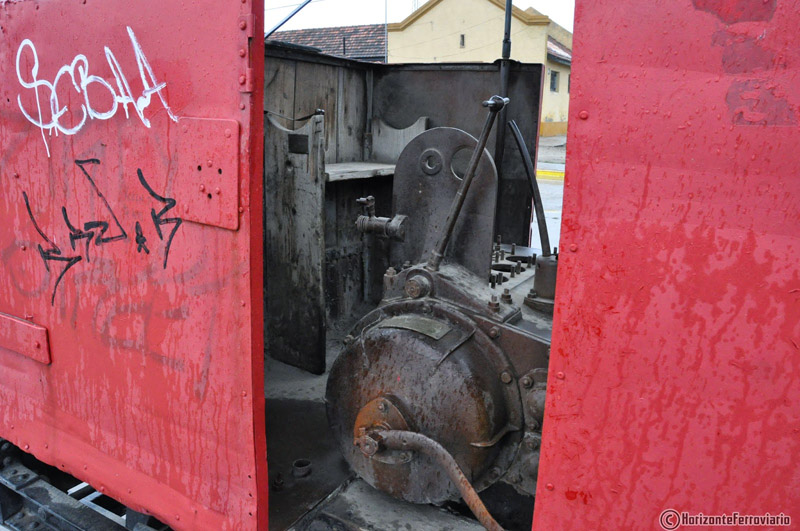

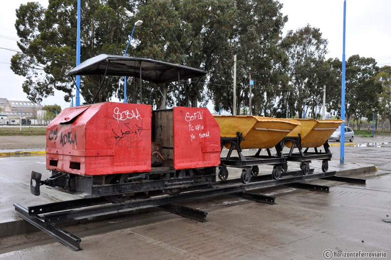

I also came across this example as a static exhibit in Patagonia!! The wheels on the skips don't look man enough to hold it off the ground, let alone rough quarry work.
What I was actually looking for is door detail. The drawings all seem to show hinged doors and the Patagonia loco definitely has hinges on the 2nd picture. However, other pictures all appear show slightly wider, sliding doors, but I can't mke it out for sure. Any thoughts anyone?

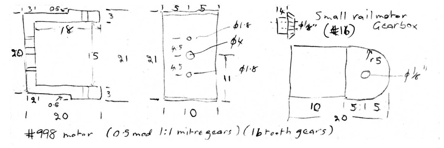

Herewith, one photo and one back of the envelope pencil sketch. This is the nearest I ever get to doing a drawing, it's basically just to remind me of the dimensions when machining.philipy wrote: Sun Aug 21, 2022 3:36 pm I wouldn't mind seeing gearbox your sketch, please. No point in reinventing the wheel so to speak.![]()
The photo shows the drive fitted in the the gang motor, which was the first one I built and the only one with 20T gears. Since then I've changed to the final drive in the sketch, with 16T gears. The 0.5mod 16T mitre gears come from RS Components, stock no. 182-7986, about A$8 for a packet of 5.....
The sketch shows the 16T gear version, as it's slightly smaller. Makes no difference to power output, but it is only 21mm wide, which may allow just enough extra space for chain coupling the axles in 32mm gauge.

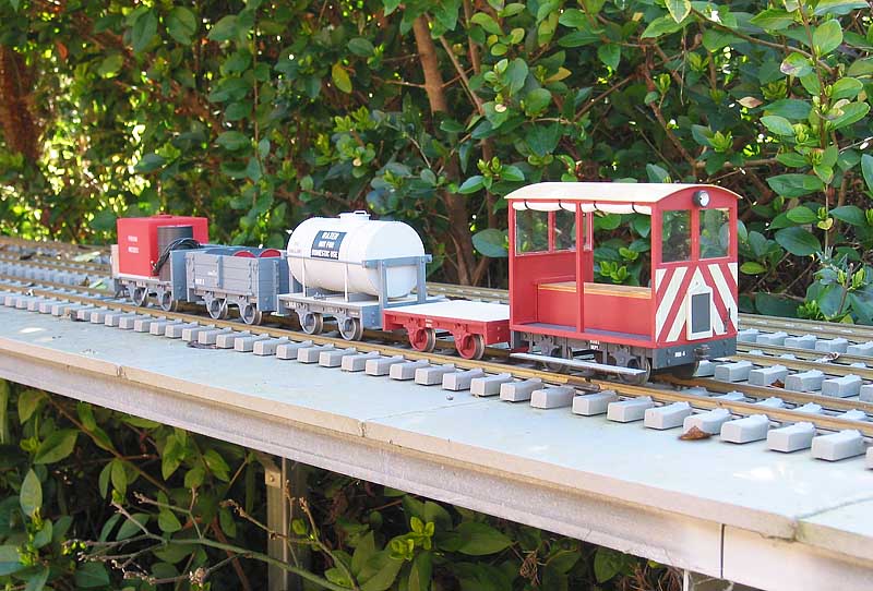

I've got no idea if it will work as a long-term solution, they may just ping/slide/snap off, but I've recently replaced the missing traction tyres on my Faller railbus with children's "loom bands" - this sort of thing: https://www.amazon.co.uk/Refill-Bands-c ... 53503&th=1
They've only had one trundle up the line so far - but so far, so good... I think Faller wheels are 21mm diameter, reckon the bands would stretch larger though.
