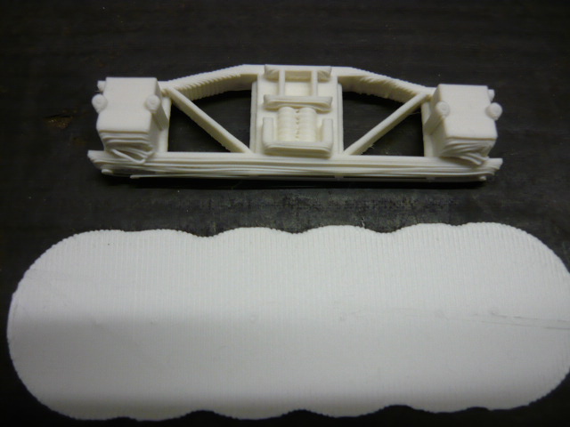

Another bit of trial and error resulted in me learning about how the Z axis offset worked (I think) the pictures below show the same file printed with the offset at 0.1, 0.13 and 0.00, I am surmising that a positive number moves the nozzle closer to the print so conversely a negative number will move it away.
The line down the side of the bed I think is a default before a print to ensure the nozzle is extruding correctly and bed adhesion is OK.

Have a look on Thingiverse for test bed levelling and you will find some pretty handy things to see if the bed is actually level. This is the first one I found but there are many others, this one seems to be quite a favorite out there. https://www.thingiverse.com/thing:4642274
Also do away with the raft printing, it's so wasteful and gives a bad first layer. Go to brim or skirt printing. I always use skirt printing which just puts 3 lines around the print without touching it, just to ensure everything is printing as you expect for the first layer, then there is very little to remove and you know if your bed is level better, it also give a flatter, better looking first layer. This is what I expect to see from the very close up picture below, the dimples arew from my glass bed and super smooth, if it's all lines and rough, move the nozzle closer to the bed and keep trying. It is actually surprising just how close you need to be, the paper is a rough guide, but I find by the time I am finished I can barely get a bit of paper in there.

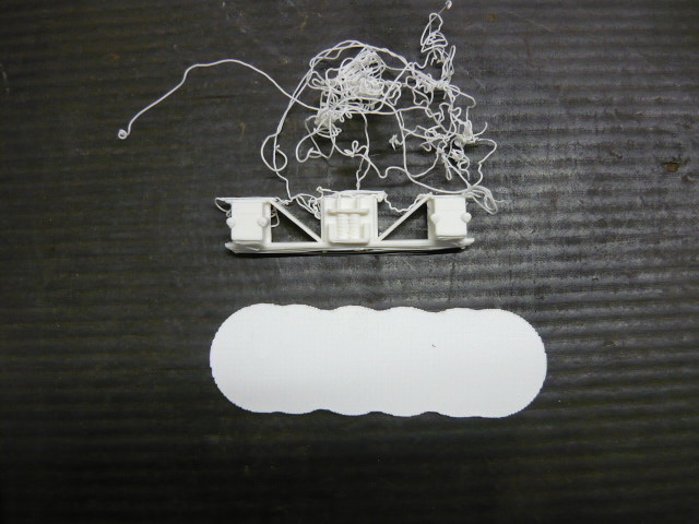

The PLA is what came with the printer and it is now finished so I bought a roll from Jaycar
I used a raft because the bottom of the print has only a few dimples (to simulate bolt heads) so I thought a raft would give better adhesion because of the larger surface area.

GAP wrote: Fri Sep 24, 2021 10:21 pm
Am I understanding you correctly - that you are trying to print bolt head detail on the bottom (bed) face of a print?
If so, I don't think you'll ever get that to work satisfactorily. If you use a raft then the bolts will stick in it and you'll lose them when you separate it. A brim or a skirt will both have the effect of either the heads not sticking and simply not printing (most likely) or if they do stick, then the unsupported main face will end up very stringy and then collapse on to the bed. If you use enough supports to prevent that, you will massively increase both printing time and material cost, and also create a big cleanup problem.
IMO, if you need detail on multiple faces, the best way of dealing with it is to split the object along some convenient plane, then print flat on the bed as 2 halves and stick them togther in due course.

I am not using that file again I have another that printed successfully with the object lying flat on its back on the plate.
The bolster with a hook tongue for the new bogie ended up a monumental fail because there was no support for the tongue and it just went all stringy till it rested on the plate then sort of printed OK.
So onto file number 3 and the I added supports and a brim and it worked well, then it was on to the side frame which is not printing properly. The printer lays a skirt OK but after the 3rd to 4th pass what is laid down sticks to the nozzle and is ripped up and ends up as a huge blob on the nozzle and nothing on the plate.
At this point I packed everything up and went inside for dinner, I shall attack it another day.
With the brim at the first go the edges curled up on 2 ends (it is T shaped) so I cleaned the bed and it stuck well. Another lesson learned.
