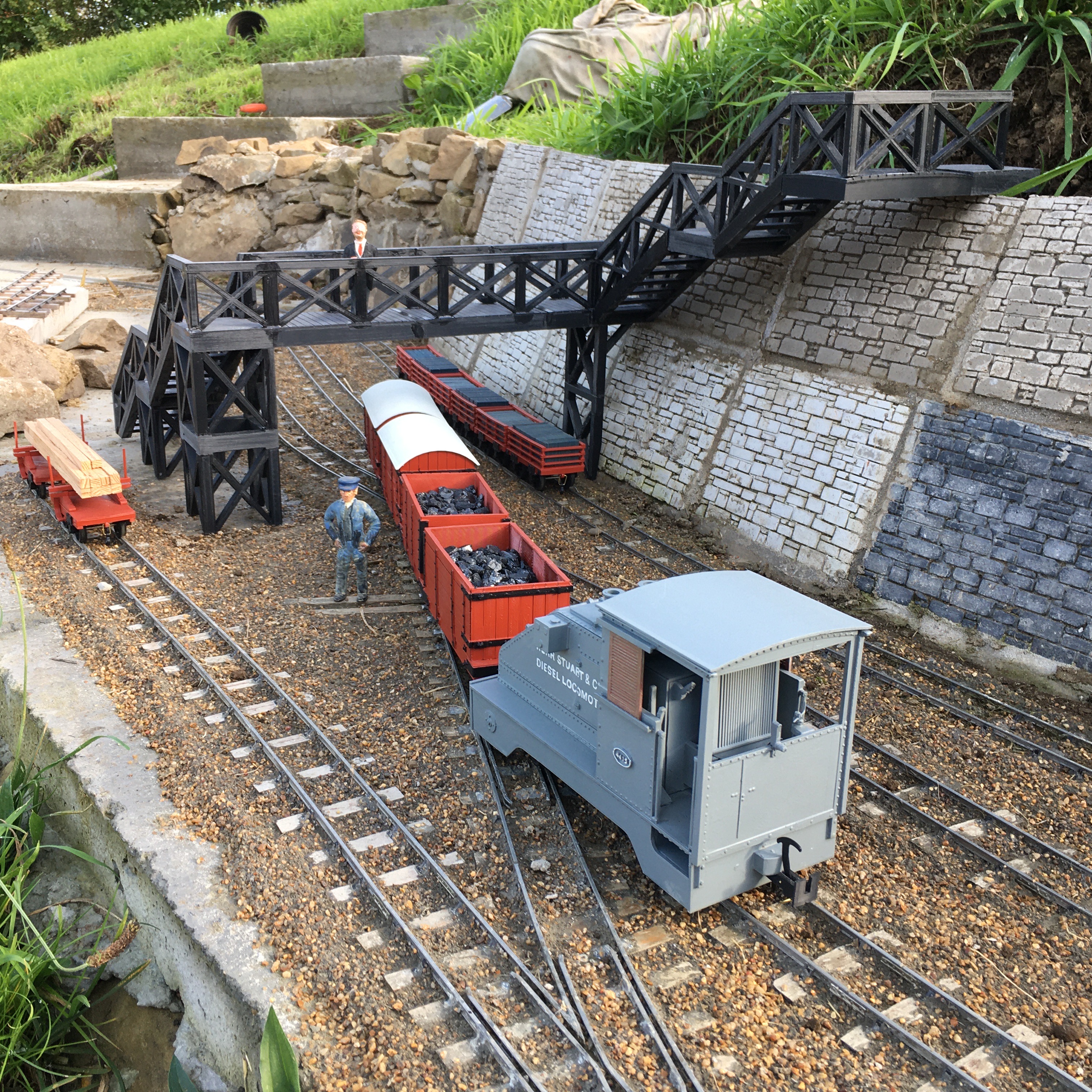

- Posts: 1182
- Location: South West Wales
Re: Buying a 3D printer
Apart from track and groundwork and people everything in this photo was 3 D printed, and designed my me in Sketchup make 2016.
That includes the loco, wagons, and the bridge.
As Peter says - there is loads of information in the 3 D printing section!
