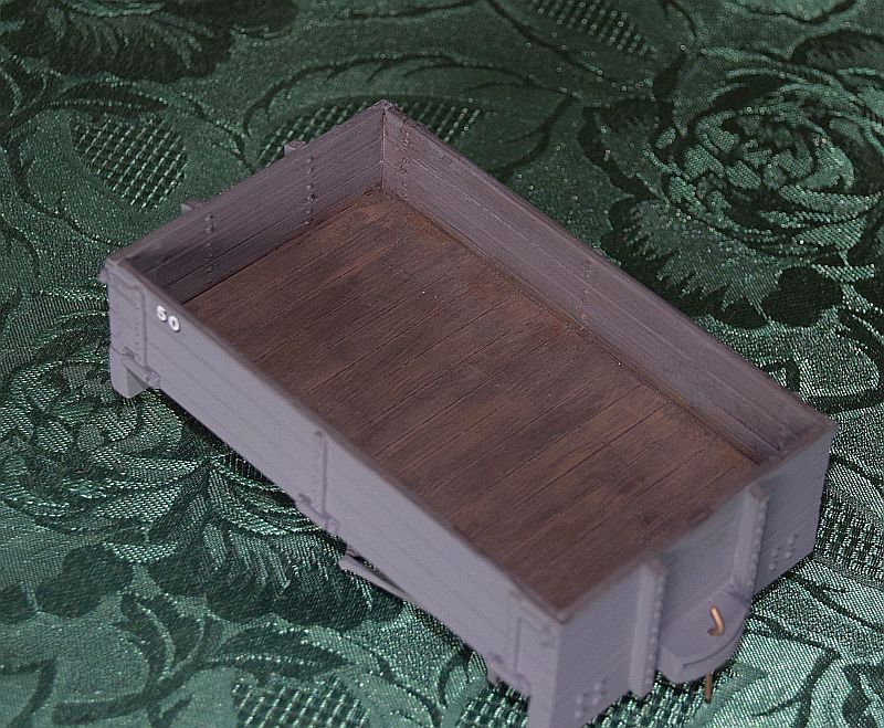

How have you got the detail on the inside of the wagon? Did you print the wagon body as a whole unit or each side separately before gluing them together?philipy wrote: Tue Oct 20, 2020 12:36 pm That looks good Rik.
Can't say I've ever heard of your elephants foot before and as far as I know I haven't suffered from it ( my shoes still seem to fit OK!)! I've printed several of these with no probs.
- Posts: 6033
Re: 3 D Printing 16mm models
A bit of a mixture tbh.
The basic box was printed as one piece and then the iron work and end stantions were printed seperately and glued on. The floor is a piece of scribed 2mm styrene glued inside the body and the underframes etc are printed and glued together underneath. The floor was done that way partly to save printing time and because it easier to get the grain effect with a file on a flat sheet than trying to print it somehow.

Interesting. I suppose printing the sides vertically works well as the striations give the impression of woodgrain. I wouldn't have dared to try printing the body in such an orientation on my old printer, but I could give it a try on my new one.

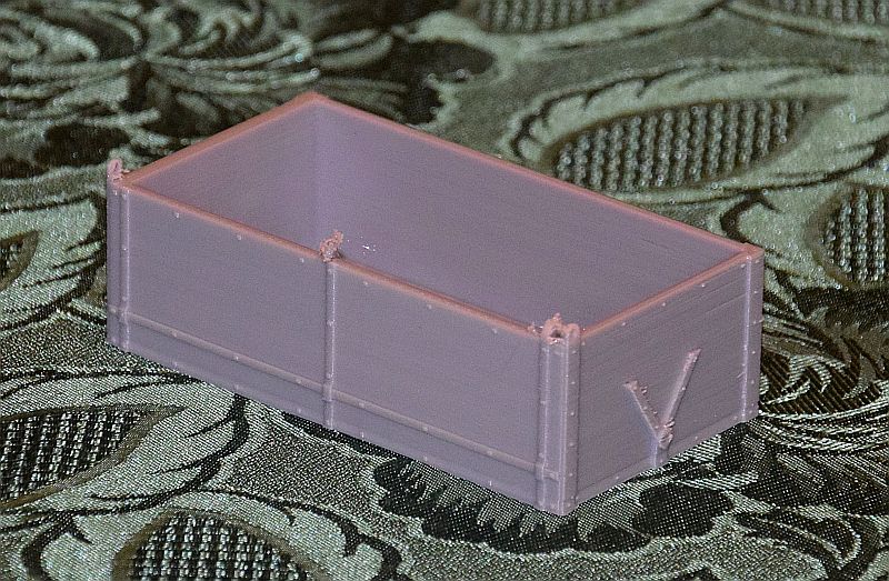

Yes thats what I thought about the horizontals.ge_rik wrote: Wed Oct 21, 2020 8:41 am I suppose printing the sides vertically works well as the striations give the impression of woodgrain.
I was very reluctant to try printing bodies for quite a while because my first attempt when I was still very much a novice was a complete disaster. That was simply a classic case of trying to run before I could walk!
By chance I've been doing some playing with a wagon body using very fine settings and when it came off the printer last night I was extremely please with the results.:
It's an iron bodied wagon, the walls of the model are 2mm thick and printed in PLA with 0.1mm layer height. The strapping is standing proud by 0.5mm. This is straight off the printer with no cleaning up at all. The striations are more obvious under the harsh flash than they are in real life.
The little bits of mess on the front top edge I expected, they are the printer trying to deal with unsupported hinge loops!
I wonder if I dare try at 1mm wall thickness??

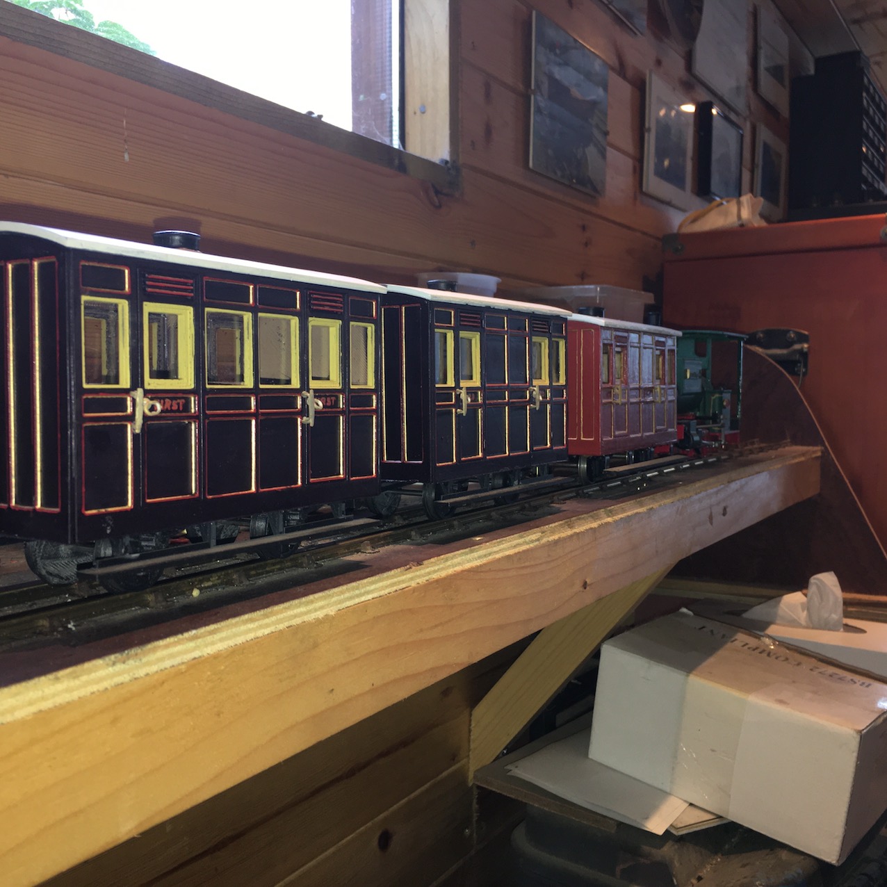

Just as a final offering wrt the Ashbury 4 wheel coaches. Here they are finished:
I think they are as good as I can make them - however I were to make them.
What I have worked out is that there are errors in the drawing I used. I took the drawing from the 7mm associations book on the Festiniog rolling stock, and it shows a central external frame vertically in the central panel. I note that photos of the original coaches - and my own photo of the replica show that the central panel does not have a central bar across it. I have altered the CAD files and will print out more in due course.

Those coaches look really good, well done.

Don't you just hate it when that happens?! The incorrect bufferbeam on my WHR Pickering brake happened tat way, and it still bugs me 10-ish years later!Trevor Thompson wrote: Fri Oct 23, 2020 2:46 pm What I have worked out is that there are errors in the drawing I used. I took the drawing from the 7mm associations book on the Festiniog rolling stock, and it shows a central external frame vertically in the central panel. I note that photos of the original coaches - and my own photo of the replica show that the central panel does not have a central bar across it.
Lovely looking carriages though, and the lining's fantastic.

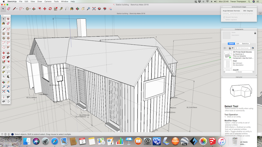

My latest project for the printer is a model of the original station building at Tan y bwlch.
I haven't been able to get there to take measurements for obvious reasons, so it has all had to be based on photographs from the internet. I managed to find views of each face of the building.
This is the sketch model I have created:
Because I am limited to 150 x 150 x 150 mm on the printer it had to be printed in sections. I created a solid floor to build the model around. That is in 5 pieces:
and the other side with the first three sections of wall erected:
and the current state of progress:
More as it develops!
