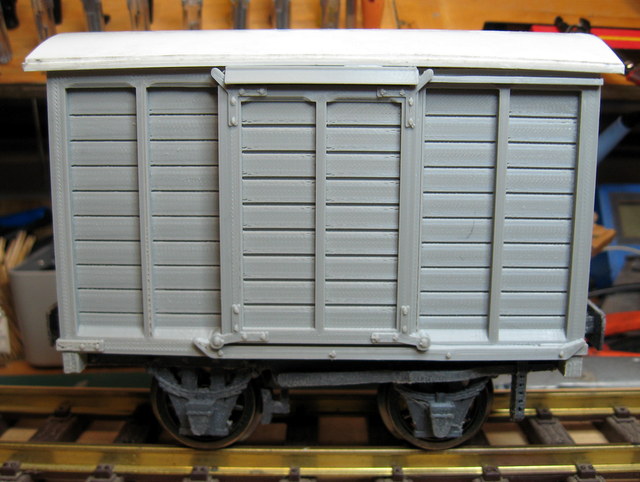

Posts: 7974
Re: 3 D Printing 16mm models
Post by ge_rik » Fri Nov 06, 2020 7:29 pm
My latest effort....
Drawn in TinkerCAD and printed off.
