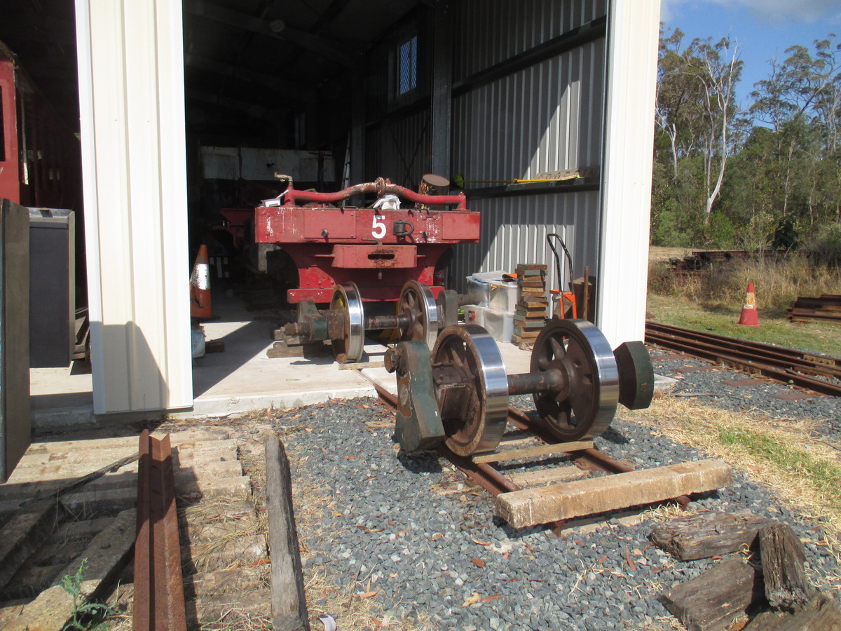

For what it is worth, I made the driving crank pin from silver steel (or was it an off cut of a 1/8" HSS drill shank?) as it was pressed on and did not need any threads. The eccentric crank will be cross pinned using 1.00mm HSS drill shanks, this is yet to be done after test steaming. The rest of the pins I made as per BW book and I case hardened the threaded pins with "Cherry Red" , which seems to work well. Not sure how deep the case hardening goes but a file skids over it. I used PB for the rod bushes. I cannot see why you would cross pin the crank pins to the cranks. I could not find where B. W mentions this in the book ??
I made the Quartering jig as like in the book and added lock nuts to the centre screws to enure they did not wobble about and also wooden wedges to ensure positive engagement of the pins to the jig. I felt this was very worth the effort.

Aye, Airdmillan is up the front of our storage compound. Like most things at Woodford, it looks worse than it really is, but we'll likely never get around to doing anything with it, due to having too large a collection and an extreme shortage of active hands. No shortage of armchair enthusiasts whinging about it all slowly returning to the earth, though..
Here's the only shot I have of the loco. Ironically, I took loads of photos of it for a mate of mine last year, whom decided to build a static model, and needed reference material. Sorry to tell you I no longer have them, as I don't need the photos myself, and am running out of hard drive space. There's too many photos for him to email me any useful number of them, and what with this plague about, I can't visit him to get copies. For the same reason, (among others) I won't be getting to Woodford any time soon..
Quite sorry about that - normally, I'd be in much better a position to help.
I do however have a few shots of our flagship, Bundaberg Fowler No.5, taken when it's drivers were returned from re-machining back in September. Being a virtually-identical copy of Airdmillan, I hope these photos might be of some use to you.
