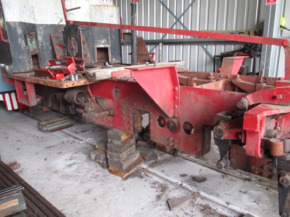

btw - more updates from the restoration of full size Fowler at Steam Workshop :

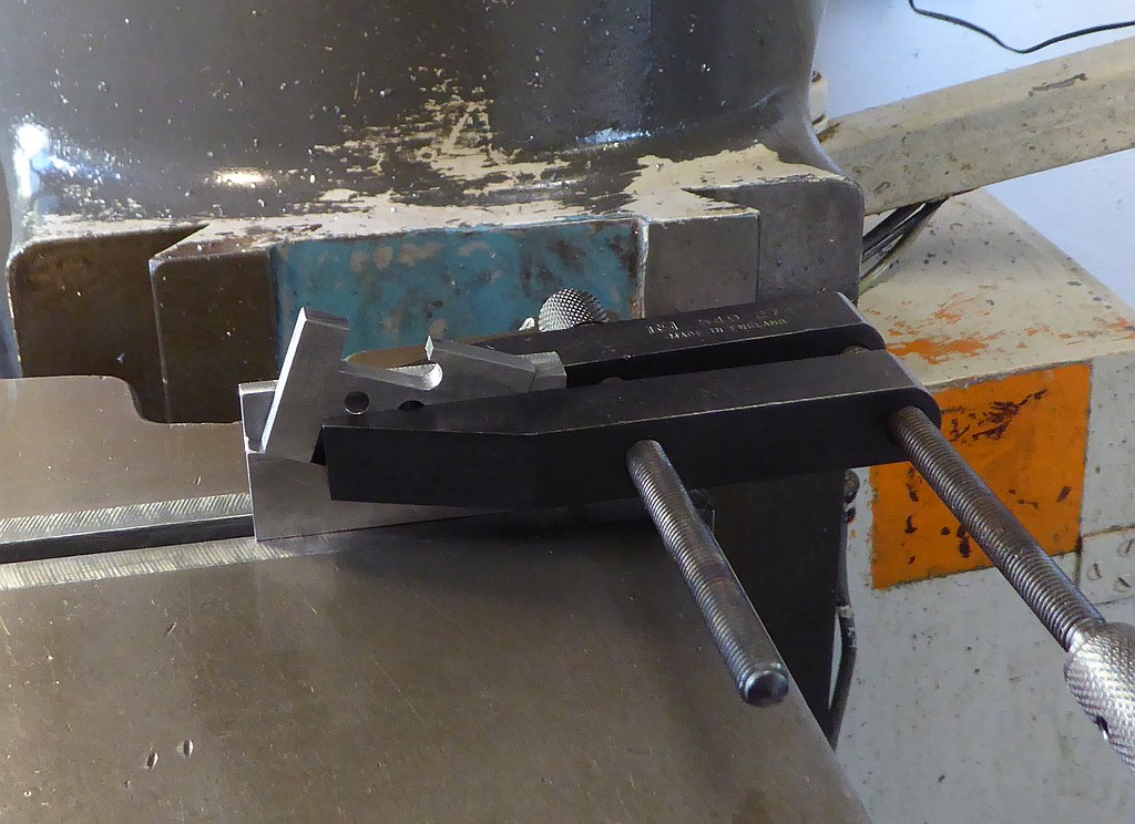

Next update is about cranks.
First a "test run" to make sure everything works as planned
I have spare axle with wheel from when I was making them, so will use this and one test crank to check some of my ideas.
Each crank starts as a rectangle of steel, with holes drilled and reamed (using DRO means everything should be quite accurate):
Next the crank start taking shape:
Balance weight are angled at 20deg, so simple fixture makes sure they will look OK:
Round face of balance weight is turned on the lathe, using simple mini faceplate:
It even has little "dog" to push crank round - when I first tried without it, just using centre screw and relying on friction, things went pear shaped
and.. finally little buttons and bit of filing to round the crank.
Didn't have silver steel to make them hardened, but regular mild steel was just fine for one off (silver steel on order)
That's it for today. Next... crankpins and loctiting and pinning it all in place.

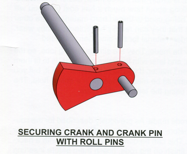

Which leads me to a question:
In Brian Wilson's book both crankpin and axle are pinned to the crank (page 22).
Axle bit makes perfect sense, but why pin crankpin? - it's not as if it is going to twist itself off (unlike possibly axle/crank joint).

There it is (scanned from the book):Hydrostatic Dazza wrote: Thu May 07, 2020 10:23 pm ... I cannot see why you would cross pin the crank pins to the cranks. I could not find where B. W mentions this in the book ??...
I guess it's another poetic licence by the illustrator and book's ghost writer
I have every intention of ignoring it, but thought I'd do sanity check here, just in case I've missed something.
I suppose someone will tell me that I am "overthinking it" but that's fine

bambuko wrote: Fri May 08, 2020 8:05 amThere it is (scanned from the book):Hydrostatic Dazza wrote: Thu May 07, 2020 10:23 pm ... I cannot see why you would cross pin the crank pins to the cranks. I could not find where B. W mentions this in the book ??...
I suppose someone will tell me that I am "overthinking it" but that's fine![]()
I found it now. Blind in one eye and I cannot see out the other.
Roll pins = ERRR Yukk in my thinking. If you have to cross drill and pin a driving crank pin then something went wrong. 0.01mm interference would be fine, but put a little step on the pin. The next time I will do it I will make the pin over length, with a size to size fit to the hole to the excess length and thus the pin is lined up nicely as it is pressed in. 0.010 will make a nice interference fit and will be lined up but the excess lead it part. A drop of Loctite but it should be a waste of time as it will be wiped off if the interference is correct. After the excess is cut off, Dremel cut off wheel and diamond file to finish it off. I think one of my pins went a wee bit off, annoying but noticeable minor tight spot, so next time I will have the lead in portion to be cut off after.

Here's the only shot I have of the loco. Ironically, I took loads of photos of it for a mate of mine last year, whom decided to build a static model, and needed reference material. Sorry to tell you I no longer have them, as I don't need the photos myself, and am running out of hard drive space. There's too many photos for him to email me any useful number of them, and what with this plague about, I can't visit him to get copies. For the same reason, (among others) I won't be getting to Woodford any time soon..
Quite sorry about that - normally, I'd be in much better a position to help.
I do however have a few shots of our flagship, Bundaberg Fowler No.5, taken when it's drivers were returned from re-machining back in September. Being a virtually-identical copy of Airdmillan, I hope these photos might be of some use to you.
Aye, Airdmillan is up the front of our storage compound. Like most things at Woodford, it looks worse than it really is, but we'll likely never get around to doing anything with it, due to having too large a collection and an extreme shortage of active hands. No shortage of armchair enthusiasts whinging about it all slowly returning to the earth, though..
