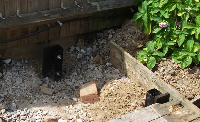

The loco shed area has been re-decked in treated timber as before.
Proper creosote was used, nice and smelly. This area is strong enough to be able to walk on – necessary while attaching the fence buildings/laying track etc.
The fence plastic retaining wall and the Post hotel have been re-affixed after repainting. The end section of the retaining wall, which had notches to fit over the fence rail and the cable that goes to the shed, is at home being modified as the cut-outs are now in the wrong place. The Factory building sections are also at home being refurbished/repainted.
Track has to be relaid of course, as well as the putting back of the engine shed.
The adjacent section of decking is in poor condition, and will not support much weight without flexing.
With regard to the more extensive use of plastic – [Thank you for your interest BCATRR] Yes, if I were to start to build a new garden railway that was to last at least ten years then I would make greater use of plastic materials and try and avoid using timber wherever possible.
Nowadays we use plastic square rain water pipe for the supporting posts. At first we post-creted these in, but now we just beat ballast (sand and stones) around them – this seems to work ok.
Offcuts of PVC cladding (facias etc.) have also been incorporated into some recent work, and will be in the future, but this may depend on being able to get any of this material free of charge or very cheap, as well as being able to transport it to the railway.
The funding of working on the FBGR is just a steady trickle over time, probably averaging to much less than £10 a week between the two of us for everything. Owing to the higher initial cost of using plastic sections (which also has to include a shipping cost), against that we can buy just a couple of bits timber at a time as we work out what to do next, we are likely to continue to use timber.
The fact that I am nearing 70 years old and that the FBGR will not likely be around in ten years time may also have a bearing on how much we invest in infrastructure.
