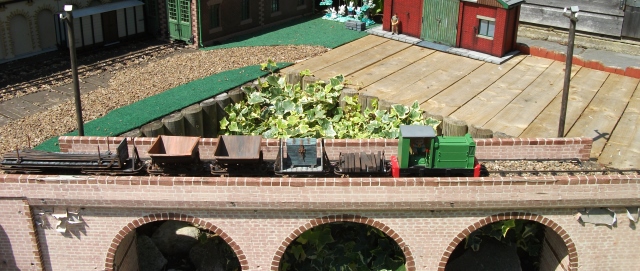

The original three arch bridge was made of plywood in 2008. I took a lot of care in treating the timber before priming and painting it, finishing off with varnish. But still the damp got in and made a mess of the paintwork, and it has started to rot the timber. Some may say 7 years is not too bad.
A couple of pics to show the state it was getting into. I used to use it as a stage to take photos of rolling stock.
The replacement is made of Foamboard with stone joints pressed in, painted with B&Q stone paint sample pots. Looks quite bright at the moment, but I expect that it will tone down in time.

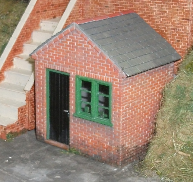

After playing about a bit more with this Foamboard material, I started to use it to pave over the rough timber deck of the FBGR Station area, starting with filling in the space between the Arches and the Back Siding with what looks a bit like a cobbled street.
Here is a bit of a close-up to show the ‘cobbles’.
I have a screwdriver set, one handle and dozens of blade inserts, as the main tool for pressing into the surface. It can get a little boring, but seeing the surface develop as you go does provide some encouragement to keep going.
An early effort to see what I could get brickwork to look like was this little weighbridge hut in 7mm scale, done for the Fareham & District Model Railway Club’s Fairhaven Town layout. Its a bit rough, but it was interesting to work in a smaller scale just for a change. The brickwork behind is embossed plasticard.
JOhn de Havilland

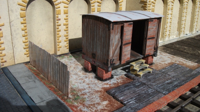

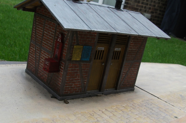

Carrying on with the ‘paving’, I have added a little something to fill up an empty corner.

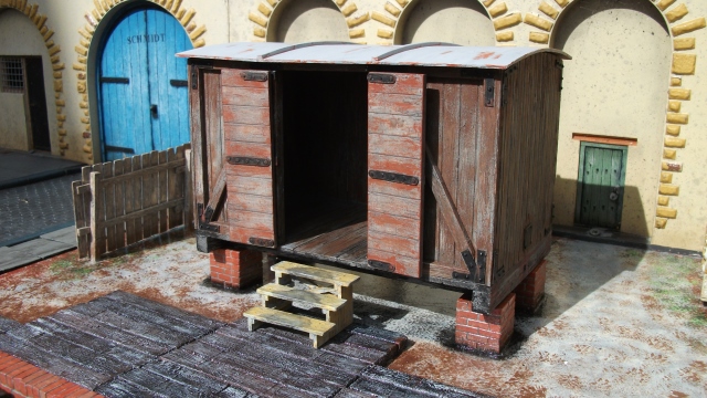

I knocked up a length of fence and this old van body to act as a store. All Plasicard except the little brick piers and the deck made of sleepers in front of the shed is Foamboard – each sleeper individually formed and surfaces dealt-with much like Plasicard.
All now lives outside – I’m using more acrylic paint nowadays, so I wonder how it will weather.
I then extended the paving a bit further, and added a sleeper pile and rack for rails or telegraph poles.
JOhn de Havilland

The original painted-on bricks/stones to the three arch bridge (see top picture above) were done back in 2008 with a couple of home made rubber stamps using acrylic paint. The colour had definitely toned-down/faded a bit over the years. The FBGR is about a km from the sea-front and when a South-Westerly is blowing you can taste the salt in the air.

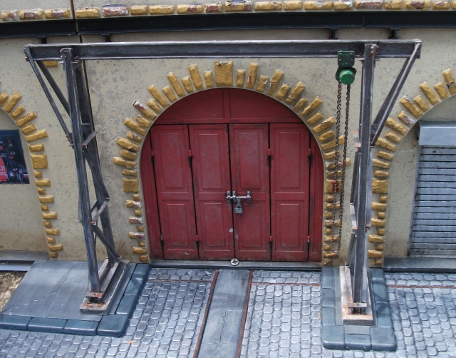

I’ve added another little point of interest, a gallows hoist in front of an arch doorway – as usual all in Plasticard but not the chains of course. These came from my parts bin and so may even have been from some of Erika’s (the wife’s) broken and discarded jewellery (‘Argos Gold’), but I painted them anyway.

Excellent John, beautifully made and looks just right in that location, exactly as it should be!
I have been toying with the idea myself and have a site outside my engine shed where it would be appropriate I think? When I get round to it I will post pictures. I thought of making it with a small truck mounted on rails at the top giving the impression of greater lifting capacity. I have probably seen something similar but can't remember where!

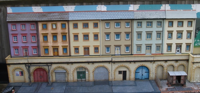

The POLA Station has been sitting there all alone for a few years, and so I thought it was time it had a bit more platform (in Foamboard). A ‘typical’ Germanic railway building was also knocked up with Foamboard walls and Plasticard roof and details to populate the platform (plus a cast metal ticket machine – I can’t remember if this came with the original Station Kit of was obtained separately). The doors, suitable marked Damen and Herren, face the platform edge, so cannot be seen from the normal viewing side – still I know they are there, much like the internal timber roof structure which you can’t see from any angle.

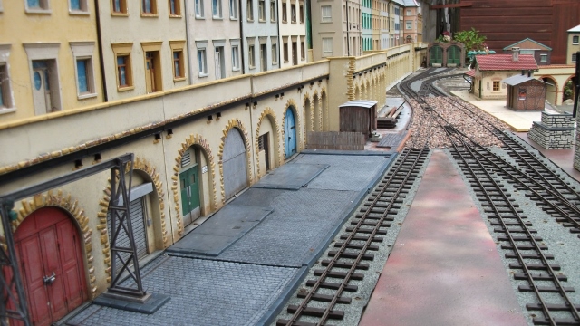

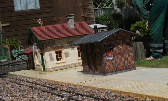

To finish up before the worst of the weather, some more areas around the Station Yard area were covered in Foamboard sheets. Mostly only 2 mm thick, this material was obtained as scrap from a local signmaker. Hammered with a small bit of paving stone to put random dents over the surface and then just a few passes with different coloured spray cans to tone the colour down a bit.. Adding a couple Locating Bases for the Water Tower and Coal Stage - these are not at left out at present, but then we have no Steam Locomotive on the FBGR roster at this time.
We have started to do some ballasting, not bad £10 for three 10kg bags from Mole. It has to be washed before spreading and is fixed down with diluted PVC.
With Winter now upon us, the completion of the Ballasting will have to wait for the Spring, and in the meantime, I have been looking at the state of some of the Fence Buildings and Retaining Wall, and will start to take them home, one or two at a time, for repair/refurbishment and repainting.
JOhn de Havilland
JOhn de Havilland

The ballast make such a difference and completes the picture. Certainly the weather is not the best for attempting this job but it will be worth waiting for Spring so you can continue.
Great pictures looking along the length of your railway, the structures set the scene beautifully.
