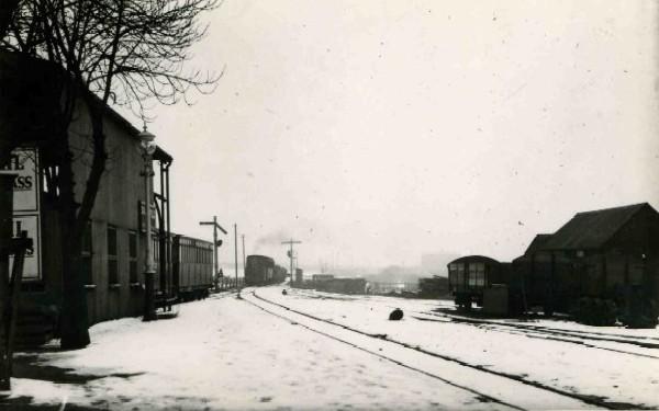

Marquis DeCarabas:110336 wrote:Here's a pic of Southwold station throat that may help - you can see the y-shaped yokes from the point blades to the signal hand levers.
These are combined 'block' semaphores and point indicators, I think.  This appelation does not universally apply, but I would a) need to look at the 1908 signalling regulations carefully and b) check to see if there were more than one centrally or only at one end of the loops.
Interesting. It looks as if they moved the signals between the two photos. In the one above, the 'inner' is beside the turnout to the carriage shed. I my later one the inner is by the leading turnout for the station.

ge_rik:110347 wrote:Interesting. It looks as if they moved the signals between the two photos. In the one above, the 'inner' is beside the turnout to the carriage shed. I my later one the inner is by the leading turnout for the station.
OTTOMH, I don't think anything changed at Southwold, but I will dig around. I've found some of my virtual notes on one level of this machine, but I need to dig a bit deeper as I think there are more notes on the preserved desktop of the next further machine back in time.

I think you're right. Here's another later picture of the station with the inner still beside the carriage siding. I think there's some foreshortening of perspective in your shot - presumably taken with a long lens.
Marquis DeCarabas
Post by Marquis DeCarabas » Thu Apr 23, 2015 9:26 am
ge_rik:110356 wrote: I think you're right. Here's another later picture of the station with the inner still beside the carriage siding. I think there's some foreshortening of perspective in your shot - presumably taken with a long lens.
Ah, yes. That's Fanny Foster's picture. Note that the further signal has had the shunting arm added and a small bothy erected.

The fishtail arm caused an extra stretcher to be added to the first points at Southwold, presumably as the forked detectors only worked when the station throat points were normal and the fishtail read into the goods yard.
[1] think LNW tumbler conditional locking, but upside down.. I'll rummage around and get up some illustrations. I found the Southwold signalling regulations last night.
As regards the groundframe and signalbox at Blythburgh - this was another anachronism the groundframe was for signals only, but did include an additional Distant by Blythburgh Church.
Blythburgh GF - not sure of the design, but will work on it.
Blythburgh "SB", note the elevated signal in the distance.
Close up pf the Bothy in Fanny Foster's pic. Note the fishtail arm.
