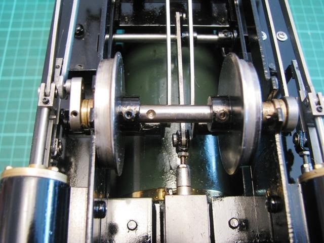

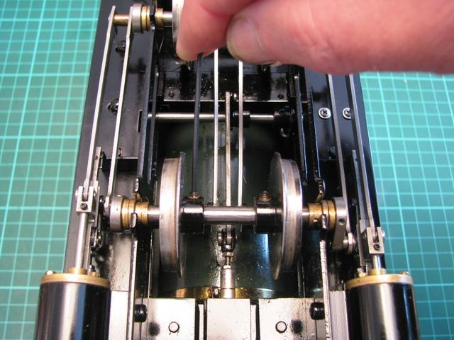

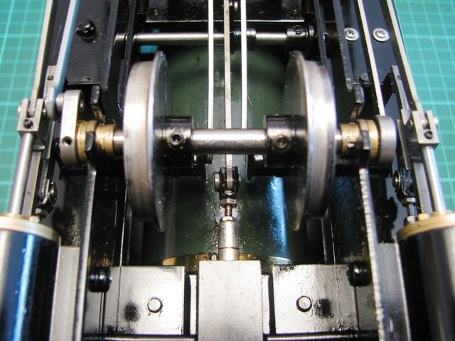

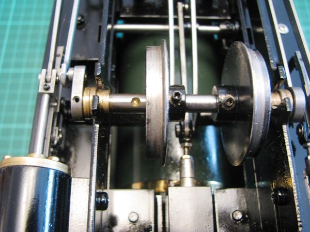

Hi Chris,
Here is my Accucraft Ragleth for an illustrated instruction using the front axle. The gauge is currently set to 32mm.
Insert your allen key and loosen the grub screw. Accucraft supply the allen key with their locos, but these tend to go walk about before the loco is sold on 2nd hand. You require a 1.5mm allen key.
Slide the wheel out for 45mm and engage the grub screw on the outer dimple. Here I have moved the wheel well inboard so you can see the outer dimple (the inner dimple is under that wheel).
In this image I pushed the wheel to the furthest outer position to show the inner dimple for 32mm (the outer dimple is under the wheel).
If you have an Accucraft loco fitted with a pony truck like the Excelsior or Leader these came with a 2nd pony truck for re-gauging. Again these tend to get lost so many 2nd hand locos do not come with the 2nd pony truck, and they are not available as a spare part.
