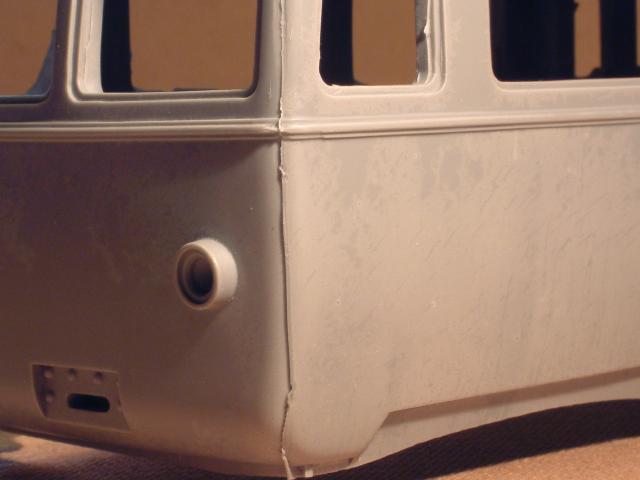

I found three things specified very true: a really really good wire cutter; a new file, and paring down where specified (rather than filing) WILL save you time.
My biggest fear of cleaning up the moulding at the corners where they are well-exposed was groundless. It really didn't take long, just follow
the instructions.
Before:
After:
I am impressed with this kit and its instructions. The only (hair-splitting) fault so far is that the original instructions didn't draw attention to opening up the motor cut out. But the fact that you can assembly it dry and push it along track made me realise the need to do it.
Also first rate response - the instructions have been amended within less than 24h of the problem being mentioned.
