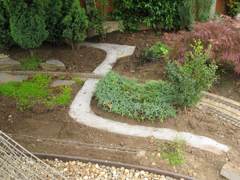

Been doing some mods to the Crowfoot Light Railway with some roads being constructed of concrete on hard core with coloured (blackish) mortar as final finish.  Also a rebuild of the station platform at Crowfoot Hall stn with the infil made of coloured mortar.

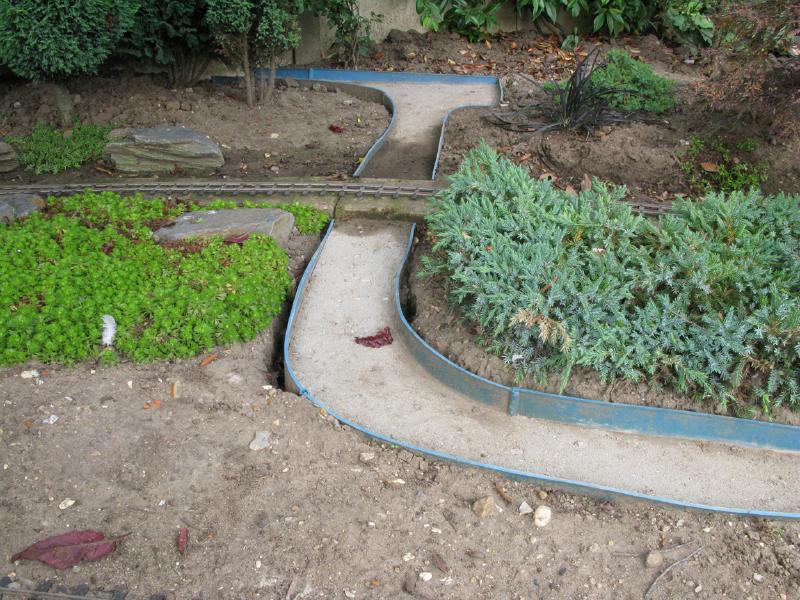

I've used some redundant lawn edging as shuttering.
Not the best photo but the coloured mortar has been applied.
With the shuttering removed we need to let nature do some work and of course the crossing gates and similar need to be built.
These roads can be walked on and will gunge up nicely eventually.

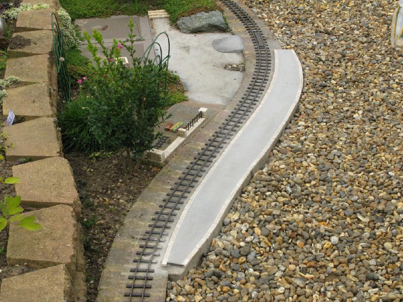

Now for the new platform at Crowfoot Hall Stn.
The white stone wall on the right of this photo was parallel to the track before I tidied up the tracklaying and this shows the extent of the re routing.  The platform on the left is not filled and you can just about see where the old concrete base was that supported the resin 'timber' halt that was the previous platform.
All done and infilled with coloured mortar.  This can also be walked on but as it is part of our dogs garden patrol route, it is not possible to have any knock offable bits on a permanent basis.
