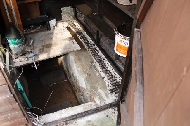

I have a pit in the shed. I hope one day to have a hydraulic platform that I can lower myself into it rather than jumping in and out at the moment. Pit is 3' deep and measures 5' x 3' is fully lined with membrane and breeze blocked.

that's a very nice pit you have, if you fit the platform I do hope the theme from Thunderbirds will play as you descend :lol:

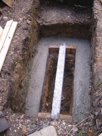

todays progress. I bought a concrete lintel to run down the middle and made the same sort of thing in concrete to form the floor support all the way round. The paving slabs will be mortared in place
The hole underneath will be filled with rubble and shingle, mainly to give support to the walls but allow water to collect and soak away.

This is turning into a serious civil engineering project and will last for years. You have thought it through and know what you want to achieve, so ' more power to your elbow!' (as they say).
Post by Soar Valley Light » Thu Aug 14, 2014 6:15 pm
That's looking like a real good job Gremlin. The soakaway capacity looks like it ought to cope with any but the most exceptional rain falling into the pit, it's a small enough catchment area after all.
What is the lie of the ground around the pit like though? Does the ground fall towards the pit on any side? If it does then some sort of shallow grading of the surface to act as a cut off might be very prudent.
