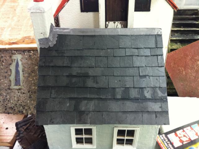

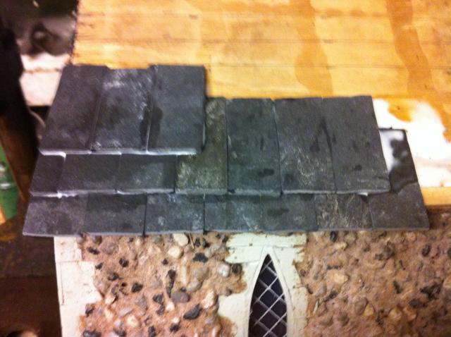

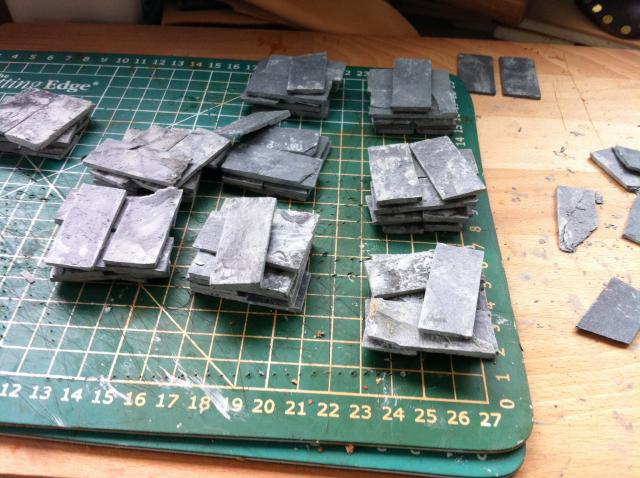

Right then, day off work so finished my tap class and went to a roofing reclaimation place and picked up 5 Welsh roofing slates! Mr F C had spent the night before pouring over geology maps deciding where the best slates come from! Apparently you can get Welsh, Spanish and Chinese! So we decided on Welsh and the man at the yard agreed. So Mr F C spent the afternoon cutting said tiles with our brand new tile cutter as the other blew itself up and started to split them. And here are a few to as the evidence!
Not bad eh! A little thick but using the ten foot rule and the relative small cost to buying ready made slates, worth a try! So I spent a few minutes trying out the effect on the church! What do you think?
Just as a comparison this is the cottage roof I did the other day with Richard Stacey's roofing tiles. To cover the church in these would cost £50-60 so perhaps now you see why we are doing it this way!

Post by philipy » Thu Apr 24, 2014 6:54 am
I like the church, well done.
Can't see the other pictures though, just 'broken picture' icons and it says they "contain errors".

Post by Mrs F Controller » Thu Apr 24, 2014 8:00 am
Tried again don't know what happened there!
Posts: 6049
Post by philipy » Thu Apr 24, 2014 12:58 pm
Thanks, thats better!
Yours look just as good and in some ways better - more weathered. Is the thickness just down to lack of confidence in splitting them all again successfully, or is it a material limitation?
I'm seriously thinking I might have a go at it on a couple of buildings I'm planning.
Mrs F Controller
Post by Mrs F Controller » Thu Apr 24, 2014 2:13 pm
Thank you! Yes I think it's limitations on the material although he does seem to have got better as it went along. Also getting the right tiles helped as the flooring tiles didn't split well at all. We went for Welsh slate as that seemed to look better in the yard. He did cut the tile up into the right size first as we felt that splitting the whole tile to such a thinness would make it too weak to cut to size? But willing to give it a go. The only reason I started this is not because it is more realistic but down to needing to have a durable roof material.
