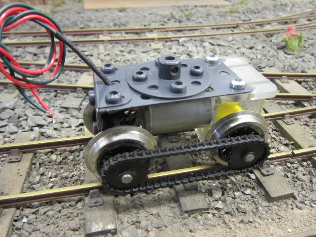

I have built a power bogie for a future project which might be a suitable pattern for you to use.
It is a low voltage motor with plastic gearbox but is more substantial than the ones from I.P. etc.... The chassis is made from Meccano and the second axle driven by Delrin chain.
Early days for installation in a model (but not too long away!) but I have tested it and it works very well.
