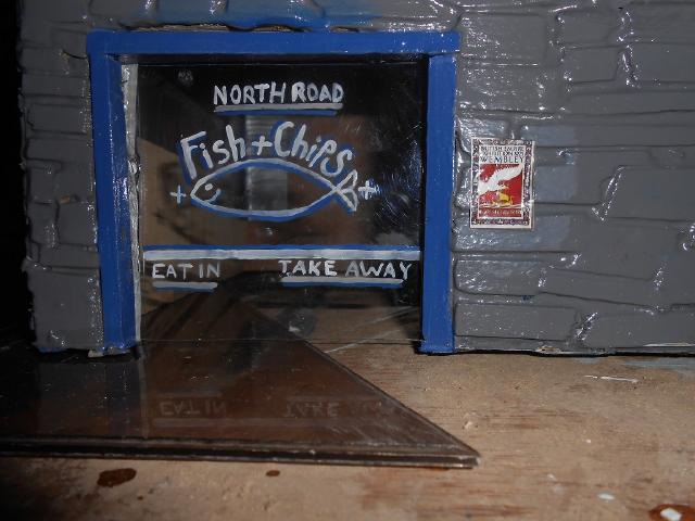

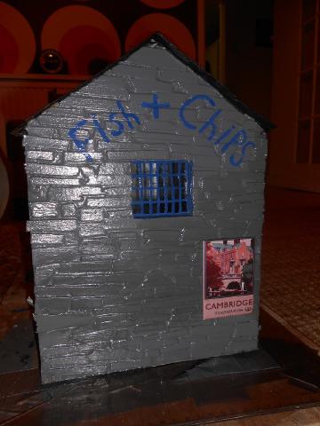

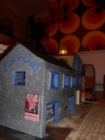

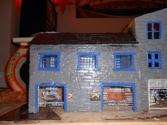

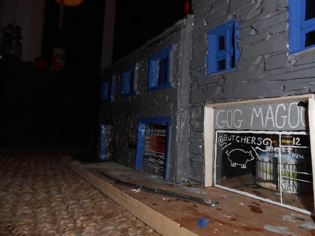

been doing this building on and off for a month or more now iv been so busy and not having a camra for a bit I haven't been able to take any photos.so heres a few for everyone to see made from off cuts of plywood from work then coverd in basa wood srips and then lots of pva .then iv given its lots of coats of a mixture of gloss and black to make grey. after lots of coats it gives quite a good effect and is ment to look like stone work.the shop fronts are painted on glass from old picture frames and the roof is carboard slates guled on with pva and then painted with knotting the knotting sokes in the carboard and should help waterproff it after this its painted with black outdoor paint .
Post by laalratty » Mon Dec 02, 2013 8:45 pm
some nice details in that, but it might be nice to pick out some of the stones in slightly different shades of paint and maybe try a light bit of weathering to tone it down a bit

Post by jim@NAL » Mon Dec 02, 2013 9:05 pm
good point iv got a bit to do to finish it I may try some wheatering powders on it tomorow

Post by Gremlin » Mon Dec 02, 2013 10:31 pm
I like the stone effect and the roof is very effective, nice details.
Dry brushing and a wash would give more depth to the stone work.
If you used powders they would need to be fixed with a spray varnish. .

Post by Peter Butler » Tue Dec 03, 2013 12:22 am
Gog Magog (Google it) Butchers....... Deep!
What reaction do you expect when it is out there?

Post by jim@NAL » Tue Dec 03, 2013 6:19 pm
well spoted its a farm shop that I do a lot of bulding / carpentry work there me and my dad built the café and have done a lot of the other buildings out.the sasage rolls and schoch eggs are fab .
