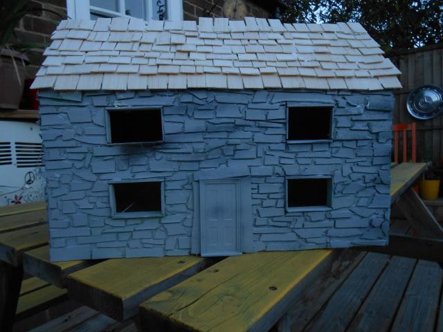

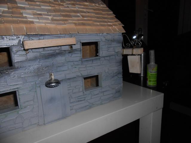

every railway needs a pub.had some off cuts of wood from work so made a pub.bit inspired by peter jones very good book making modle buildings for garden railways

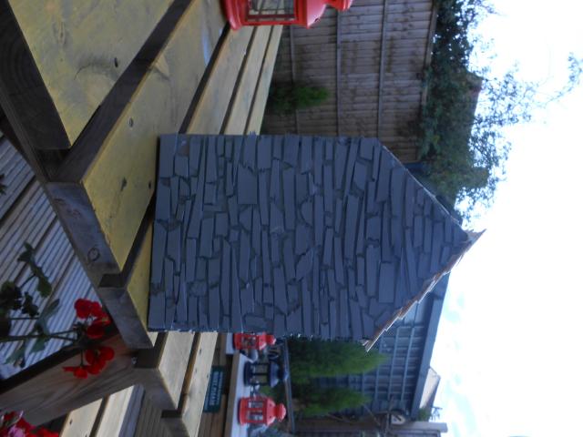

Post by Vapouriser » Sat Sep 07, 2013 7:30 pm
I like that jim. How did you do the roof?
Posts: 1142
Location: haverhill suffok
Post by jim@NAL » Sat Sep 07, 2013 7:42 pm
the stone work is basa wood snaped and guled .the roof tiles are basa too. coverd the roof in plumbers type mastic to glue them on .going to cover the hone thing in pva a few times to make it more water proof .the gray colour was sprayed on jest to see what it looked like .the roof tiles look a bit rustic but I wanted that way to make it look old

That looks great, the rusticness is very....er....rustic!

Post by Catweasel » Sat Sep 07, 2013 11:04 pm

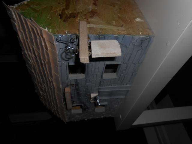

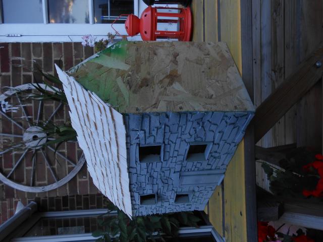

May I suggest that you rotate your photo's prior to posting please?

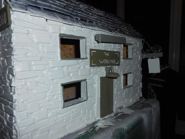

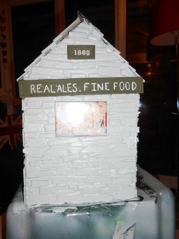

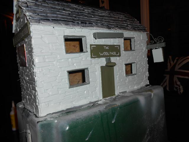

painted roof and findows to finish
Post by jim@NAL » Mon Sep 16, 2013 10:34 pm
Posts: 1142
Post by jim@NAL » Mon Sep 16, 2013 10:39 pm
hope you all enjoy the pics lots of layers of glue and lots of paint starting to look quite good .iv taken a lot of the idears of what peter jones said to do in his book and it seams to of worked quite well going to make some more buildings like this

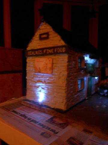

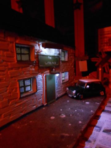

Post by jim@NAL » Wed Sep 18, 2013 9:25 pm

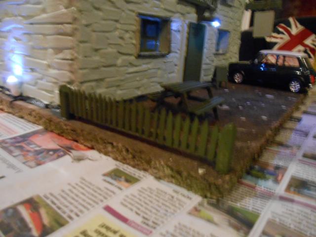

a string of sola lights put in and pub is looking quite good mounted on an old roof tile from work
RylstonLight
Posts: 209
Post by RylstonLight » Wed Sep 18, 2013 11:17 pm
Those nihgtime shots really bring out the random stone courses. Can I suggest every country pub needs welcoming lamps in the windows? I always feel an irrestible draw to a country pub on a winter's afternoon with nice warm lamps in the window. Either that or, hic, I've a drink problem.

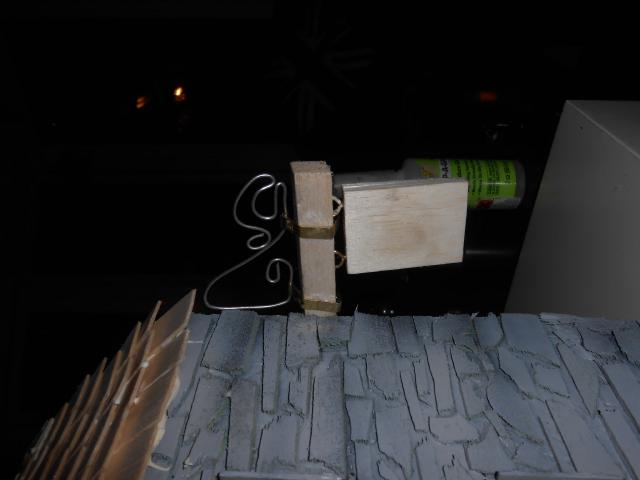

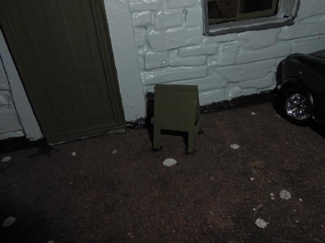

tonight iv made a few more bits to finish off the pub
Post by jim@NAL » Thu Sep 19, 2013 8:58 pm
I made a small picnic bench a picket fence and an A board
