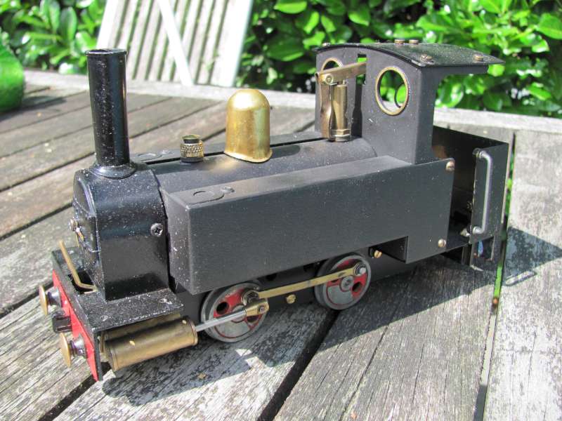

This is my entry into garden railways. I like the looks of it, so I won't change much. Some nuts and bolts will be replaced and/or removed, philips heads just look wrong and I see no reason why the roof of my loco should have nuts and bolts on it. An extra pair of handrails on the cabin would be nice also. Maybe I'll add or remove some other things also, who knows?
Currently the loco doesn't have a burner, but that's ok I don't have any track to run it on anyway. ;) I'm going to make an alcohol burner for it, I don't like the noise gas burners make.
Paul

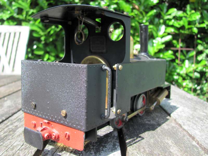

Post by Superbiker_uk » Sun Aug 11, 2013 8:35 am
Chris Cairns:86785 wrote:Looks like a Salem Steam Models bunker on the rear............
Yes - definately. Here is one one of the SLK1's I have owned (now sold). I do have another of these bunker set-ups for another of my projects.

Post by The Denying Dutchman » Sun Aug 11, 2013 10:37 am
So that's why the two connection point on my bunker is a bit flimsy, it supposed to be mounted to the rear plate of the cabin!
Still I think the open cabin looks nicer. Maybe I'll add a plate so that I can fill the bunker with coal. No doubt that the driver and fireman won't be happy about that, the severly limited living space means that their table and chairs have to go.

Post by The Denying Dutchman » Sat Aug 24, 2013 12:01 am
Thanks to the generosity of Chris Cairns my loco now has the missing cab handles, thanks again Chris!
Looks a whole lot better in my opinion. The Salem bunker is mounted a bit too high, but I'll fix that when I've made a burner.
Paul

Culd you tell us, please, by how much in mm, the Salem addon extends the frames by?
Posts: 85
Joined: Thu Aug 08, 2013 10:27 am
Location: Assen, the Netherlands
Post by The Denying Dutchman » Sat Aug 24, 2013 12:56 am
About 15mm I think, a bit hard to measure since I don't have a back plate.
Paul
